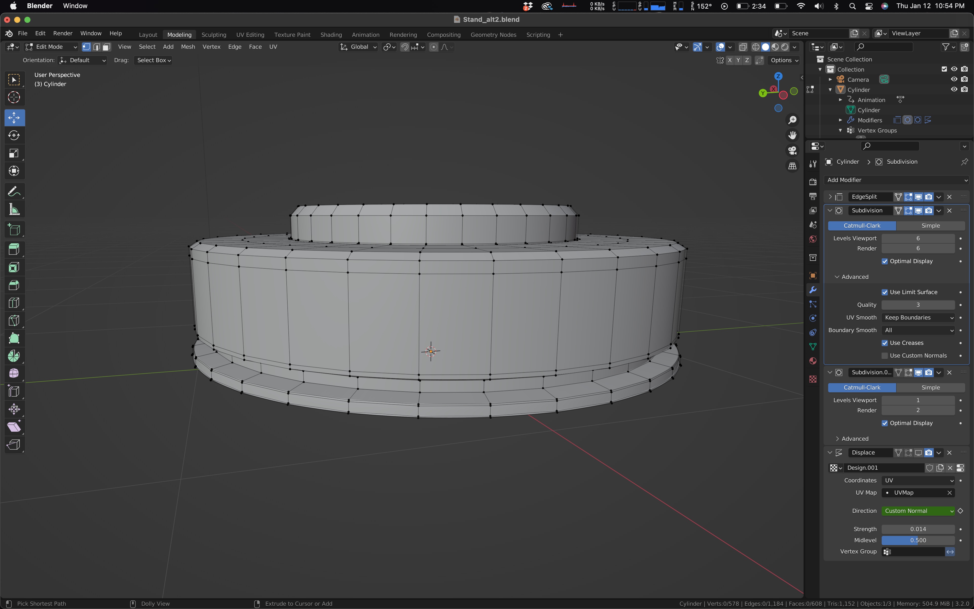

The geometry is pretty simple, just a short cylinder with some rounded edges, and a shorter cylinder on top.

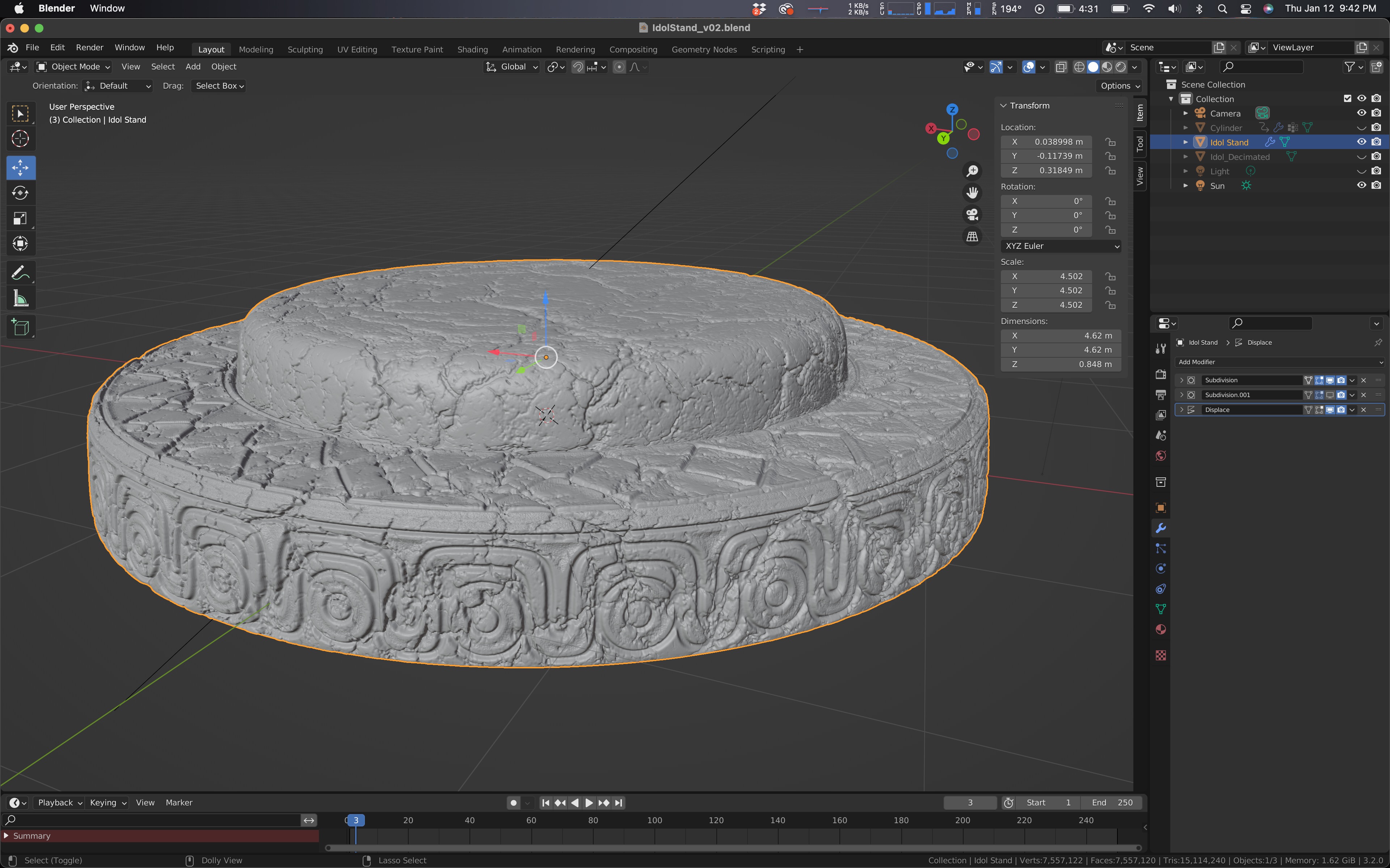

However, the fun part is wrapping a texture around it to displace the geo, that's where it comes alive. Here's a peak at my "map" used to deform the model. It's a combo of After Effects and Photoshop. It was fun to place the cracks and damage on top of the design. This type of modeling is pretty easy and fun once you get it set up right and get things dialed in.
Here's what comes out of it.
The model is huge, lots of vertices. I ended up slimming it down to make it printable, but at one point it looked really smooth and realistic.

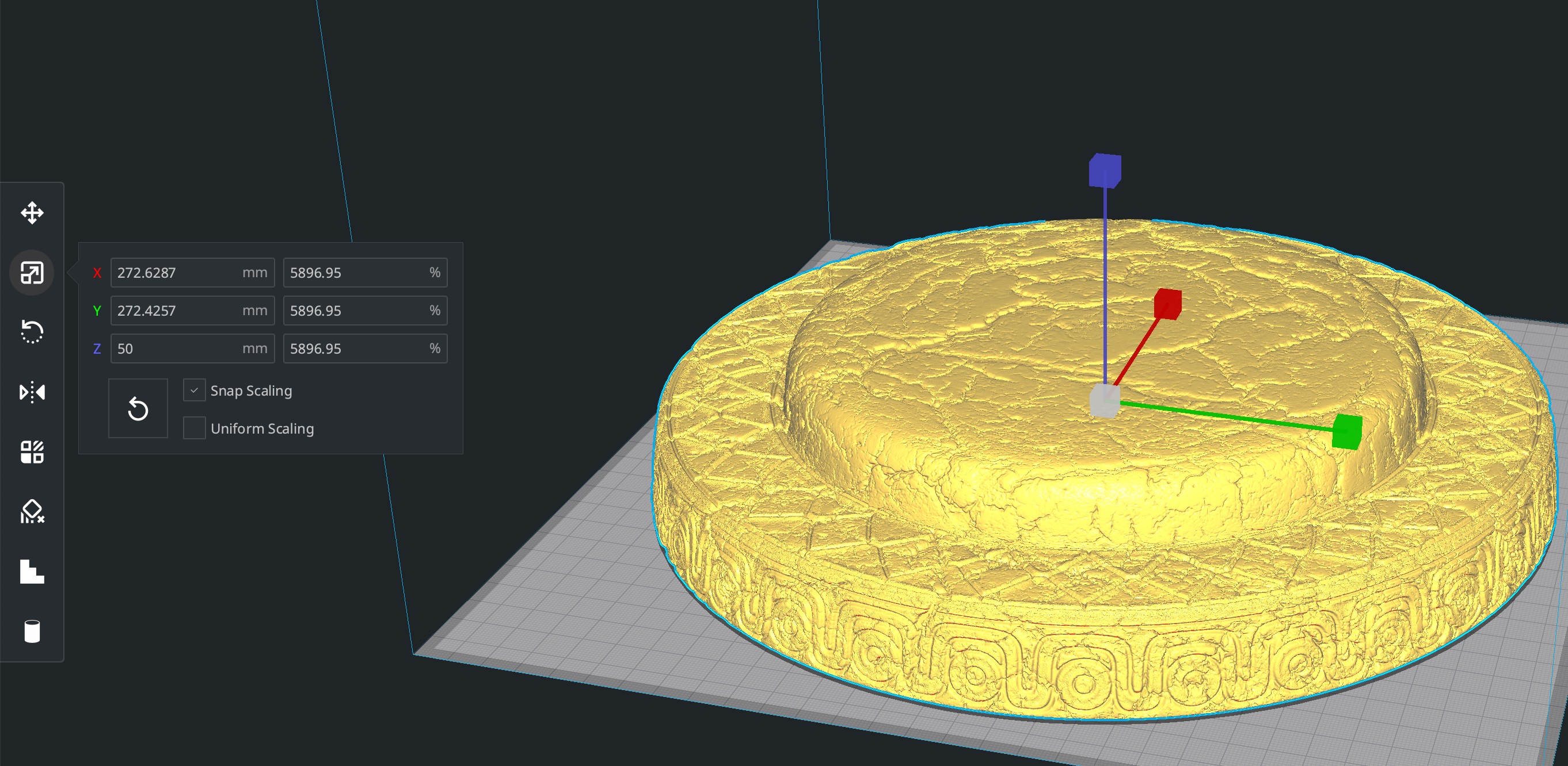

Then it was on to slicing and printing.
It fit quite nicely on my print bed. This is a CR10-v2 for any wondering.
