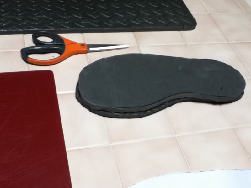

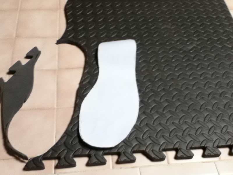

measure shoe or foot for template and cut out on paper or trace
step 2:
cut out shape a few times depending on the amount of thickness you want to add to height

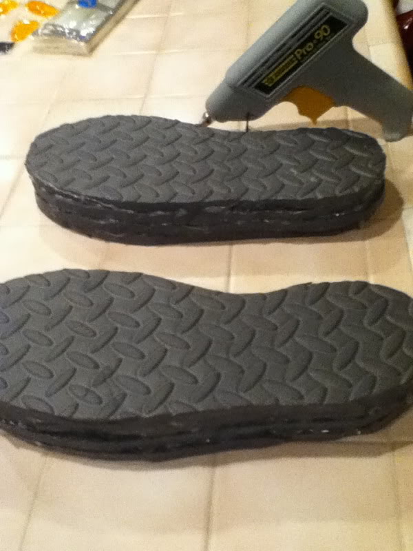

step 3:
glue cut outs stacked on top of each other

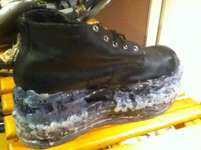

step 4 now your ready to glue pads to bottom of shoe or sandal
Step 5:

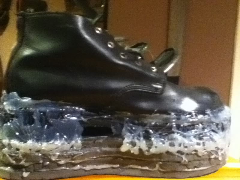

Glue to bottom of boot or sandal

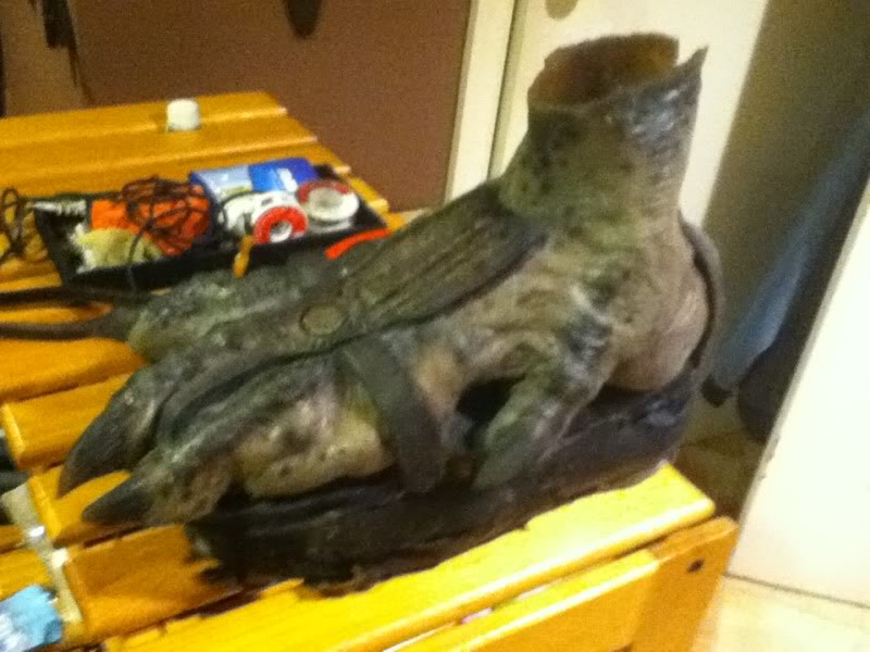

The final result
keep in mind my weight will knock me down about 1/2 to 3/4 of an inch.

Since the mats come in 2'x2 squares and there is 4 mats in a set, you can try it a few times and create a library of sorts of heights for you to select from. A parade/walking set ...a con set, you get the idea.

I have done this before and it does work for about 2 hours, then the glue begins separating between layers and BAM! You are walking around lop-sided all night! If you are not using the shoes/boots for anything else, use a drill with a screw attachment and drill some screws and the pads together from the INSIDE/ OUT for an additional connection. Be sure your screws are not longer than the thickness of the shoe sole and pads. I even reinforce it again with a little Gorilla tape. You will be glad you did!
