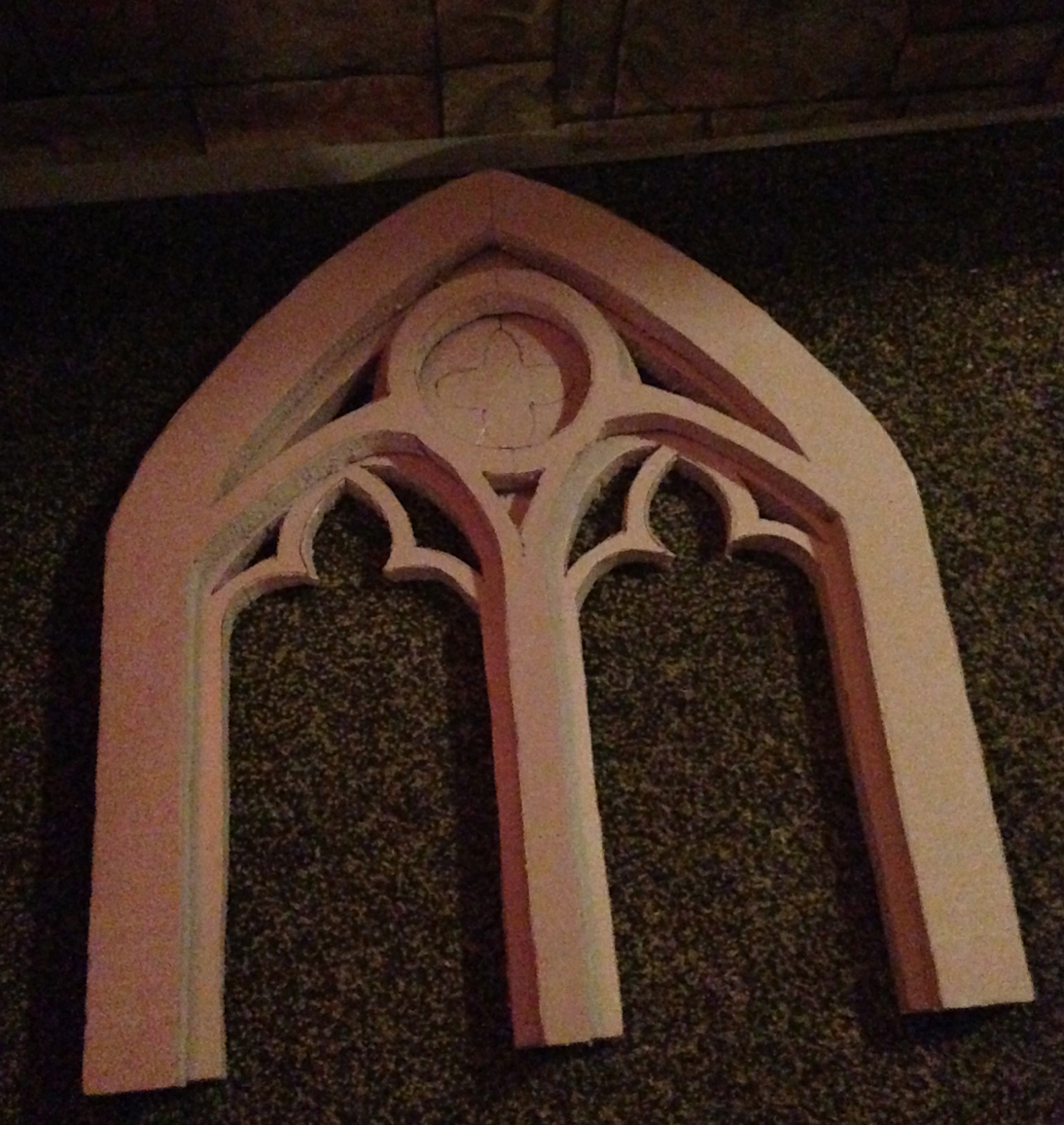

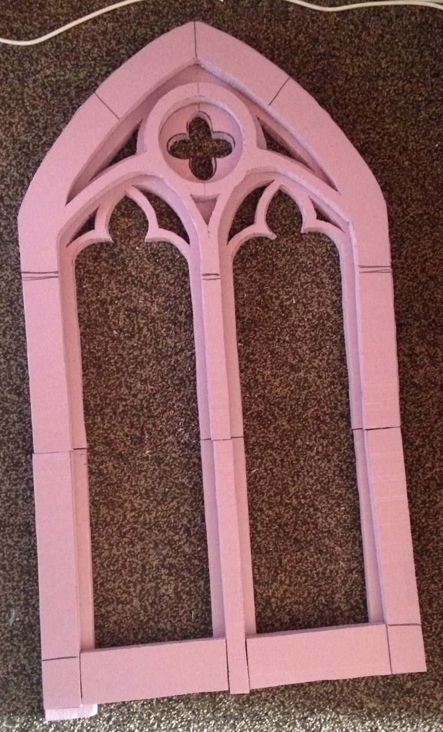

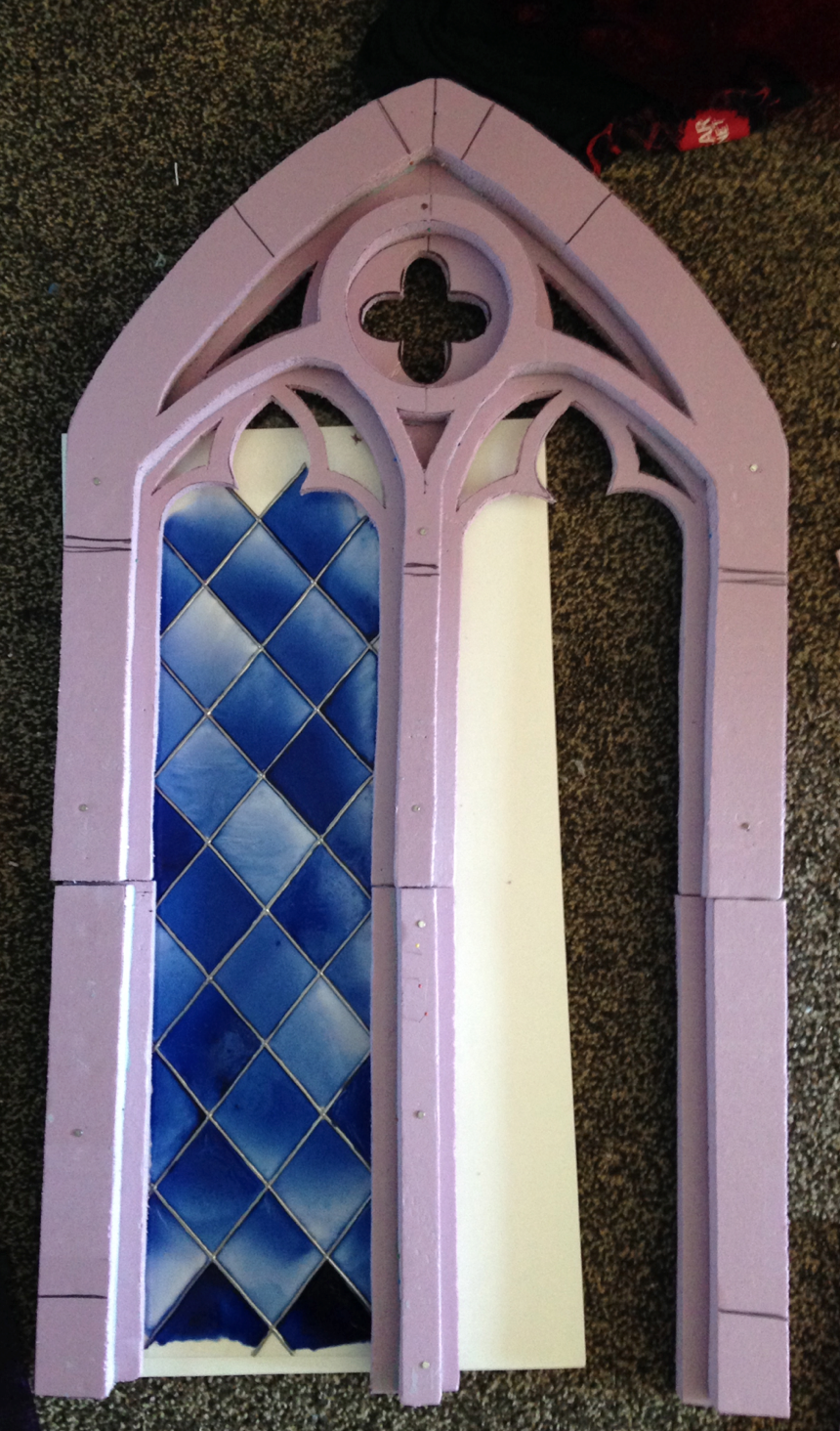

Here are some progress pics and the mostly finished piece:
Screen Shot 2014-12-28 at 12.31.04 PM.pngScreen Shot 2014-12-28 at 12.31.12 PM.png

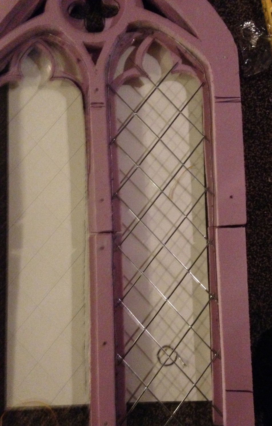

Applying the cut plexi and adding the adhesive leading:

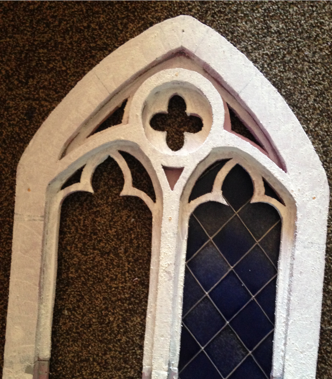

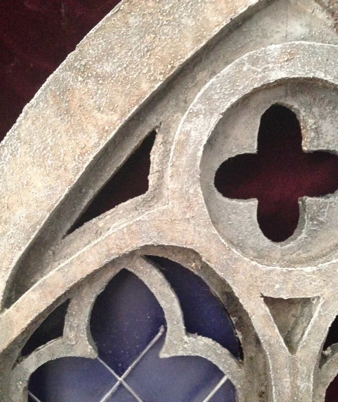

Layer of foam coat:
Some paint

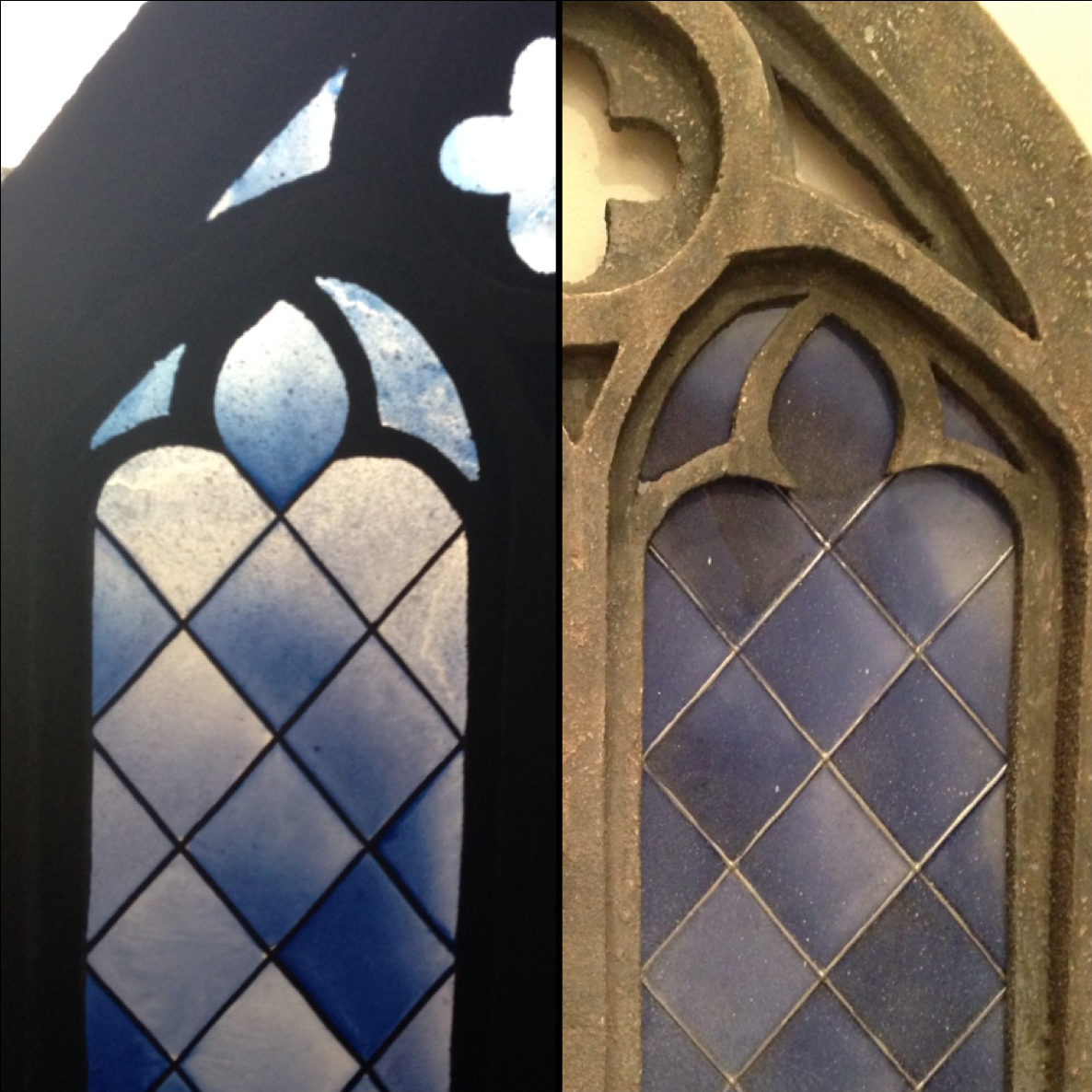

Comparison shot of it backlit with sunlight vs no light

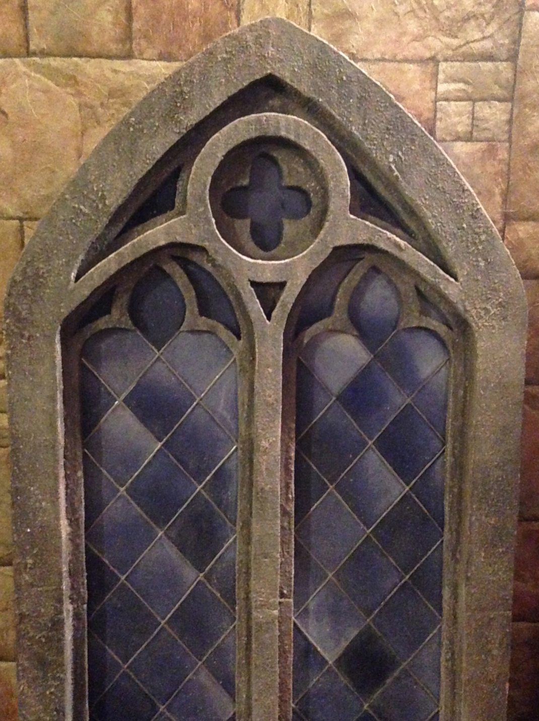

The mostly finished piece (unlit)

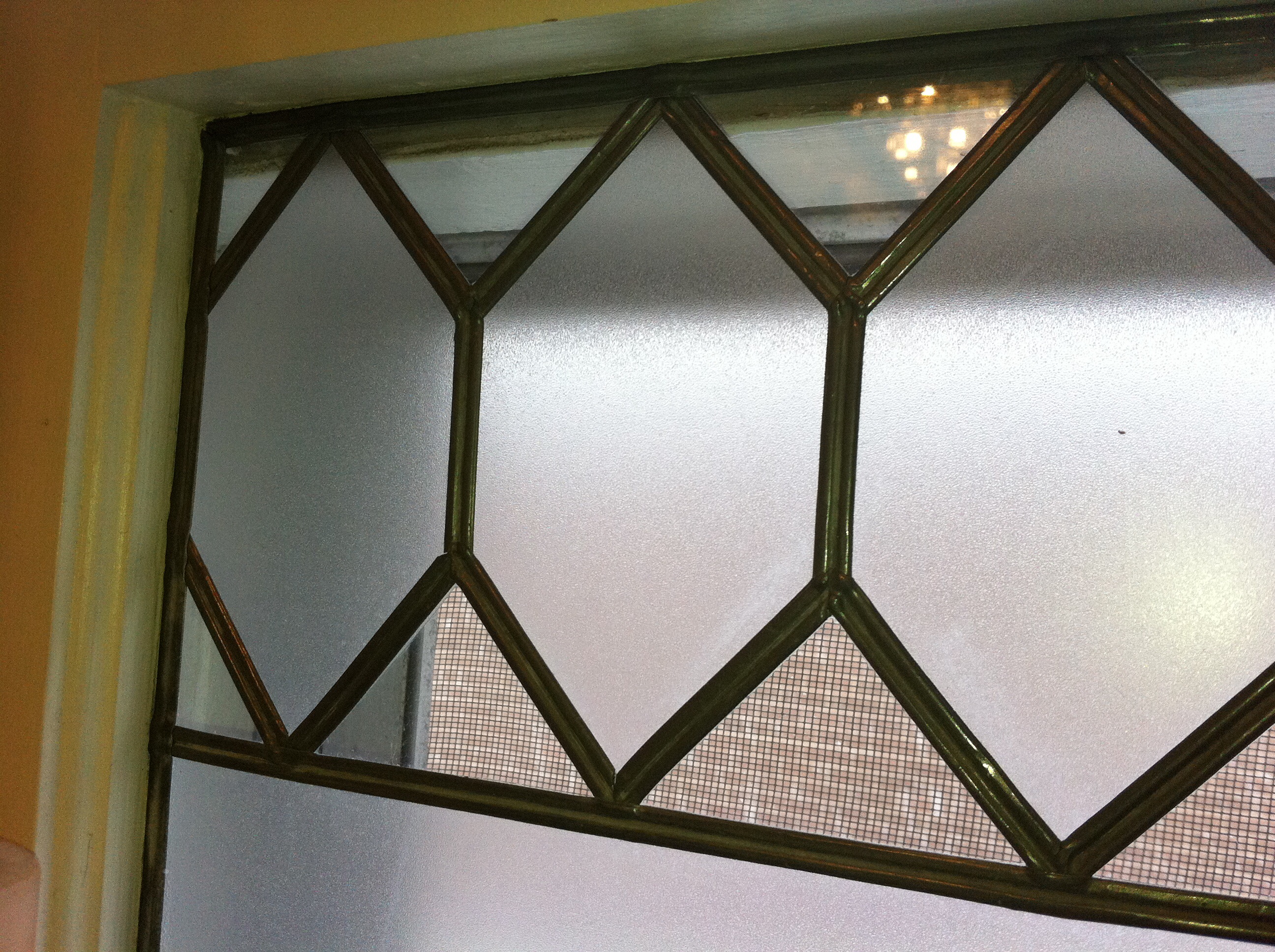

Moonite, have you used the lead stuff before this project? If not you'll be in for a nice surprise. :) Because it is real leading, you will find that over time it oxidizes and ages to look even more authentic - the silver shine goes away. I actually used it on the window in my bathroom a year or so back and most people think it's the real deal.
Just be be cautious handling the stuff often though, you don't want lead poisoning!
Wow - I didn't know that! That is fantastic! And that is the Pebeo brand or a different kind you used?

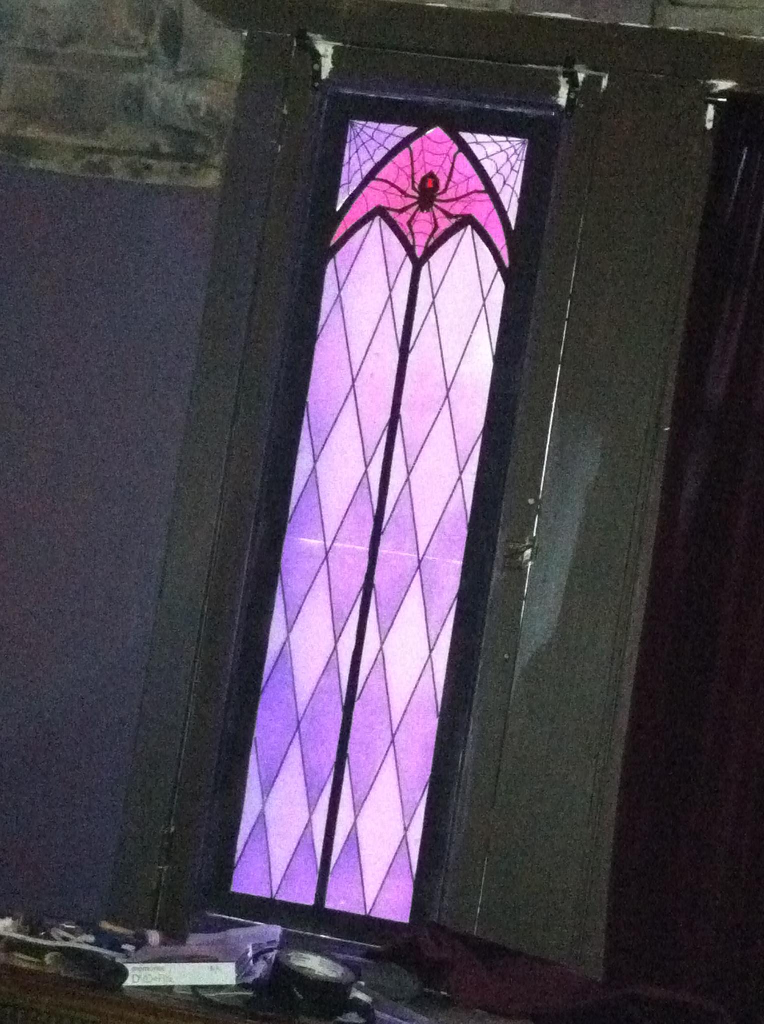

Oh - and here is the "stained glass" I made about 3 years ago using gels and the rubber leading from gallery glass.
