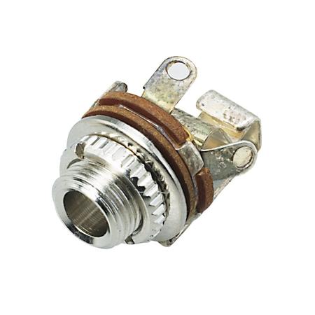

The QMX versions (and later seasons hero props) use standard 3.5mm audio jacks for the side jacks. (Personally I prefer their look over those larger power jacks.)

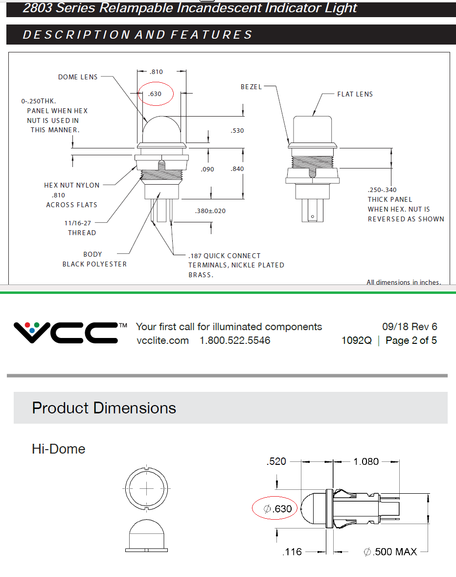

Zombie, I've dealt with VCC nylon panel lamps before. Snipping away the nylon housing does not affect the lens in any way. I wouldn't have made the recommendation without first-hand knowledge.
The lamp is also tiny, less than half the correct diameter.
Dr Slurpee, I have no idea where you pulled that comment from. Maybe you were reading the link wrong.
See below - The top image is from Zombie's part link datasheet, bottom image is from mine:
