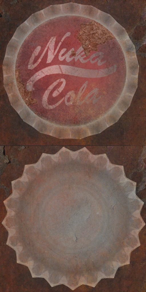

I just tried extracting the textures using B.A.E. (I never got any to work in Nifskcope)
It is so odd that they didn't put proper images on the tops of the caps, looking at the textures they did have space and were not saving any memory.
The Quantum bottl texture even has the same "D32" metal image placed on it twice! I may have to make my first Mod to publish on the Nexus.
I also don't see the edges as "White" see them as raw metal. The edge on the extracted texture is the same as the backside of the cap.
I am using the nVidia Windows Texture Viewer to read the files.
Awesome! Thank you for the info on the viewer, will make good use of that. :thumbsup
Now that the images are clear, it's pretty easy to see you're right about the silver edges. I'm very glad to see we've got some definitive images, shouldn't be much room for argument here.

I was able to extract the textures for the caps stash box from the Fallout 4 game files. Here is a jpg of the textures used on all sides of the box.
Here are the extracted textures for the Nuka caps. If anyone needs any other textures from Fallout let me know and point me to the appropriate thread where they need posted and I will post them.
