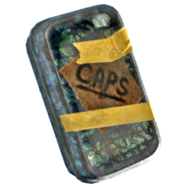

Maybe one of these vintage first aid kit tins (I think they are 7" in length, need to double check):
zapwizard
B Wo, I didn't realize you could etch tin like that. My wife has all the supplies listed in her scrapbooking room, I have the rest in my garage.
EmmaInCandyland, I think if someone can find a larger tin that looks close enough then that is great. However, the scale on some props in Fallout is sort of ridiculous. That box is on top of a clipboard, assuming that it is an 8.5"x11" clipboard, then that cap box is close to 10 inches long. However, if you compare it to the keyboard next to it, then it looks around 6 inches long. My other issues with the scale in the game is the tape. Normal tape like that is 0.5" wide. I think they created the original model based on something like a altoids tin, but then scaled it up to make it easier to find inside the game.

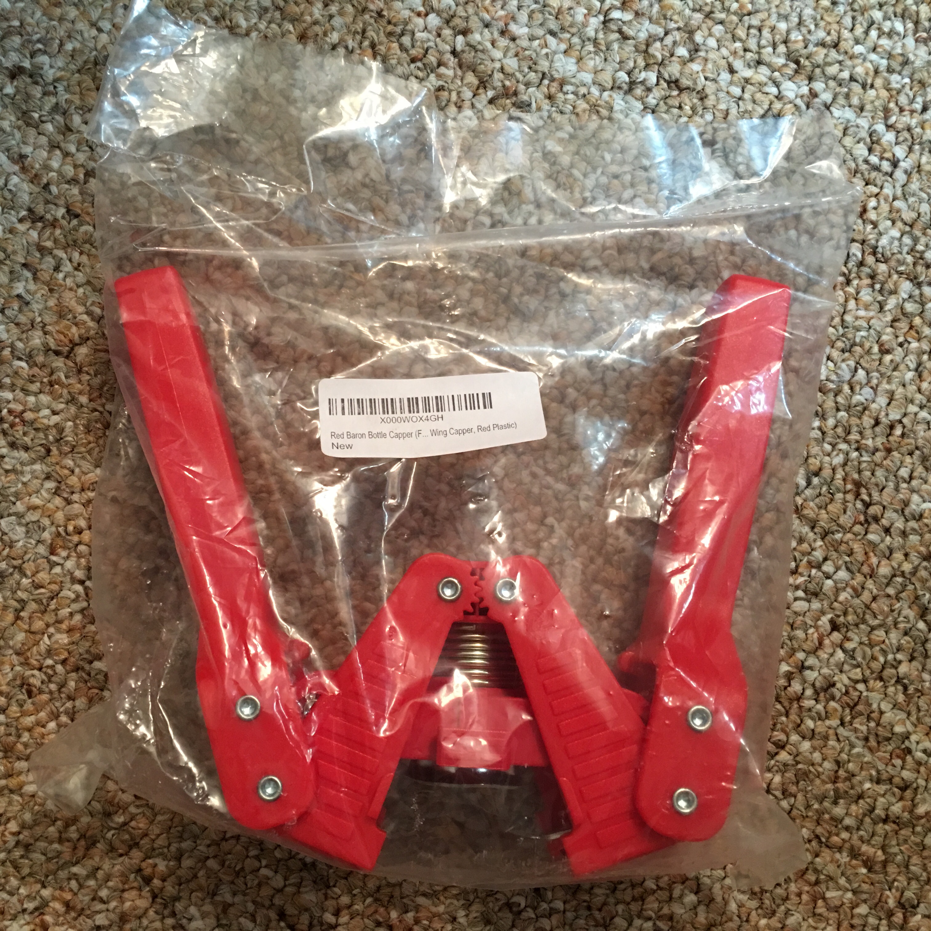

The best way to disform them is to buy a capper. They are only like $12 and its the most realistic way to disform them :)

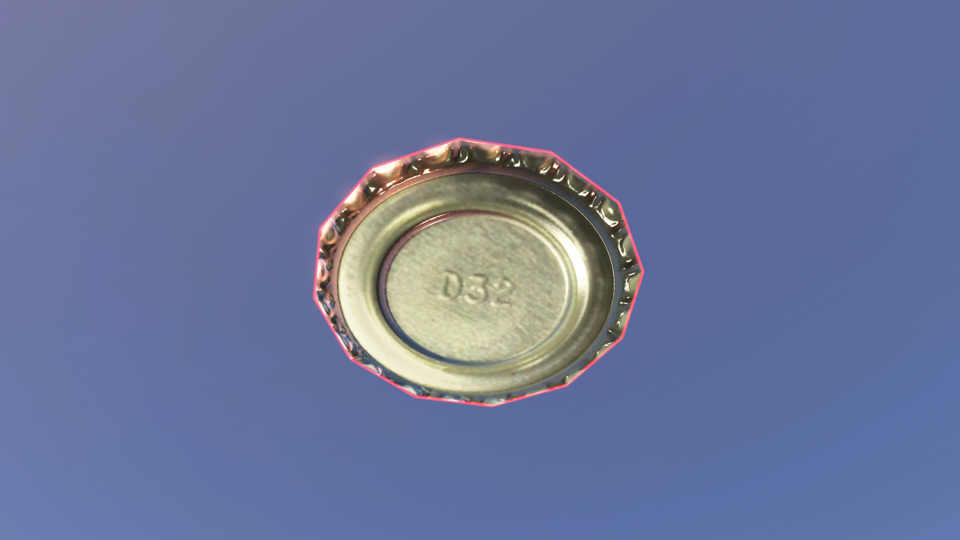

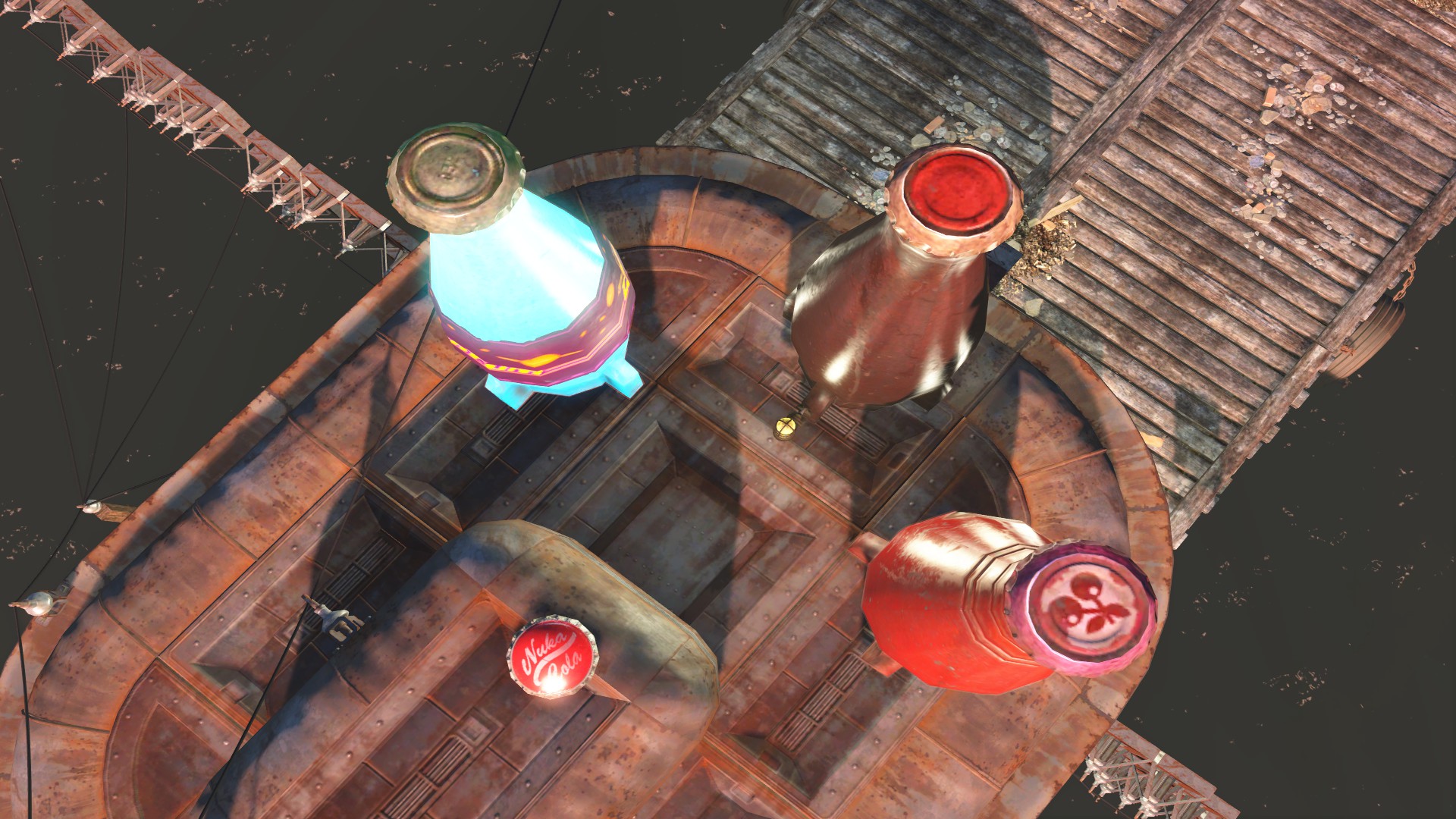

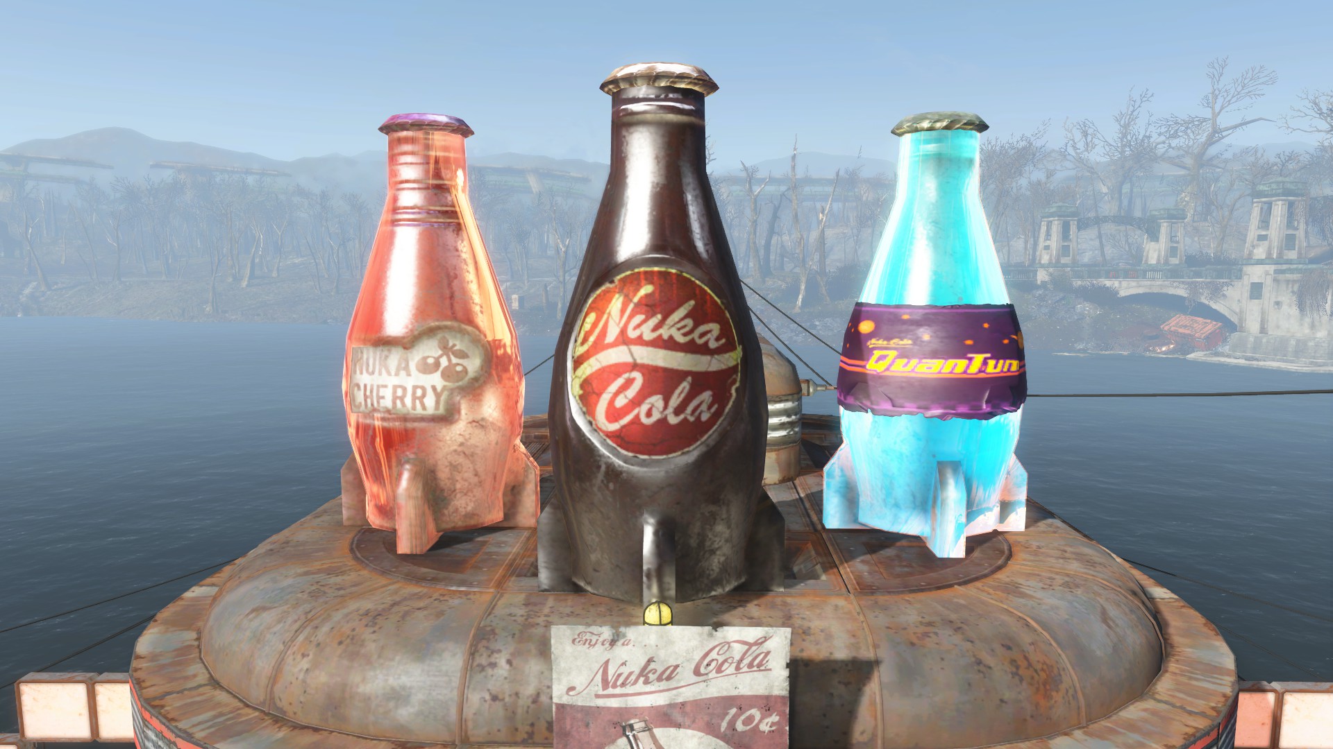

The other method to get a better view is to click on the item and use the console command: "Setscale 50" to blow it up to a huge model. Also the OCDecorator mod allows you to place bottlecaps.
Here you can see that the caps on the bottles in-game are actually different than the individual caps you pick up in game.
The normal Nuka Bottle just has a red top, no logo. You see they found room in the texture file to put a logo on the Nuka Cherry bottle.
However, the giveaway is the Quantum Bottle cap. It is actually on upside down!
If I look at the bottom side of the individual cap, you can see it marked "D32", and it is metal with no paint. If you look closely, the Quantum cap also says D32!
My bet is in the effort to save texture size and precious memory space for consoles, they selected to reuse some of the same texture elements. Because, really, who is going to be looking that close at it. (Besides us)
Also bonus image of the bottles blown up.

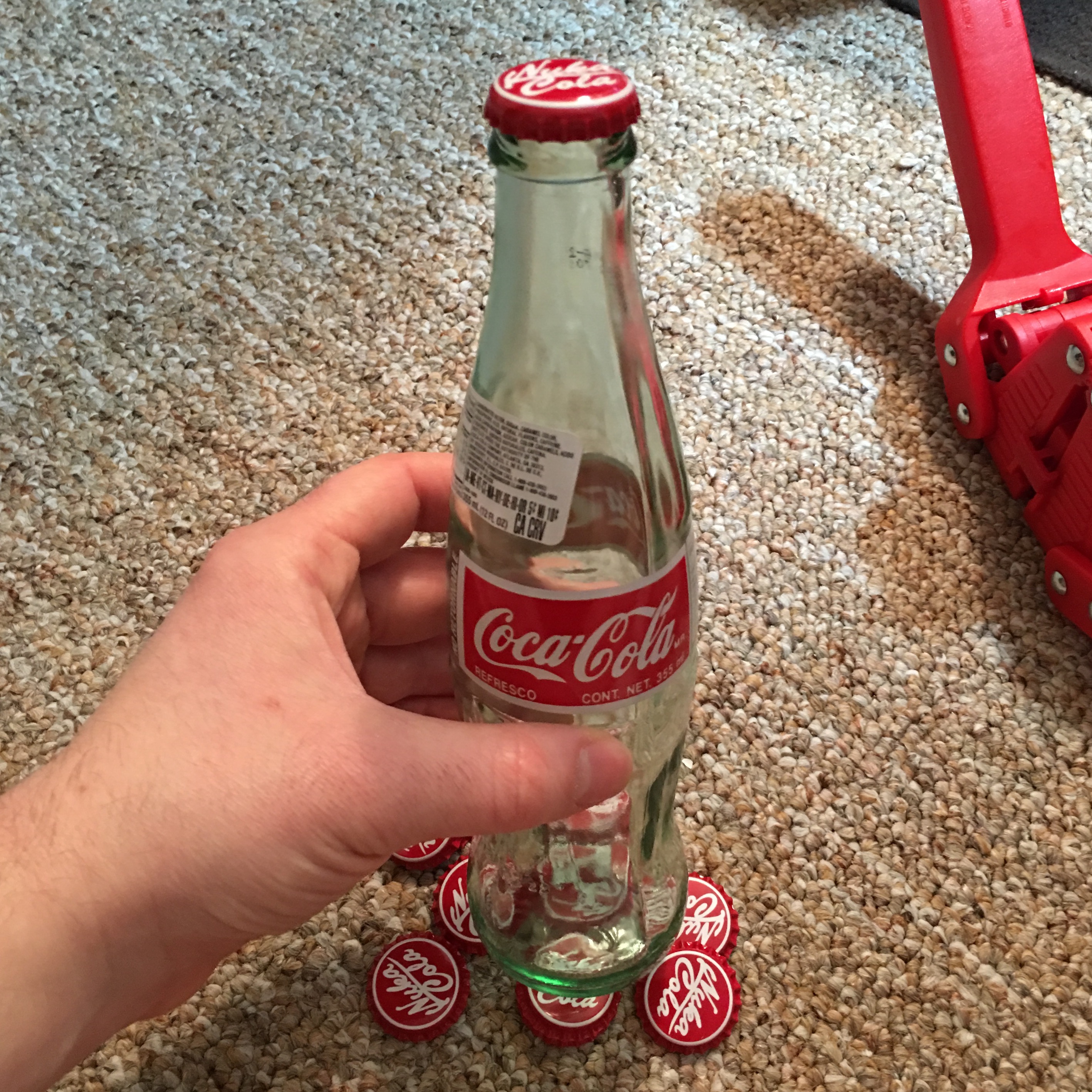

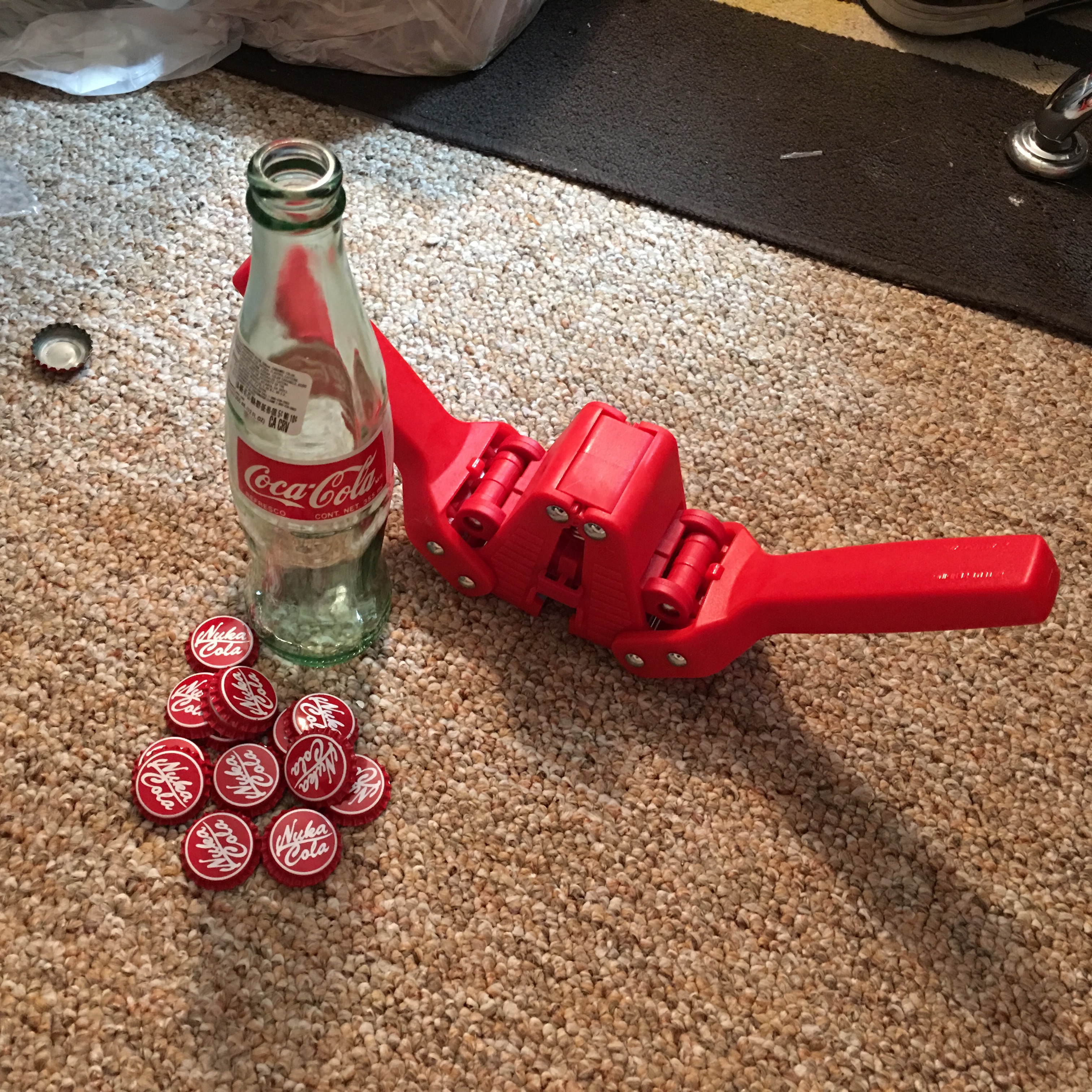

I tried machining a bottle capper out of some scrap carbon steel at work. I based the design off some Google images and dimenions from a beer bottle a coworker had on his desk. I failed utterly, and decided to spare myself further headache by spending $14 on a bottle capper off of Amazon.

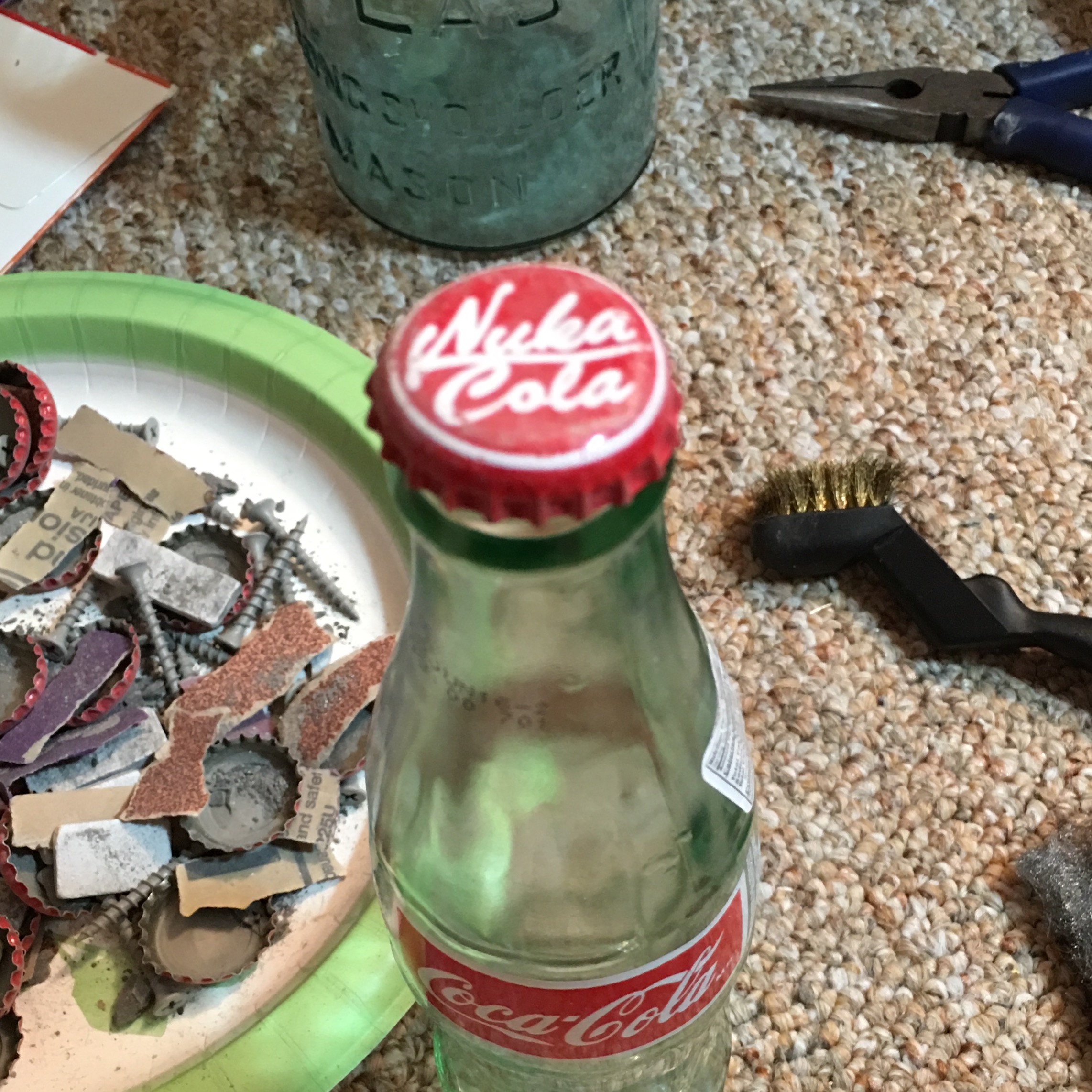

I bought a glass Coka Cola bottle from the grocery store, and set to work fastening and removing caps. It was stupid fun.
Caps Stash WIP - 2.jpg Caps Stash WIP - 3.jpg Caps Stash WIP - 4.jpg Caps Stash WIP - 5.jpg

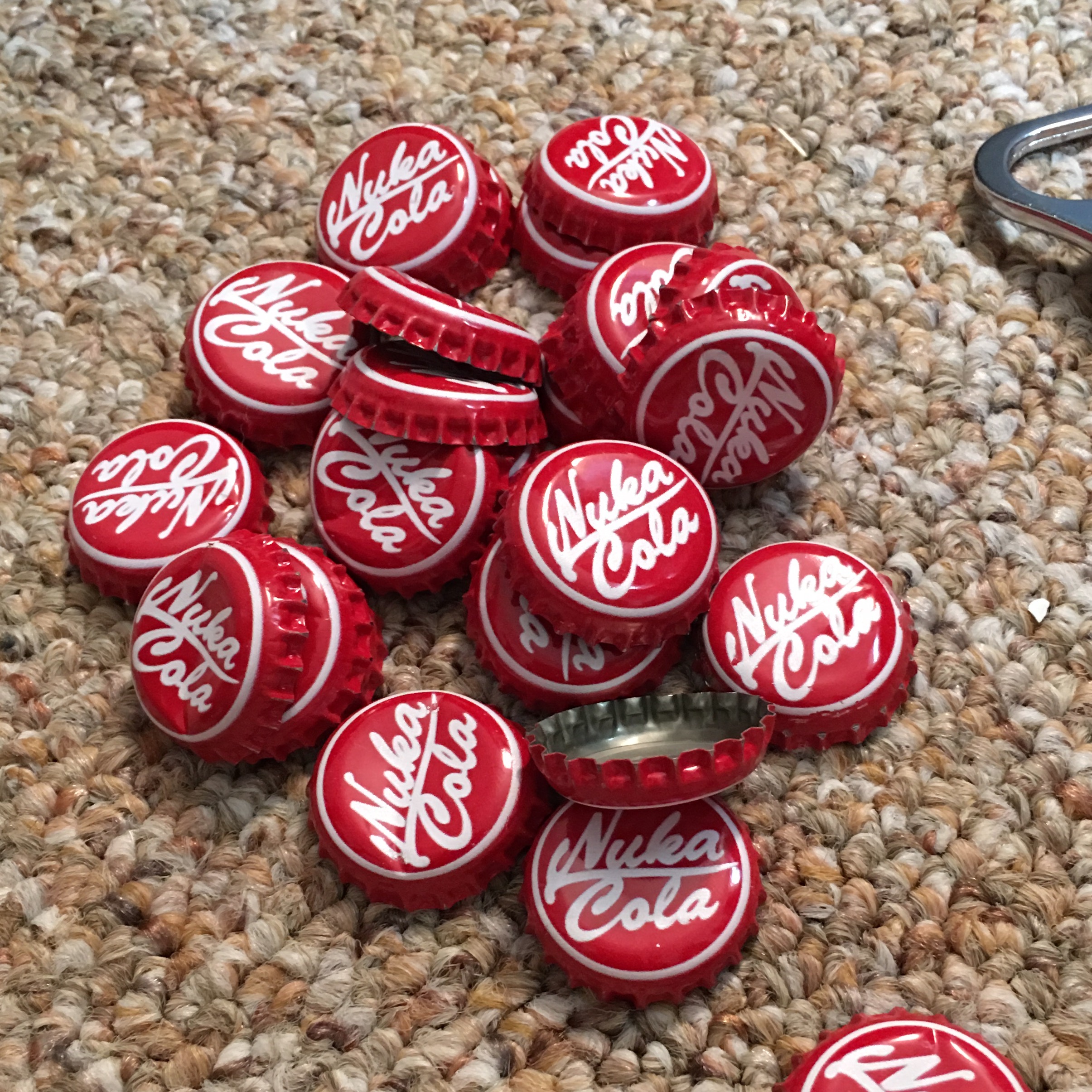

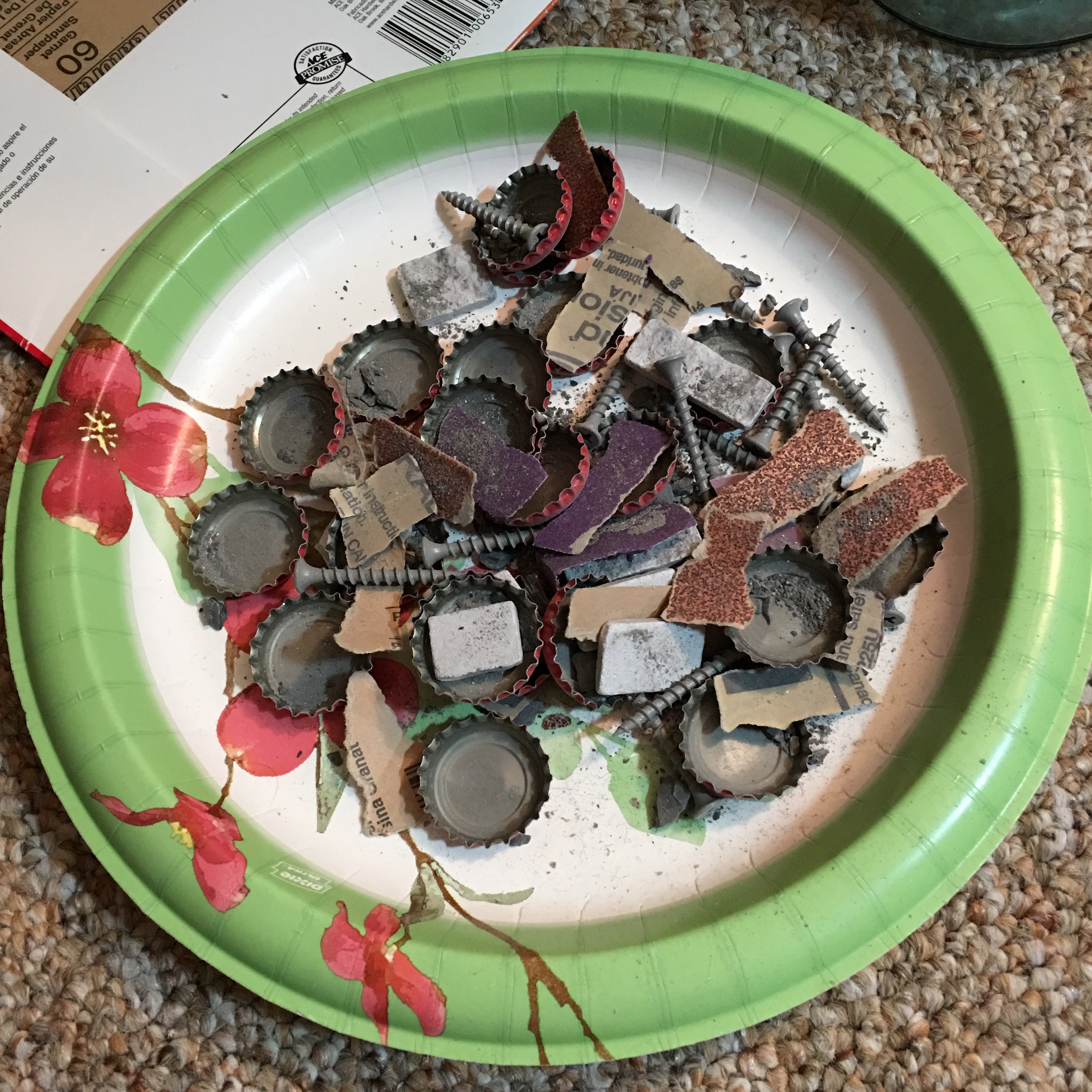

I used zapwizard's method of distressing caps, initially. I threw some screws, shreds of various grades of sandpaper, some chunks of slate tile and plaster in a mason jar and shook it like a Polaroid picture. Then, I dumped the contents on a paper plate. I put the caps back on the bottle, one at a time, and then mashed the cap into the pile of debris to get some scuffing. Then, I hit it with a copper wire brush, a little spot scuffing with sandpaper, a steel wire brush, and, finally, some 0000 steel wool. This was all pretty convoluted; there are probably better ways and worse ways. I document, here, so peeps can pick and choose the method that's right for them.

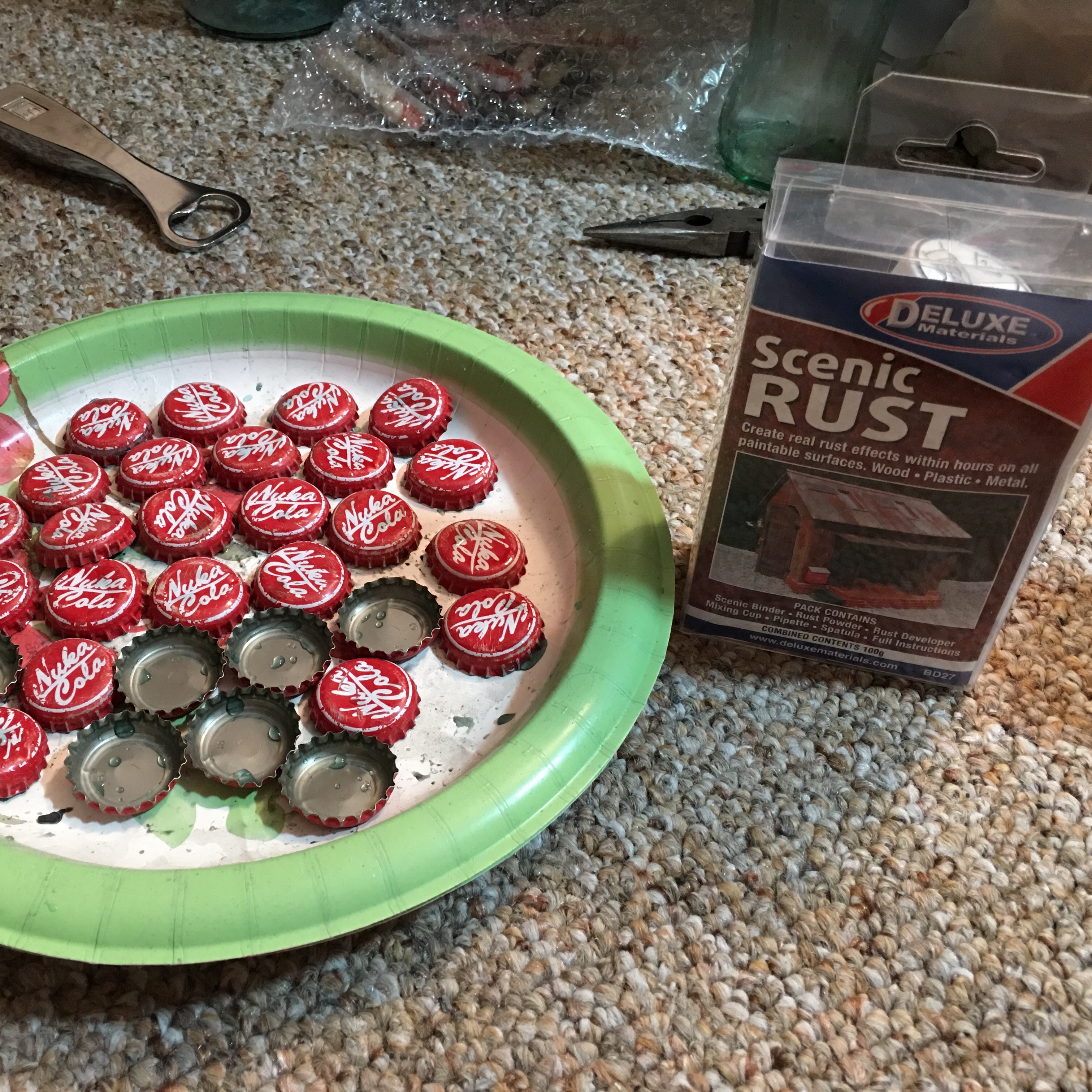

After my caps were sufficiently scuffed, I took a product called Scenic Rust by Deluxe Materials, and used an acid brush to hit the bare metal parts of the caps.
I let the Scenic Rust sit overnight, and my caps ended up looking like this:
View attachment 586014 View attachment 586015 View attachment 586016 View attachment 586017
View attachment 586021 View attachment 586022

Thanks for the write up. I was just literally looking at buying a capper, so I can finally get my bottles finished. :thumbsup

GhostMinion You're welcome. The capper wasn't expensive, and the thing works like a charm. I only wish I'd had more caps to....well, cap.

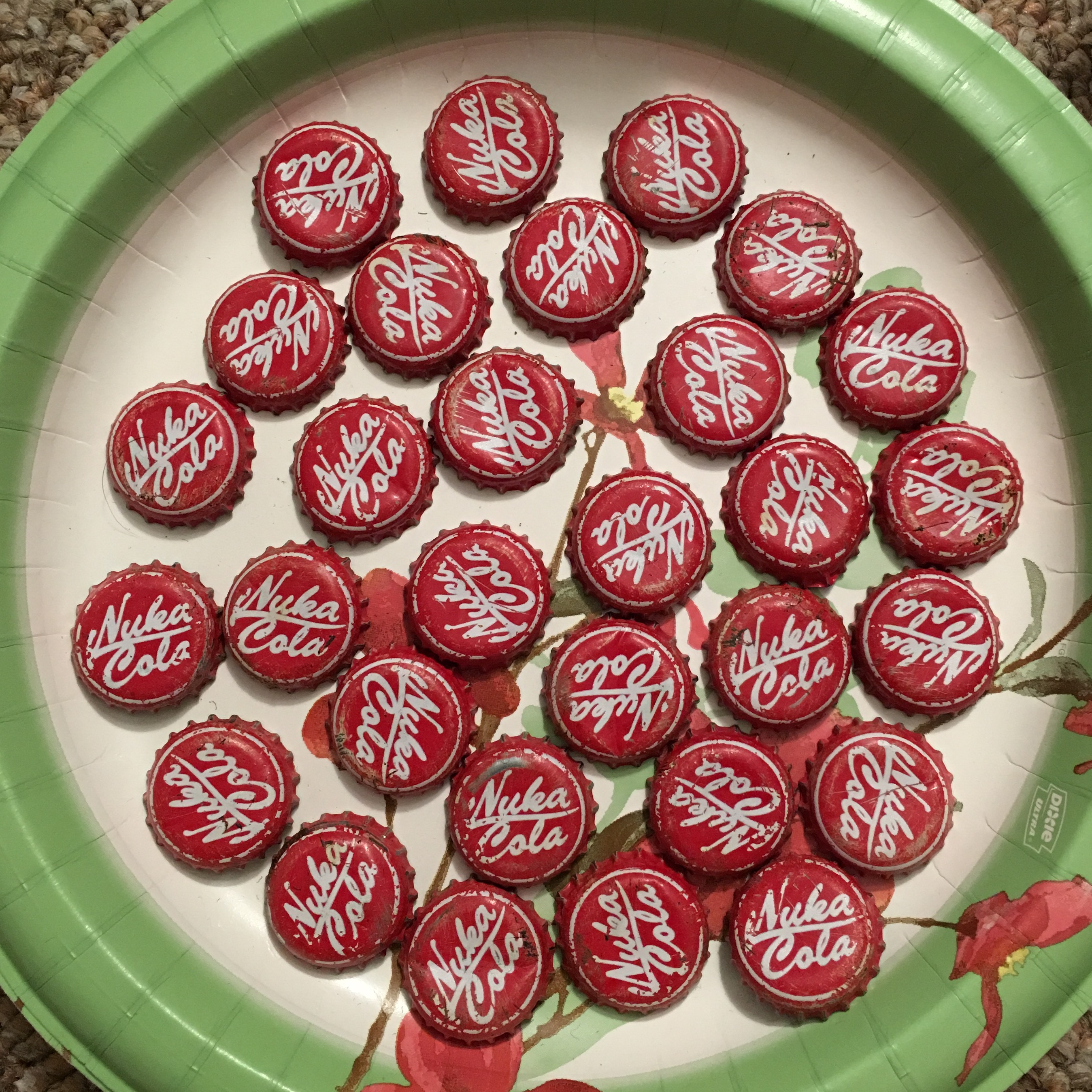

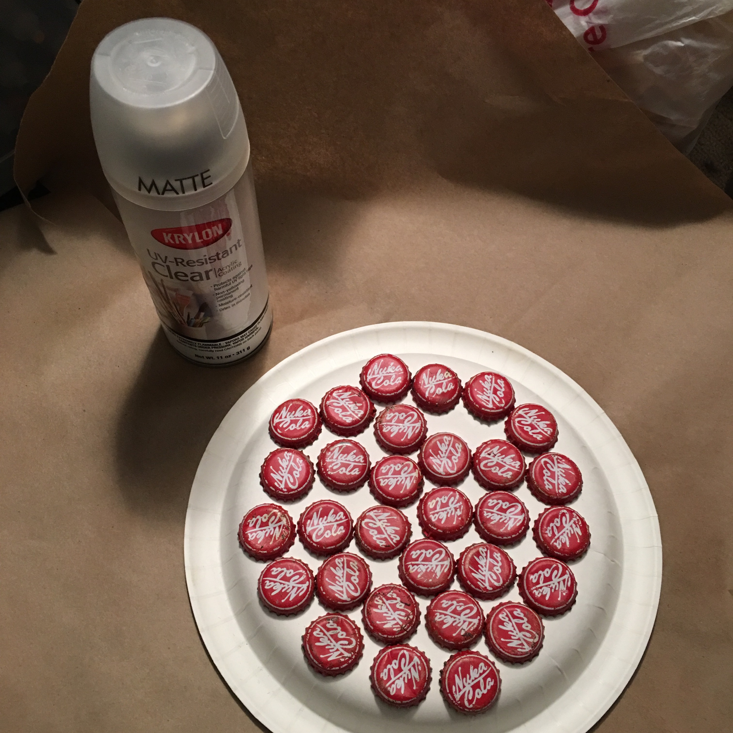

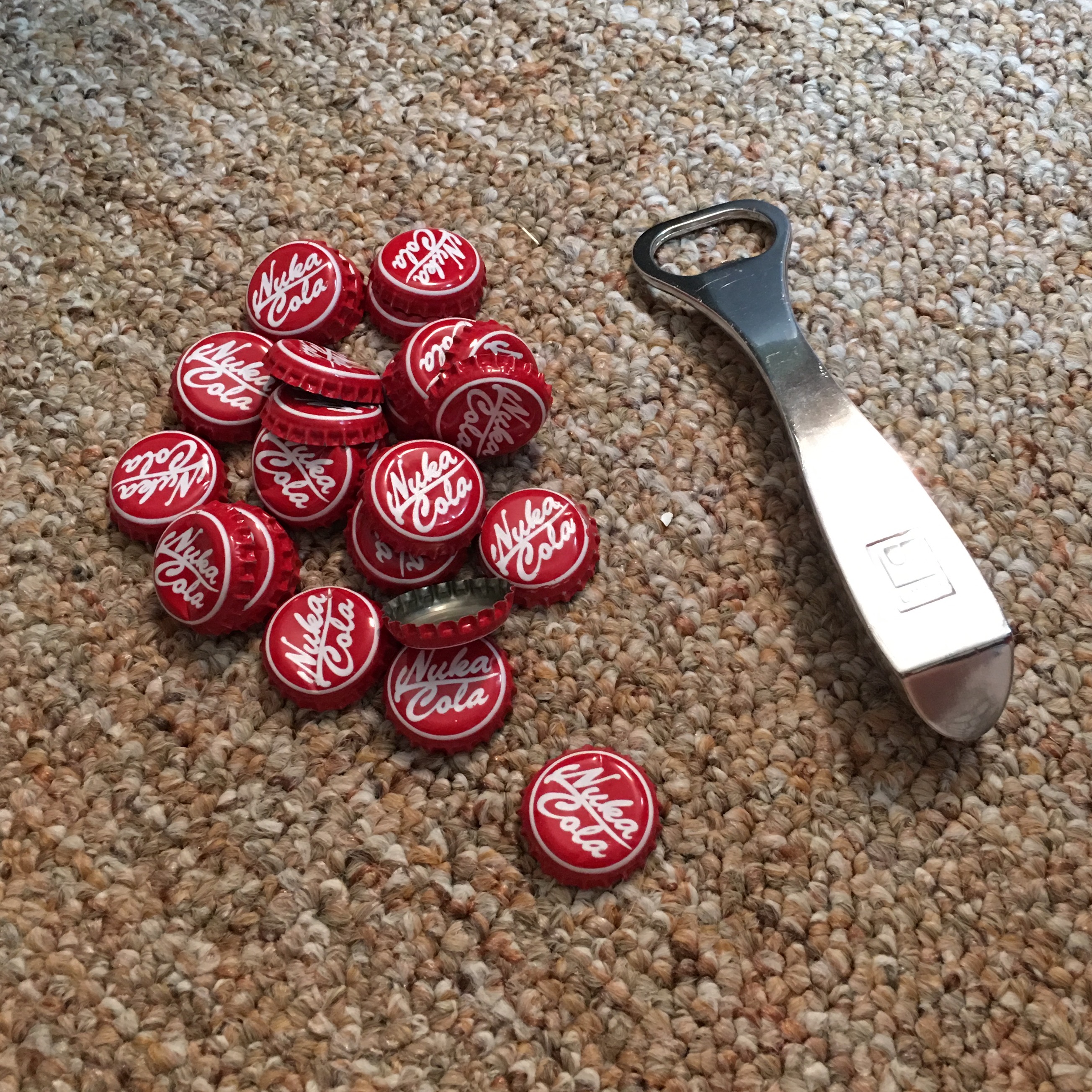

Here is how my caps turned out:
That didn't sound grammatically correct when I was typing it, haha.
I picked up some 100 grit rusty orange sandpaper, today. My tins arrived yesterday. The supplies for etching arrive tomorrow. I will post a WIP once I've got my mini caps stashes wrapped up.

Looking good. The bottle capper does make them look a bit puffy or perhaps it's just the lighting. But I will have to add some rust to the next group I weather.

Some notes on Deluxe Materials Scenic Rust:
The Scenic Rust system comprises of an iron powder, a medium (like watered-down PVA glue), and an activator (the blue stuff you can kind of make out in my photos, above). The idea is, you mix the iron powder into the medium to make a paste, and you brush it on to the surface you want to weather. Once the past has dried, you apply the activator, which oxidizes the powder, and, presto, authentic rust.
In most cases, Scenic Rust is being applied to a styrene or resin surface, as it's used in building scale models. This is significant, because once the iron powder has oxidized, the reaction is over; the substrate is inert, and can be sealed with varnish.
In the case of metal caps, after the activator has been applied to the exposed metal, it will rust, but applying varnish to the surface will only inhibit it spreading topically. The substrate is still metal, so, like that troublesome bubbling around my Honda's front wheel well, it will continue to rust internally, beneath the finish.
I don't know precisely what this means for my caps, as they're only a couple days old. One thing is for certain, and it's that they will only look more and more authentic until they are an orange powder and flakes of red and white paint.
In hindsight, beautiful hindsight, I should have scuffed them up, then sealed them, thoroughly, then applied the metal paste, activated only the paste, and then sealed it again. This would have insured that the caps would be of archival quality.
I share this so anyone reading can be aware of how their weathering techniques may impact the materials they are working with.

@falconNL, I wasn't as much going for "Accuracy" as I was going for what would look correct if it were manufactured by Nuka in the real world. The circle around the logo on mine came from the circle around the logo visible on the Nuka Cola gun. So your version 2 caps are actually a bit closer to the game model.
