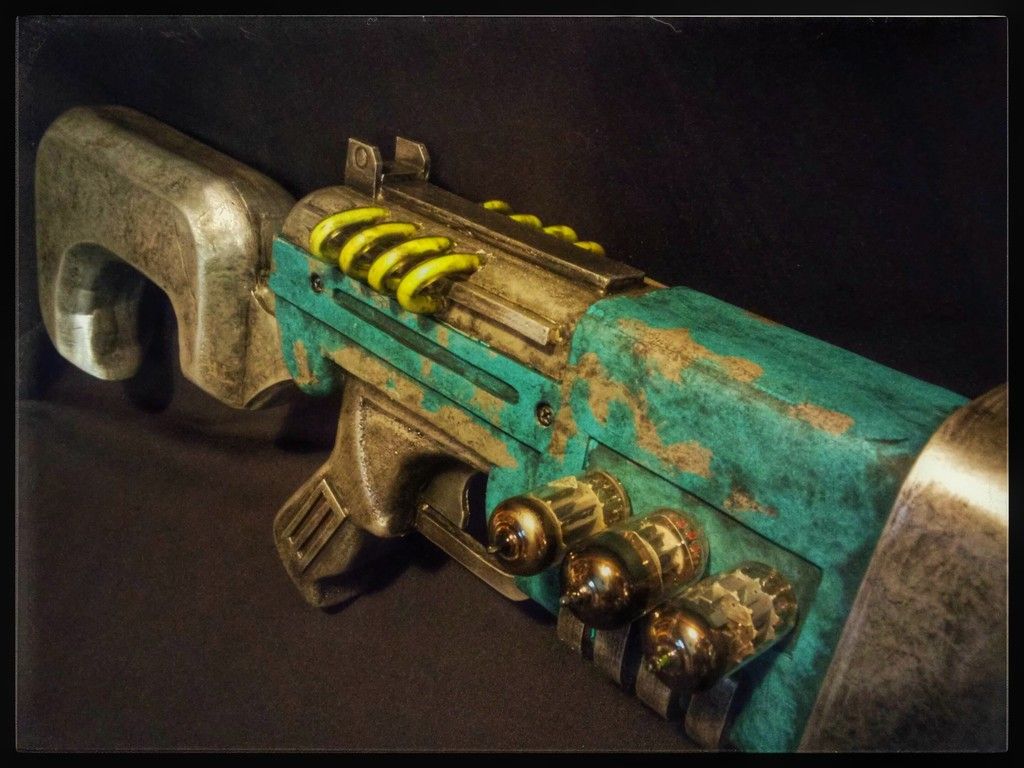

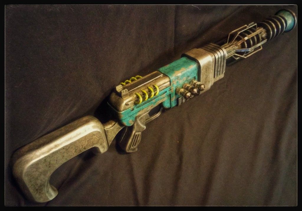

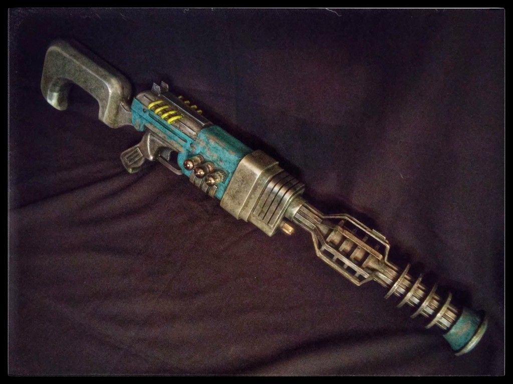

Just finished up my Recharger rifle from Fallout:New Vegas. I made it using pink panther foam insulation board, different thicknesses of craft foam, foam core poster board, fish tank tubing, Sintra, pic pipe and some vacuum tubes. To seal the foam, I used a 1:1 ratio of acrylic paint and elmers glue-all and brushed on 4 layers of it. It works pretty we'll to fill gaps. For larger gaps, I used DAP light weight spackle and sanded it down using Various grits of sandpaper. The base coat was done with Krylon smoke Gray, then I applied the turquoise paint, used licorice acrylic mixed with Windex for a blackwash and applied silver rub n buff. It took me 13 hours over the course of 4 days to finish this and I'm fairly satisfied with the result seeing how it was made all from scavenged materials as is the way I make the majority of my props. Enough talk, on to some pictures.
