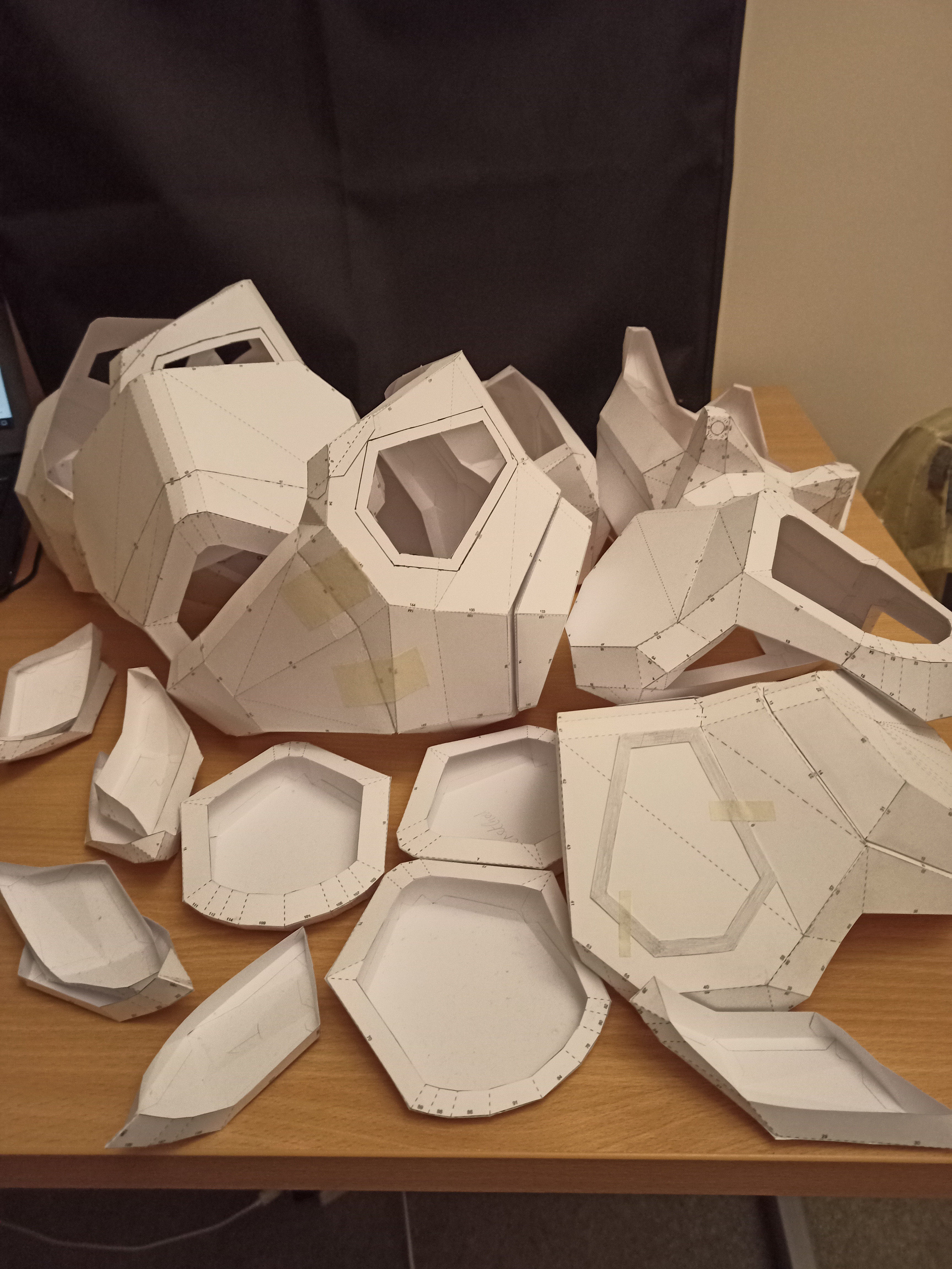

I have a big pile of card models of prototype pieces now!

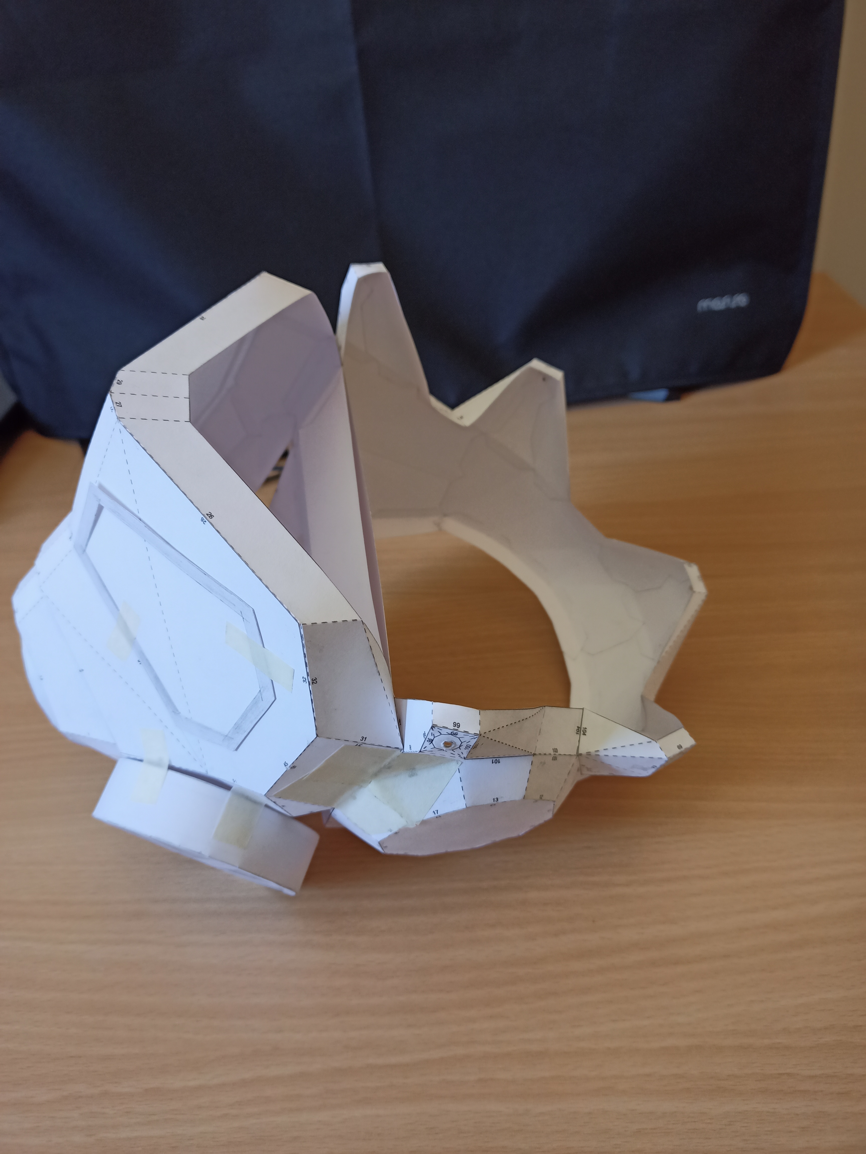

I put together a mock-up using various test parts and taped on paper bits to visualize what the full helmet will look like:
Currently I have most of the final peps coated with epoxy resin and ready to have body filler applied. Once I've finished shaping/sanding I plan to make molds of the pieces and slush cast them in urethane resin for the final finished version. I haven't decided precisely what kind yet.
To solve a problem that's common in other NCR ranger helmets that I've seen of the helmet slipping around and down over the eyes I made the neck piece have "arms" that reach up to holes in the helmet part where rivets would be in the real one. The neck piece will then be attached to the helmet with machine screws of some kind. Not the most elegant solution but it works in the mock-up at least.
