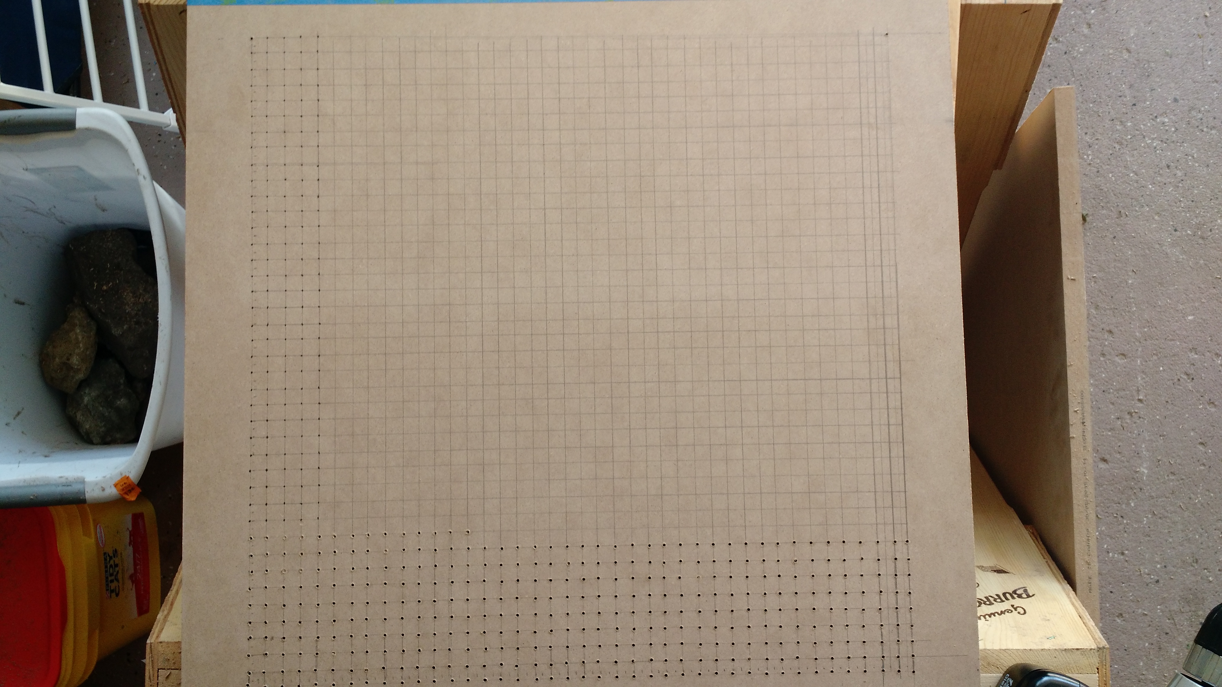

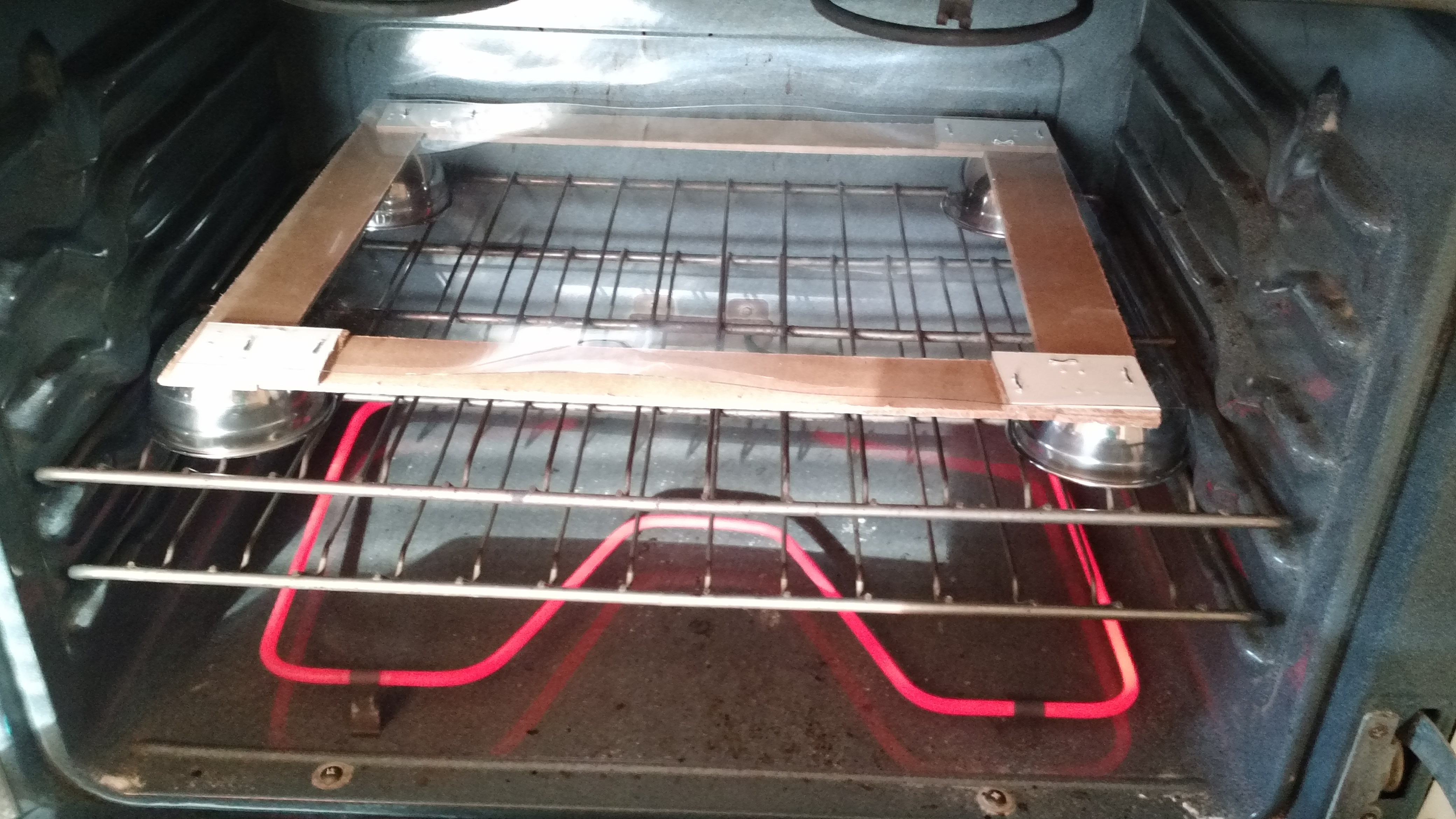

    I have a lot of other reference pics but they are .png on my phone and the forum doesn't like the format so I'll upload those once I get home. Any way, I decided to start with the head gear. I wanted to vacuum form it due to the huge visor. So my first step was to build a vacuum forming machine. What I learned: drilling 1600+ holes by hand sucks. The frame that holds the plastic us every bit as important as the vacuum box. The heating method is paramount to the whole operation. What that really means is that my machine is a work in progress! I was concerned my shop vac was under powered so I bought a 6.5 HP unit...the suction shattered my first clay buck (to be fair it was far too fragile). My kitchen oven was far too small to accommodate the 24" square PETG I wanted to be able to form. This was for the best I didn't like the idea of heating plastics where my wife cooks our food. So I won a 1500W infrared heater on EBay ($69!) Which I will build a dedicated vacuum forming heater.

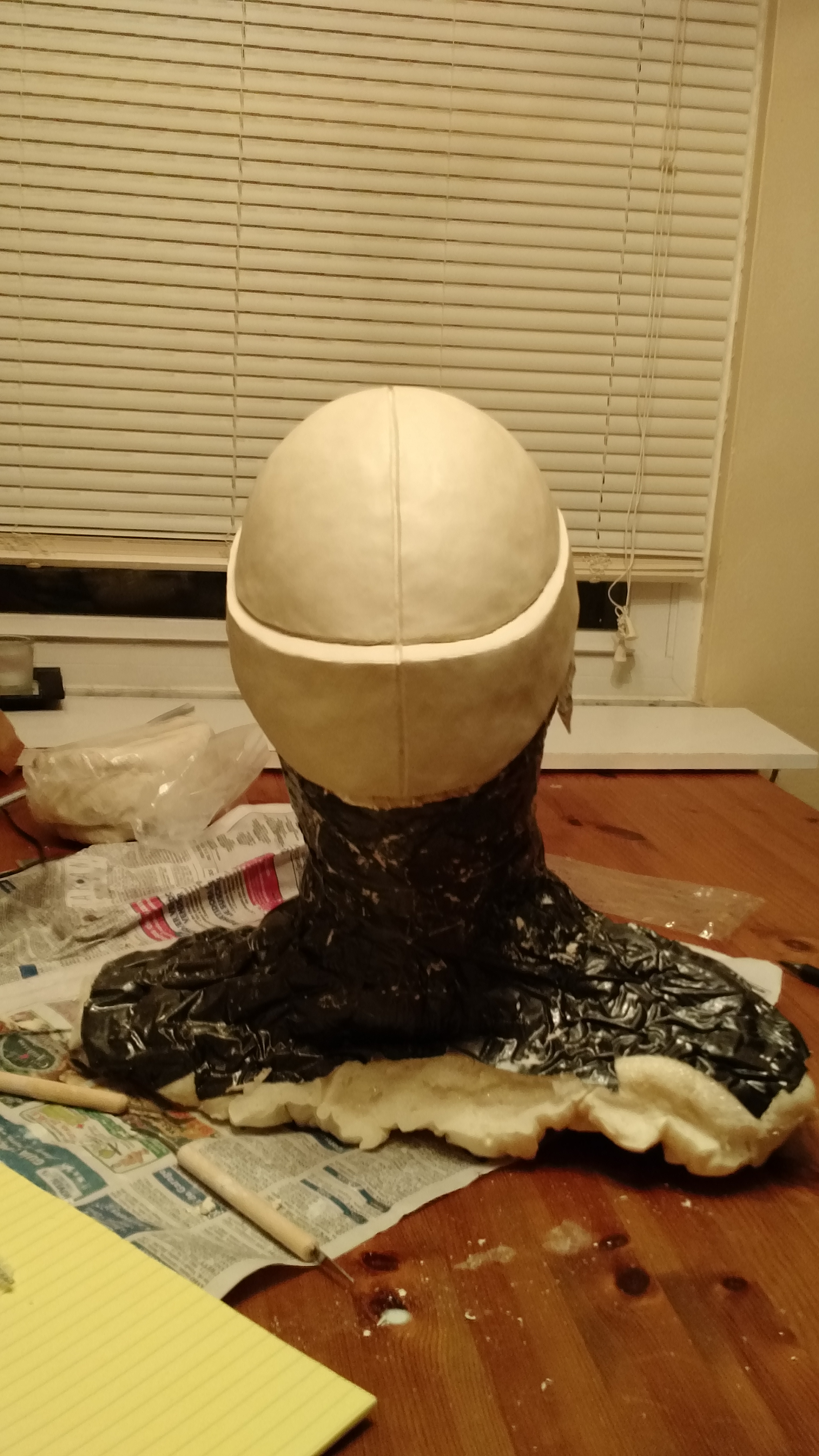

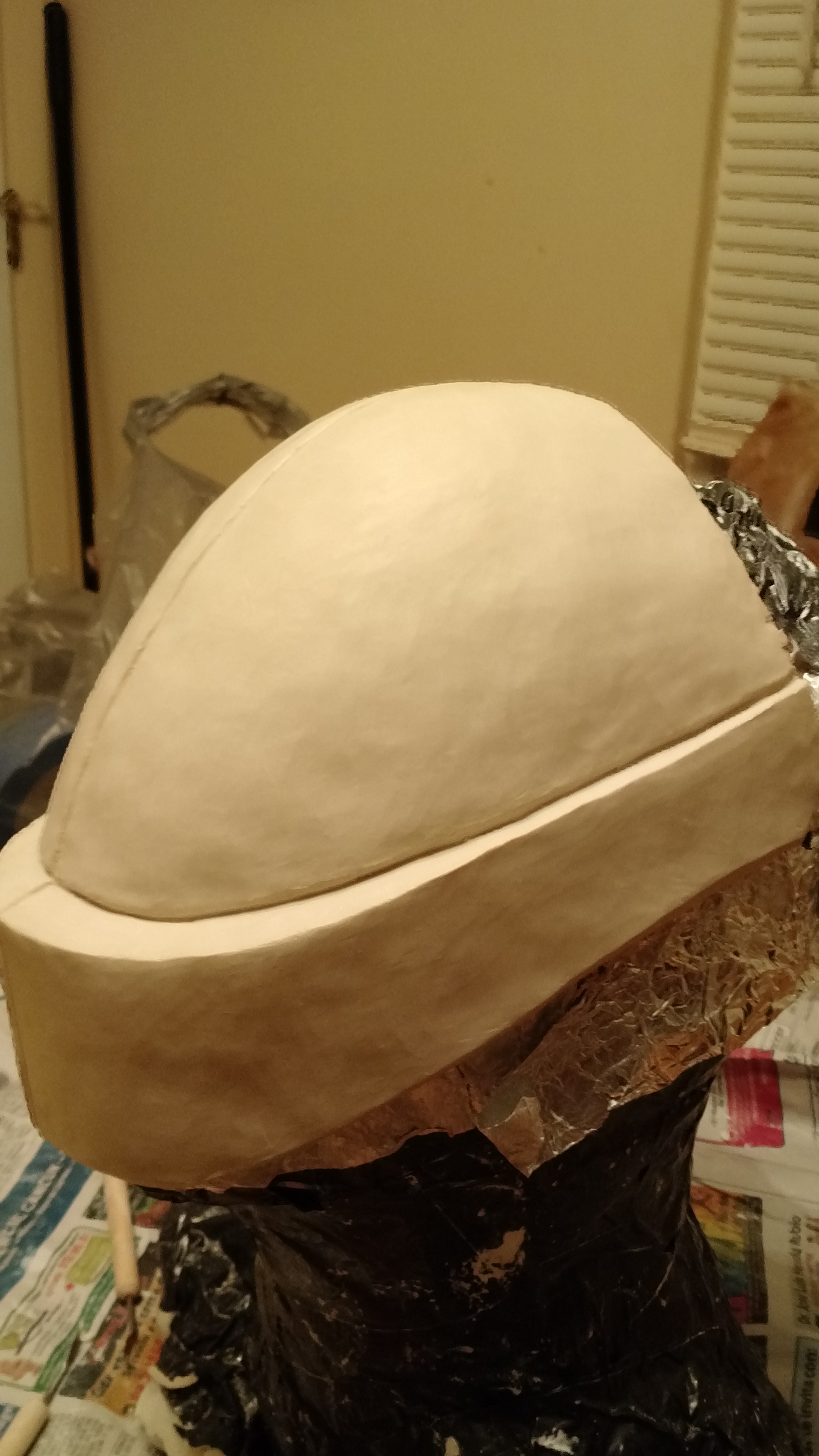

    Next I used abbydarkstar's duct tape body form method and let my wife and mother-in-law tape my whole head and face up while I was breathing through the body of a disassembled pen (now that's a trust exercise). Once they cut me out of that closterphobic mess, I taped up the seams and filled with expanding foam (I wasn't thrilled with the results from the foam and will do it differently next time...but it was good enough for now). With the head form finished the next step was to sculpt clay (I used crayola air dry...it is so so but super slow to dry).

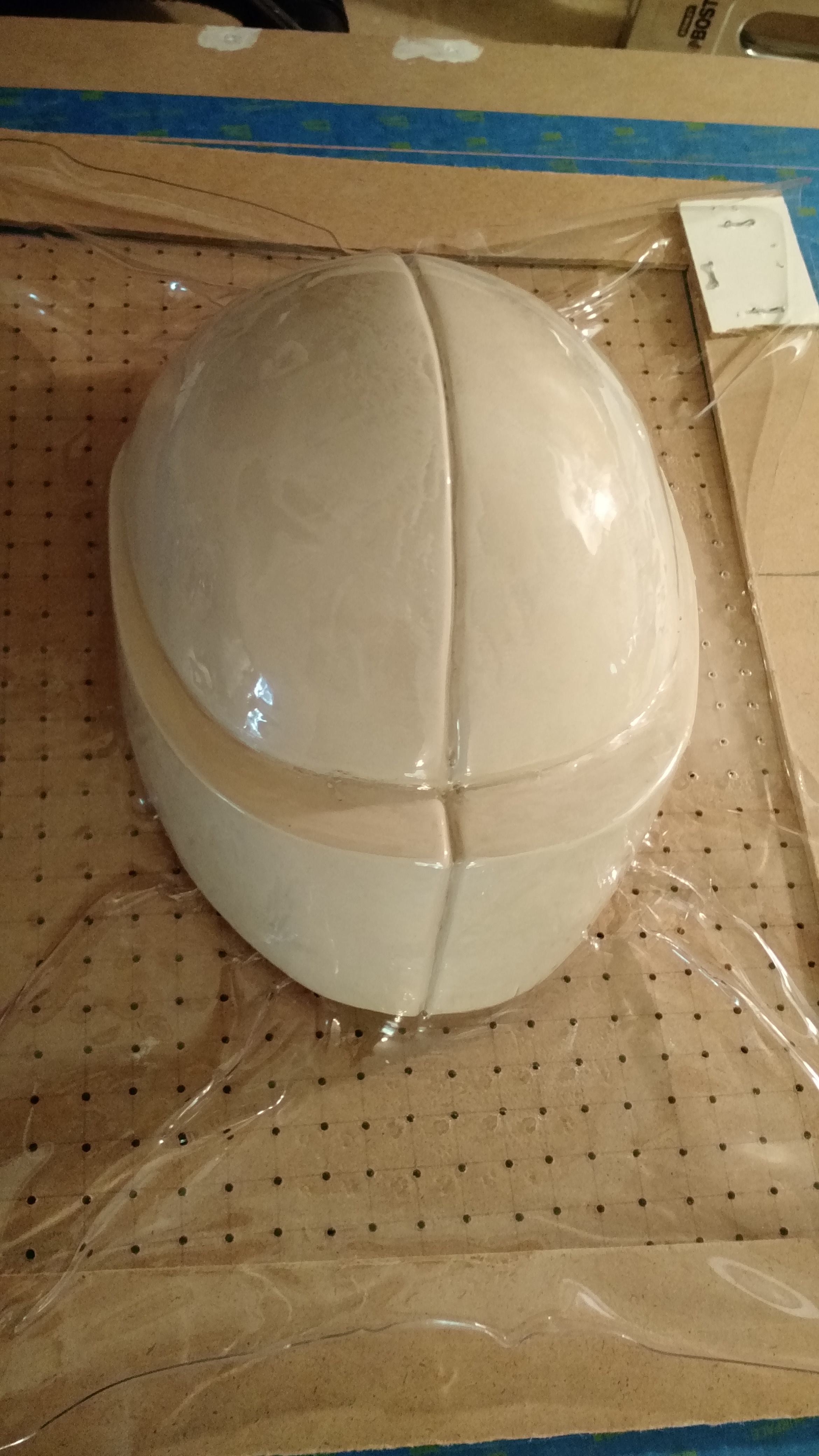

    As I said earlier that first buck shattered because it was hollow so I had to sculpt another (at least the second one went twice as fast!) Once I finished the second version I filled the inside with even more clay (hugely inefficient, I know, but I had the clay and I didn't have silicone and plaster for a proper casting.) Then it was off to the vacuum former. This step was met with failure after failure as I learned how to do this process. Bottom line is the right tool for the job saves a lot of frustration. I managed to pull one mold that was passable but I'm going for as good as I can do. I know I can do better so the mask is on hold while I build a proper heater and frame (and ups delivers me more plastic).

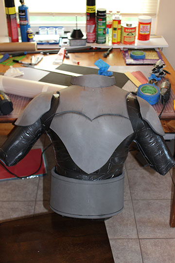

    As promised the Foam work:
    Ignore the duct tape, this is the first "test" fit. That will be replaced by nylon web belt. That EVM belt buckle will be replaced with a functional buckle cast out of alum alloy. I also have the thigh pieces and arm bracers (gauntlets) done too.
