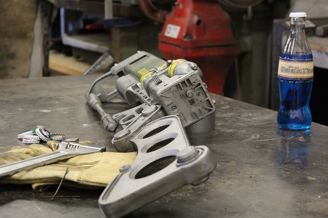

    After spending some time looking at all of the AMAZING things that people get up to here on The RPF, I really wanted to get involved and share with you guys the first replica that I built when I first got into model making - the iconic laser rifle from Fallout 3!
    I've tinkered with a few things in the past and have built some smaller items, however this is the first slightly bigger model that I have made from start to finish.
    The plans were created by Harrison Krix, which I bought from the shop over at Volpin Props (I wasn't sure how to create plans at this stage, and wanted to make sure I was building from some good material!)
    Whilst some of the details have been modified ever so slightly, the majority of the sizes and dimensions are based from the plans. I also used quite a lot of in-game stills to figure out how some of the parts fitted and worked together - I'll take any excuse to play Fallout again!
    Here are some hero shots of the final product, along with a fun pic of my mate trying to look like a Raider!

    Oh man, you did a great job! I've got to try this myself now. What materials did you use? In the build log of Harrison he said he used aluminium as well.

    Thanks! The body is formed from sheets of MDF with layered pieces of HIPS to add details - the more complex curved parts are made from foamed PVC sheeting or Delrin. All of the smaller components are made from aluminium to allow me to capture the detail in a more robust material; I do regret spraying over them and not using their natural colour!

    HIPS is polystyrene right? But what is Delrin? I'm from the Netherlands, it probably has a different name here :)

    Yup, HIPS is polystyrene :) Delrin is a brand name for a thermoplastic called acetal - I've heard of it being called Duracon aswell
