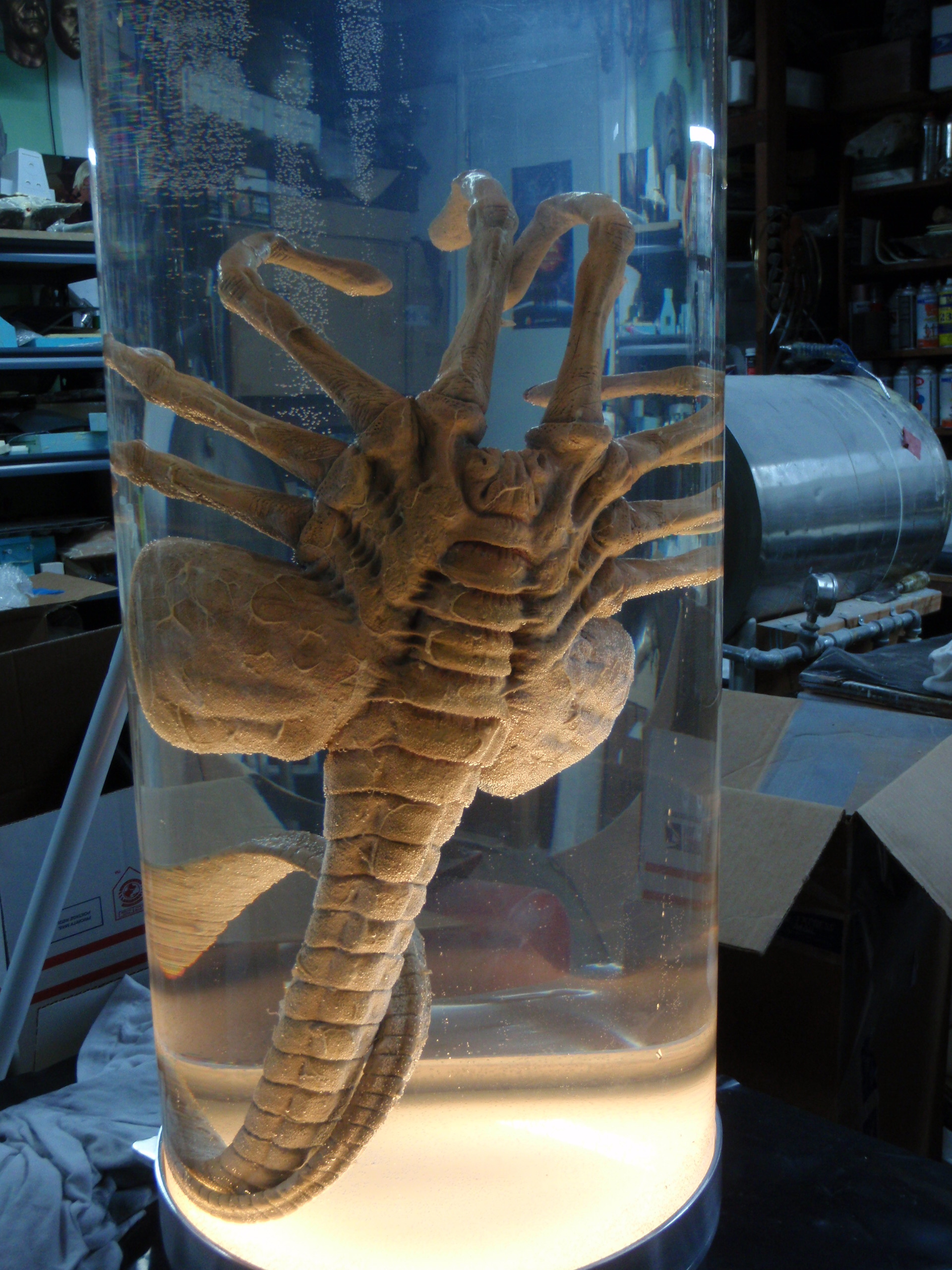

I am doing initial research and preparing to build a facehugger stasis tank. I want to build a tank that is 3/4 to full-size (depending on the facehugger I end up with) and filled with liquid. I like the look of the one in the image I attached. The facehugger has a gray finish and bubbles on the surface. It makes it look very authentic. I’m confident that I can (figure out how to) build an appropriate tank and enclosure but I have questions about the actual facehugger.
Does anyone know how long (or if) a latex rubber facehugger would hold up in liquid? Is there something other than water that I should be considering?

I built one years ago, used a Halcyon 1:1 facehugger which I coated with Envirotex clear resin to make it water proof....which actually worked. The only drawback to using this material is that it is a solid coating, meaning if you drop it, the coating might likely crack and/or break off. DO NOT put anything directly into water without some sort of water proofing! Even using just a coat of sealer won't o the trick, trust me! I tried it and after a few months, the paint job started to lift and peel off. The Envirotex worked great, you just can't drop it, but as long as you aren't taking the hugger out and playing with it, this shouldn't be a problem. :D

Those are great! How have the facehuggers held up?
Great info. So you painted it and posed it the way you wanted before coating it with Envirotex? It sounds like the resin locks it in position.
That is brilliant. I love the idea of a digital control panel. And bubbles for sure!
dropshipbob
Yep! Before I glued all the parts together, I made a wire armature and placed it inside to help the hugger keep it's pose, then assembled, glued ,painted then coated with Envirotex. I had the tube filled with water for 3 or 4 years with the hugger inside and only had a few areas where the painted started to lift....probably because I missed those spots with the clear resin.
RareBlueMonkey
That sounds like a plan. Thank you!

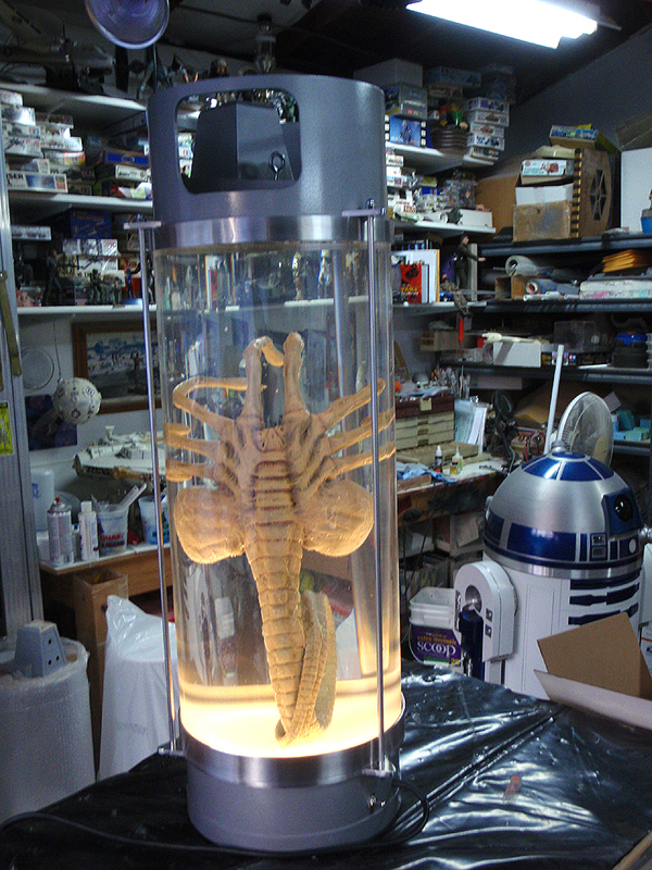

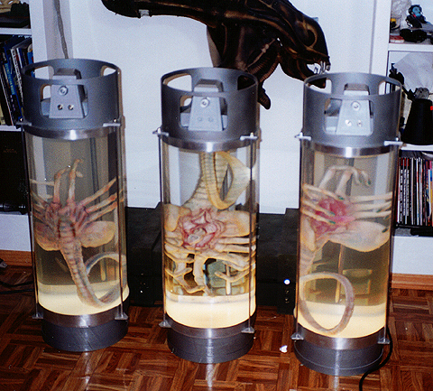

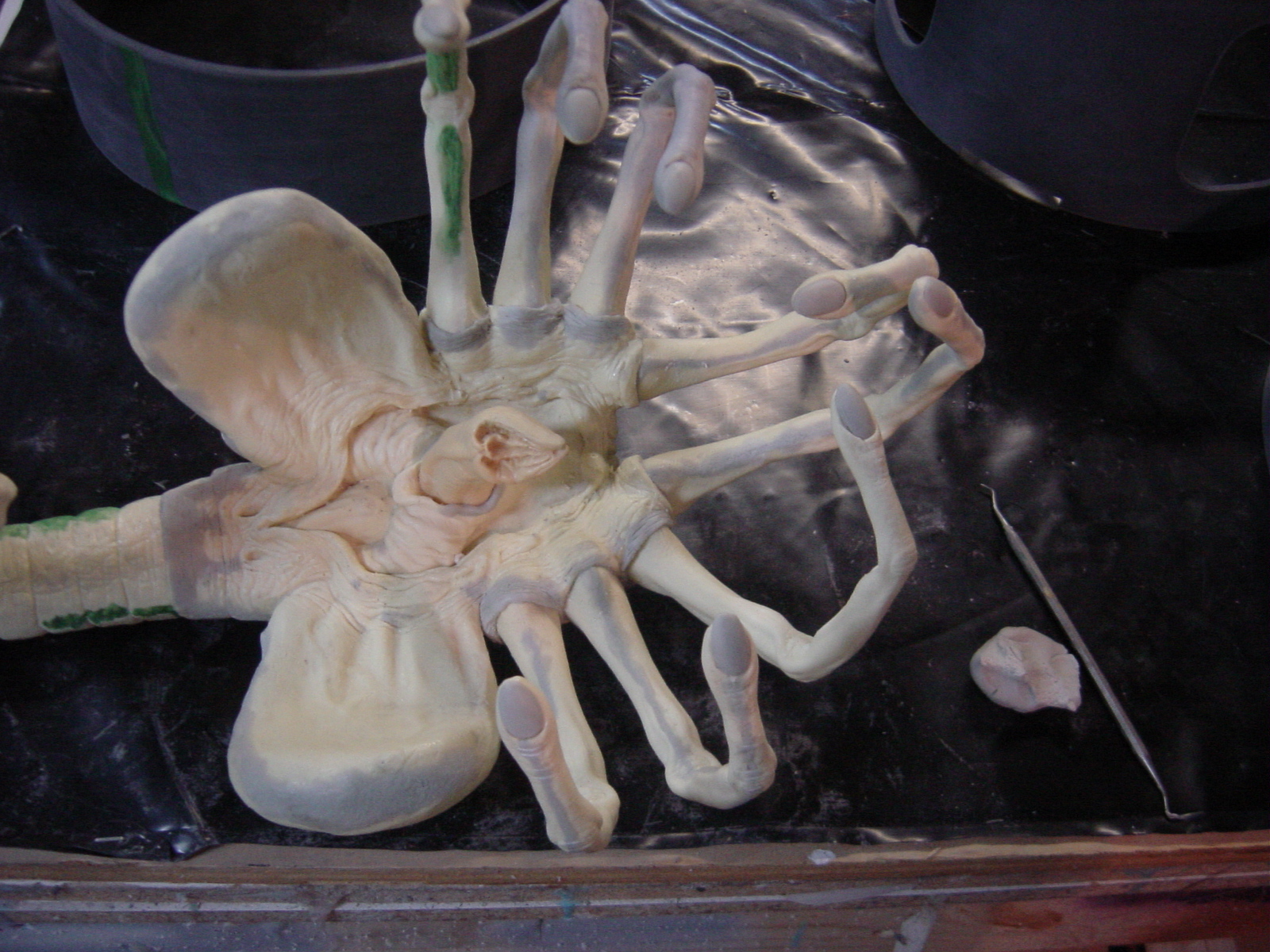

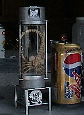

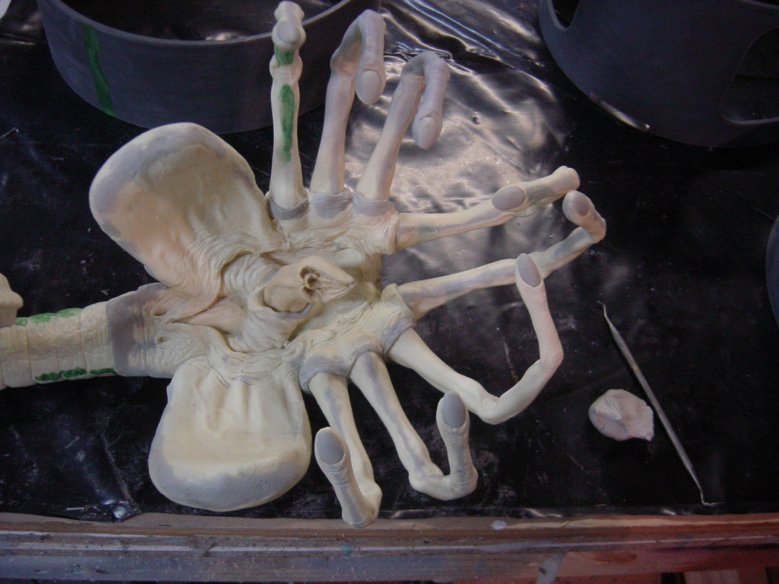

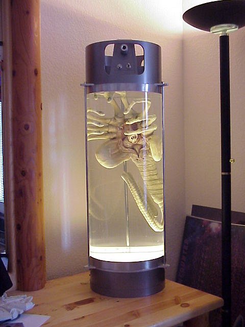

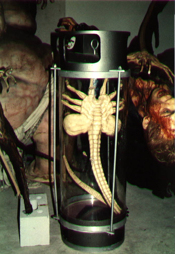

I had a mold long ago for the Halcyon. Made them out of resin...so they SANK in the TANK. also fixed the seams, Cleaned it up quite a bit.

Facehugger held up real well. But its mostly OUT of water....I dont keep it filled that long.
BrundelFly
Great work! Just curious, what did you use for the glass/plexi cylinder?
Thanks!
I had a cast acrylic tube ordered from a local plastics place. There are two types. Extruded (tiny lines) and Cast (Clear as glass)
They were gorgeous...but expensive. Any place that sells acrylic will have those. Long ago..I even sold these as kits.
Also did a few build ups.
