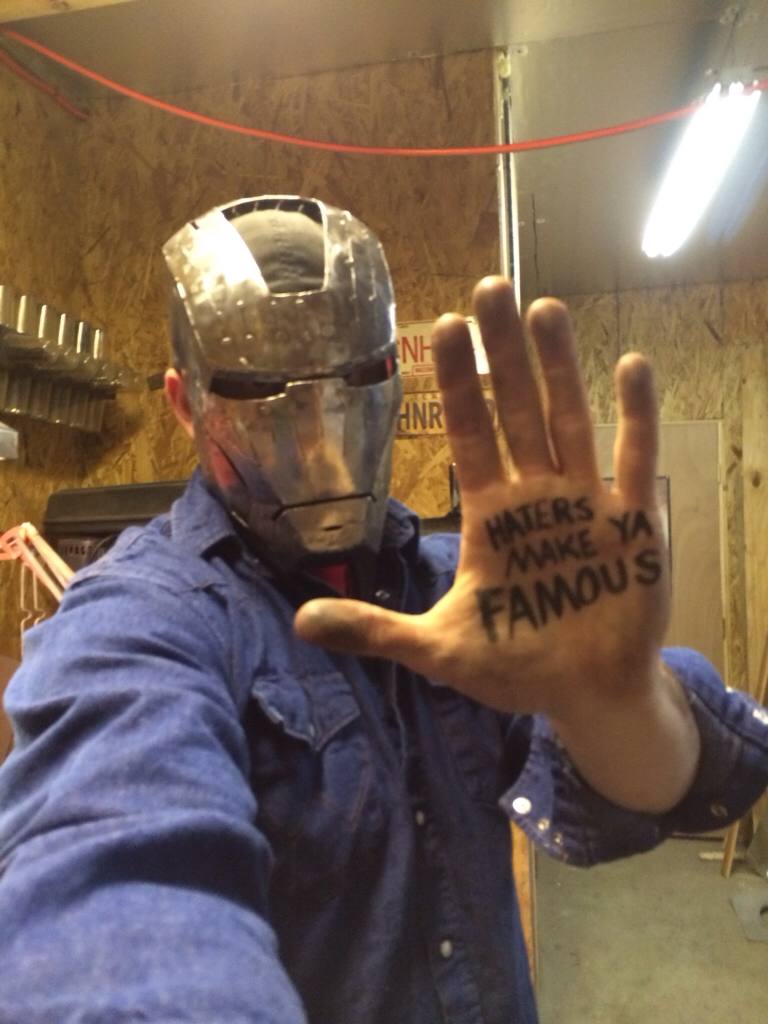

First off i'm really liking this build now that pics are up. But not to rain on your parade, the last pic of you wearing the mask. The angle i am looking at the plate appears to be large on your face, mostly at the bottom. That can be my perception from the angle but i would hate to see you go so far and then realize that it has to be redone...GM
Good eye sir! There are two reasons why this face plate looks so big. First is because this particular faceplate is actually 10% larger than the actual size, which was originally a test to see how the steel worked.
Second, the face plate looks extra big on the bottom because of the way that it is pressed against my face; the top is against my forehead and the bottom wasn't even close to my face lol. I tried to take a good picture but it didn't work very well. That's also why I didn't take the picture from straight in Front of me, with the mask being 10% larger, it made me look cross eyed in the face plate lol.
Thank you for the concern and the input!

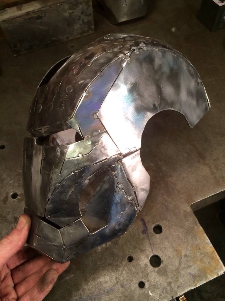

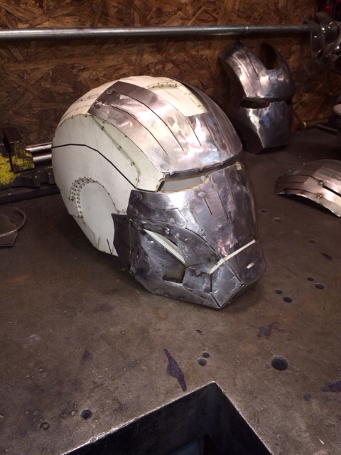

Here's a quick update on progress of the helmet. I wish I had a chance to get more done but with thanksgiving and my entire family and I catching the Worst flu virus ever; I needed a little time off. But I'm back at it now and was able to put a few more hours into it tonight. More pictures to come soon!
Crap i love it. Damn you lol. The only thing you really need to do is get a photobucket account so that the pics are larger...GM

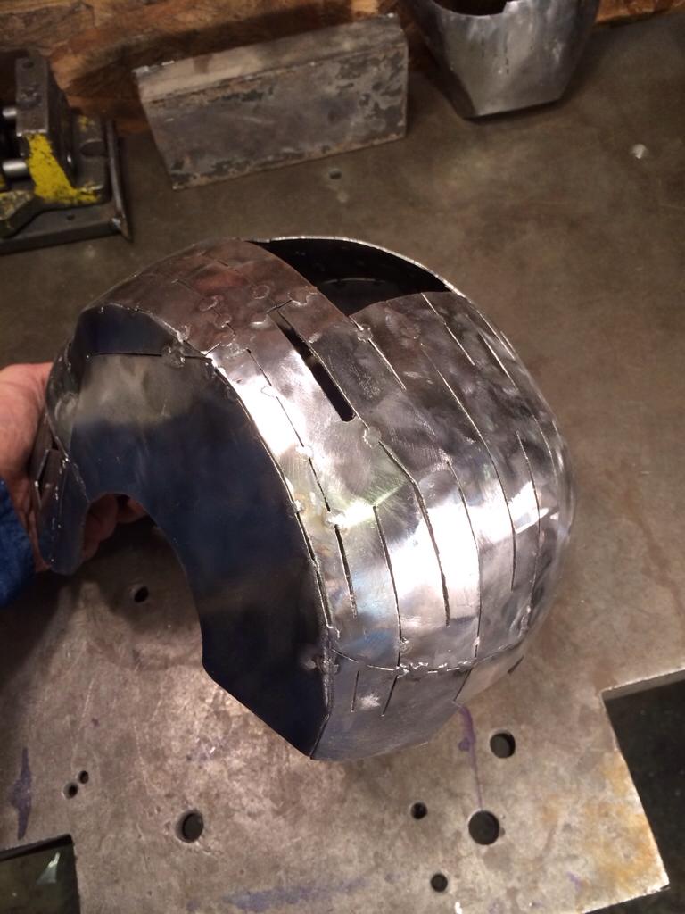

do you intend to get rid of all those seams by welding them shut and then sanding them or are the seams gonna stay?
Not answering for him but I'm sure much like the bondo stage of many peoples fiberglass pep's, he'll use some sort of filler in those seams to get rid of them.
The seems will all be welded shut and ground/sanded smooth at the end because the steel will warp with the heat from welding, and would be misshaped. I'll have the whole helmet tacked together before I finish the welding; that way everything will be braced by itself and will eliminate warping. I will then make it all perfectly smooth with body filler, high build primer, and sanding.
Yep, as a metal worker myself, this is a huge issue when welding sheet. The warpage is extremely hard to avoid. I'm guessing, even with all the tacks, you'll still get some warpage. I'm curious on the weight of the helm. I'm doing a silver centurion build, I got the foam suit from IM Nation which is awesome, but I will be replacing many parts with actual aluminum or stainless (maybe even titanium). So my build will be more of a hybrid of metal and foam. I'll be keeping my eye here though. Good luck

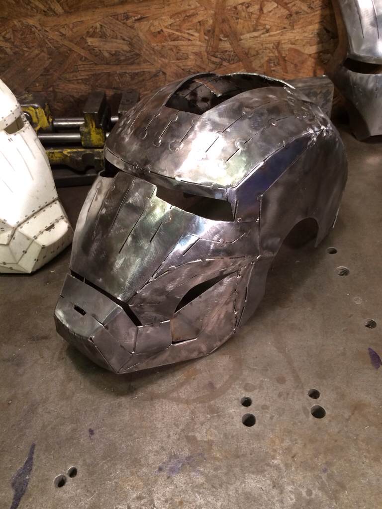

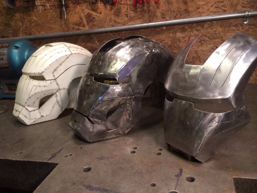

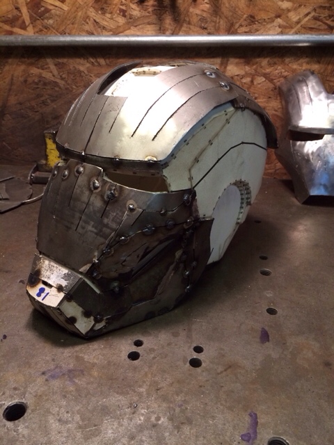

Got a decent amount done on the helmet tonight, and really pleased with how it's coming together. I'm really looking forward to getting it all welded up and ground smooth so I can start working on the fine details. The helmet fits great so far; can't wait to get it finished!
looking real good dude.. is it starting to get heavy?
Thanks! its really not that heavy at all. the only thing I could think about comparing the weight of it to is a football helmet while I had it on my head, but even then it still wasn't even close to being that heavy. im sure once its all together and done; it will be just like wearing a football helmet which in my opinion isn't that heavy lol
