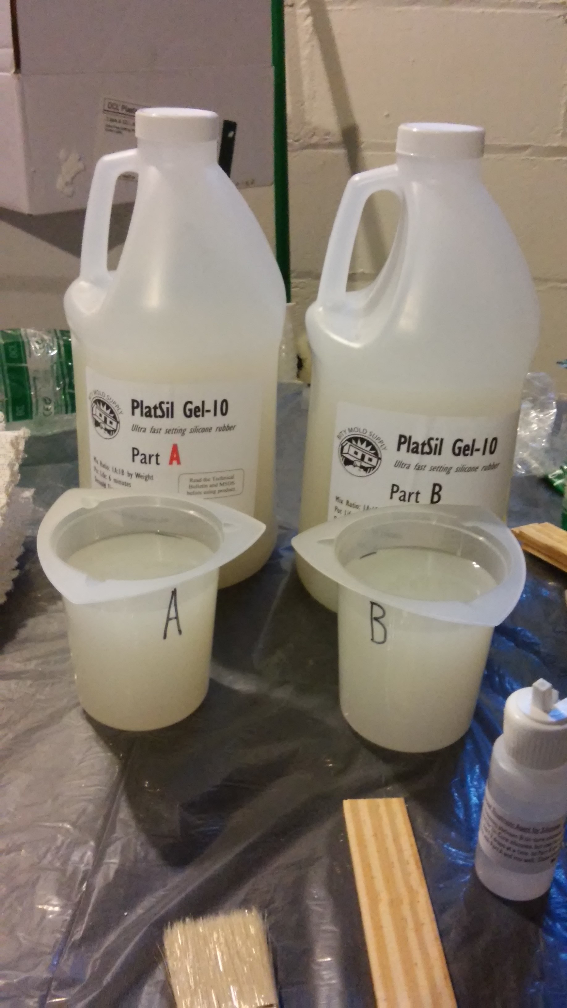

So, this:
You can see I am covered liberally with large amounts of Vaseline. When I purchased the Vaseline, I made sure to buy enough. 5 jars. The cashier looked at me funny... I didn't bother explaining.
The video I purchased blabbed on and on about the importance of covering up the hairy areas with liberal amounts of petroleum jelly. Eyebrows, eyelashes, nose hair, you get the idea. Bla bla bla... let's get to covering my head with gel 10!

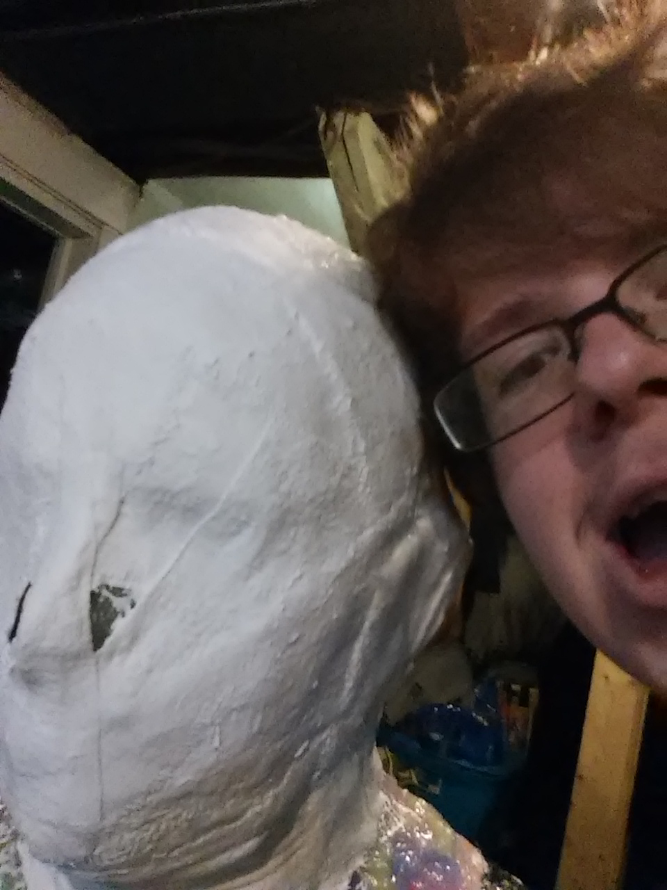

Finally, gel 10 has cured, and we begin removing the plaster mother mold and the cured silicone from my noggin. Came off pretty easy, until we got to my eyes.
Let me pause here and state, no, overstate the importance of liberally applying the Vaseline to the hairy areas. Everything else was free, but my eyelashes. I was stuck, holding a silicone mold, which was pulling mightily on my eyelashes and eyebrows.

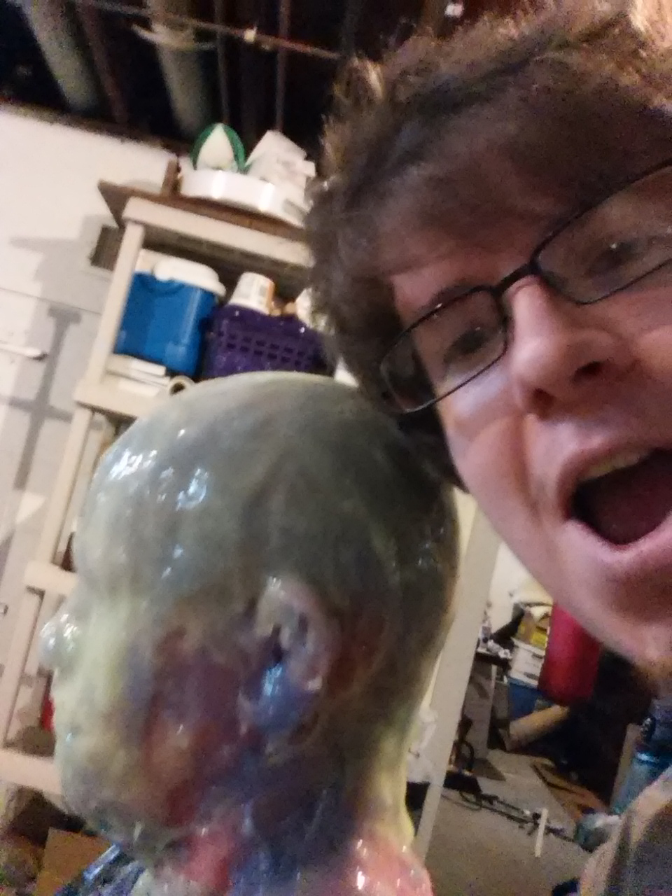

Later that night, I decided to create a resin copy of my head. It was hollow, but I figured that was a close replica of my own head.
I had plugged the nose holes with gel-10, and figured I was good to go. I mixed three batches of resin and slush casted them into the mold.
TIP: Wear gloves. I am still picking dried resin (bonded to my skin) from my hand.
It was very difficult pulling the resin from the mold. Apparently there were several holes that I never saw, the resin leaked, which bonded with the plaster, effectively ruining it. I could hear the resin cracking apart, and eventually I said screw it, and yanked it from the mold.
Here is the result of the resin head cast:

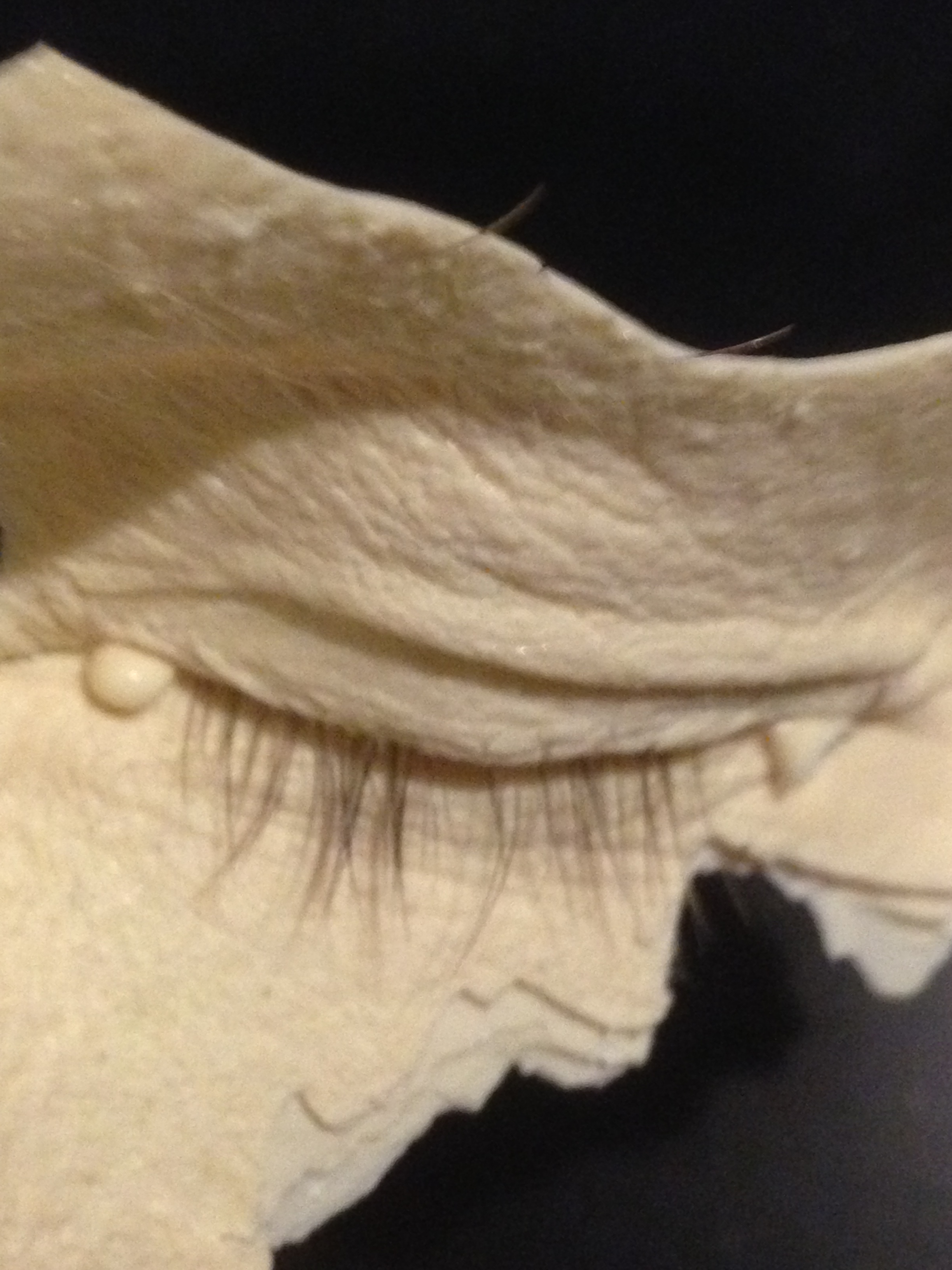

My EYES! Lacking in the eyelash department. I had a lot of them anyway.
LiBErAL amounts of Vaseline was applied, in fact, when I blinked, my eyelashes stuck to my face! Lots. On the upside, that is quite likely the most accurate eyelash placement in the world. You can't find a makeup artist to create that kind of work!
