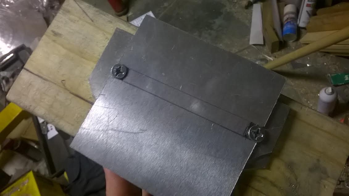

Start off with a flat sheet of aluminum bigger than you need (because smaller would just be silly).
Screw it to some wood. Next use a hole saw to cut a hole out of the aluminum and wood hammer.jpg

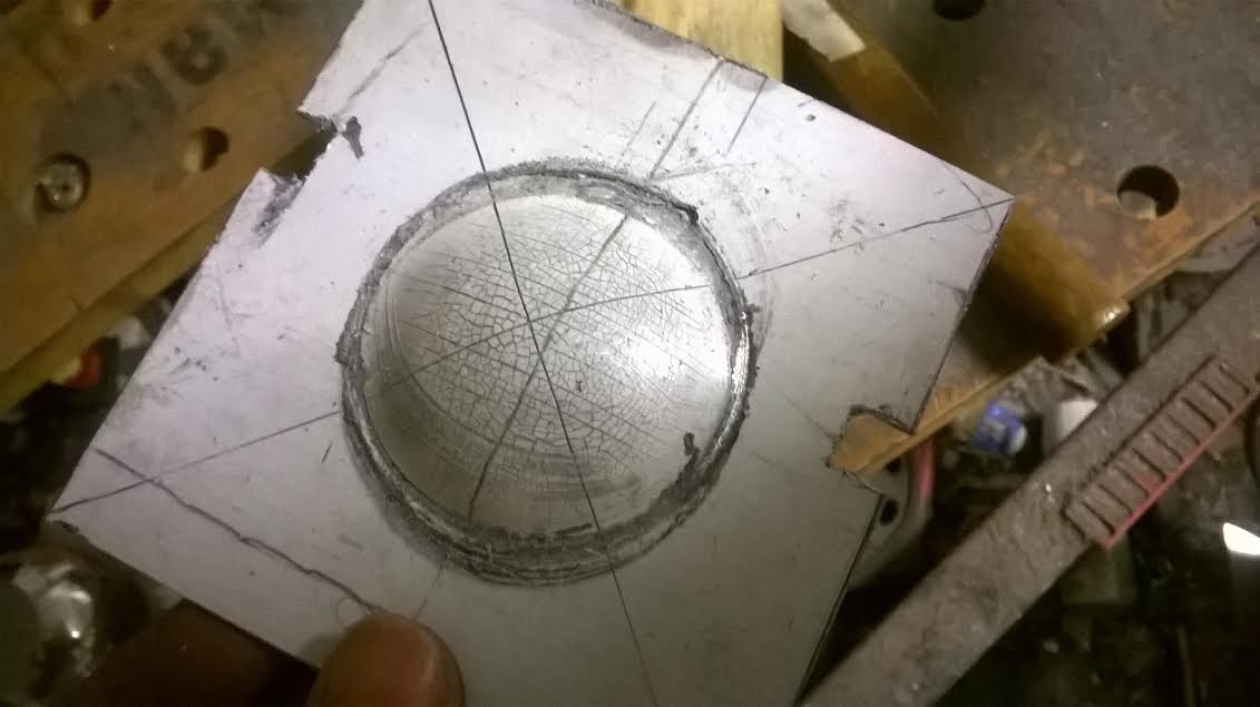

Next, place the shiny, perfect, happy, untraumatized sheet of aluminum against a trailer ball hitch that is anchored.
and SMASH IT! Beat it with a hammer on the opposite end! Rotate it around! Yell at it! Call it names of people who mistreated you!
Okay, not really

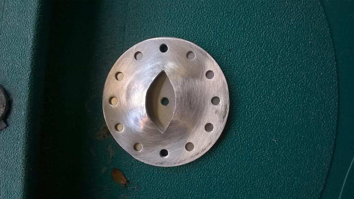

As we last left our adventurer...

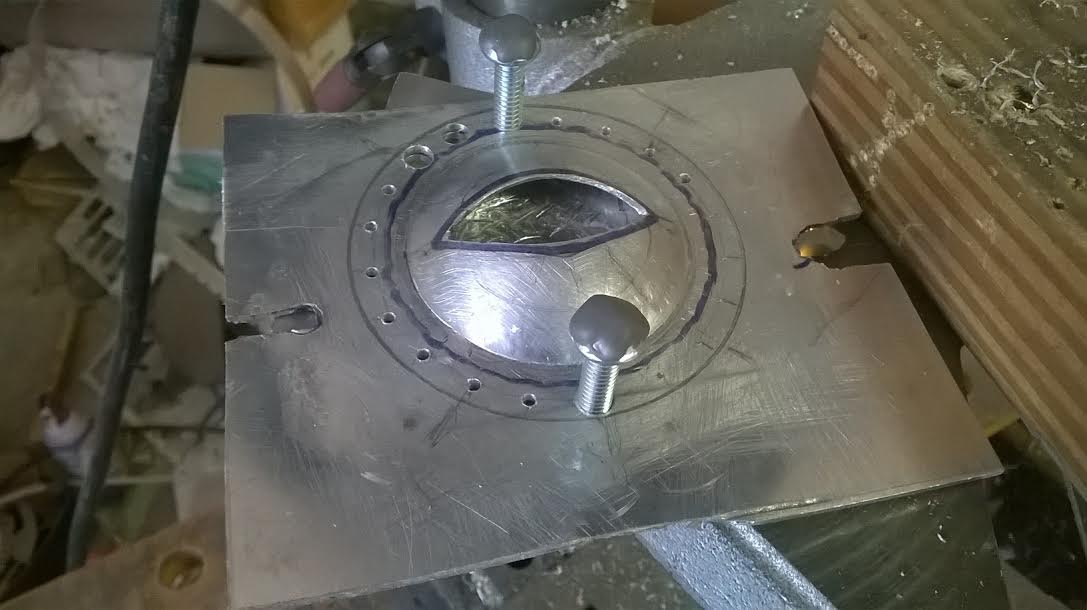

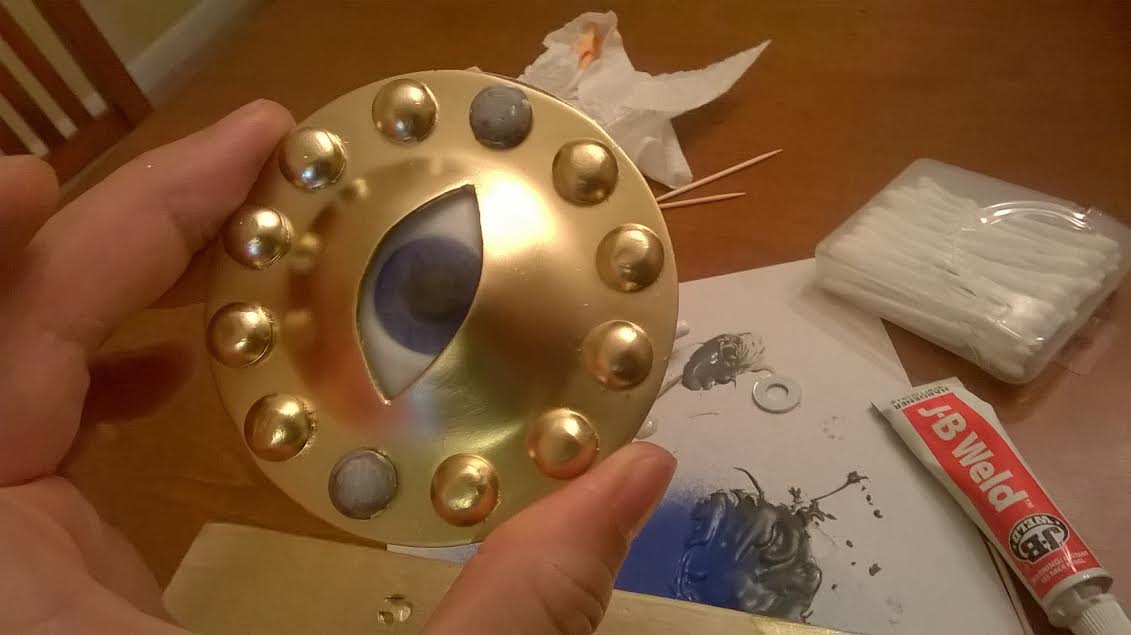

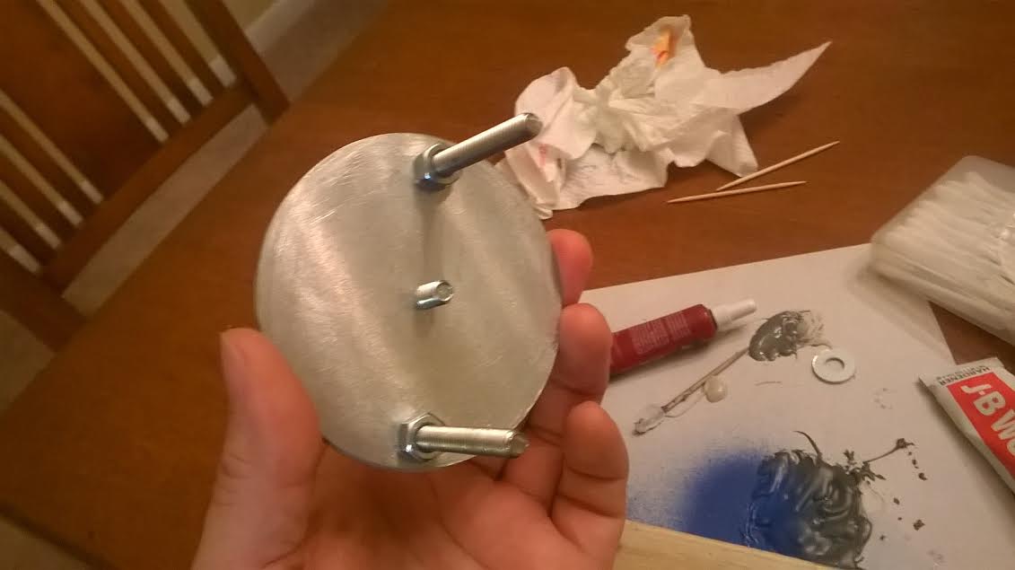

After making a circular backplate, I used a 1/4 inch bolt for the back, then drilled out the treads to place a circular bead of JB Weld.

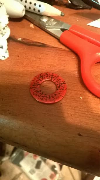

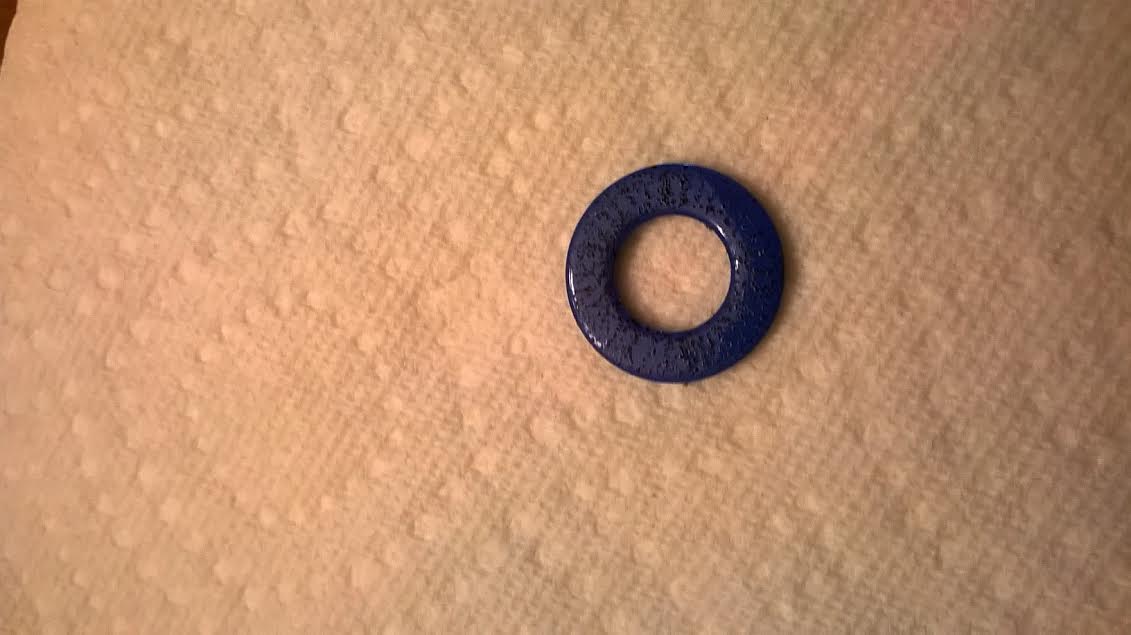

The iris is a 5/16 washer, painted blue then dotted with india inkiris2.jpg

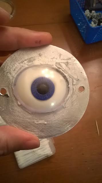

Then samiched the eye between the rounded and flat plates, bolted them together. NOTE : I threaded the aluminum for the 1/4 inch boltsboltedsee.jpg

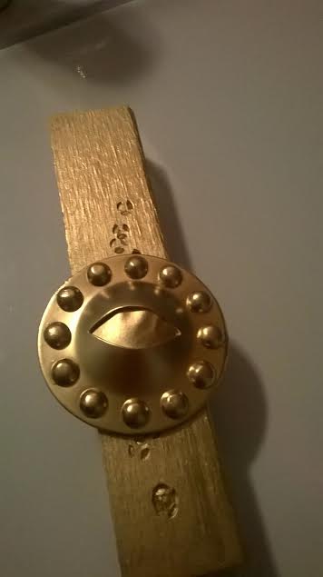

I had done a test run of gold paint before bolting two pieces togetherbolted.jpg

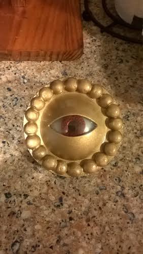

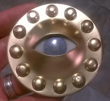

Shave down the bolts, cover the eye, and pain away!boltedshaved.jpgpainted.jpgDunecrop.jpg
same technique, made a red iris'd onedrilled.jpgdrilling.jpgiris.jpgeye2DUN.jpg
EDIT: Except used a hemisphere doorstopper for white part of eye
