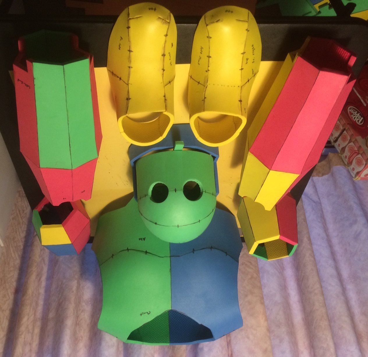

Hello,
For sealing my EVA foam on my upcoming Iron Giant I’d like to use this for sealing at least, and possibly also mix it with a tint (such as those used with latex paints) on a 2nd coat for paint job.
I’ve brief experience using this to fix cracks in foam only. I expect to use disposable gloves and finger-smear some as follow up if brushing it on?
Here is a progress shot of my Iron Giant, for use this Halloween. Loads of work before painting stage, but want to get the method lined up in advance.
Any tips on applying this to heat-sealed EVA would be appreciated, thanks!
