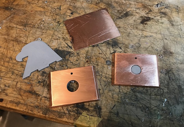

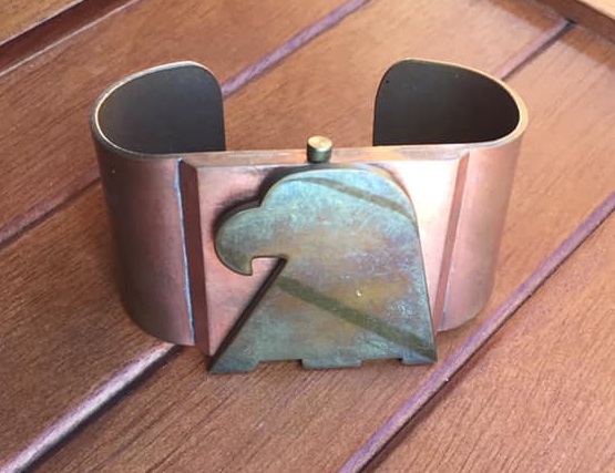

The bracelet is a harder one to tackle. Rylo will not ever be revisiting his version (I asked) so this weekend I got out the old hand tools and started tinkering. The difficult part, when you don't have a mill, is the copper 'box' containing the spring/trigger mechanism. I've got a working idea of how I can do it, using copper sheeting and a3d printed 'base' to sculpt around.
Here's a quick test I did using both 0.5mm sheet and copper tape. Both are viable, but I think the sheet will be easier. I'm a bit undecided as to whether I should make it a perfect square or a rectangle. Fan versions I've seen have been symmetrical, but I wonder if the screen used isn't slightly wider than tall.
The bass eagle and copper arm band will be made out of 2-3mm sheeting. Trying to locate a small supply right now, but in this day and age, buying small quantities of metal is nigh-impossible. I'll dremel out the eagle by hand, unless I decide to do more (which I might have to due to the cost of metal) in which case I'd look into having the eagle laser or water cut.

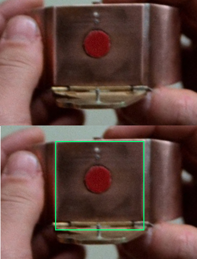

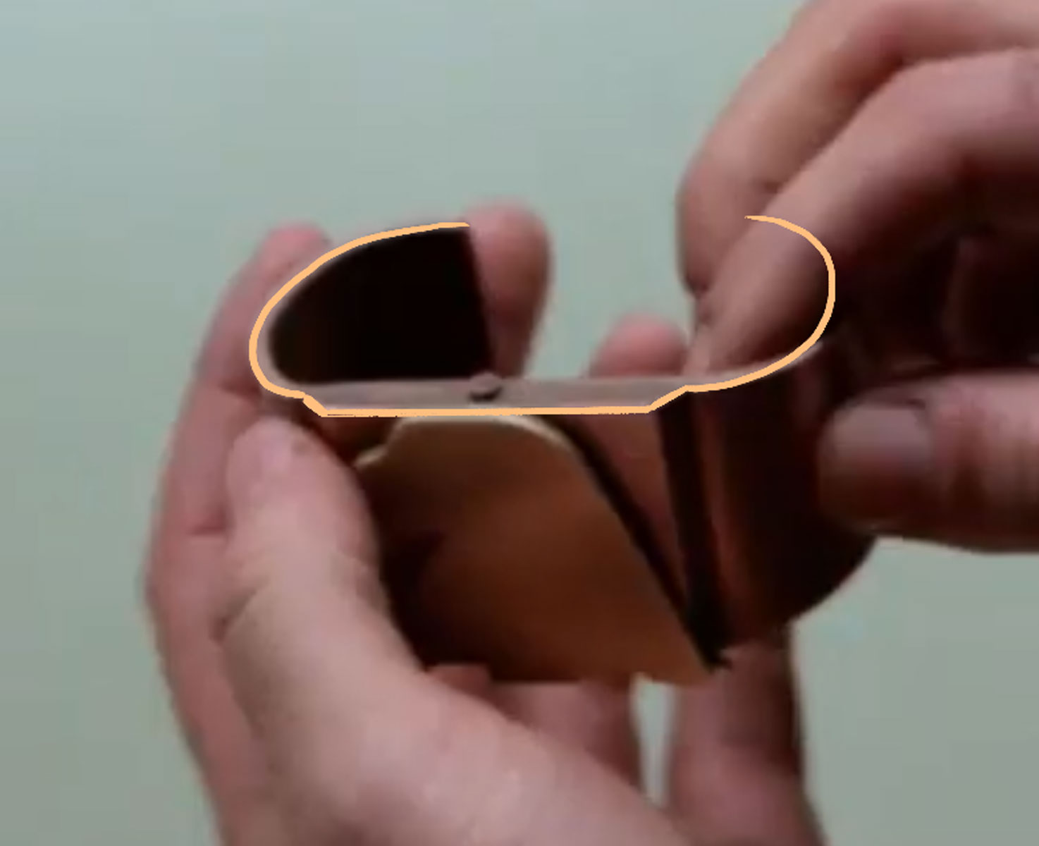

I keep watching the shot where Snake flips the bracelet open. At the moment, I'm not convinced that the screen used version is spring-loaded. To me, it looks very much like Russell flips it open with his thumb to make it look like it springs open. After it hits full open, it starts to spring back and you can see Russell quickly catch and stabilize it again. I also can't see any trace of a spring arm. The pin doesn't have much of a groove to latch either; I suppose it could be a friction latch, but would that be strong enough? (Note also the little curved 'tail' sticking out from the hinge to the right, near his thumb.)
Check it out:
JOATRASH FX
And look here:
Definitely not a perfect square!
I wonder if the little grey metallic dimple between the pinhole and the red button is itself a pin, designed to push up the eagle from underneath as an SFX gag? When Russell activates the flip, it looks like he exerts quite a bit of force.
Where the copper strip goes across the top with hard bends and the box is made from a strip across the void on the back?
Hard to tell.

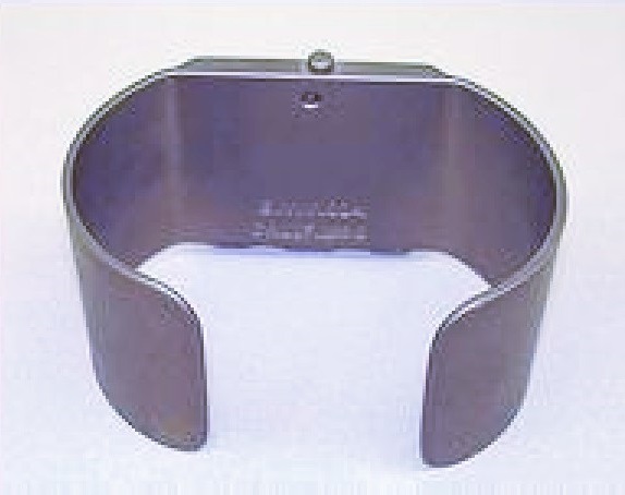

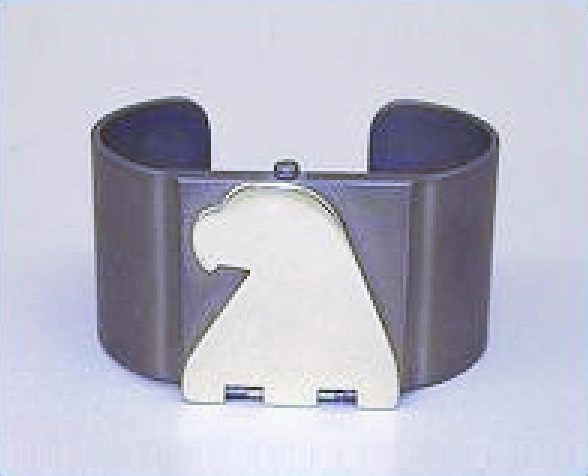

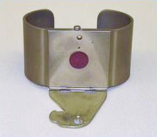

This is supposed to be a photo of the screen used bracelet:
The bottom of the eagle, with its asymmetrical cutouts, seems to match the one Russel is holding. Here they soldered a block of copper to the armband strip.
I'm also fairly sure that the little grey 'nub' is simply to level out the eagle so that it doesn't accidentally press the button. (The eagle doesn't sit flat against the copper- note that the hinge attached to the block is slightly raised!) Nice attention to detail by the prop maker.

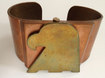

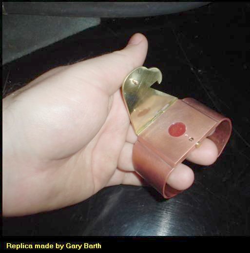

Gary Barth, I believe, was the first one to tackle this project. He made it with a spring-loaded eagle that popped out (like in the film) when the button was pressed. Still have mine somewhere. --Ed

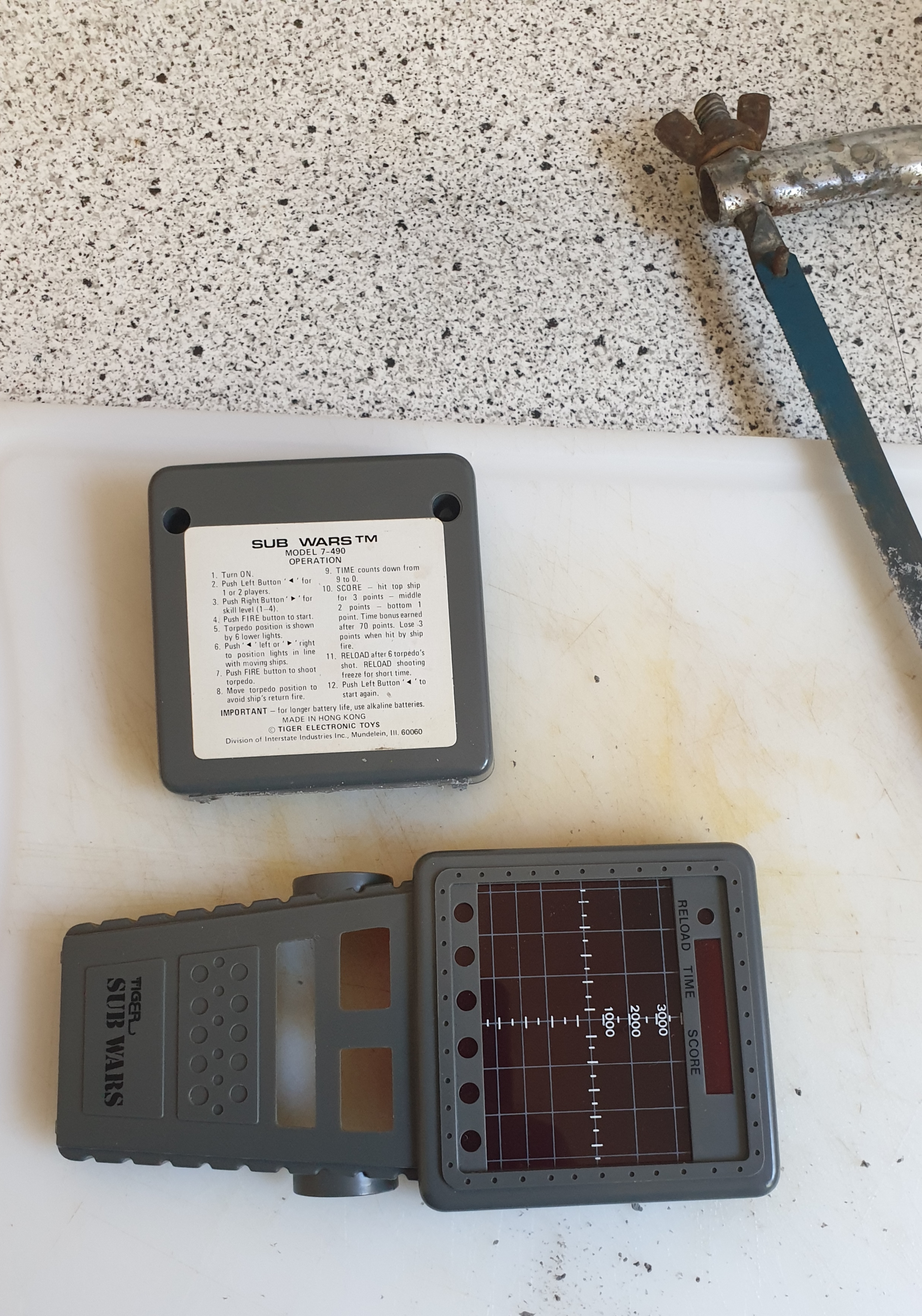

Did y'all hear that screaming? That was the sound of a thousand collectors of vintage electronics as I took a razor saw to the Sub War game and cut off the handle!
Found some photos of Gary Barth's replica. --Ed
Nice to see previous versions!

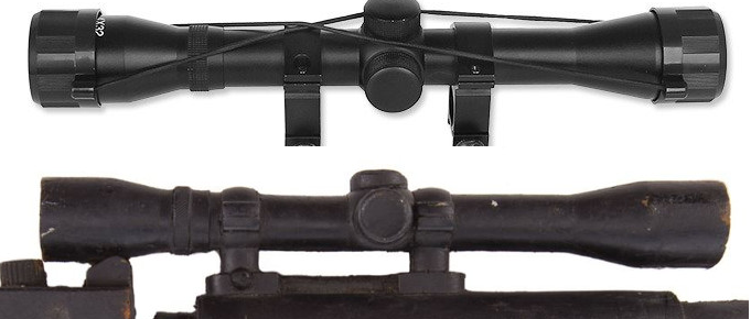

I got the scope today. It's an ASG Strike Systems 4X32.
Here's a comparison with the screen used:
https://actionsportgames.com/
It's off in a few places by a couple mm here and there but I can't imagine anything else being as close unless someone finds a vintage copy of the real scope. This is one of those instances when I think "close enough" really is satisfactory. I'll be making the mount for it myself.

Last night before I went to bed I cleaned off our dining room table.
I pulled out my sub game (still in the damn box!)
Next to it sits my Dremel.
Next to that sits my files.
Next to those sits some sandpaper.
And next to THAT sits a bottle of bourbon and a shot glass.
When I get home there will be some tough choices to make!
septic
I too have an original Sub game (complete with box), which I bought specifically for a Snake costume, buuuut damn, I'm loathed to cut it up ...

I kinda stalled on this a bit. Did some calculations on doing kits and... if I did a run on these, printing the box/shell alone would cost a couple hundred (at least, with casting not being an option), and the electronics just as much, putting a kit at around five hundred bucks. I don't think there's interest enough to do it. Maybe just an electronics package that will fit the real subwar shell?
Also did a bunch of work on the tracker bracelet. The brass and copper I got doesn't want to take solder at all, which is odd, and I needed to get some thicker stock for accuracy (the eagle is about 3mm). I ordered somepieces from a place in the UK, but they haven't arrived... so now I have to file a claim or see if they will actually send them. *sigh* I do have a guy that might be willing to machine up a few copies of the "base" of the bracelet- I just have to arrange a proper CAD file for his CNC. (I have a working design for a 'lock' that will hold the eagle in place, but I'm not counting on having it spring loaded unless someone can prove to me that the original actually was.

Well, then I made the right decision.
I converted mine.
