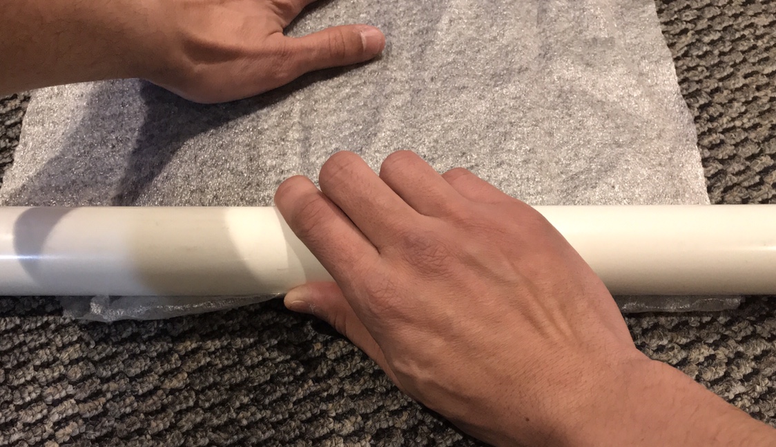

Rolling the pole with 1 hand while keeping the fabric tight.. let me take a picture to improvise ;)
This is how I roll it Tom
This way too by doing small increments of rolls you can stop it from over lapping

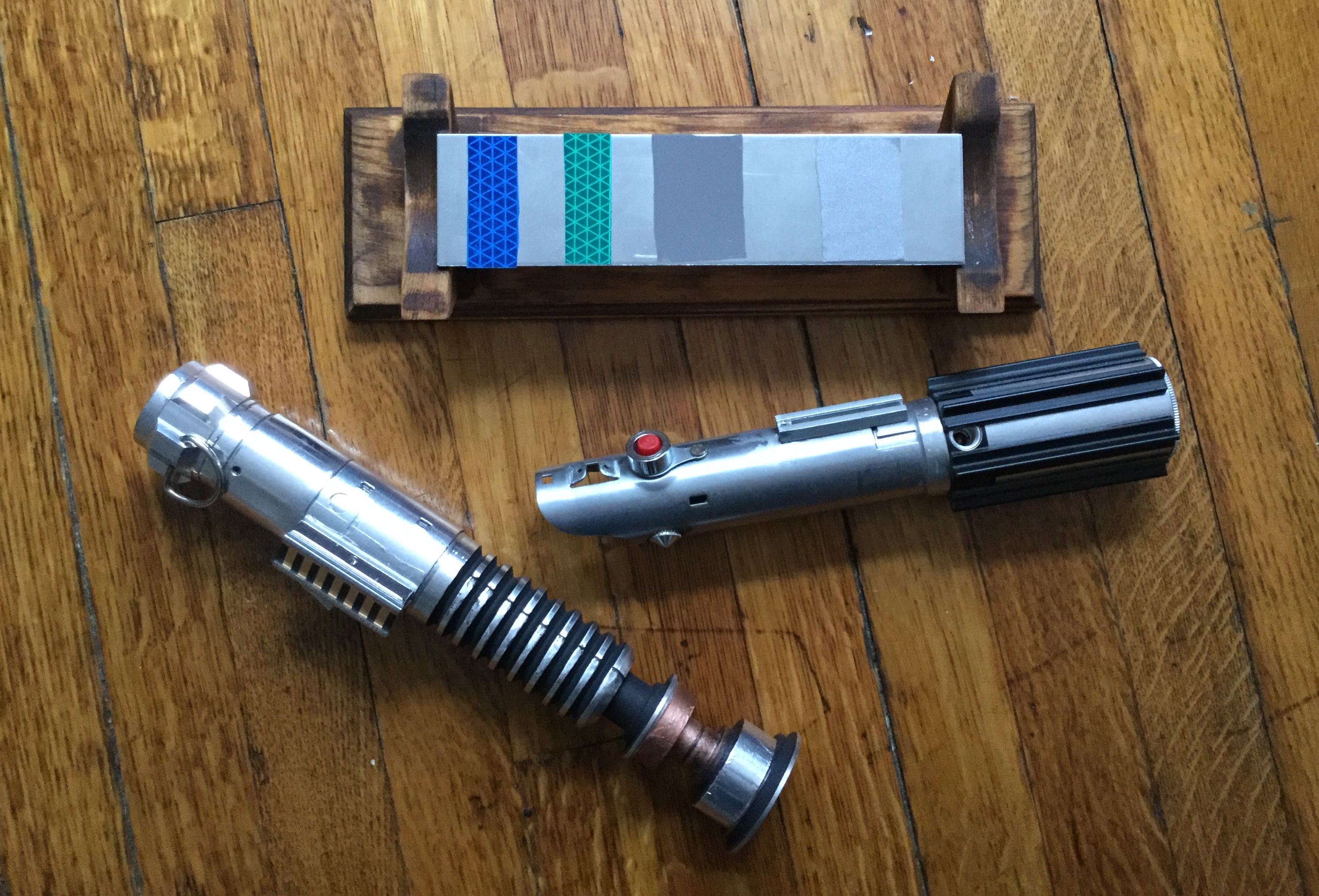

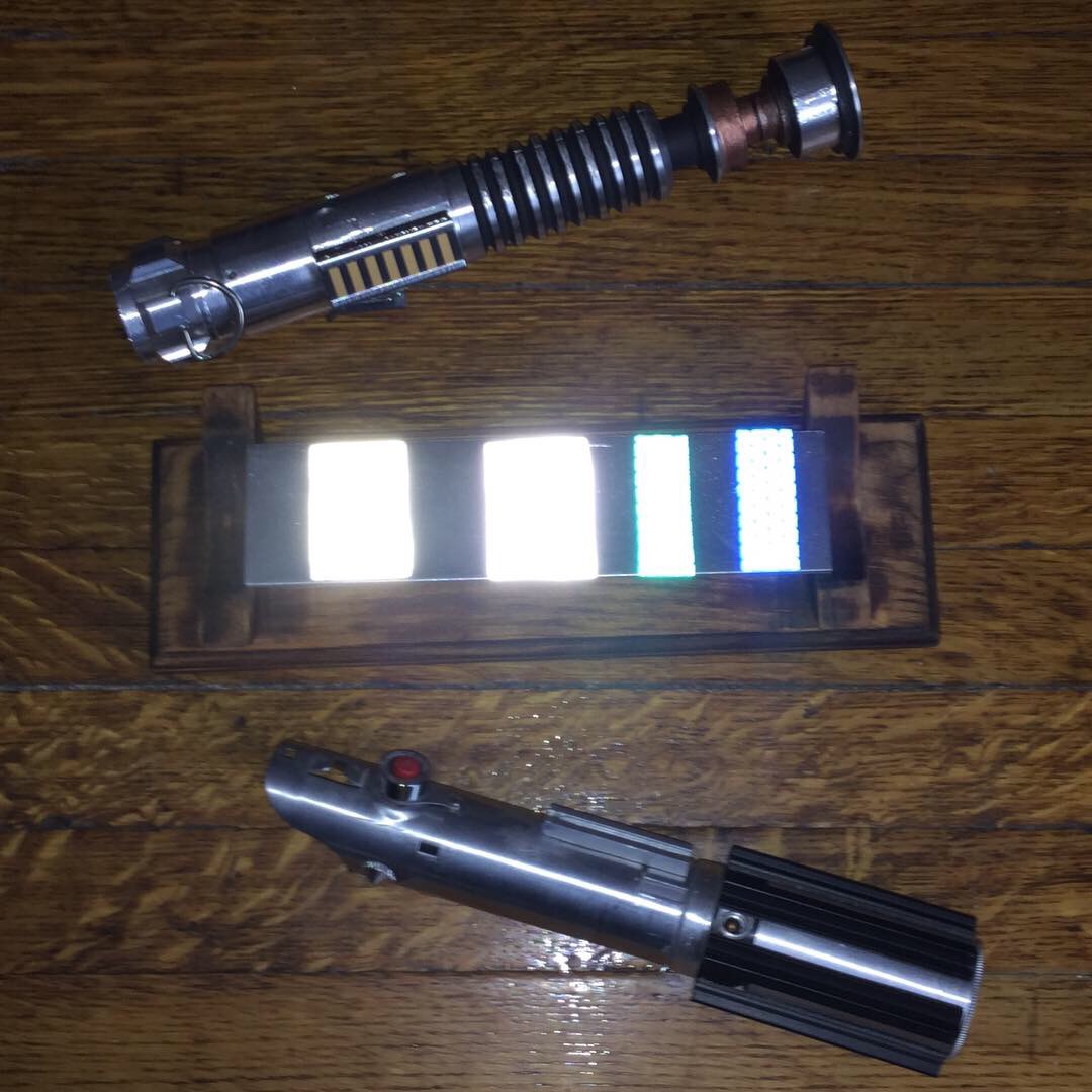

I glued pieces of the material I have to a piece of aluminum for comparison

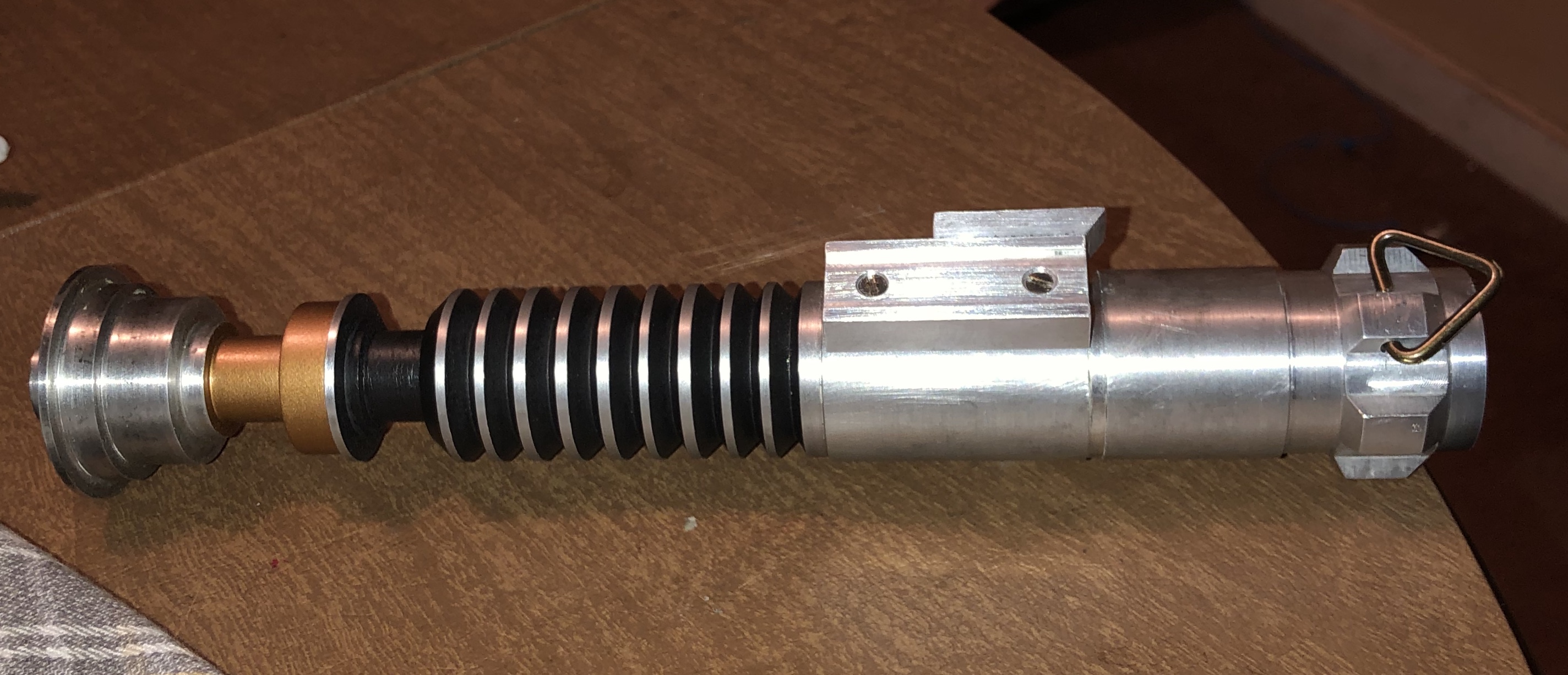

Btw, I LOVE your V3 and Luke Kobo-flex Stunt! Is the V3 one of Dan's build kits? And what did you use for the copper neck??
I guess I wasn't shaking the can enough too :D
and thank you! That is one of Dan's builds, the neck is copper paint and then ruby rub n buff over it. Doesn't feel quite yellow-y enough for me, but some of those photos out there are altered. I'm especially a fan of the luke hand saber. That socket is an old replica blade socket and it shattered, so the socket is packed with putty and it has an old metal film canister lid where the socket pin is. funnily enough, the glass eye port is filled with putty on the real thing, so until we ID that part, its more accurate than I imagined.
Great thinking with the display of Scotchlite!

And Thomas, thank you! Ruby rub n buff, that's the secret ingredient! Must go get me some. I did find a pretty good looking copper in a spray can at Ace. It's Ace brand. I'll edit this post with the name/number, in case anyone cares!
I know what you're saying about the reference pics. To me, it looks really red in some, especially that one where a guy is holding it next to the Hero. So that's what I'm trying to achieve.
Me too, I think thats why I went that way.
There is an Ace copper or metallic (?) spray paint that looks VERY close to the Hero ROTJ color. Anakin Starkiller put me onto it. I used it for my Yuma saber
