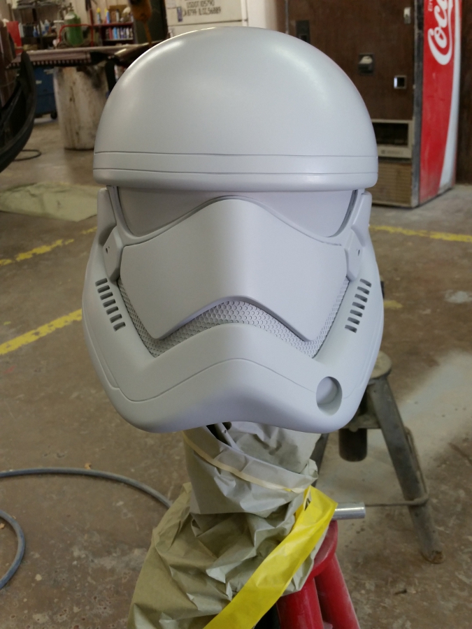

    Thought I'd share with you guys the first big project I've worked on since I've started propping again.

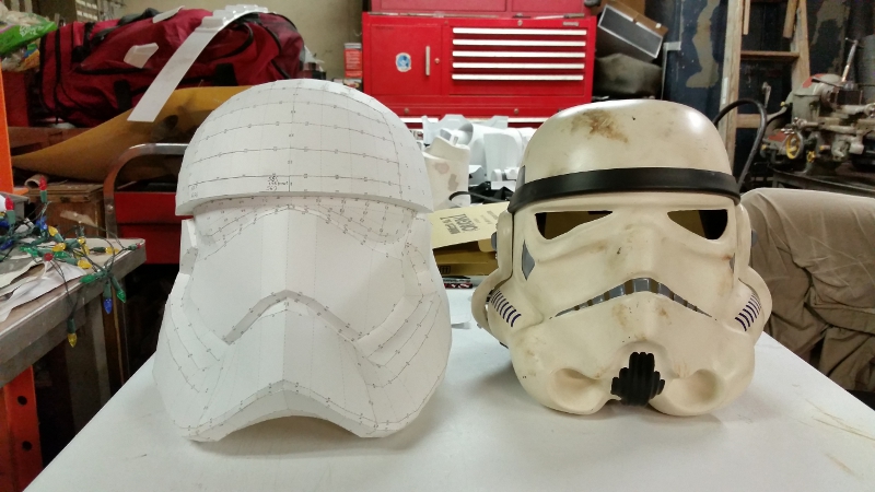

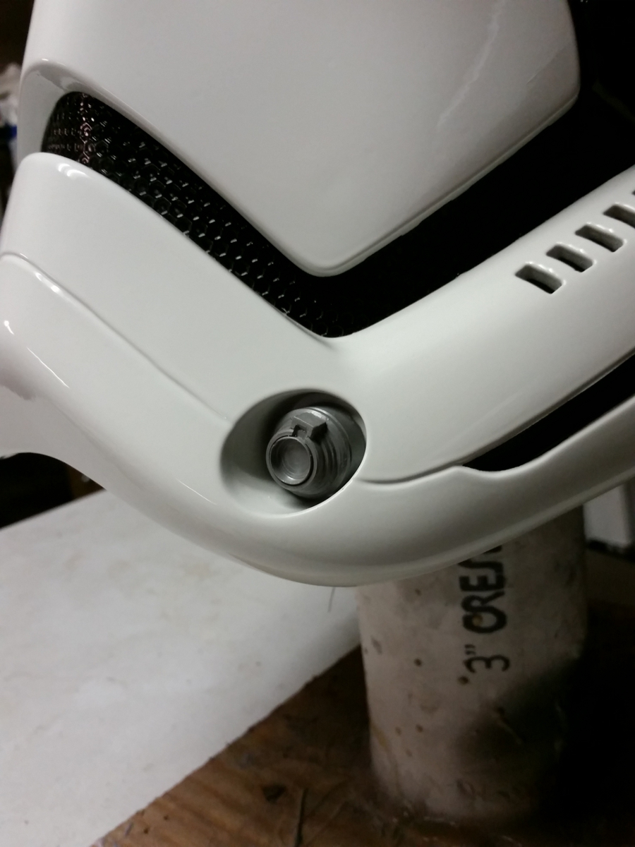

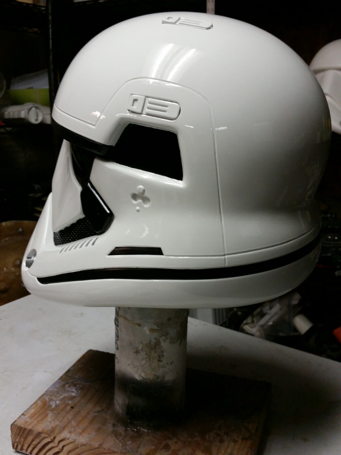

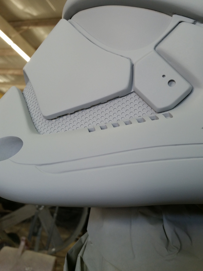

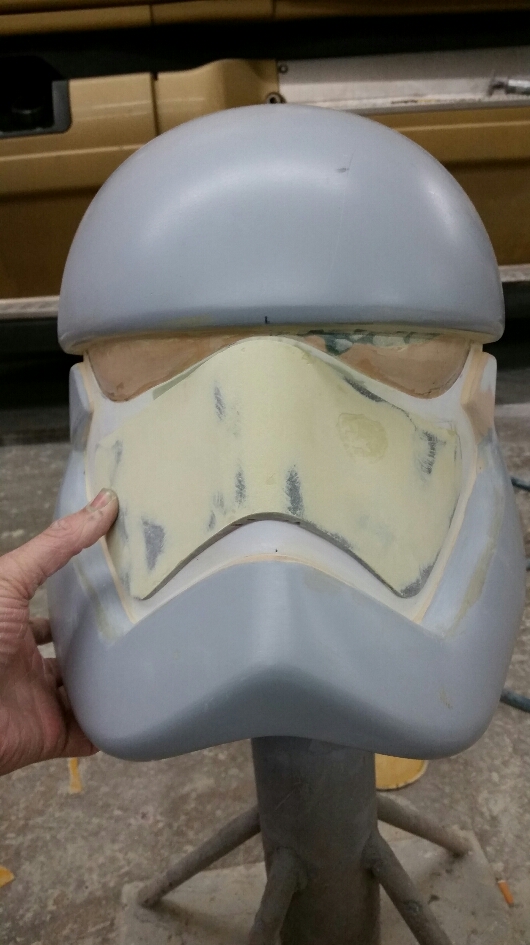

    The weekend of Celebration when all of the photos of the new Stormtrooper hit, I HAD to have the helmet. So I've collaborated with @amouro to crank out our own. I sent him every photograph I could find and he worked up a 3D render and converted it to pepakura. Once that was built, fiberglass'd/rondo'd and refined, we made an intermediate casting of that from resin that we then went in and added all of the final detail to.
    A few W.I.P. pics:
    And here's it is before making the final mold:
    And the final product:
    The final piece is slush cast. All one piece except for the lens, mic tip, and "clips" on the top. Extremely pleased with how it turned out! :)

    The master is pepakura?? Insane skills, so sharp and clean . . . looks like it was cnc'd with lasers it's so precise :thumbsup

    Thanks, everyone. Most of the credit goes to amouro. He did all the hard work. My bit was easy compared to his(not to mention the fact he had to deal with my constant nitpicking and "it's not accurate enough" tweaks :p).
    I will try and take some photos later today that match the angles as close as possible to some of the Celebration photos.
    It's not perfect. There are several inaccuracies with it, including some of the shape, but overall I think we got pretty close.
