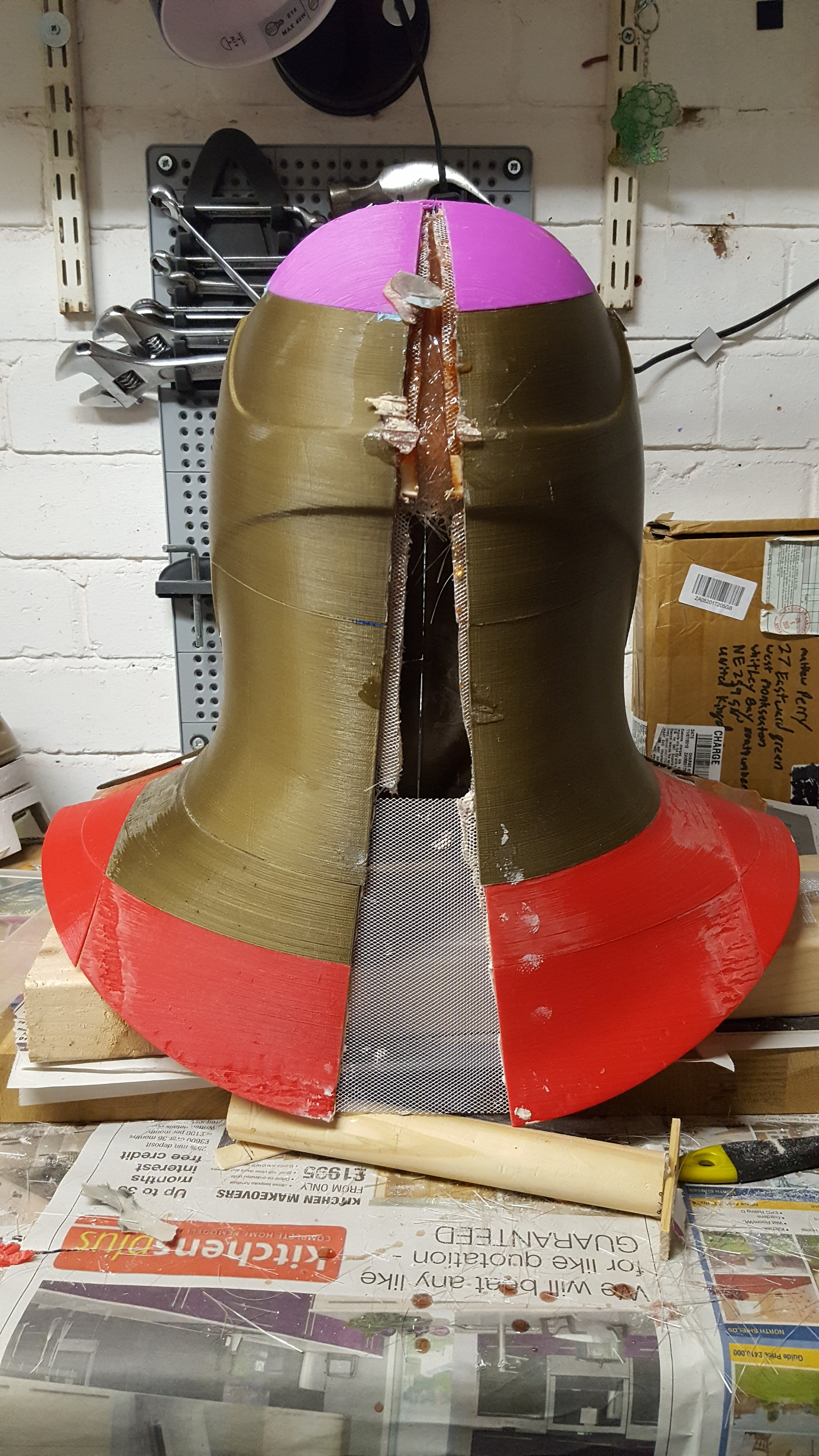

I taped it together to get a feel for the size, and tried it on. Not even close. Where the "cheeks" sink back into the helmet creates a bottle neck with the back wall of the lid. I have a 24" head, so I tried it on the wife, nope! Measured her and she has a 22" head (when choosing a wife always look for a little head!!). I untaped it and found that if I put my face in the front and then closed the back on to it, it would fit perfect. So it really is that point at the "cheeks", or where the back ends in that above pic.
It did however fit the kid just right!
So used lolly sticks hot glued in the inside walls to hold it together with about an inch gap.
Now it seems to fit. So I resined in some aluminium mesh and started glassing the gaps to give me something to fill on to. I found that quick wipe down with some 220 grit on the inside really helped the glass stick to the PLA, its totally bonded, no bother there.
Great. Tried it on. Didn't fit anymore!! There must have still been some give in it with the sticks that was taken out by the stiffening of the fibre glassing.
At this point the whole thing was printed out, at about 70hrs, I wasn't about to start over. So took the jigsaw up the back of it and pulled it open about another good inch or so.
Luckily, its not an overly detailed helmet. Even with the back splayed like that it doesn't look odd from the front, the sides aren't sticking out at all, so I got lucky with that. Obviously there are some lines that won't meet up properly now. I had glassed good portions of the inside to hold the seams better and give the whole thing some rigidity. So I took the dremmel to the lines around the band to the top to get them to line up nicer.
Then just started slapping bondo all over it like a mad man.
That's where I'm up to now. I'm going to clean that filler up and smooth it back and do more passes of filler and sanding till its good.
