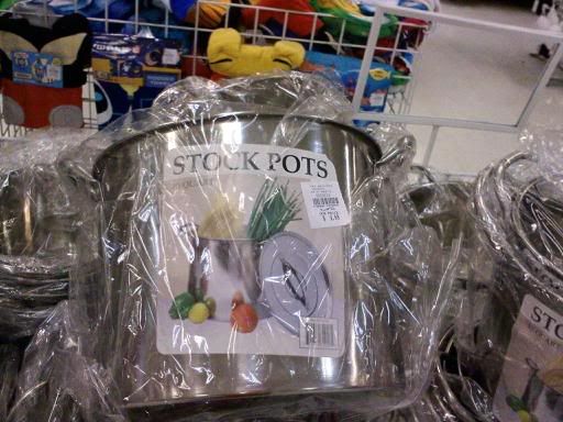

Hey Jessica, thanks for thinking of me, but I just got home with a pot that I think will work. It's 12 quarts. I was running errands with a family member at the Family Dollar store and they had some in various sizes. I was even able to try this one on - it's a cheapy, so it's light and thin. I paid $9 for it, so that would be about as much as I would pay to have you ship me one. Again, thanks for keeping me in mind.
