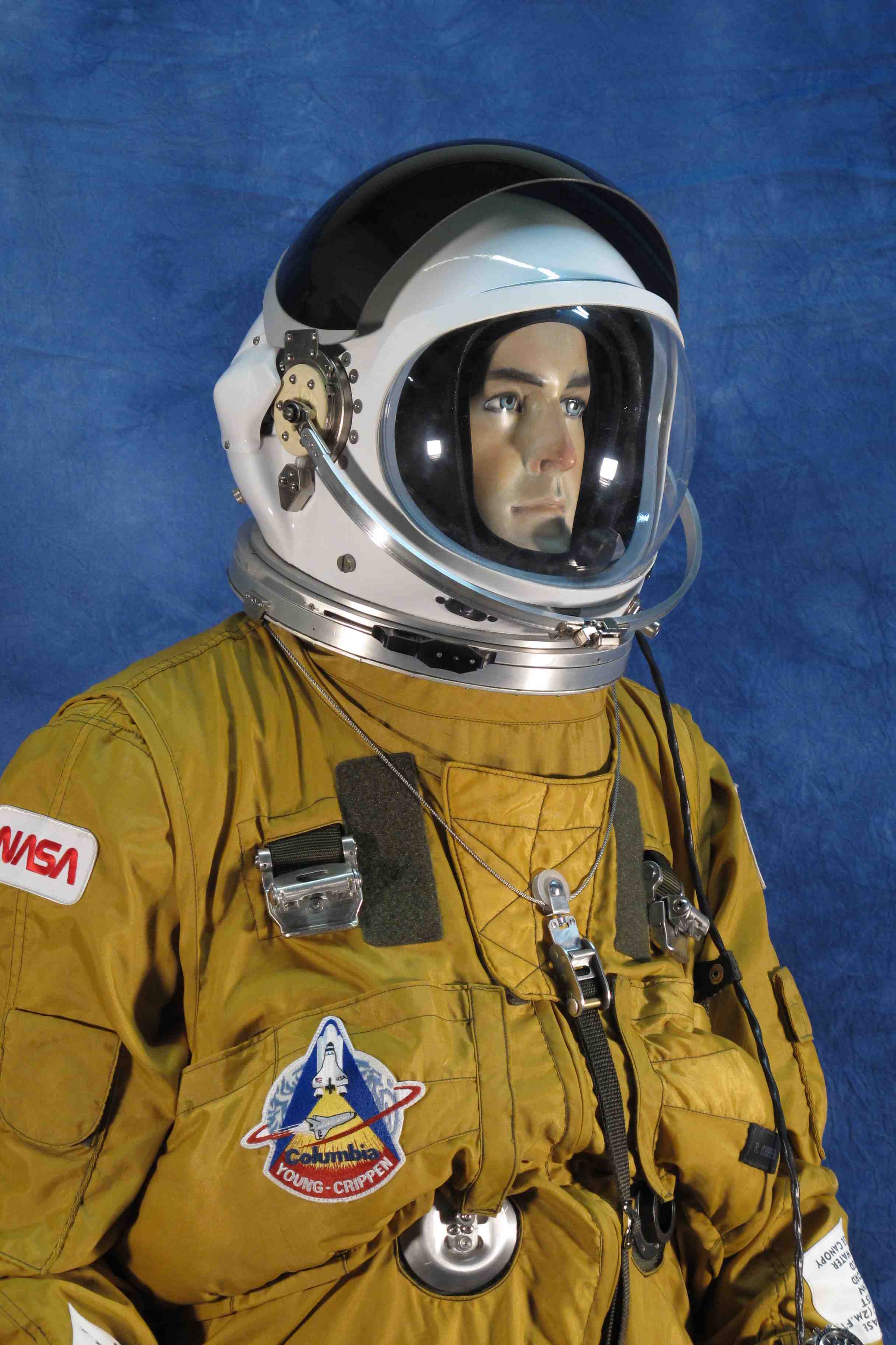

Digging around for something else, I found a couple of shots of the early Shuttle "space suit" we made for a client.
This type was a modified version of the S-1030 suit and it was used on the first four missions.
Thanks. Looking at the photos again, the only bits we did not make are the boots, smoke visor (in this instance) and the patches.
