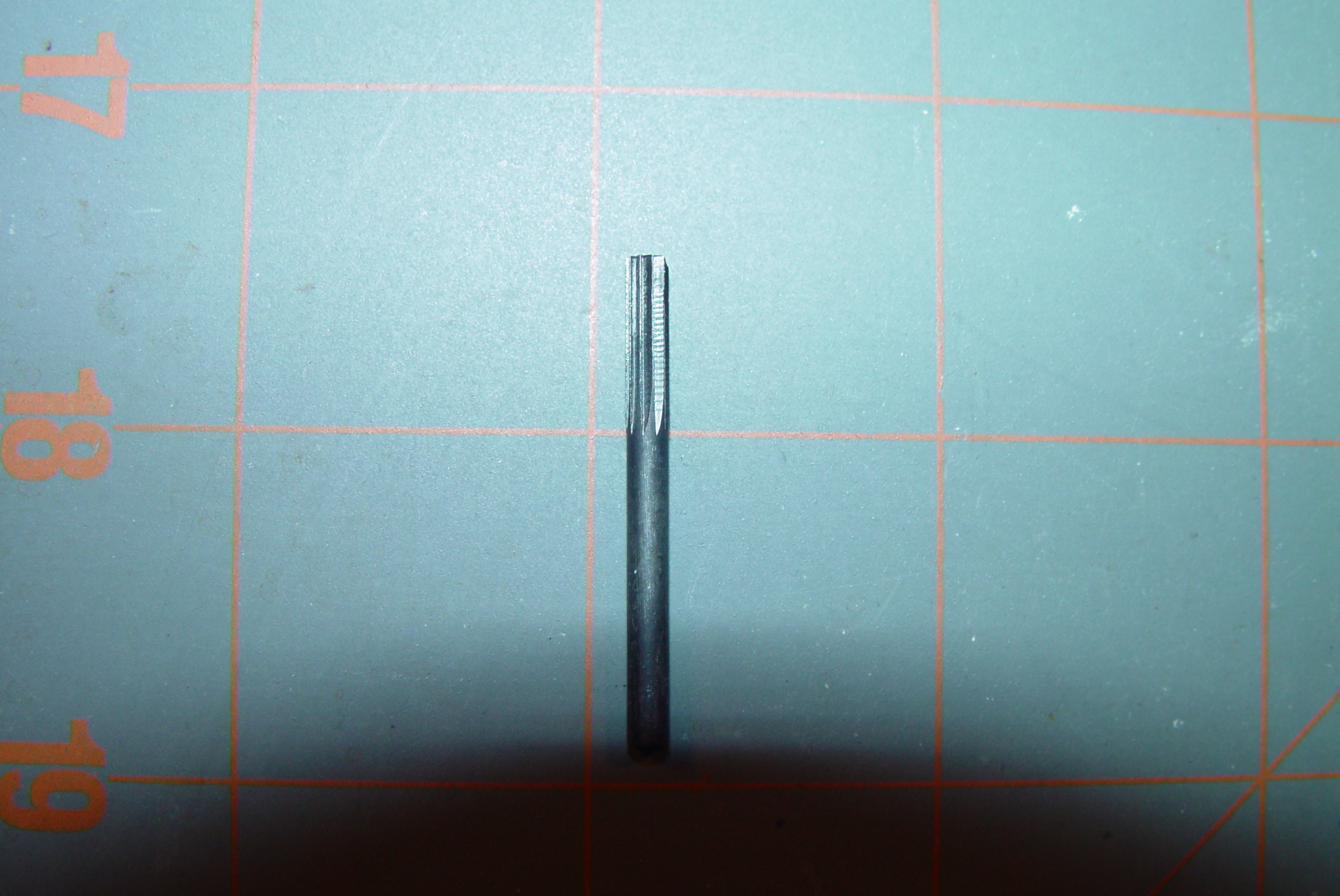

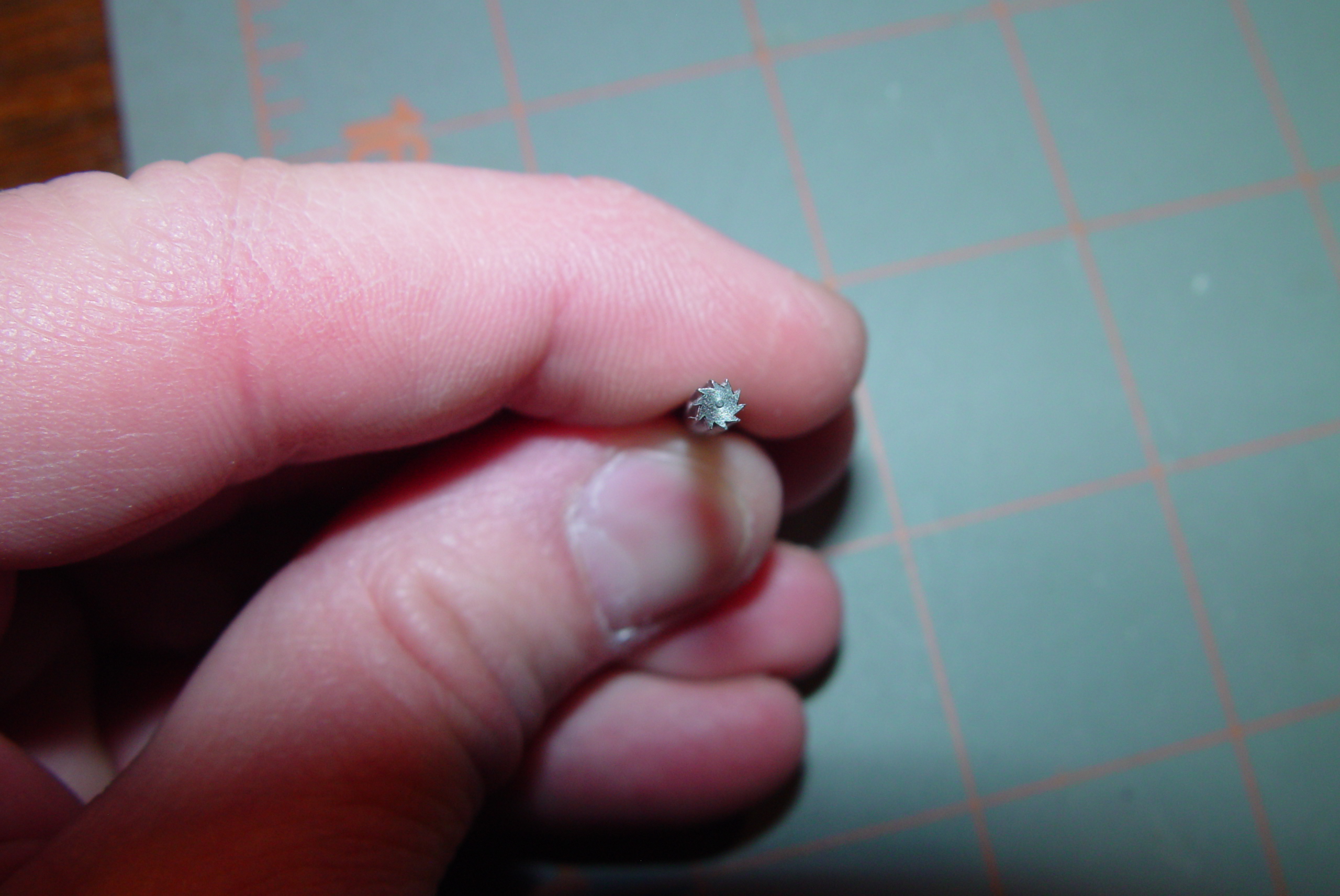

My go to plastic cutting bit, especially when I need to cut curves or discs out of styrene sheet is this high speed steel cutting bit out of one of those little sets. It will melt, but if you're using a flex shaft you can have really good control and it will spin off the melted plastic so you can still cut very well. Now you have to notice the shape of the cutting edges, because I've seen similar sets where the cutting edges are like a symmetrical star shape, not angled like this, and they don't work nearly as well.
