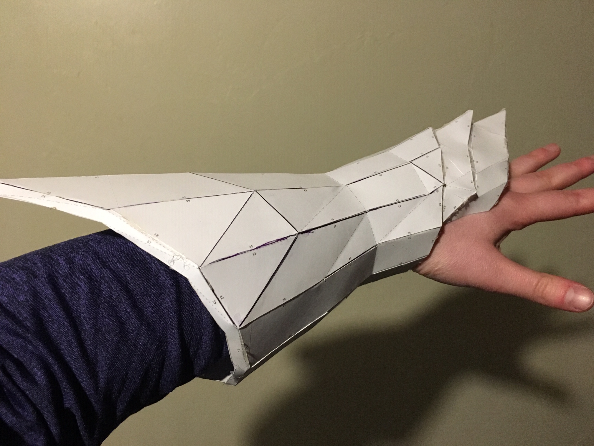

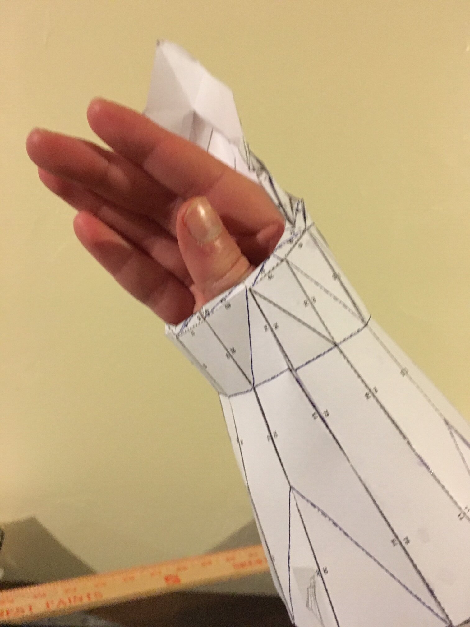

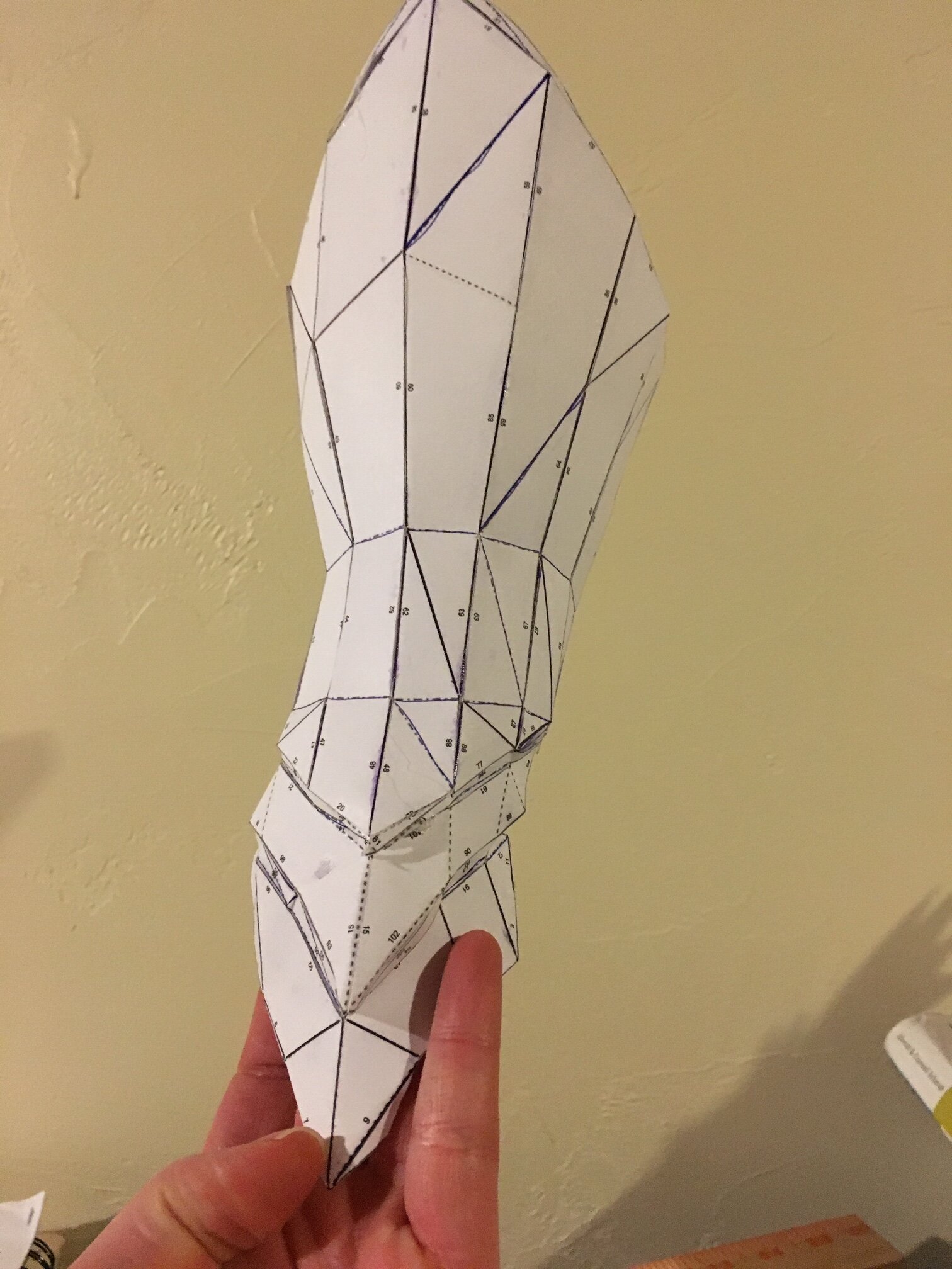

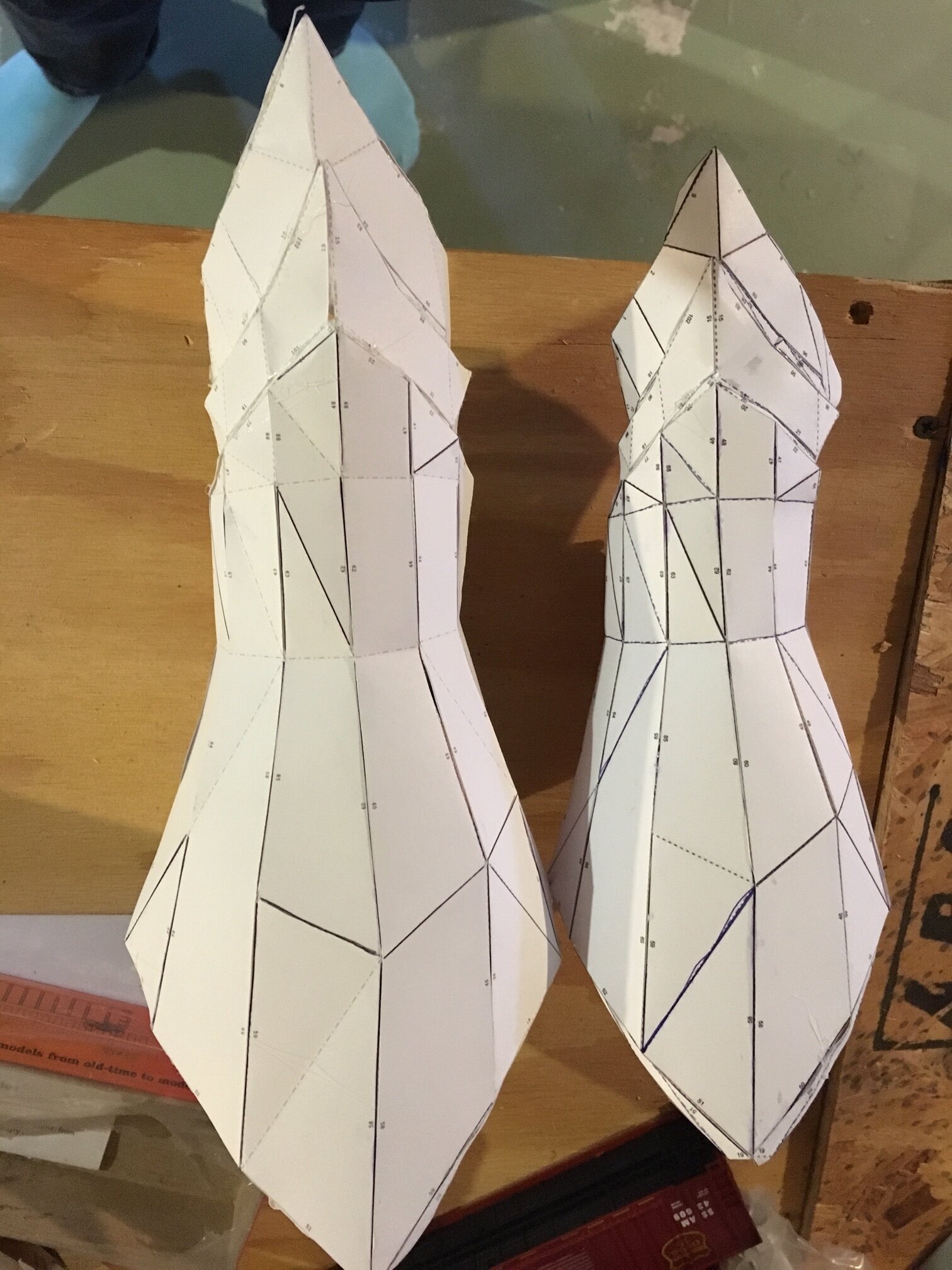

I've started with the left forearm piece, but I put it together, and I can't get my wrist all the way through. It's too small anyway, so I'm going to bring it from 11 inches to 13 inches in length so it's the proper size. The tiny little rim pieces are also a pain. I fudged the part that goes over the top of the hand a bit, so part of the edges of the v's aren't at the right angle. At least this forearm bit was a test run.
Gonturan0
Here's the larger version of the forearm piece. It's not difficult to fit my wrist through, and with some padding it will stay in place. I got the tricky little edge bits right this time. I'm making the right forearm part next, and then I'll move on to the upper arm parts and the elbow.

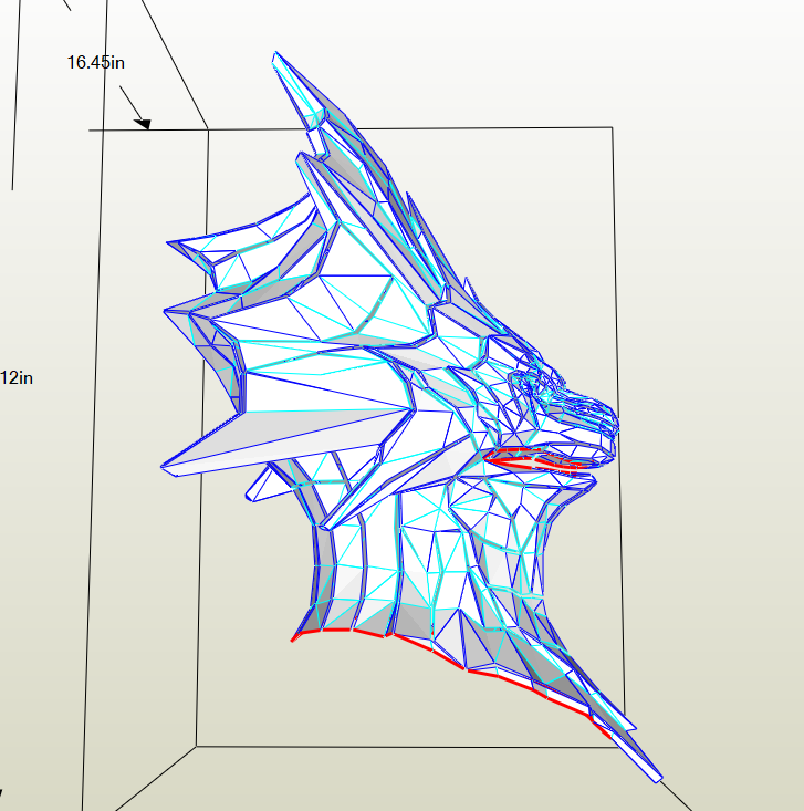

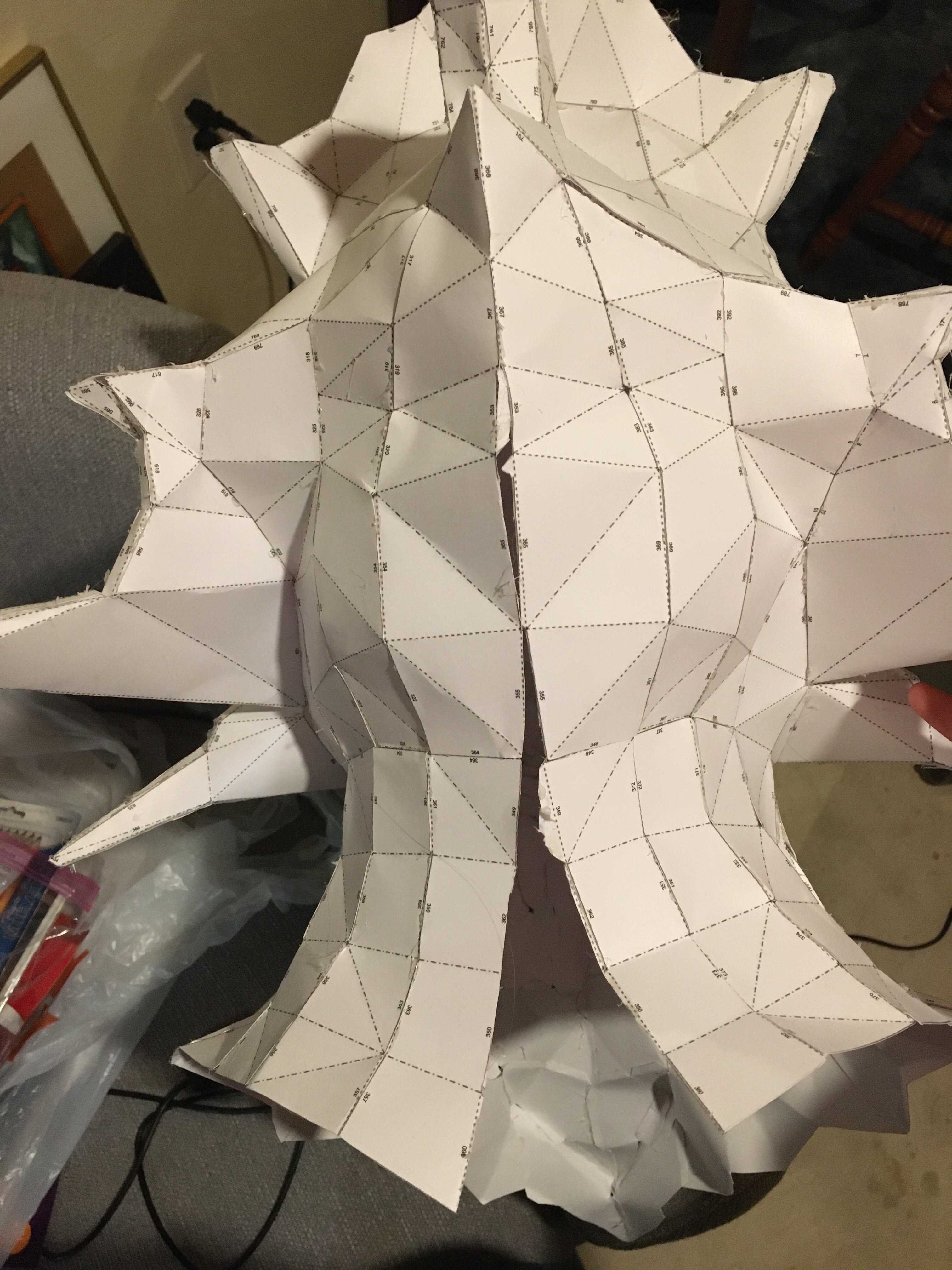

I decided to work on the helmet
I've done nothing but fold, glue, and cut paper for three days
and it does not fit
16.45 inch width wasn't enough
I am going to work on my drawing of Godzilla on a skateboard and chill out. Then I will add 3 inches to the helmet, shuffle the pieces around, and build it when I get more cardstock.
Gonturan0
Watching with interest. This is a deep dig and will be cool!
Thanks for watching, Frenzy.

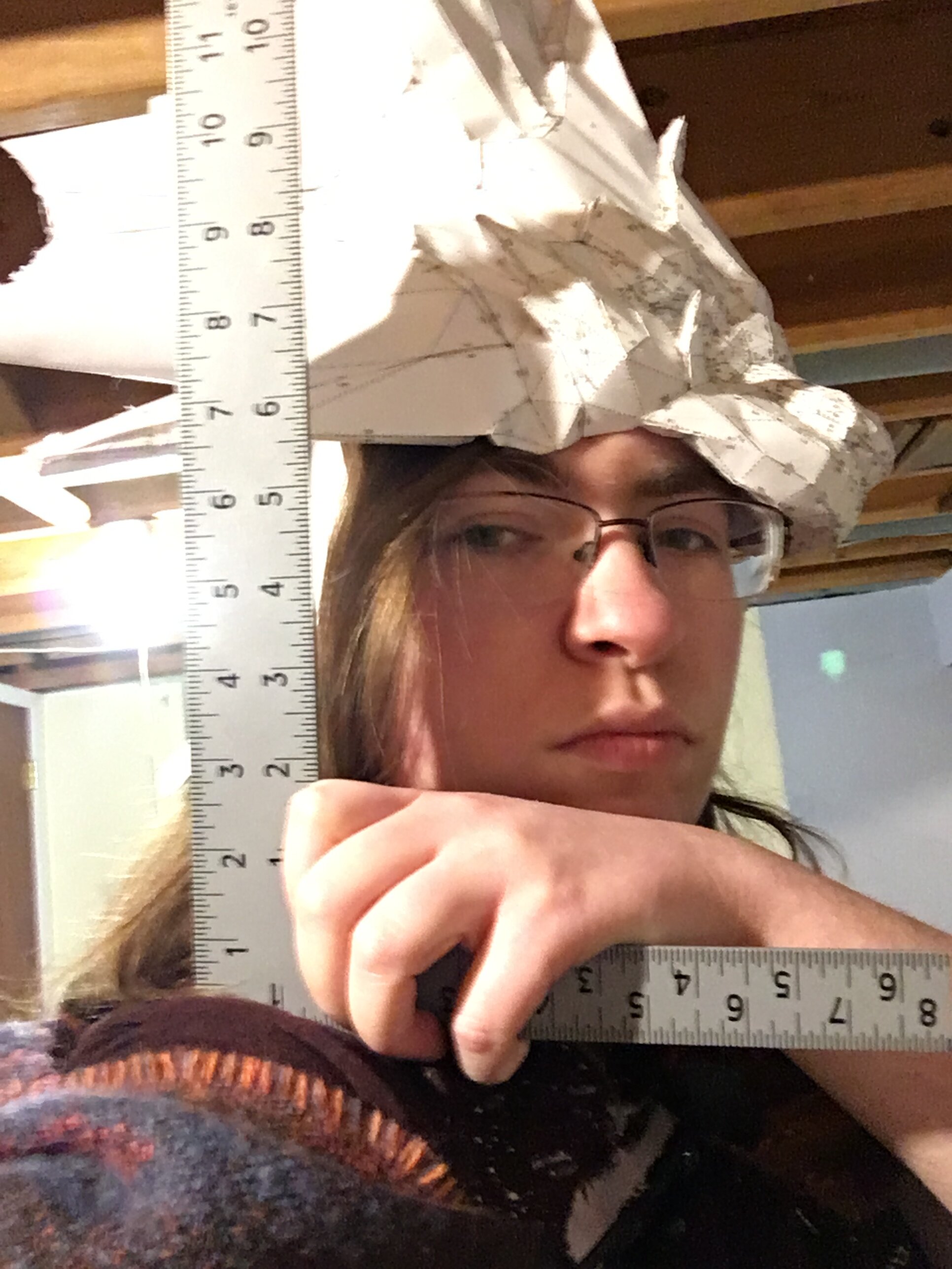

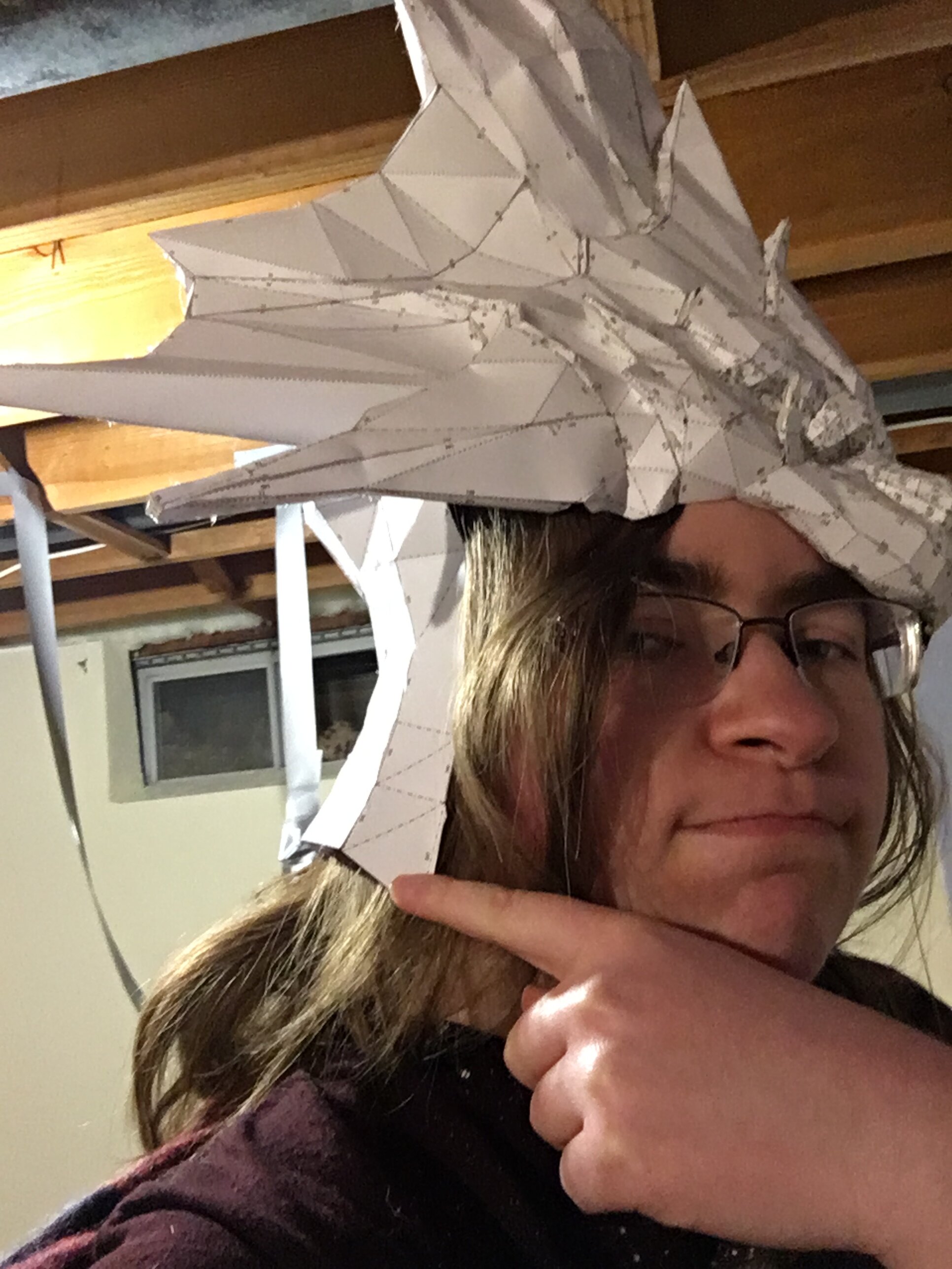

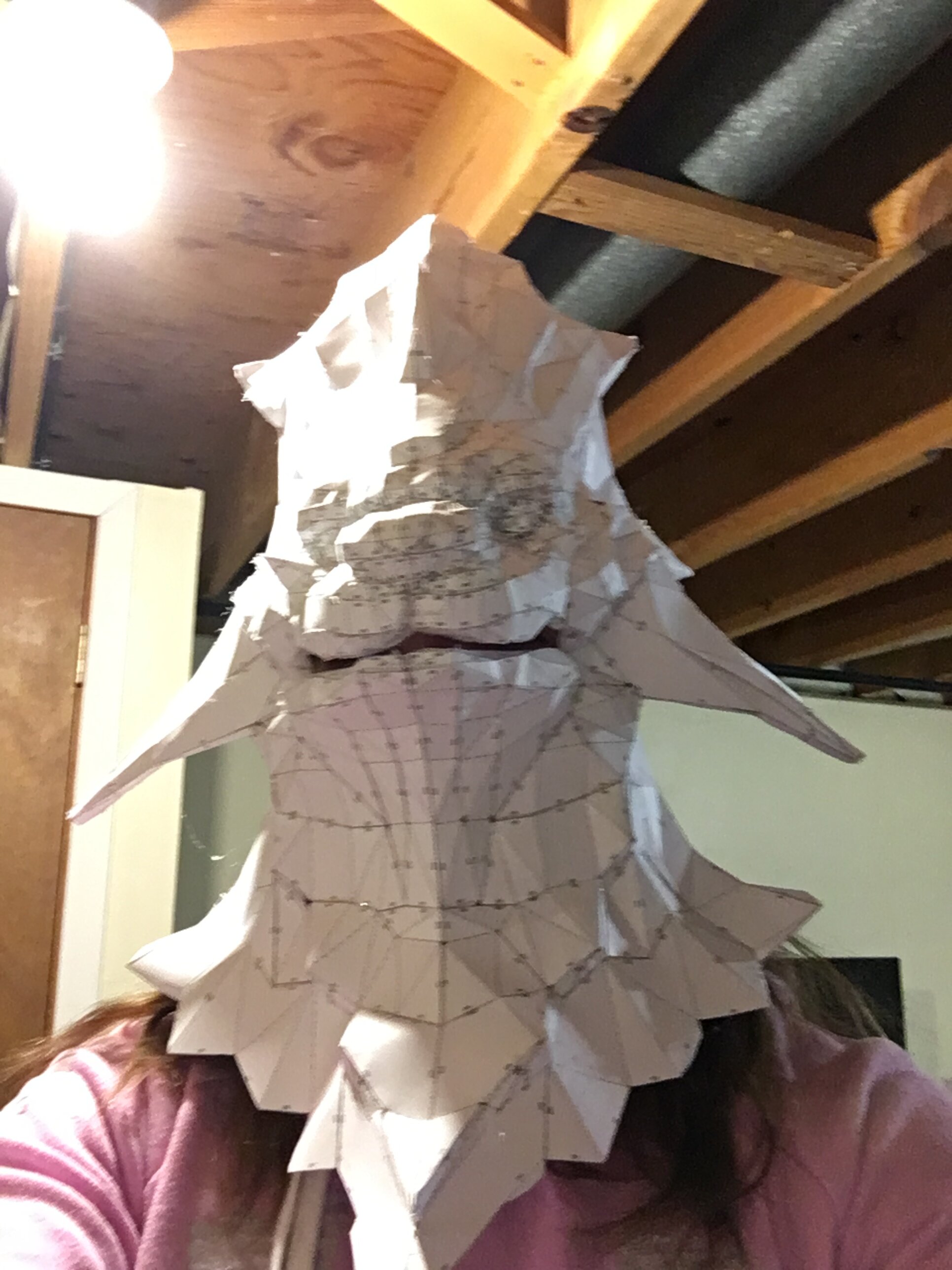

It turns out my judgements of the helmet were premature, and yet, not really. One is not supposed to try on a helmet while wearing glasses, and one should recall that the edges of the helmet should probably hover an inch above the shoulders. After all, I'm going to be wearing the chest plate too, and that's bulkier than clothing.
I can, in fact, fit the helmet on my head. It stays in place if the edges of the mouth rest on my cheek bones. However...
I had to open up a big slit in the back. That can be patched up easily enough with some more cardstock, but the bottom of the helmet is somewhat distorted by the wide seperation in the back. I could size up the helmet by a few inches so my head could fit inside without the distortion, but then the distance between the mouth and bottom of the helmet would be widened and I might not be able to see out. The helmet may also collide with the chest plate. Plus I'd have to build it all over again.
The helmet right now is 25.12 in x 16.45 in x 16.84 in, and if I add 2 inches to the width or depth, the height increases by 3 inches.
I think my best option is to try patching the back of the helmet when the chest and back pieces are built. It's the upper half of the helmet that catches the eye, and I don't think anyone's gonna care if the neck's a bit thick. The back of the helmet will also be partially covered by the big plume. I still have to figure the plume out, but that's for later.
I have both the forearm pieces built, and I'm going to move on to the arm and elbow pieces next. For real this time.

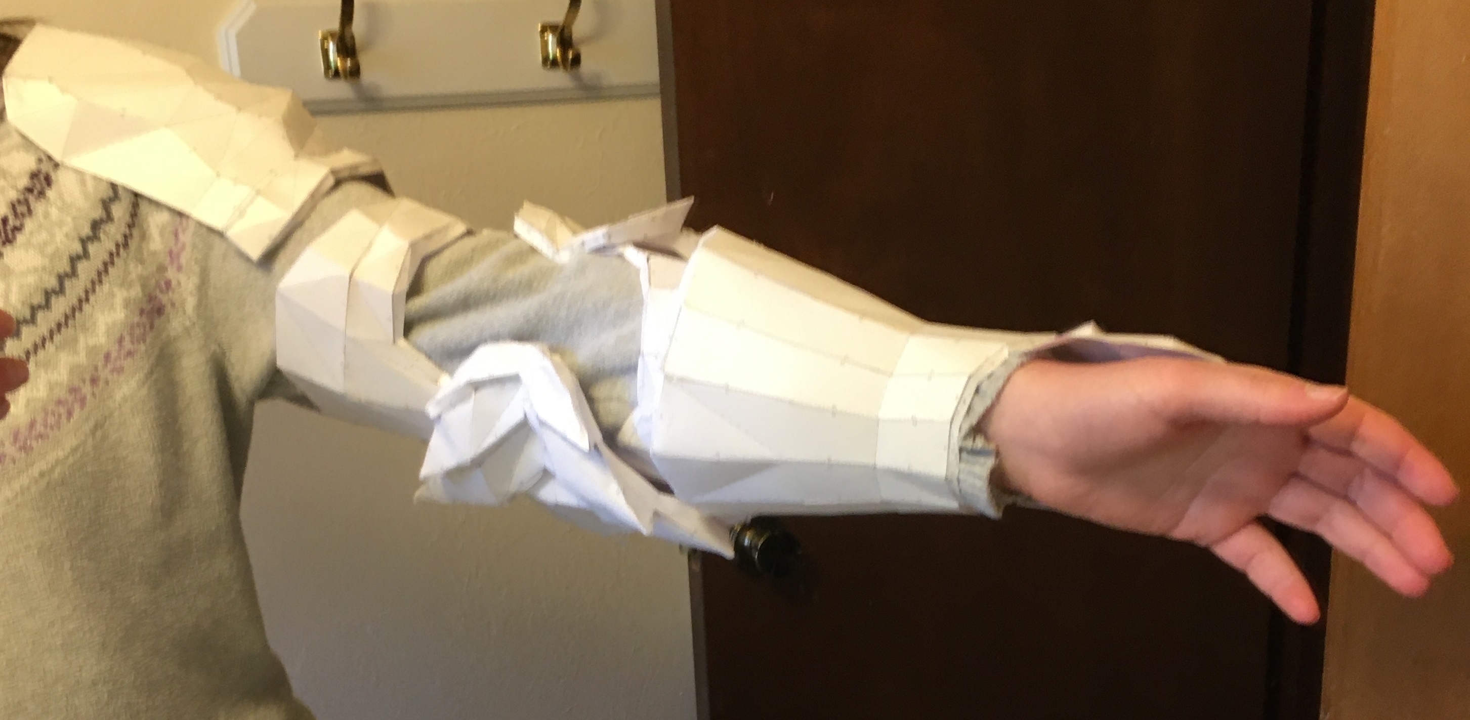

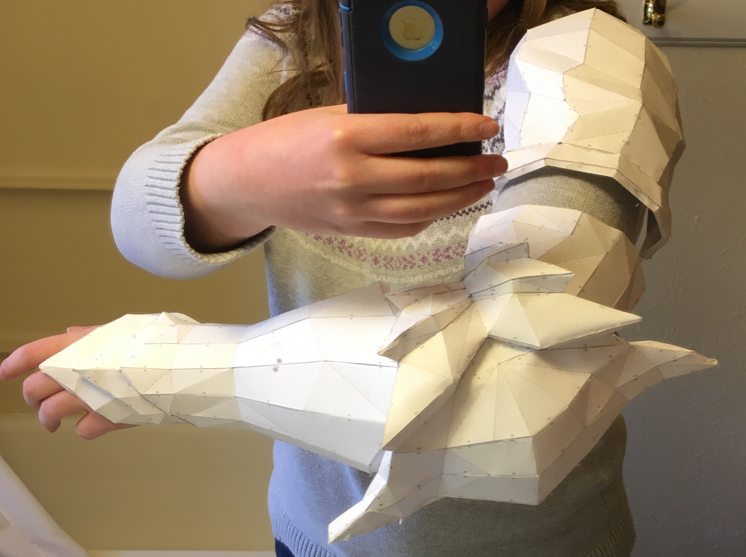

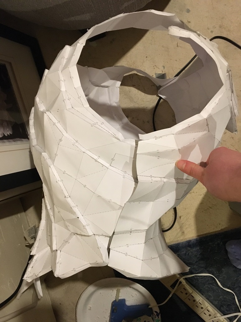

it has been a long, painful day but at least I can cover both my arms with nice paper
yes I know there's only one arm covered here but trust me, there's more
The pieces separated by the elbow piece were actually one entire piece. The problem was that I couldn't bend my arm. I'm pretty sure Ornstein was familiar with battle strategies such as Bending Arms, so I cut it in half. The separation will be hidden by the elbow piece anyway.
I tried being clever and scaled up the elbow piece before I put it together, but alas, the standout parts of Ornstein's armor are not oversized elbows. I printed it again at the original size and the piece fits perfectly, for what it is. It's going to need some velcro and elastic bands to keep it from sliding around.
Next I'm tackling the chest and back pieces. After that will be the shoulders. The chest and back are going to be pretty big, so I'm waiting on making the shoulders and making final adjustments to the helmet.

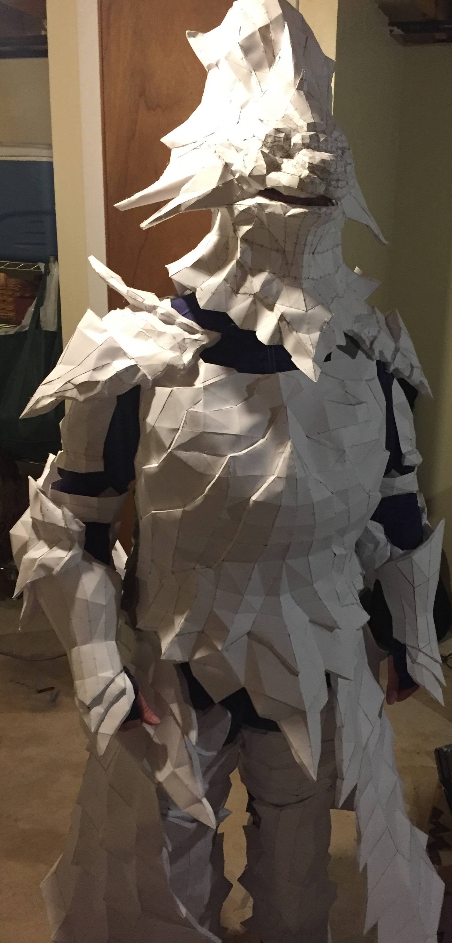

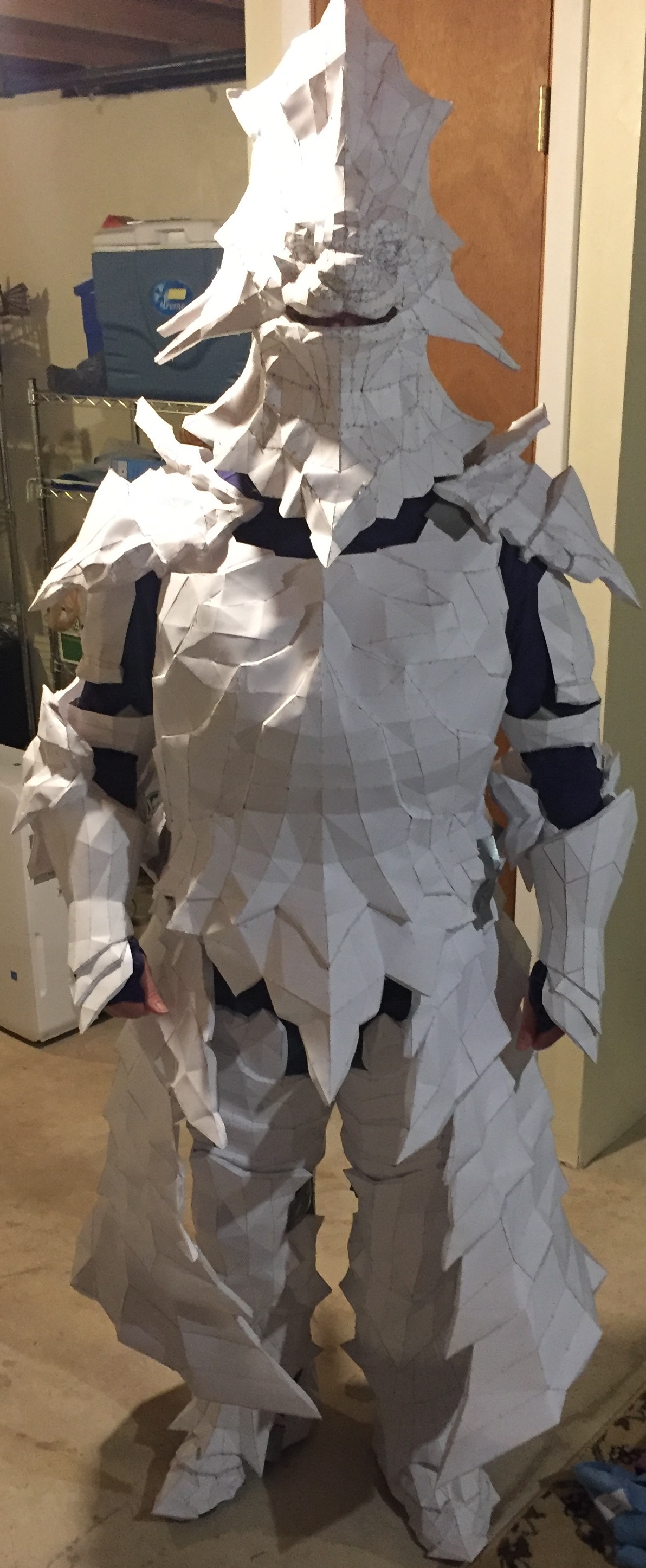

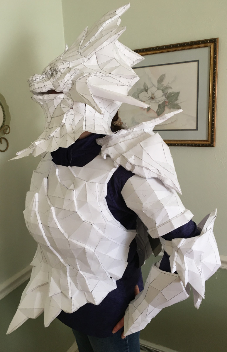

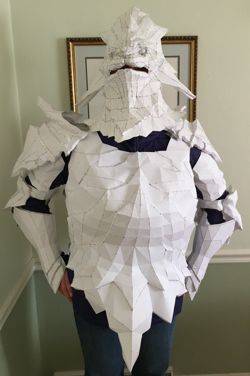

Okay, so I’ve built the whole upper half of the armor. I can only see people if I tilt my head at the right angle. The pieces aren't in quite the right positions in these pictures, but I had to enlist my dear cousins to help out. Those shoulders won't sit right until I employ duct tape wizardry.
The helmet... doesn't look right. I’m still on the fence as to whether to patch the helmet or make it bigger, since it floats off the surface of my torso, and I don’t want people to be able to see my neck. Then again, it might be fine once I put some foam under the straps that sit on my shoulders, and the torso's raised up a bit. Or not; that's a biiiig gap. Hmm. Might just have to build the whole thing again. The shoulder pieces will also have to be attached to the armor somehow.
IDK how long the lower half is going to take, since I’m starting my new job Tuesday, and I have to also do work for a college class for two more weeks. But the lower half of my armor shall be finished, eventually.
Anyway, I’ve got some questions that I would like answers to.
SOME QUESTIONS
Where do I find a plume?
Okay, so Ornstein’s got a big plume in the back of his helmet
and it’s critical that I get my hands on some long red hair. Red yarn would look lame. The problem is, I’ve got no idea where to get this stuff. Do they have this sort of thing at Goodwill?

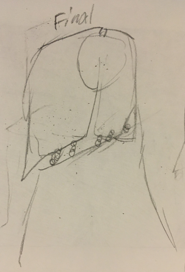

How do I make the two separate torso pieces attach and detach easily?
I can’t slip into this thing without separating it at the bottom, and somehow I have to attach the side skirt pieces under the armor temporarily. I’m thinking that I might chain the skirt part permanently to the back part, since attaching anything back while the torso’s on would be a pain. Temporary attachments at the front are doable. Anyway, I can only use one arm to attach a side together once I’m in the armor, since the chest is so bulky that I can’t reach a side with the opposite arm.
The top join will be hidden by the shoulder parts, so if there’s any hinge or some other attachment up there, it wouldn’t be visible. Not that I’m necessarily gonna put a hinge there.
I know of a guy who’s used magnets, and I’m friends with some dudes that could help me work with making the metally bits he’s used, so that’s a viable option. I’d like to hear other ideas though; I can’t be the only one who’s had to deal with this.

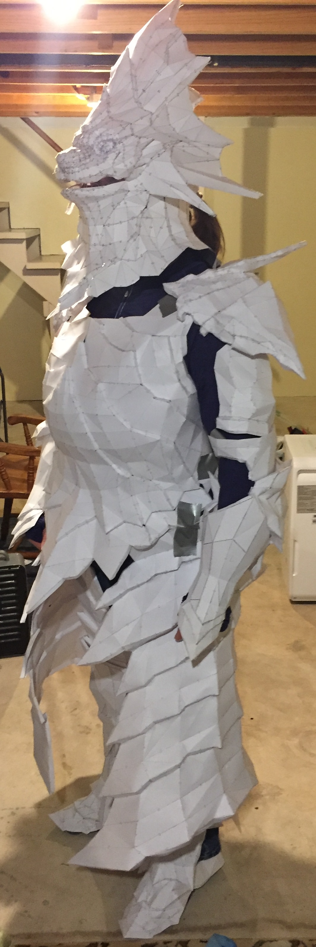

PSYCHE I'M STILL ALIVE
Idk why the right skirt thingy is bent in the photo. looks alright when it's not on me.
the thighs are the most annoying part to wear, besides the chest and head. I'm gonna have to find a way to hold them up. might use the belt that will hold the chainmail and skirt things, or I could use suspenders. but those things CANNOT slip down or they're gonna shift all over the place and restrict my movement. moving my legs far at all is gonna be a chore. same with my arms. ;-;

1. I'm gonna buy a cosplay wig, cut a hole through the helmet, and feed the hair through the hole. There will be a band around it to make the hair stay in a plumy ponytail shape.
2. I'm gonna need four computer magnets for four points on the sides to keep things from shifting around. There's no other way to get the sides to attach and to hide the join.
