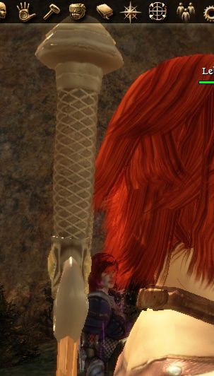

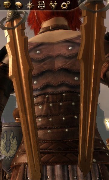

So I started by taking a lot of screenshots from the game:
DA Sword origins (2).jpg DA Sword origins (5).jpg DA Sword origins (8).jpg DA Sword origins (25).jpg DA Sword origins (28).jpg

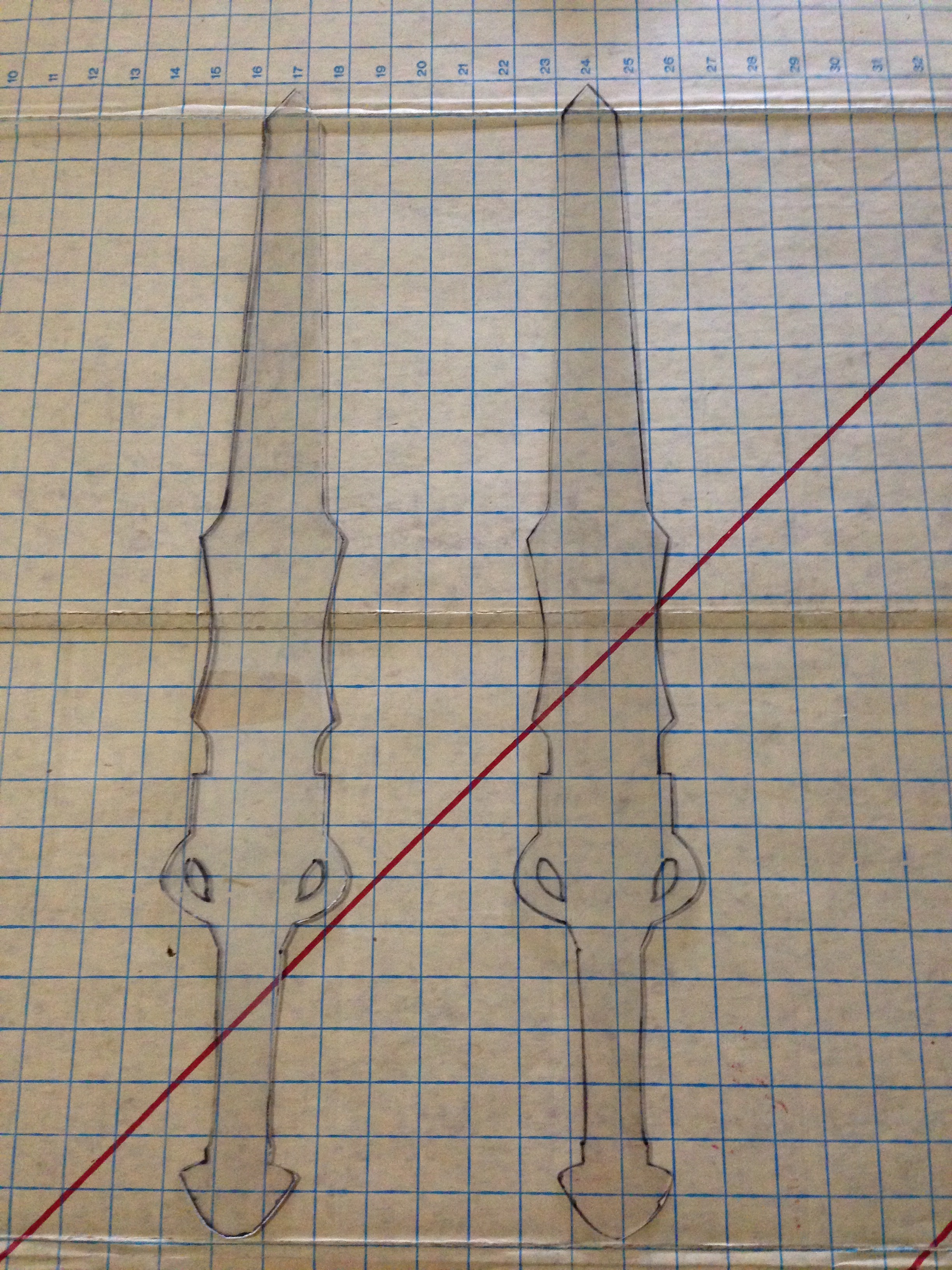

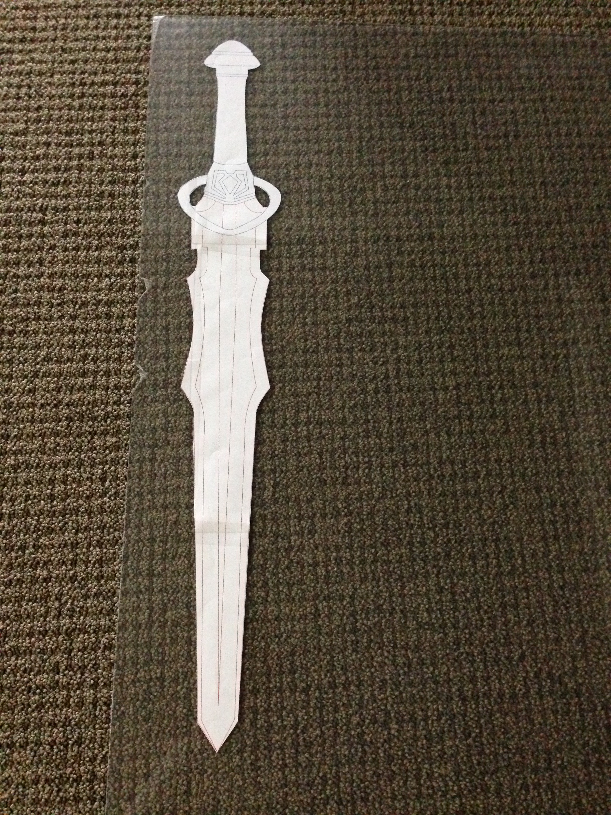

Then the lovely novacat17 offered to help me out by making a vector after I asked for some help on getting started on this thread, after that I printed it out and traced it out onto a piece of plexiglass and then cut it out with a saber saw. (sorry for the pictures, all I had is my phone)

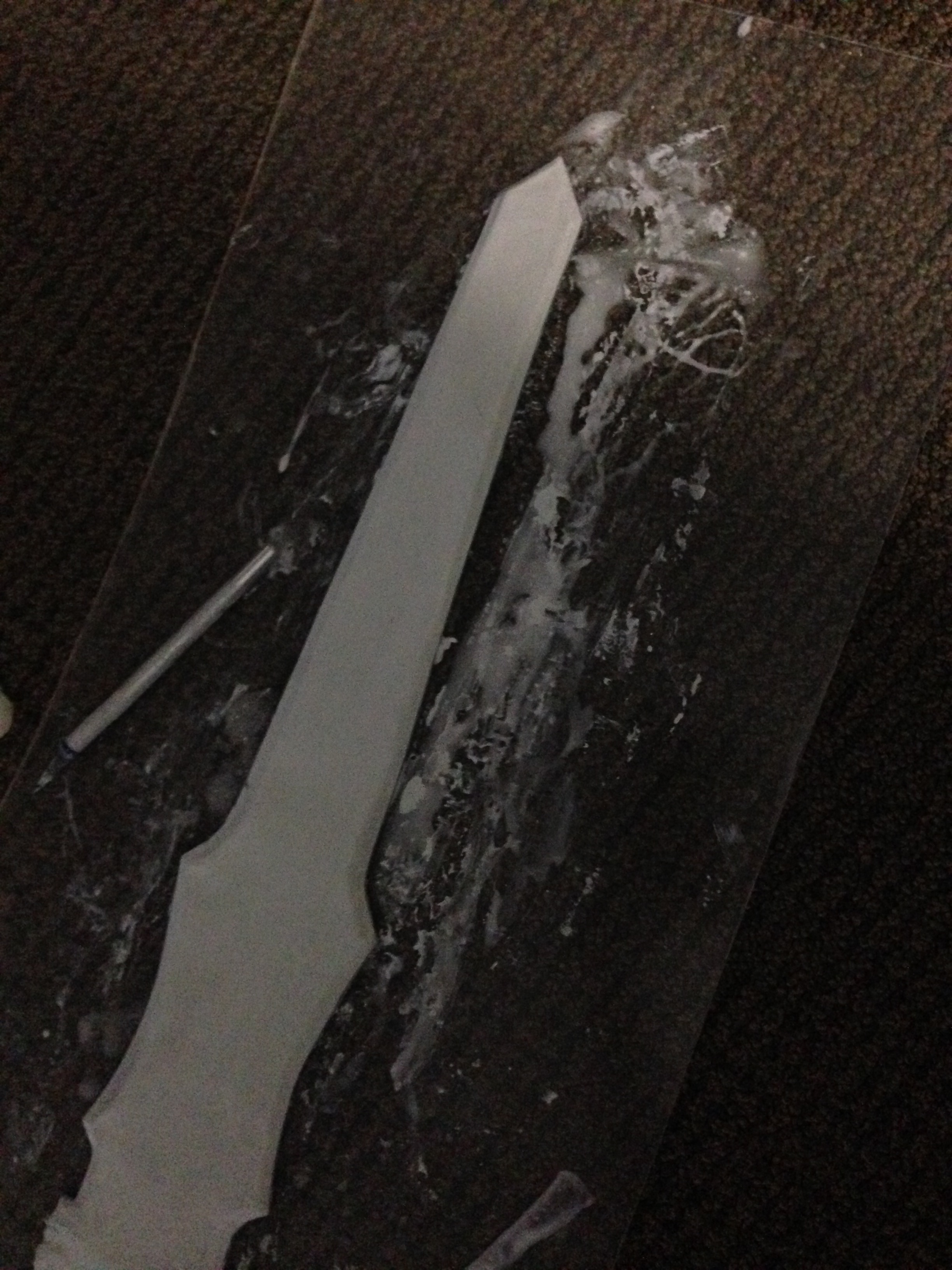

Then after they were cut out i began sculpting the blade portion with apoxie sculpt. First by slapping it on the plexiglass and smoothing it out, and then adding details. (Sidenote I have never used apoxie sculpt before, but I am now in love with it and will definitely buy more!)

Awesome progress and thanks for the nod. Im glad to see the apoxy sculpt is working out. You were not kidding about sculpting well; it puts my apoxy sculpt stuff to shame :$
How is the apoxy sculpt adhering to the plexi? Did you have to sand it before or does it just stick well? I have used it on styrene, but not plexi.

I thought I would need to sand the plexi down so i tested it on a little piece that I had lying around, and it stuck really well! I guess the adhesive in the clay is strong enough to stick to most things.

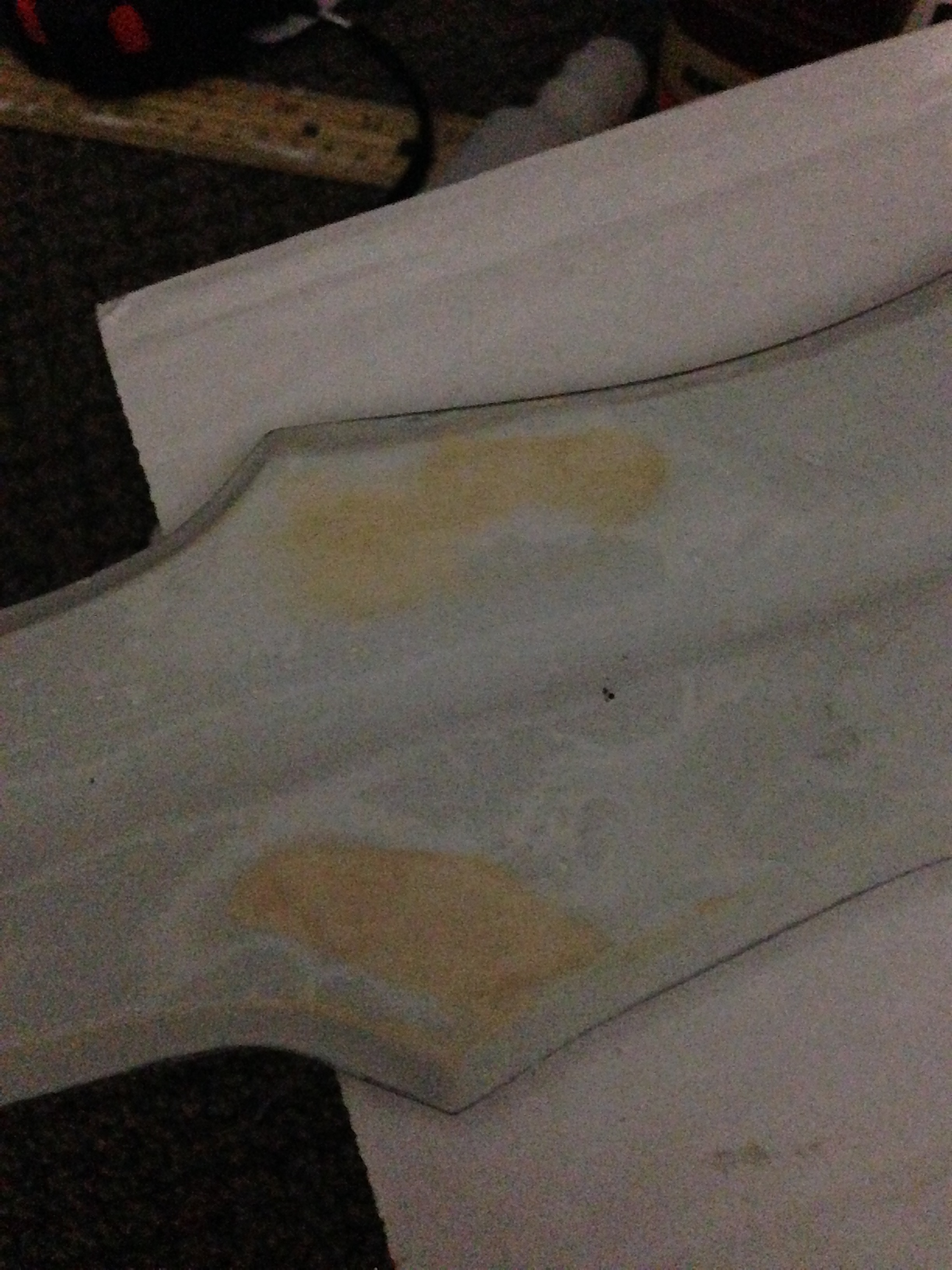

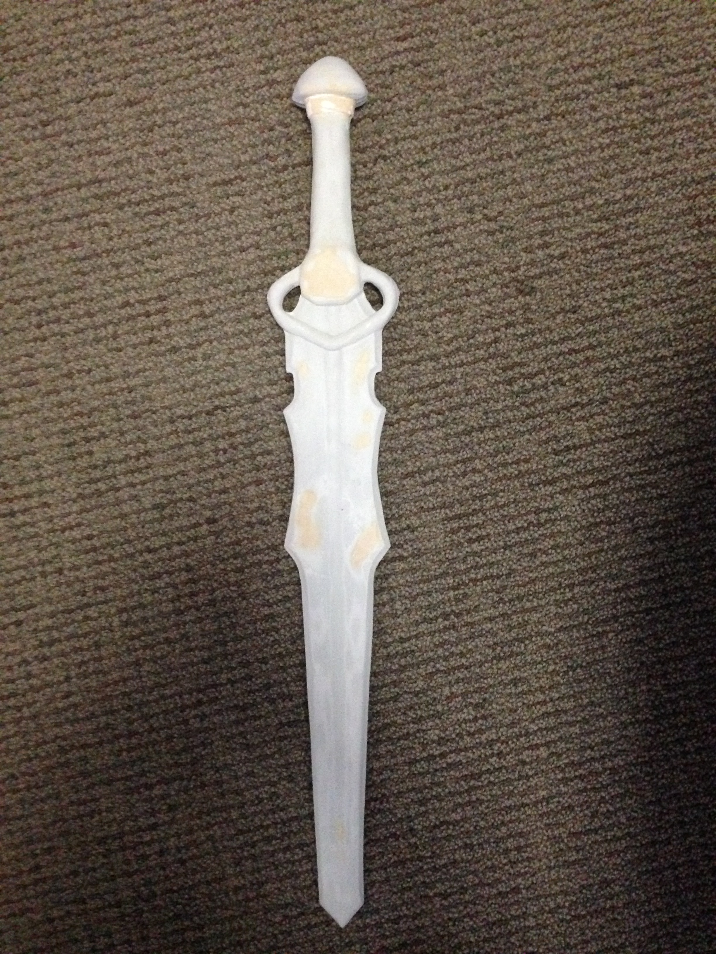

Then there was some unevenness in the blade so I went through with wood fill and evened that up.
Then I went through with sandpaper, patching plaster, and wood fill to fix whatever I didn't like.
so hopefully its ready for priming and then casting. I unfortunately wont be purchasing any casting materials in the near future because I don't want it to freeze, and I have a less than reliable mail man who has been known to deliver the mail at 8pm only for us to find it the next morning.
