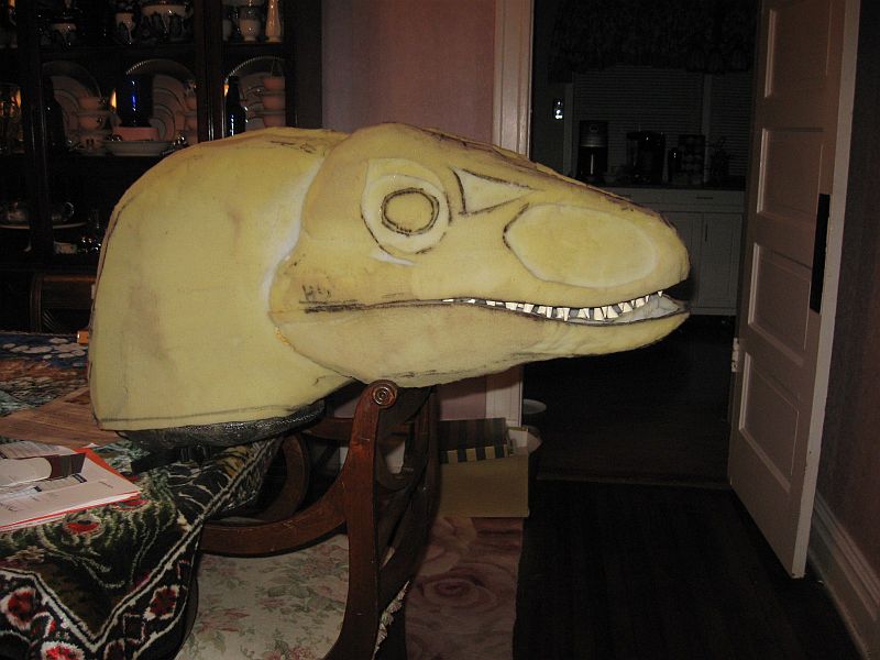

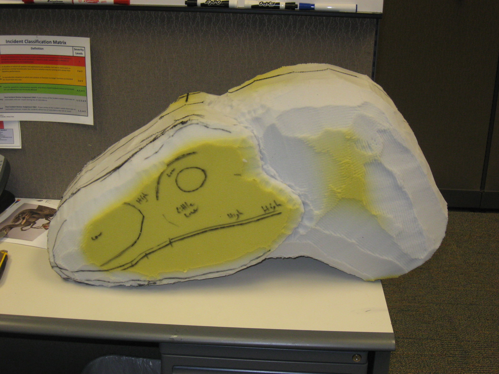

I decided upon what the final length of my head should be and then used proportions to calculate the dimensions of everything else. But I always did the math for BOTH models, the pepakura AND the toy...and then chose the final body part length that seemed to be best (if there was a big difference between the two sets of final numbers).
One decision I made that may have been a "mistake" was in going along with what KIND of foam to use, as presented in those Stan Winston videos. The head piece alone cost me $70. It was thick alright, VERY thick. I carved it with an electric knife, then started using smaller and smaller blades.
Some progress photos of that:

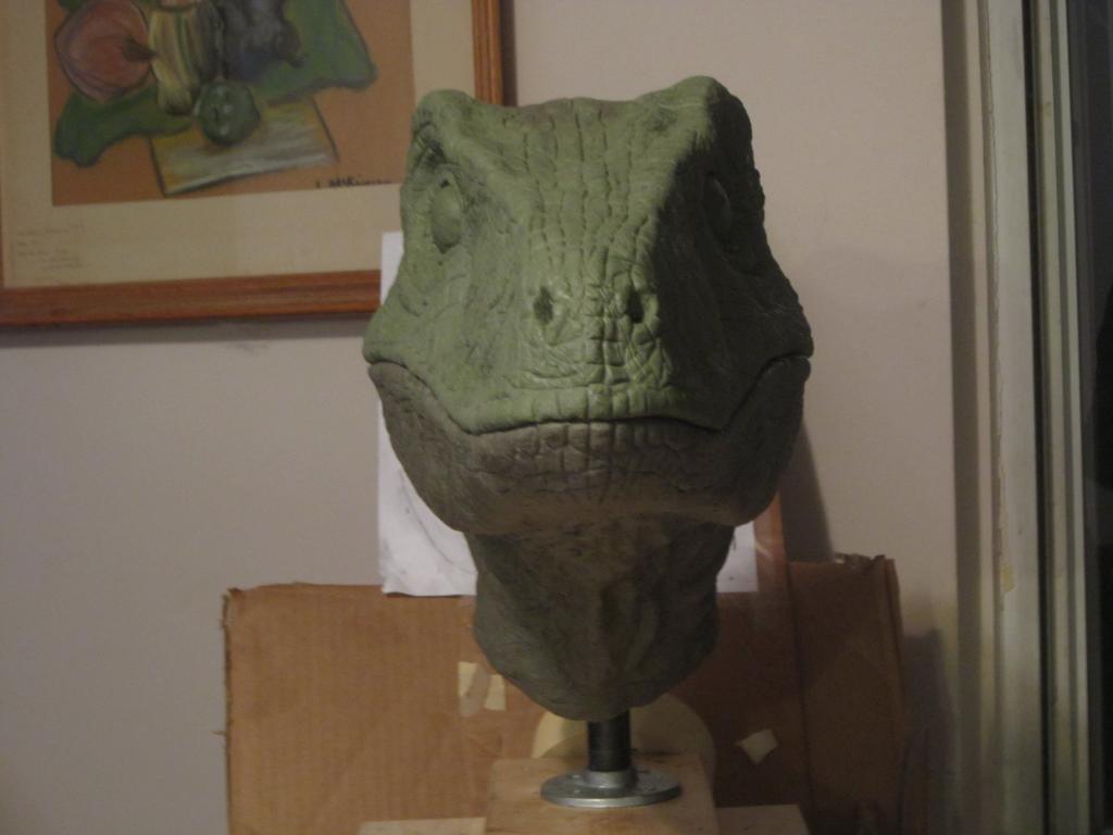

As I worked over time to make this head more accurate, I found somebody here had made a clay model of a raptor head. So I added those images to my reference documents:
While this foam was terrific for carving, it also made for a very HEAVY head. On the one hand, I didn't really need a special "hinge" for the jaw. I had several kids literally pull down on the mouth with their hands and it maintained its strength and snapped-back just fine. But still, after wearing this head the first time (after carving out a hollow area in its neck and gluing a bicycle helmet into it), I had to add two straps to the rear of it, to help reduce the tendency of the head to pull forward so hard.

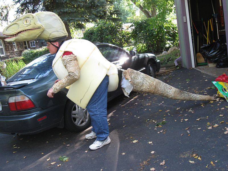

The tail was made out of a pool noodle, which I carved a bit into segments and then ran PVC through about a third of it. I then surrounded it with foam (the more "normal" kind that you can buy at any craft store).
The hands were made out of foam that I carved. I then split them almost completely in half and carved out the insides so as to fit my hands. And then I glued the halves back together again.

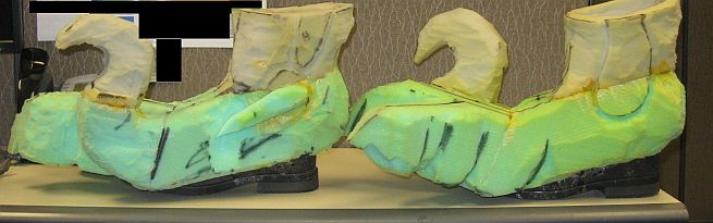

Most folks I've chatted with on these forums were very concerned about how I would handle the digitigrade feet. I did NOT want to go the stilts route, because I'm 45 years old and the older I get, the more worried I get about breaking an ankle or falling and actually hurting myself in one of these outfits (especially since VISION while wearing them is so often a problem).
I thought I'd create the illusion of digitigrade by making foam feet that would bend upwards at a 30 degree angle... and then build in that angle / foot onto a set of shoes or boots. Unfortunately, in the end, the angle ended up less than 30 degrees, so this didn't quite work out:

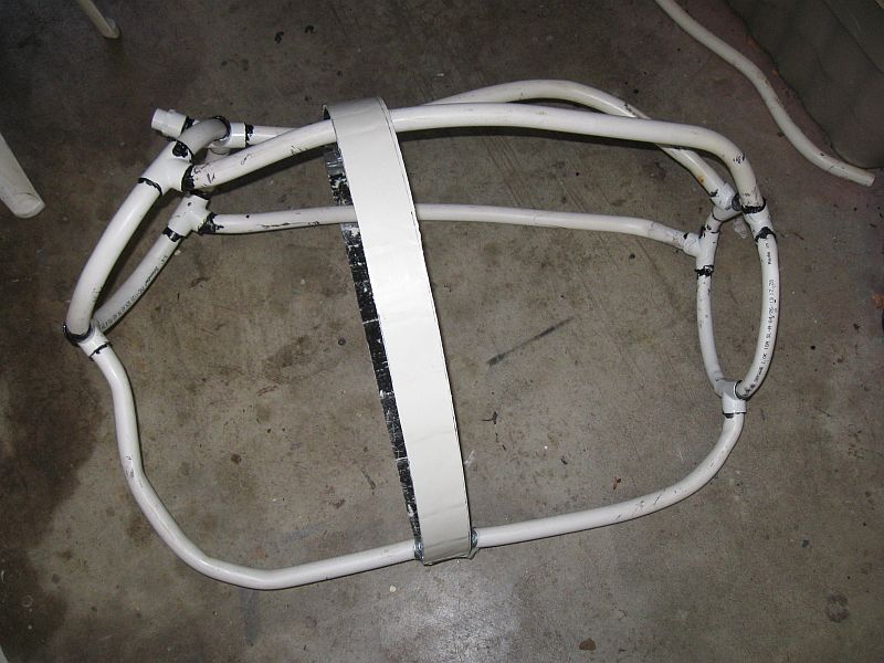

The body was made of a sort of "PVC cage". I used a heat gun to bend the PVC and then glued the parts together with PVC adhesive. As far as how I determined the shape of the cage, I used that toy raptor as a reference. The only down-side to this was that, I'm afraid my body just isn't the same as a velociraptors: if I had taken the body cage to its logical conclusion, the rear end would have been much longer and so would the tail. So, I essentially had to "chop off" a foot from my cage before terminating its rear end. The final result of this was that the CHEST on my final costume seems somewhat bigger than it should be. This seemed to give it a more "mascot-like" feel. Thankfully, the head looked much more realistic than a goofy mascot and kept the whole thing grounded in the realism that I had wanted.

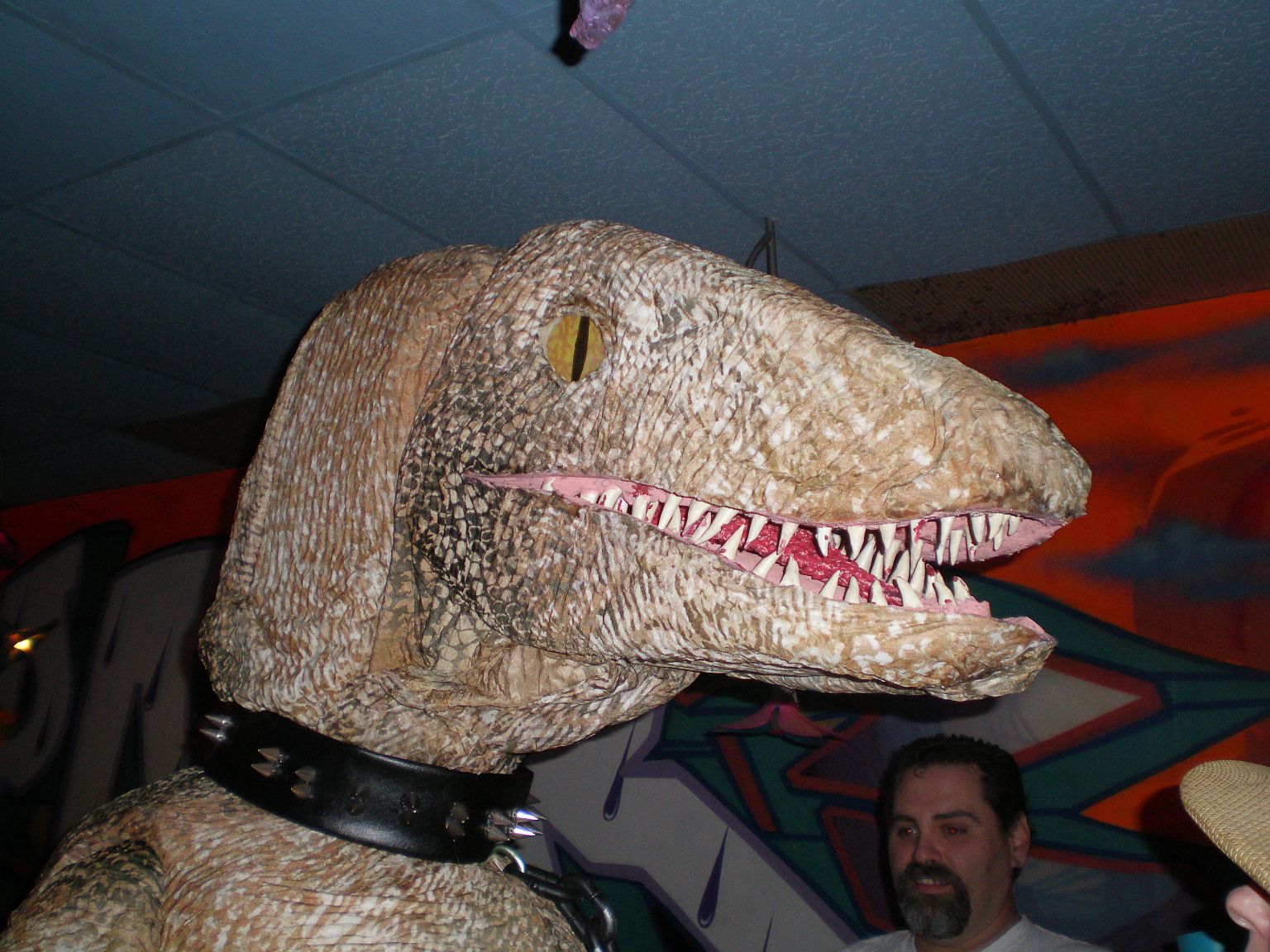

I made the eyes out of resin, painted them myself, and more or less "tucked them into" some eye sockets I had carved. The teeth are made of Sculpey.

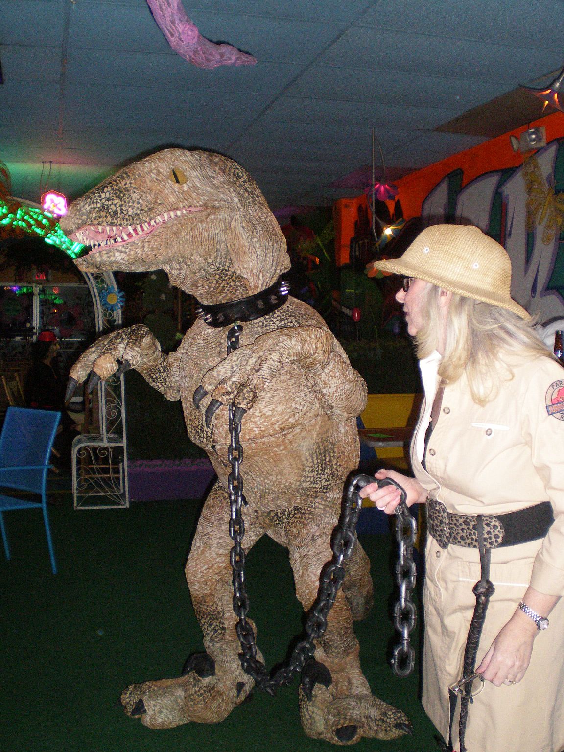

The chain is a cheap prop from Michael's craft store.
My wife's costume is made from Thrift Store finds, supplemented with two Jurassic Park patches purchased on eBay.
Here are a few more progress shots, and then some shots from when I wore this thing in public:
I did end up taking 1st place ($700) in that costume contest this year! And, to our surprise, they let us do a "victory dance" to a cheesy 80's dance tune: "Walk the Dinosaur!":
