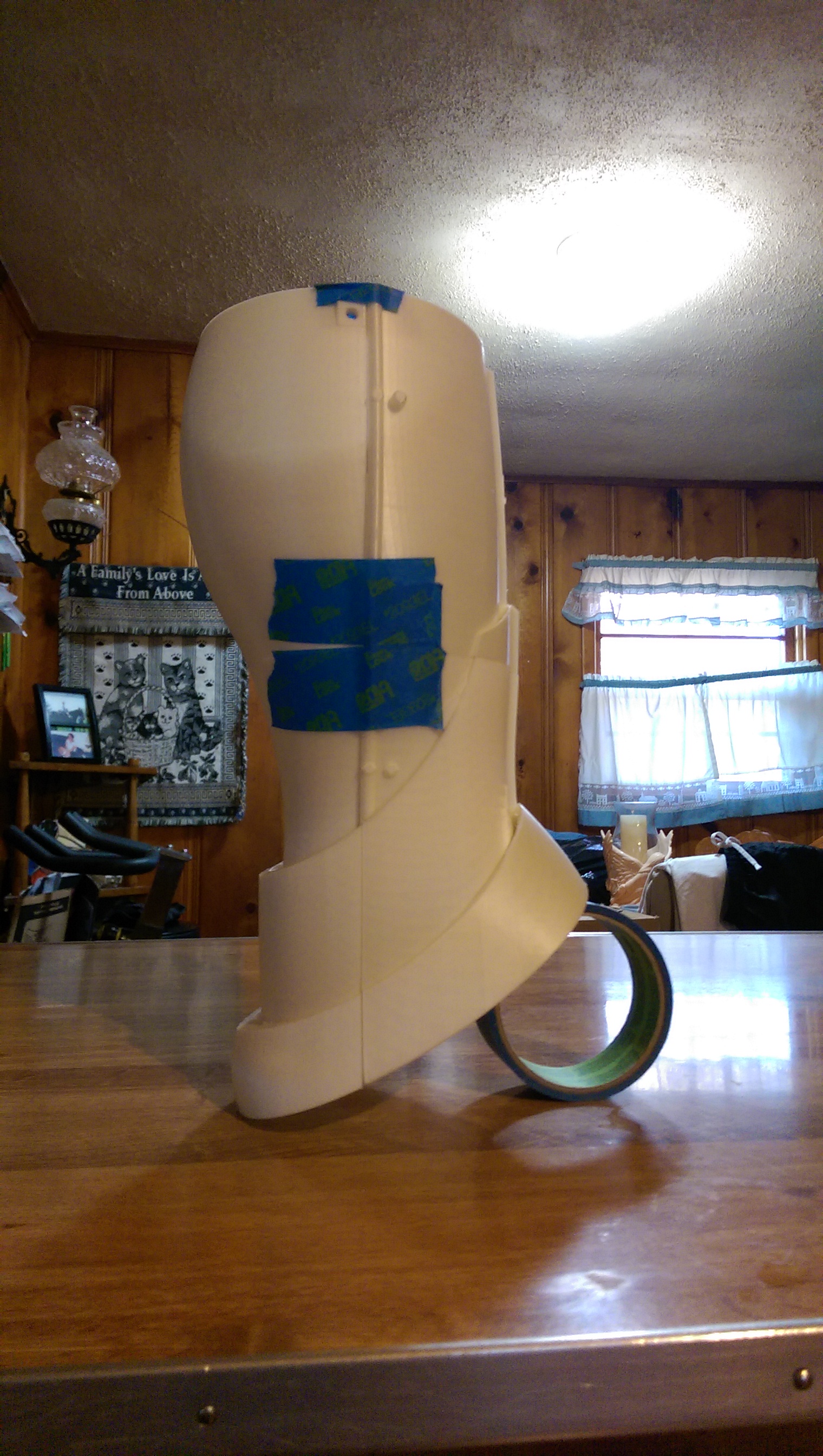

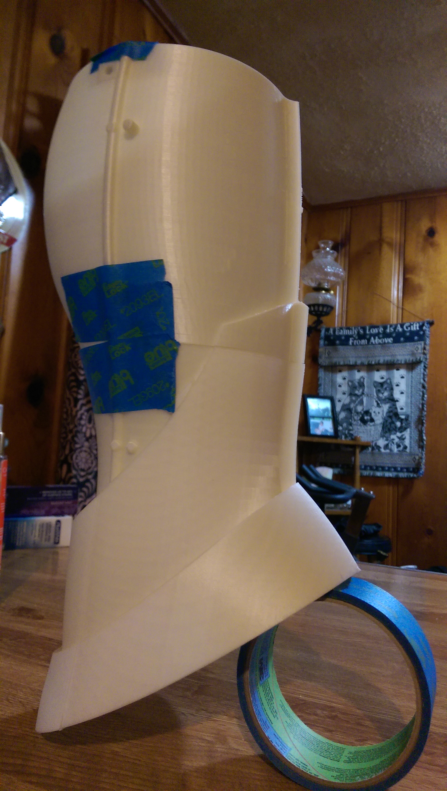

Little progress, after 3d printer went down for a month finally got to print the lower leg armor. I'll begin the Knee and upper leg armor after one more print.
