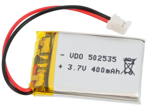

Hey Joe. Do you have a link for a rechargeable battery as I can’t seem to find one with those dimensions here in the UK.

There are probably dozens of options as these are pretty common. 3.7v LIPO., rechargeable.
Something like this (as long as it's within the size range 25mmX5mmX37mm) :
5 x 3.7V 200mAh Lipo Rechargeable Battery 502025 For MP3 headphone smart watch | eBay
NOTE: The one linked does NOT have the little white connector for the power booster. There are batteries that DO have the connector so I'll see what I can find.
The one we used is 25mmX5mmX37mm. (I can see if it has a specific model number.) I suspect you might get away with something slightly larger, but I don't know- you don't want it TOO cramped inside. Since we got our battery locally here in 'little tiny Sweden', I reckon it will be MUCH easier to find elsewhere because our local selections are always lacking.
Hey Joe....would this do? It has a depth of 8mm.
It might fit, but it's 3mm thicker than the measurements I've been counting on. There is a little extra space in there, but since I haven't done a build with all the electronics yet I don't know exactly how cramped it is. (And there's no way to get inside and measure, haha.) I also can't tell what connector it has from the photo. (You want the connector that works with Adafruit stuff.)
Here's some more info on the battery we're using for the ones we are doing:
Searching for "VDO 502535" turns up several pages of links.
(We paid about $8 and that's with the 25% sales tax we have here!)
The Adafruit connector is also called "JST-PH".
(Note: You can of course use a SMALLER battery without issues. It will just need recharging more often.)
