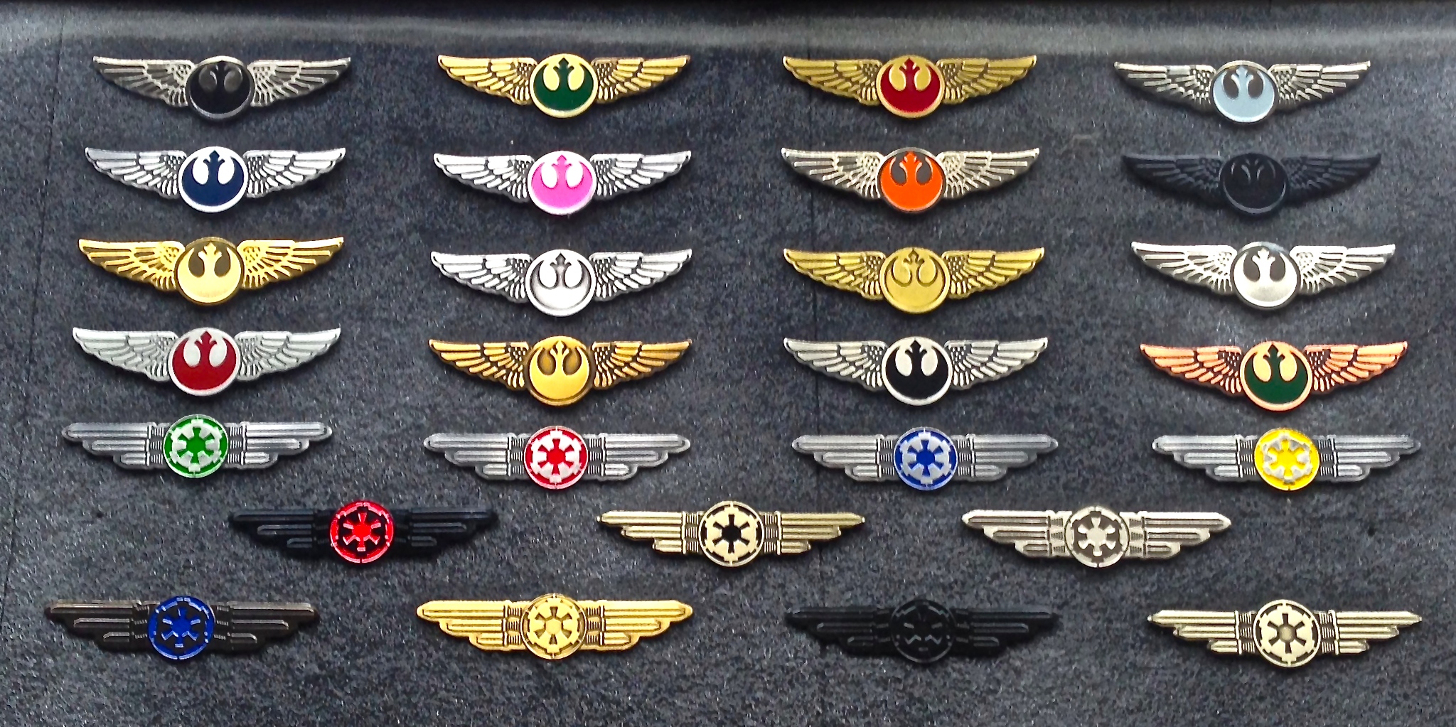

I don't really disagree with anything you are saying. As you can see from my old Imperial Wing pin in the image attached,
attachment.php
i went with a harder line design. But it also played off well against the natural look of the rebel design I created. However this time around with the hard line design go the resistance pin, I wanted to go another way.
I also agree that the upsweep wings tend to be the standard, but it is not uncommon.

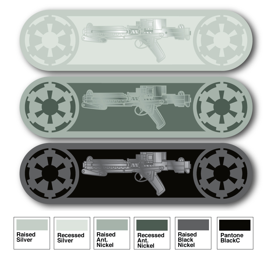

One idea I have is to go away from the traditional idea of a pilot badge (wings) and do something else. Maybe a TIE wing/panel with the FO logo in the center.
I guess the other thing I could do is try something for the FO instead of pilot related. I could rehash an old idea for a infantry style pin I developed but never produced:
