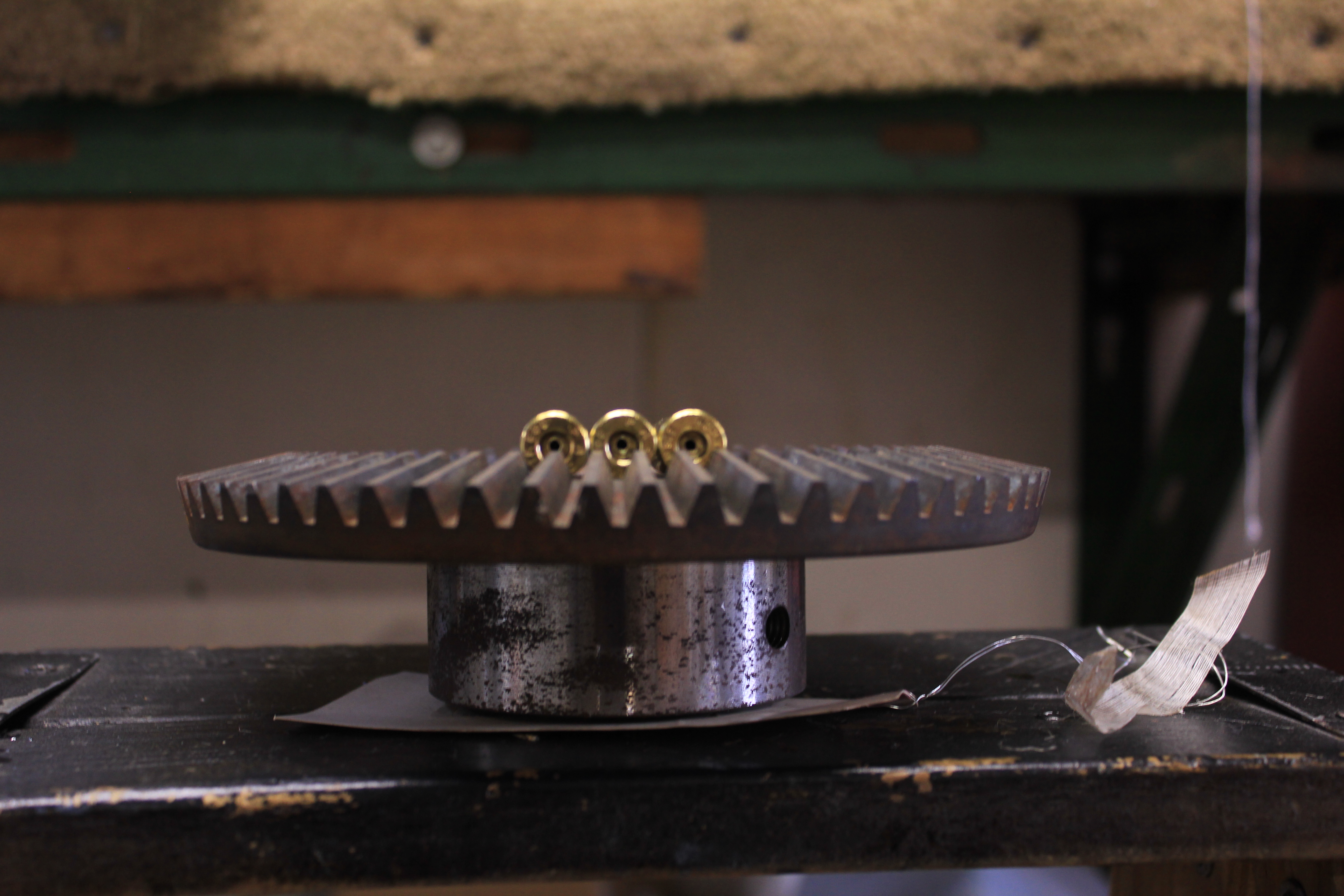

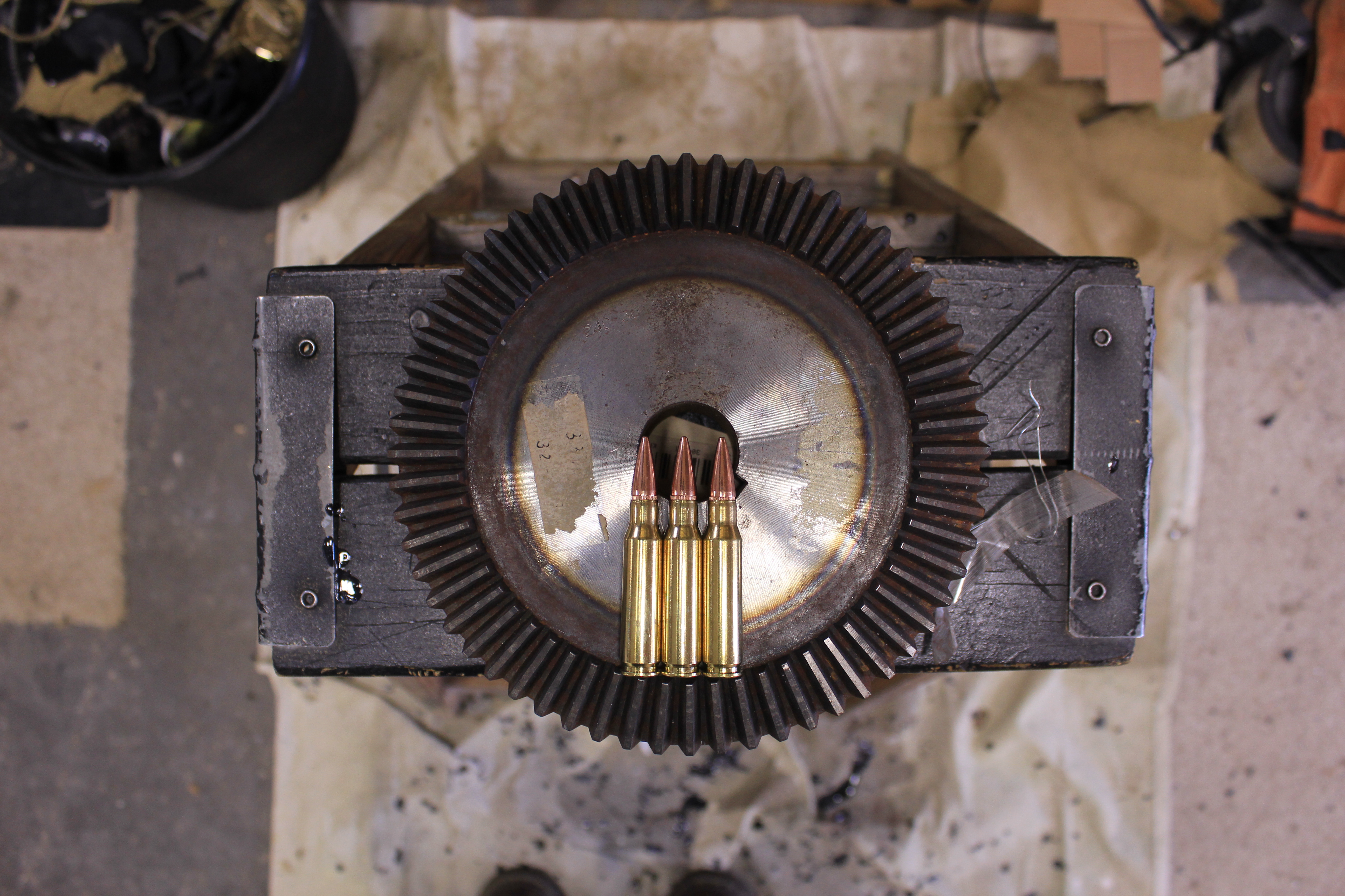

Most of what I did mimicked what @I Make Stuff did in his thread only I was much more cumbersome. Doing some rough measuring, based on sizes of a 308 shell, I figured the wheel is between 13.5 to 14 inches in diameter and that lead to me search for a gear that was 6.5 to 7 in. in diameter. I found one on the 'Bay but it has 60 teeth rather than the 38 the actual thing has but it's good enough for me.

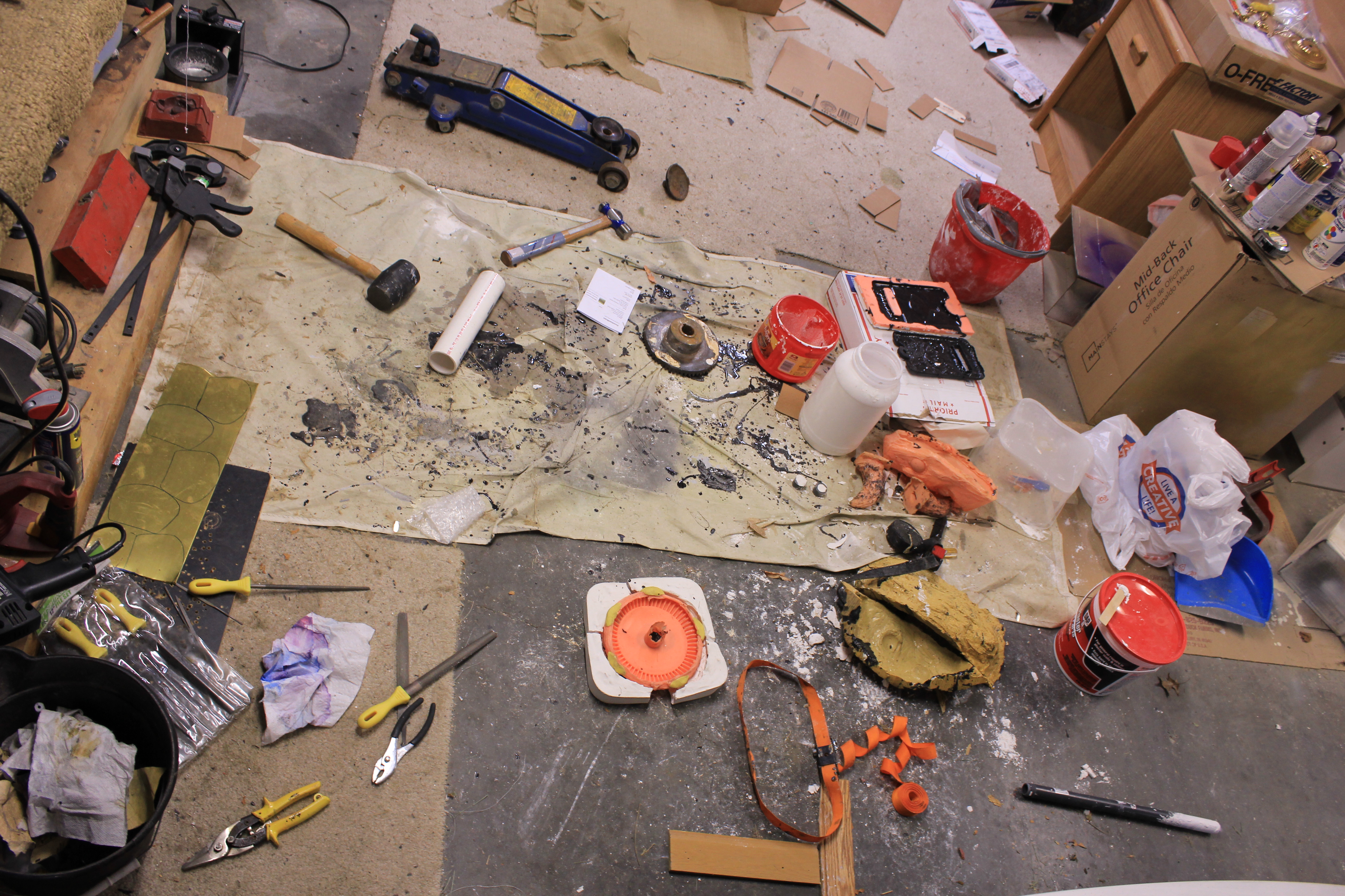

Finding the "right" gear, first off, was tricky but then finding the thing was 9 lbs of solid, heavy, tool steel ruled it out being used. That wasn't a problem but my cold-casting skills were naught before I tried it and it took a good three tries before I got a decent enough pull.
There are no pics of this and the later processes that lead up to where I am now, but if a picture speaks a thousand words, here's this:
...And that's how I got to this:

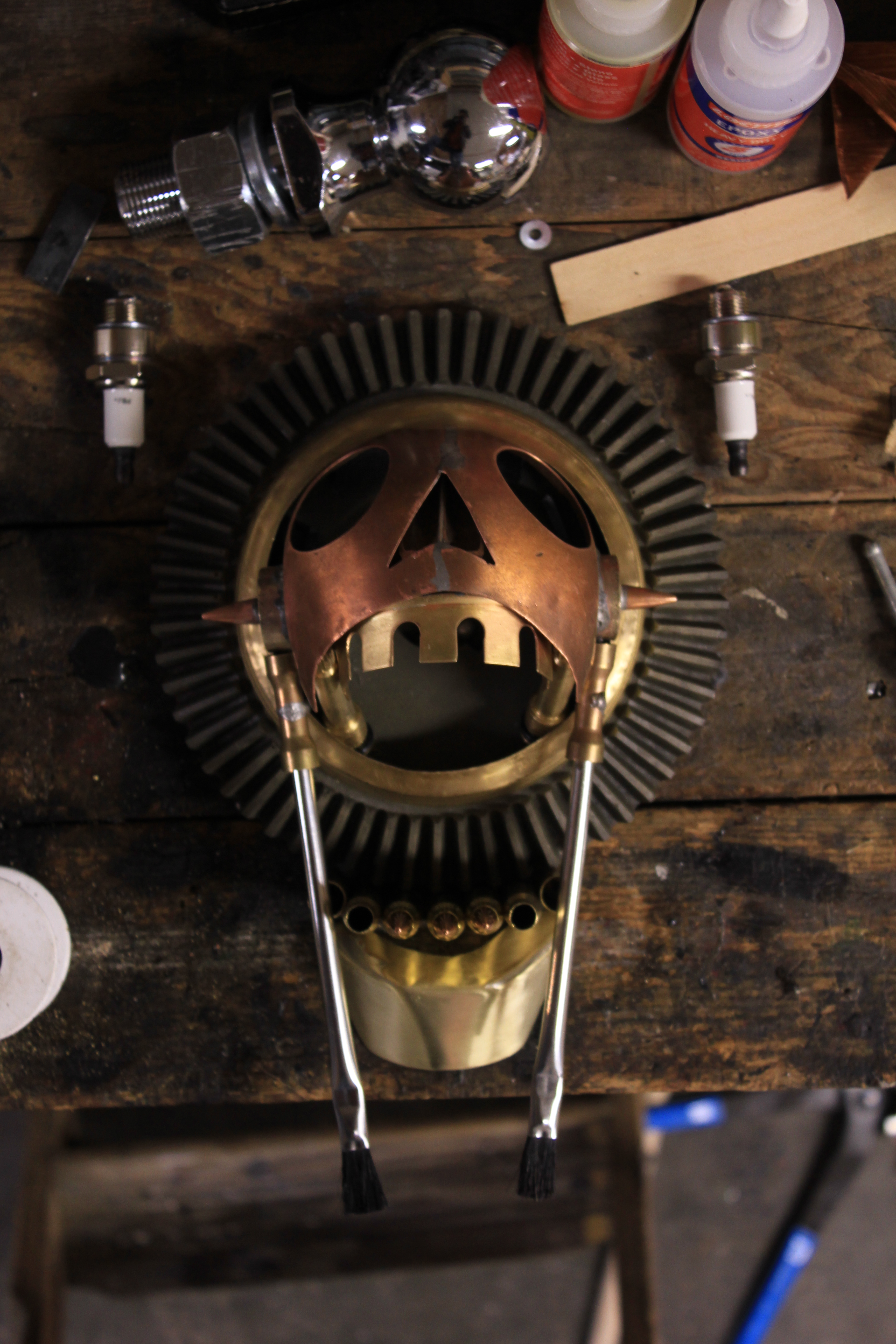

It some some weeks and it's still got a ways to go (I've only got handtools) but it's near the end. I just need to find a way to put in the eyes, put together the jaw and secure it to the rest of the thing, then rust the gear and one final spit shine to get it...well...shiny and chrome.

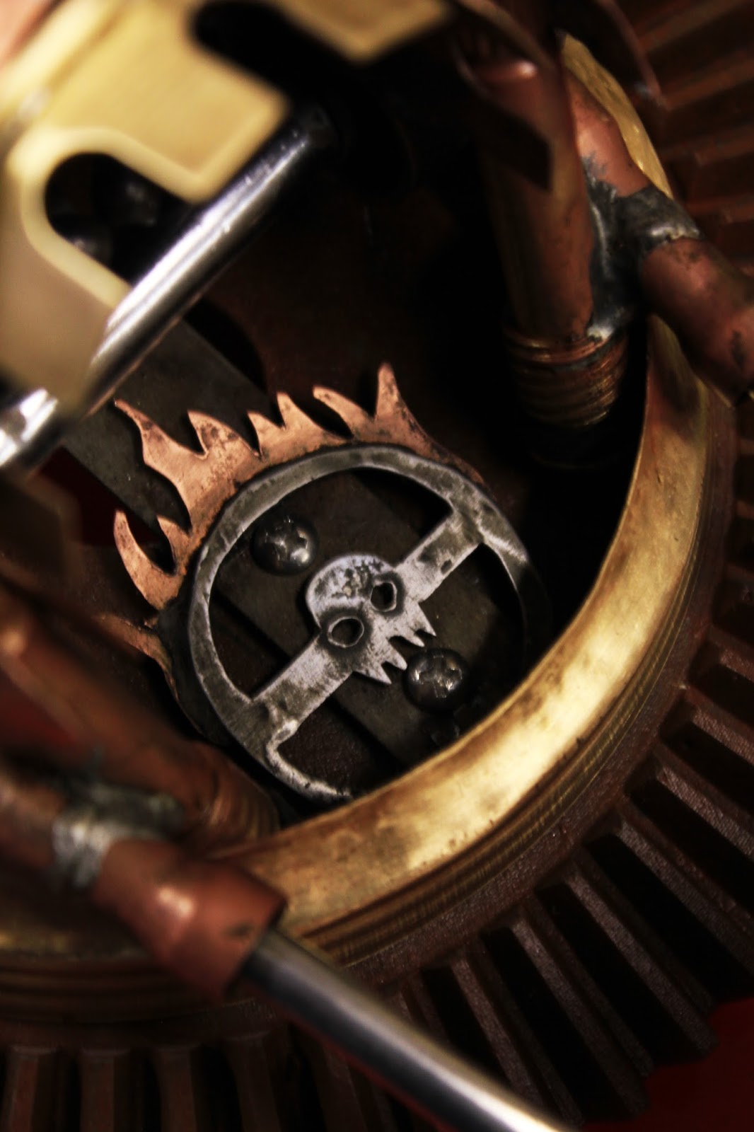

Copper skull and brass bits (that aren't bullets or plumbing/sink bits) were all hand cut and hand shaped to get as closely as I could to the original piece. One can even see how I went about it in the pics above (trailer hitch + hammers + car jack + lots of sanding) but, as of right now, only a few things are soldered and held together; the rest is currently pressure-fitted together. I'm trying to avoid using glue as much as possible and keeping the bonds mechanical just so it feels more...authentic, I suppose is the word...to the world of Mad Max.

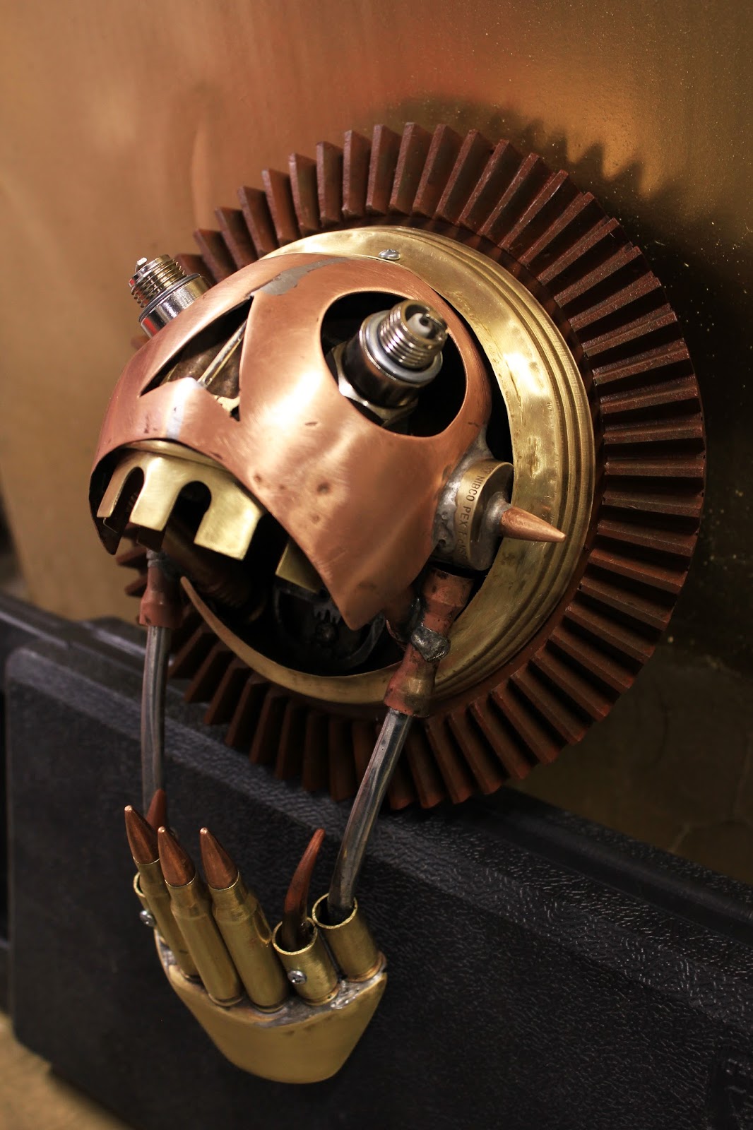

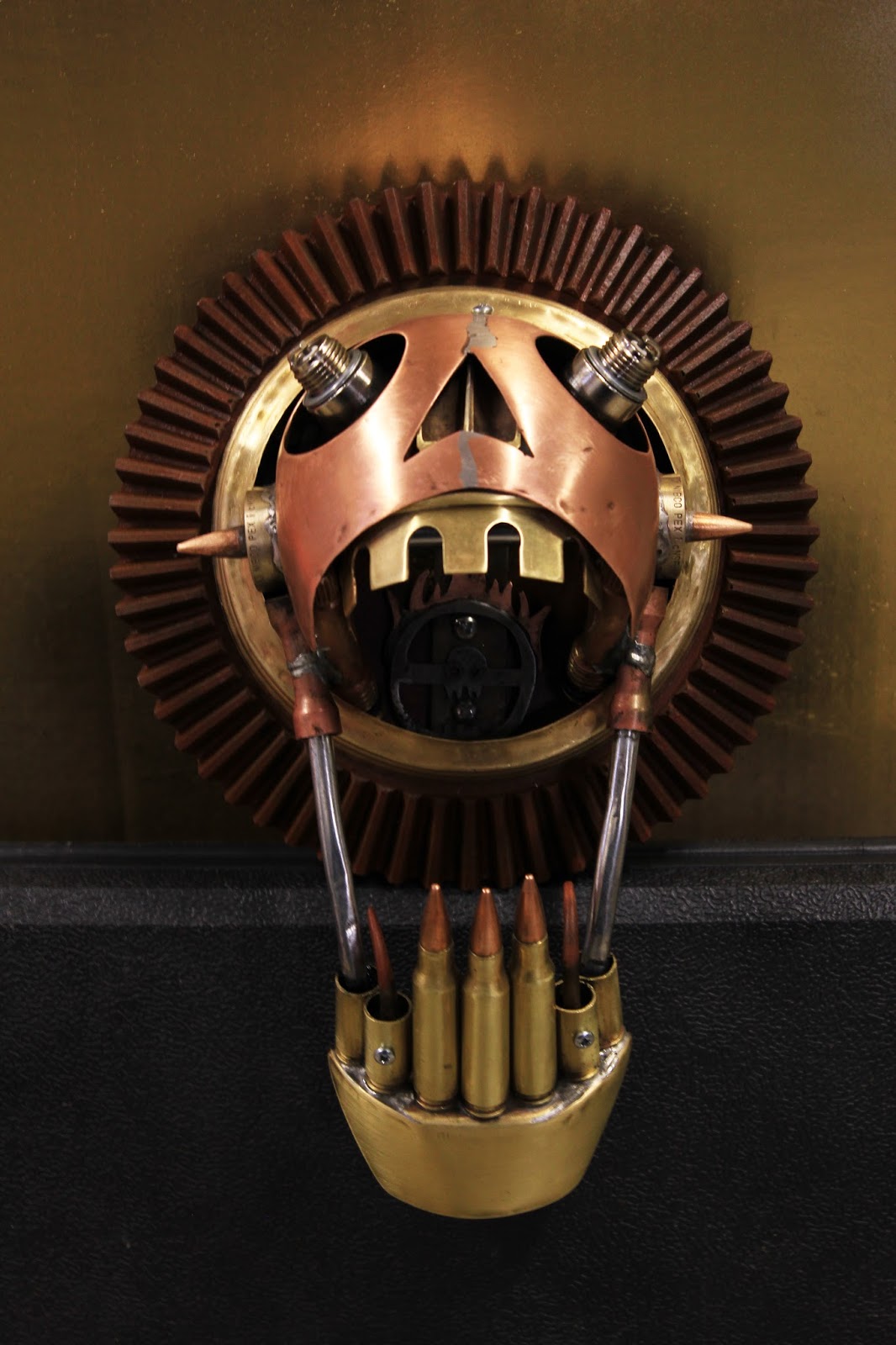

And...it...is...done! WITNESS!

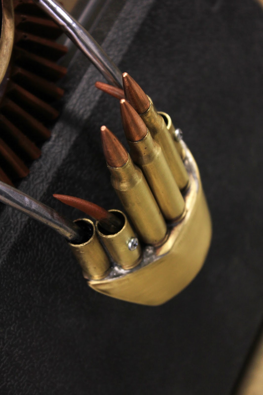

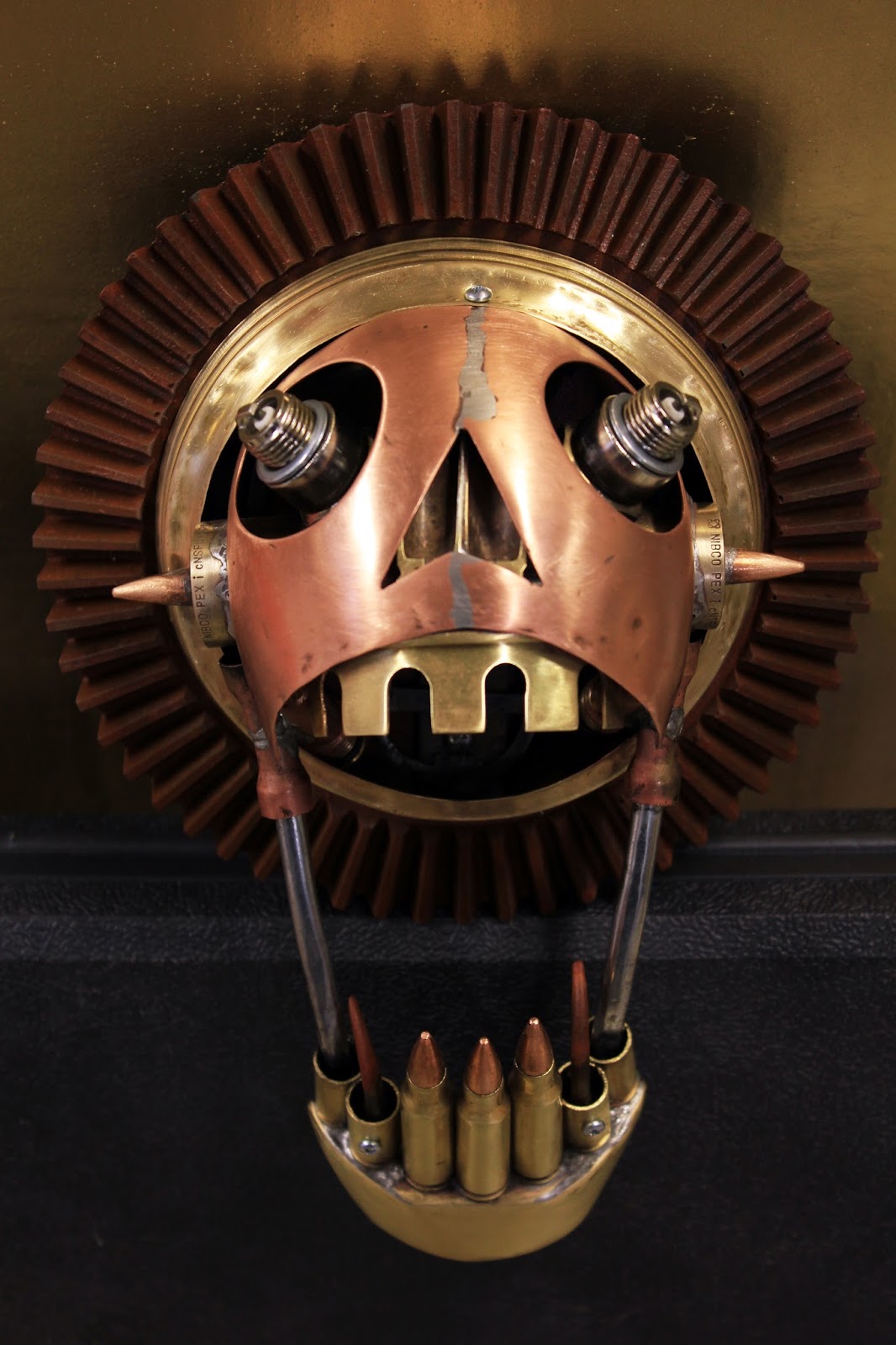

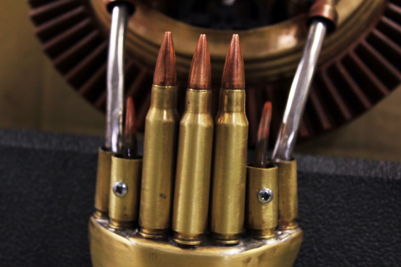

I tried to stay as true to the original piece as I could, used badger claws for the lower "canines" and painted the tips, and the rest is kinda self explanatory. I gave it a few minor touches of my own in certain places (predominantly the Screaming Skull emblem) but nothing that strayed too far from the path. No wreath this time round, I've the right steering wheel, but no way other than a hacksaw to cut the casings, and I can't be bothered to do that.
Forgive some of the messier bits; I have no business playing with metals.:p
