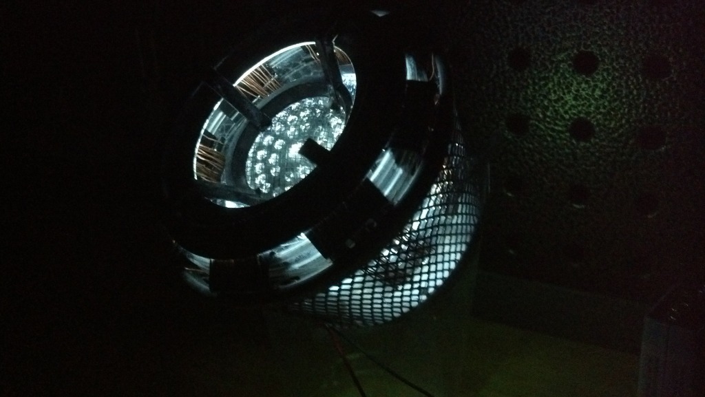

Hey everyone, as you can see I am new here. This is my first official build of any kind. Up until yesterday, I hadn't even picked up glue or scissors since elementary school.
I originally found RPF while searching for an Iron Man chest piece to make for Halloween. Instead of jumping right in to it, I decided it would be better to build one to put on display on my workbench. After researching the forums and Google, I found the dollar store build idea to be perfect to get my hands wet.
All items were purchased yesterday from the dollar tree, with the exception of the hose nozzle that I bought from Big Lots for $2.50, copper wire and medal ring from home depot for $1. Total cost of the build was around just under $10 with tax.
There are some things I would do differently next time. I ran out of copper and would have preferred to have each wrapped section be more full. I plan to build a proper stand for it to be placed on. If anyone is interested, I am happy to list the materials and how-to instructions.
DSCN3148.JPGDSCN3162.JPGDSCN3163.JPGDSCN3170.JPGDSCN3189.JPGIMG_20130716_215023_872_zps0b71350c.jpgIMG_20130716_215042_848_zps5e41df4e.jpgIMG_20130717_111946_344_zps342e32c8.jpg

Step 1: I borrowed the idea from Xrobots to use the clear plastic dixie cups for the inner rings.I cut two in half and used the tops by placing one inside the other. Then place the small binder clips ( 8 total ) over the top edges of the cups and clamp down. Once they are all on, I cut the copper into about 1.5 foot sections and split the strands. I used 3 strands per clip. You can tie them in to the clips and wrap around the edges. When you are done it should look something like the first picture. It fits perfect inside the metal basket. Note: This is the most time consuming step.
Step 2: Flip the metal basket over and place a dime directly in the center. Trace the dime and drill out a hole that size. This is where the LED light will sit. Flip the basket back over and place the bottom part of the hose bib, over the hole on the inside. This should line up perfectly in the center. You may hot glue this in place but I chose to use super glue. Allow to dry. See Pictures 2, 3, and 4.
Step 3: Take the top part of the hose bib and saw off the bottom piece with the nut in it. You will now have a whole in the bottom. Measure the diameter of the whole and cut the sink strainer and mesh from the strainer tools to the exact circumference. Super glue these two to the bottom of your hose nozzle. Flip this over and super glue to the metal ring. See photos 5, 6.
Step 4: When the top piece is done drying, it should fit perfectly on top. I chose again to super glue the top to the rest of the reactor. I mostly did drops of glue on top of the copper coils. The top will look like picture 7.
Step 5: Take apart the LED light and you should be left with the light, some wire, and the battery pack. It comes with a miniature button to turn the unit on and off. I flipped the reactor over and hot glued the light to the bottom hole. Picture 8.
And there you have it. I know my instructions may not be the best. Please let me know if you have questions. I would be happy to help.
