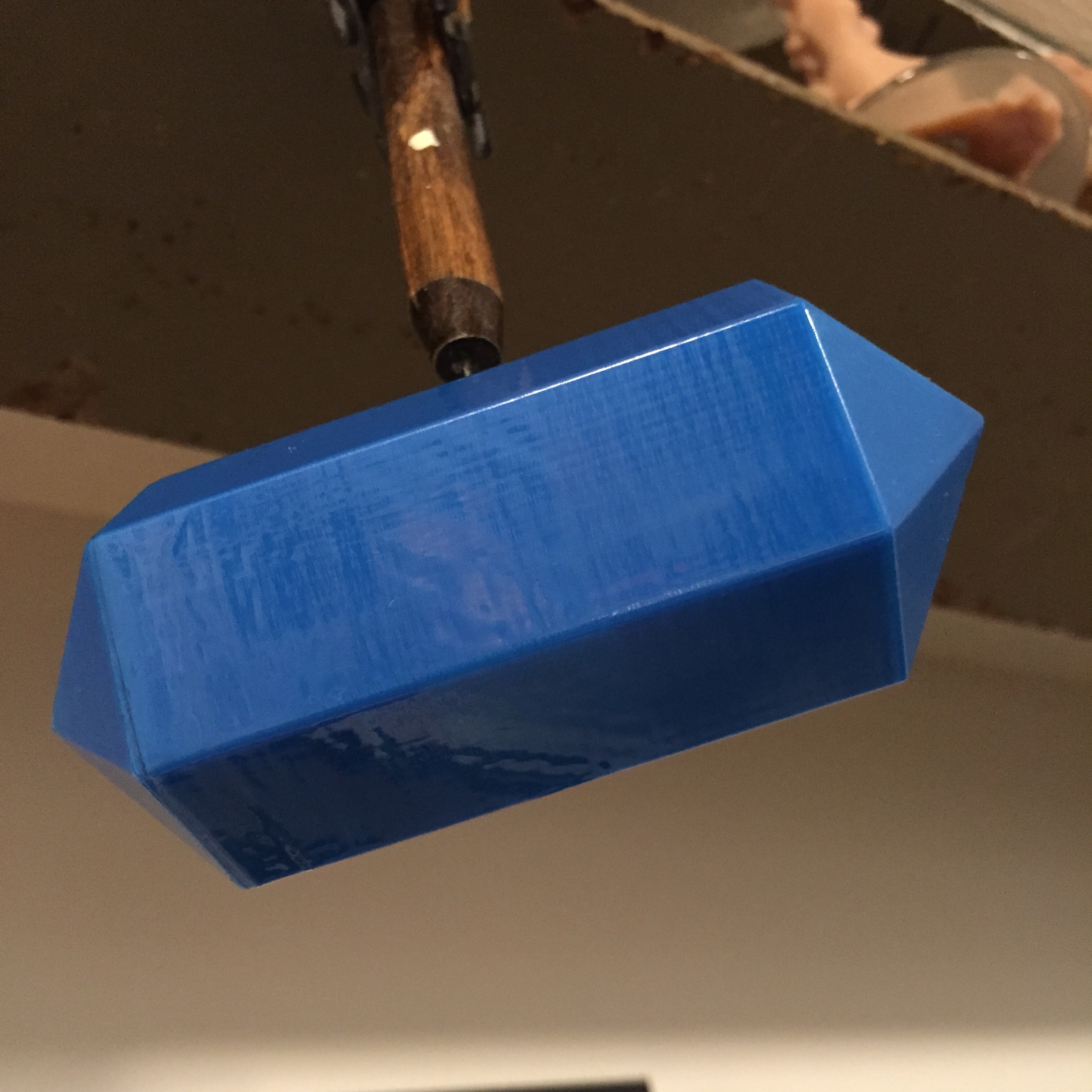

After getting to a place I thought was spot on, I vapor bathed the piece trying to shine it up. It met with some positive results.
But I found that, even though it was smooth-ish, there was still a lot of unevenness. So sanding, polishing, more vapor bathing got me to what I thought was pretty good.
But when it came down to it, it just wasn't shiny or smooth enough for molding. I've had a lot of experience with casting clear resins (I make the Key to Time segments), so I wanted to create a mold that required as little post work as possible.
A friend put me onto a sprayable bondo called Smooth Sand. Wasn't cheap (but I got to buy new toys!), and I managed to get a pretty even coat, and then sand it down to a mirror finish.

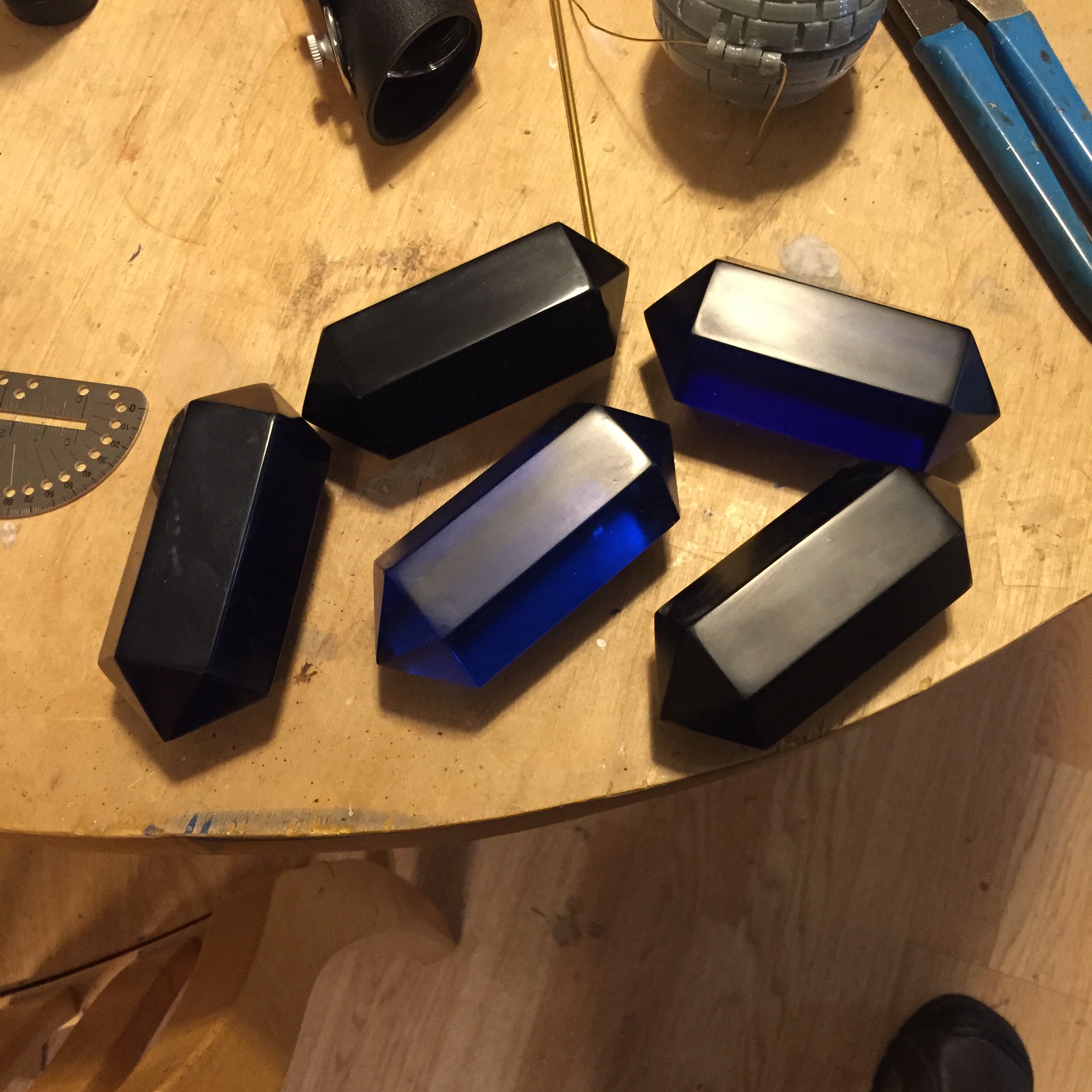

I molded it in Smooth On's Mold Max 14NV. I degassed it even though you don't really need to, just to ensure a great mold. Left one facet open for pouring. Figured that would be easier to smooth out rather than trying to inject it and deal with sprues.
SUCH A PRETTY MOLD! So smooth.
My first pour was with tined Smooth Cast 65D, but it just kicked too fast to be able to pressure cast it.
Hate when that happens.
So I ordered some 67D and it works great.

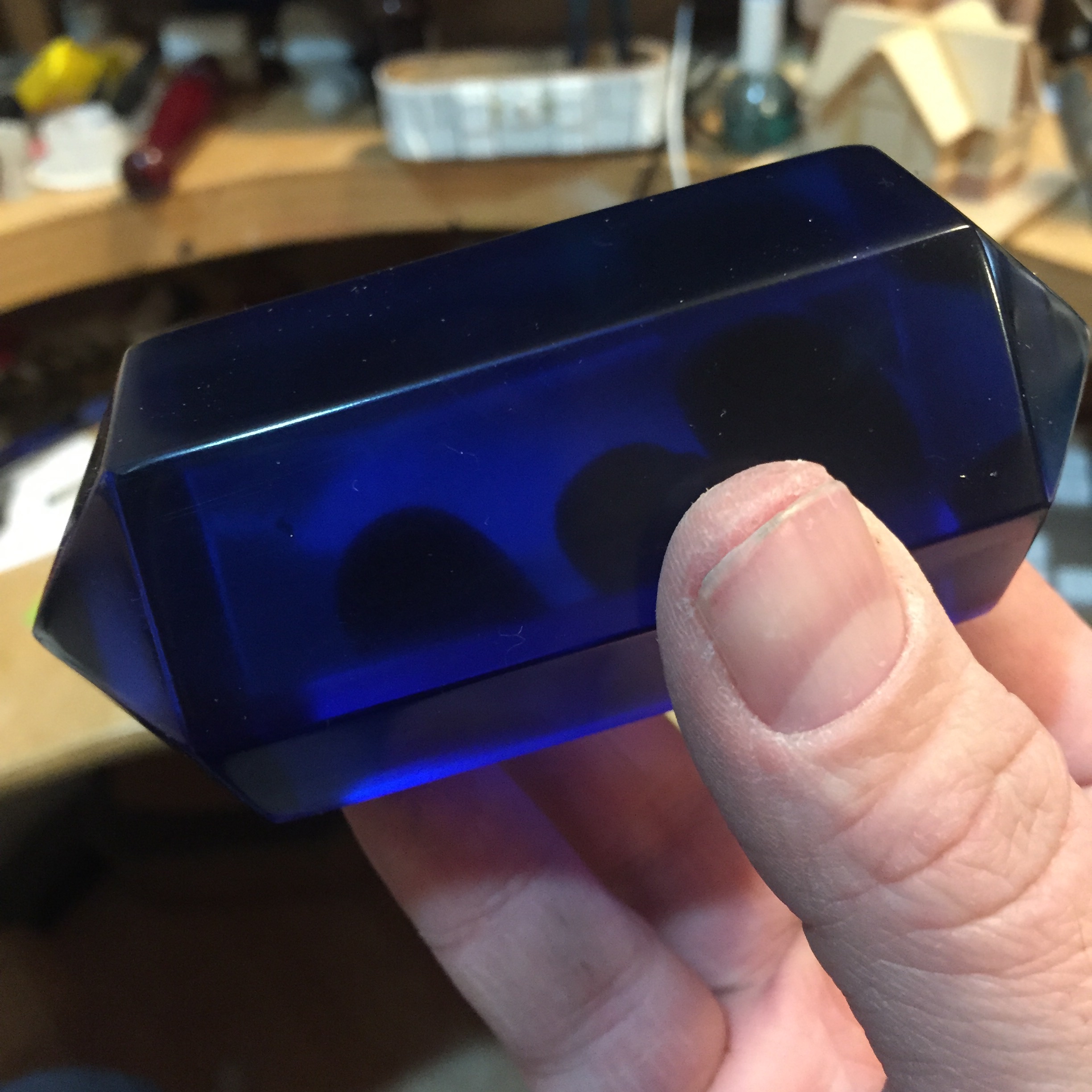

Then it was on to color matching. I found that it takes about 5.5 ounces of resin to cast the piece (I make up 6oz so that I don't pour the dregs.) Even at one drop of tint at 6 oz it was too dark and hard to see through. So I've been cutting the drops in tenths using one drop of tint in a separate bottle with 10 drops of Part B of the 67D. Figuring out the best ratio has been a challenge (especially since I have to wait a hour or so between pours for the resin to cure.)

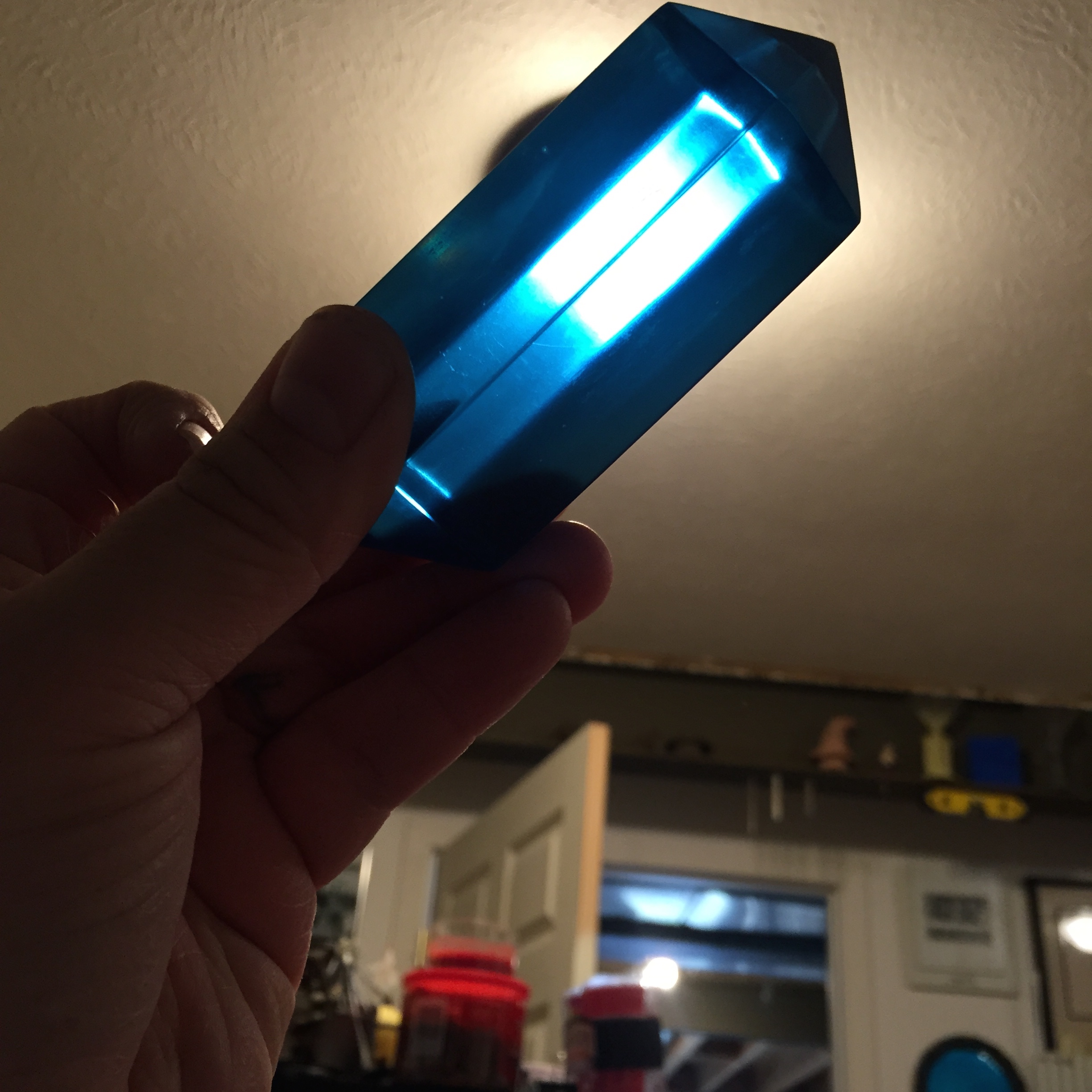

But I think I finally got it. Here's the final piece. Think it turned out pretty great.
Nice and clear! What do you all think? I'm not quite at my 50 posts, but when I get there I will probably post and interest post since the mold is ready to go.
