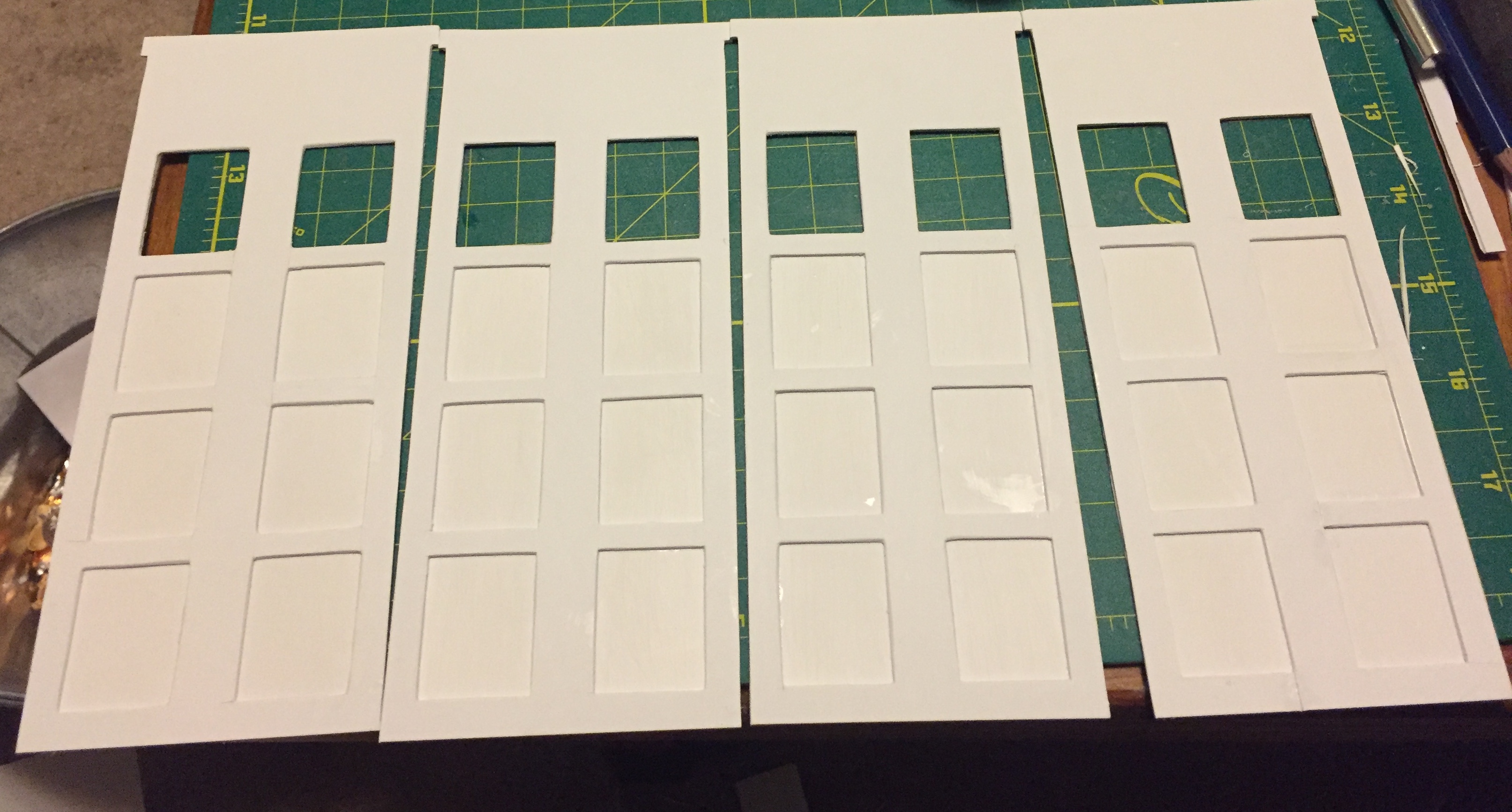

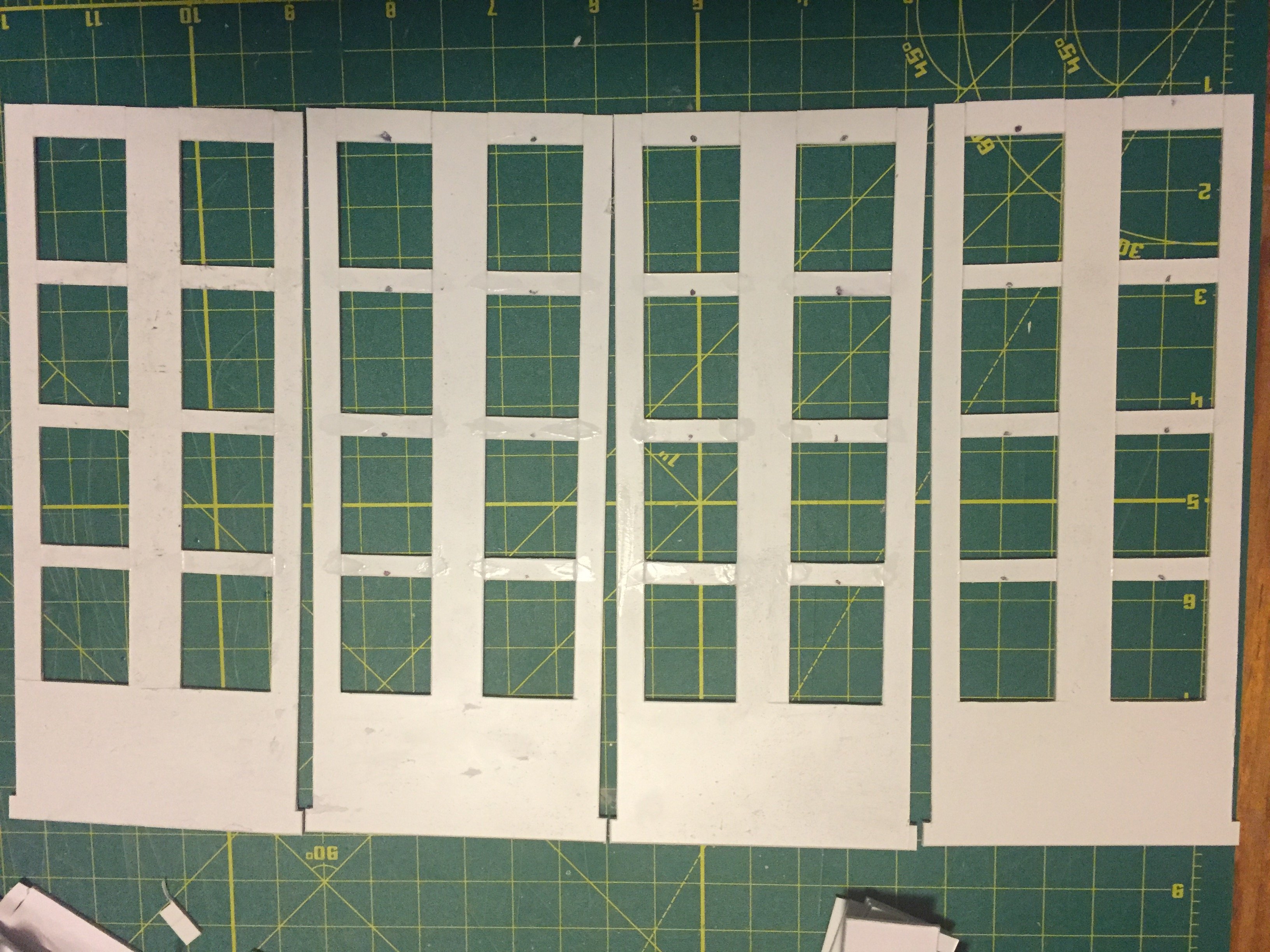

To start out, I went over to tardisbuilders and found the dimensions of the Hartnell TARDIS, scaled it down to match some styrene pieces I already had (and that scale was around 1/13 scale) and drew some cutting templates in photoshop. I used spray adhesive to adhere the templates to the styrene sheets, and started by cutting out the side paneling. I then glued it to a backing of styrene, though I should have probably also put some backing where the windows were since I now plan on making a mold. Took me a couple times to get it right.

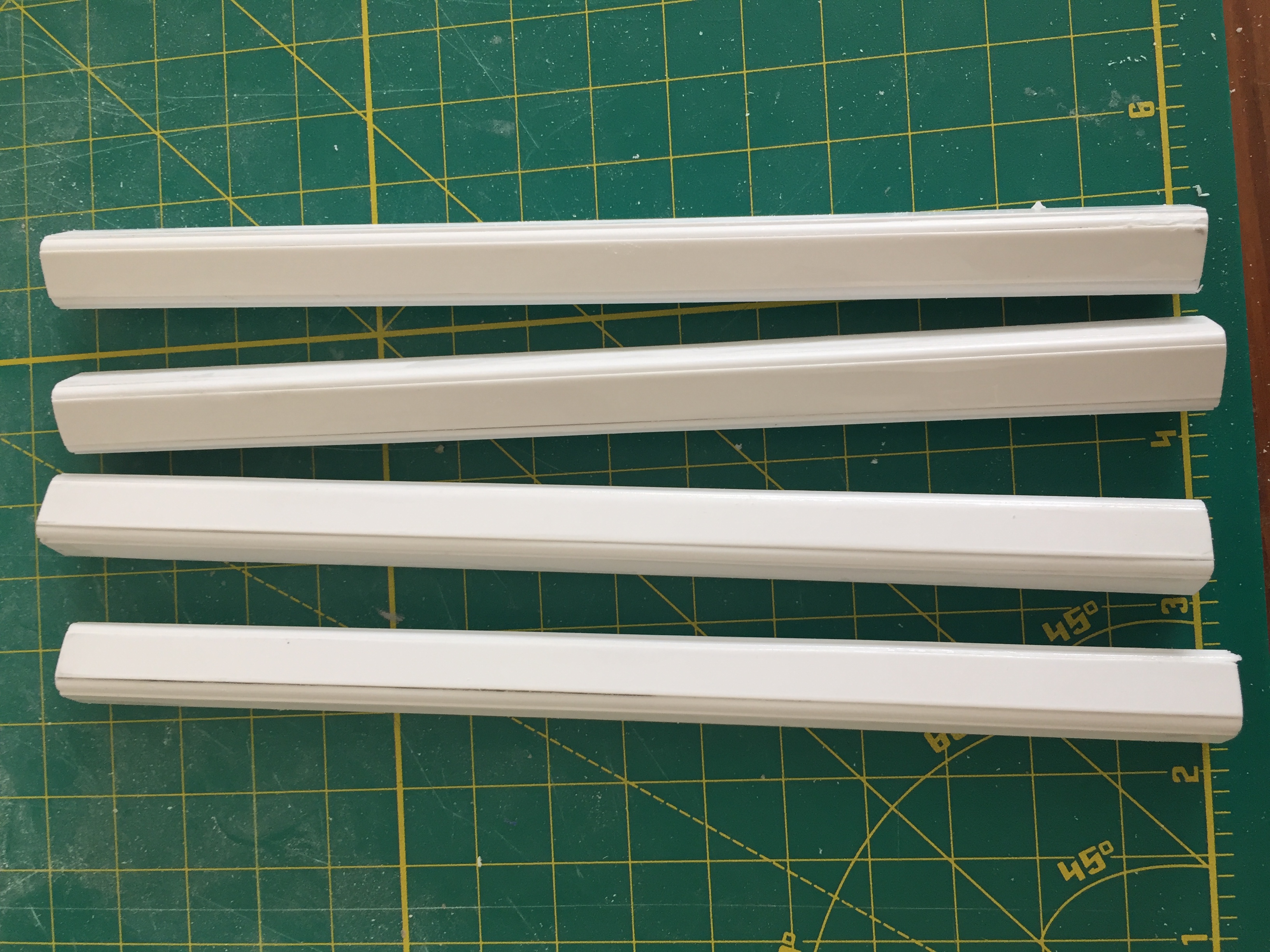

Then I started working on the posts, which took longer than expected, as I had to order some more styrene quarter rounds, then re-order it as I bought the wrong size by mistake.

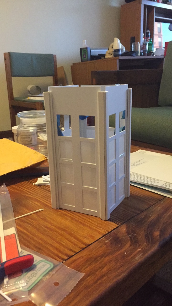

And while waiting for the extra pieces, I decided to tape the panels to the posts just to see how I was doing so far.

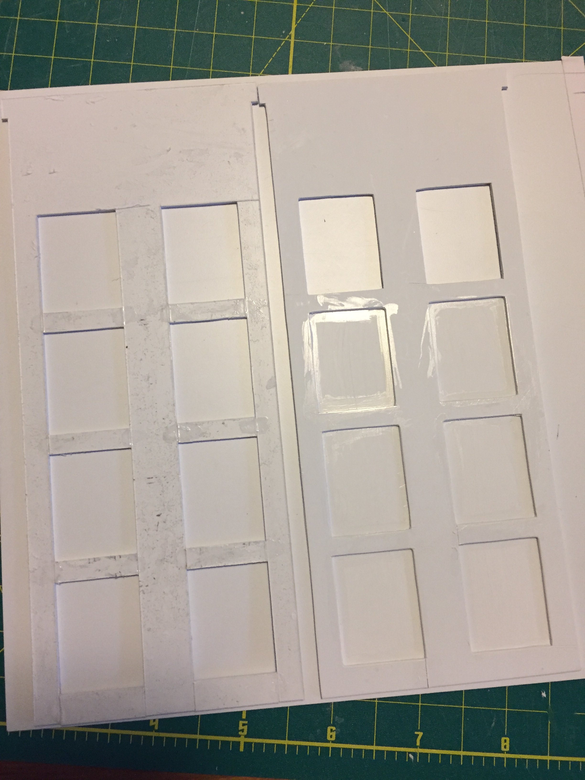

I thought it looked quite nice, BUT I wasn't completely satisfied. Because I'm a self destructive, persnickety perfectionist, I decided to re-do the side panels. Cutting and filing the rectangles individually ended up with slightly rounded, uneven edges that don't look so good with the windows. So instead, I cut the entire section vertically first, then cut the vertical planks and lined them up with the cut out rectangles, and glued them to the main body of the panel. Its a nice, angular result, and is sort of assembled like the actual wooden box.
Old panel on top, new panel on bottom. Will clean the bits of paper/sand down lifted edges later.

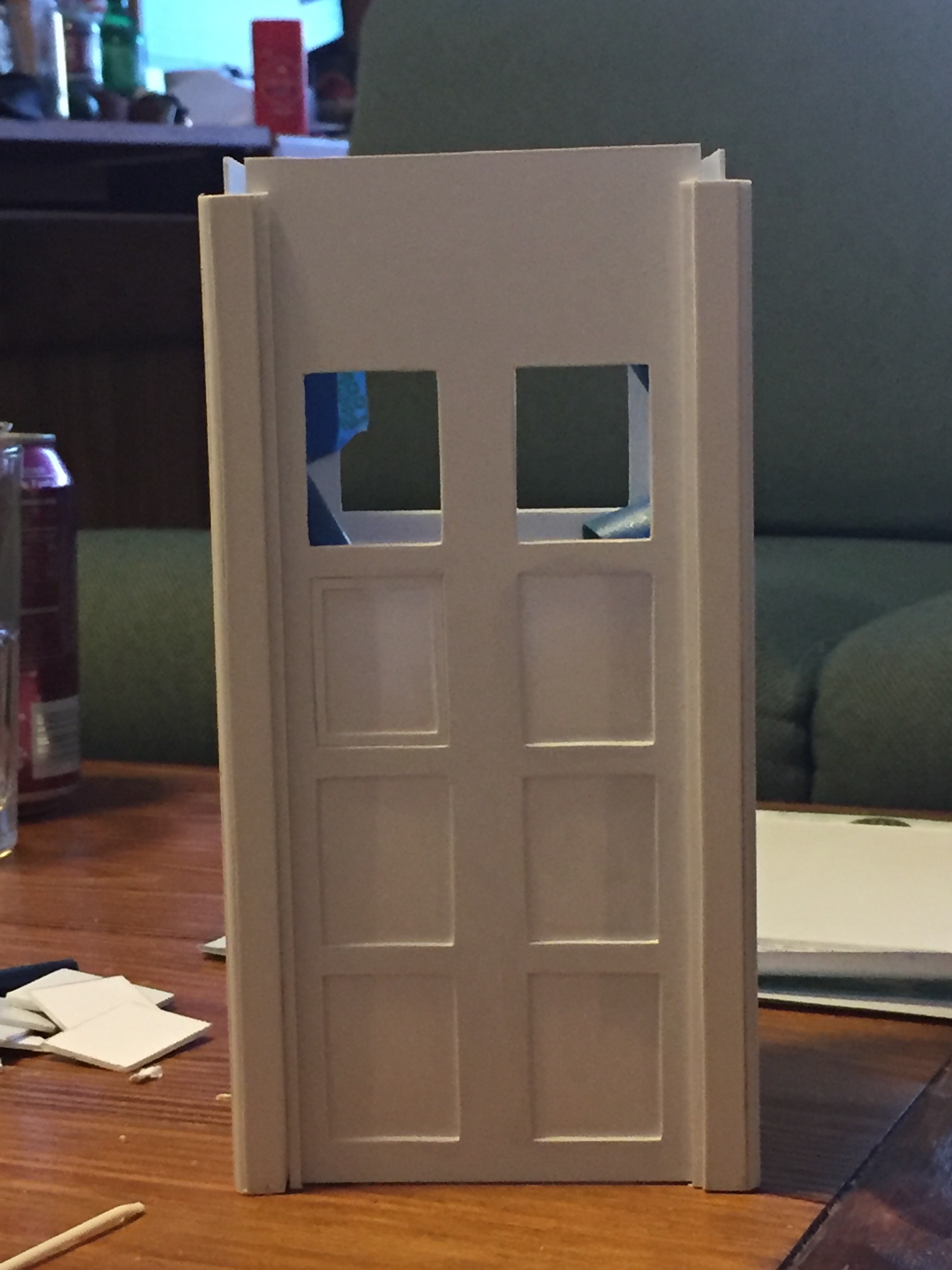

Finished re-making the side panels. I think they came out much better this time around.

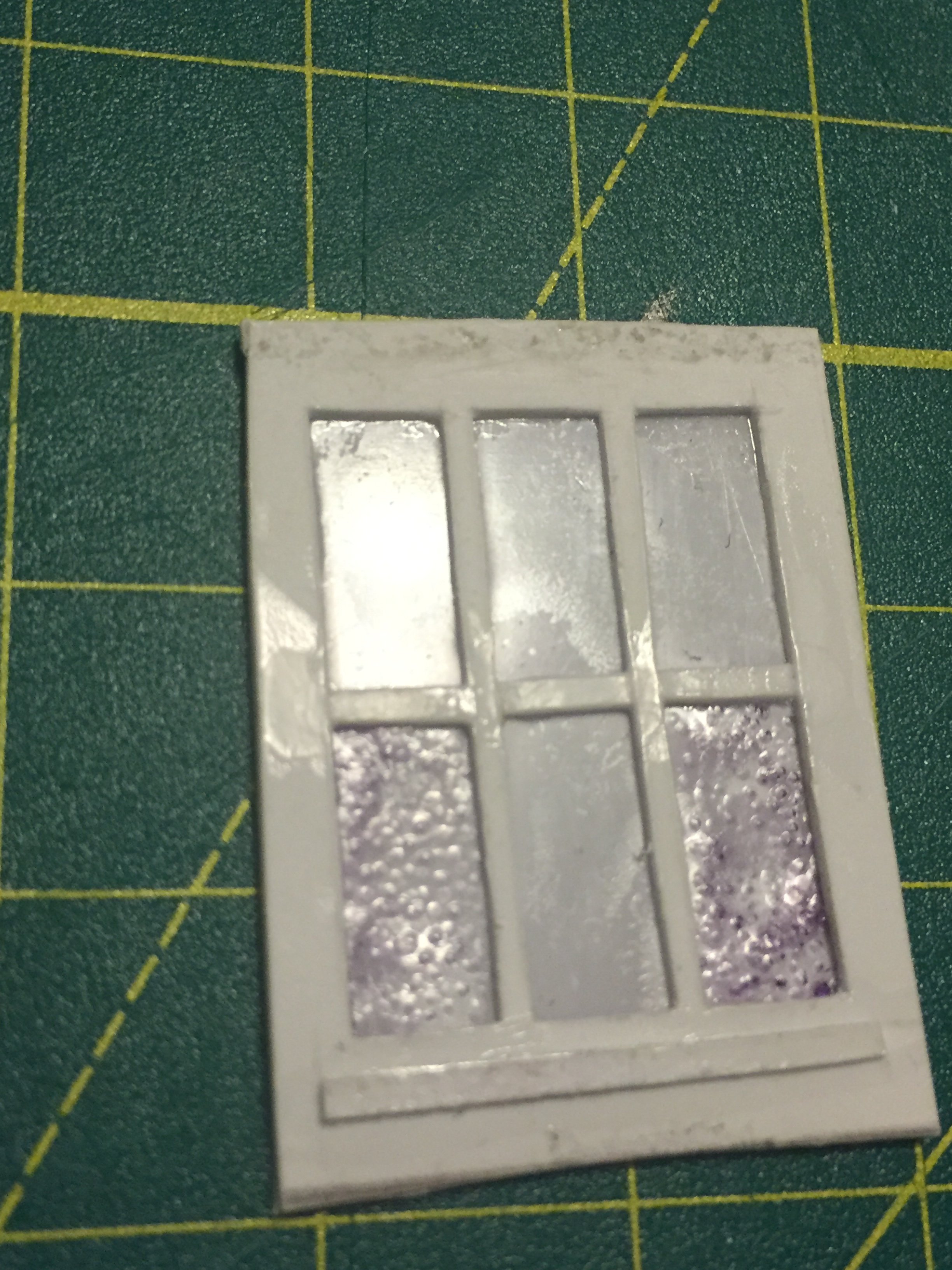

Also decided to mold the windows separately, cast it in clear resin, then paint the windows white. Now the question is whether to mold only one, and cast each one individually, or mold several and cast all at once. The first option has less work before molding, but more of a wait post molding. Second option has the opposite.
Realized I can make a decent pebble texture on the window by poking the reverse side of the sheet with a pen.
