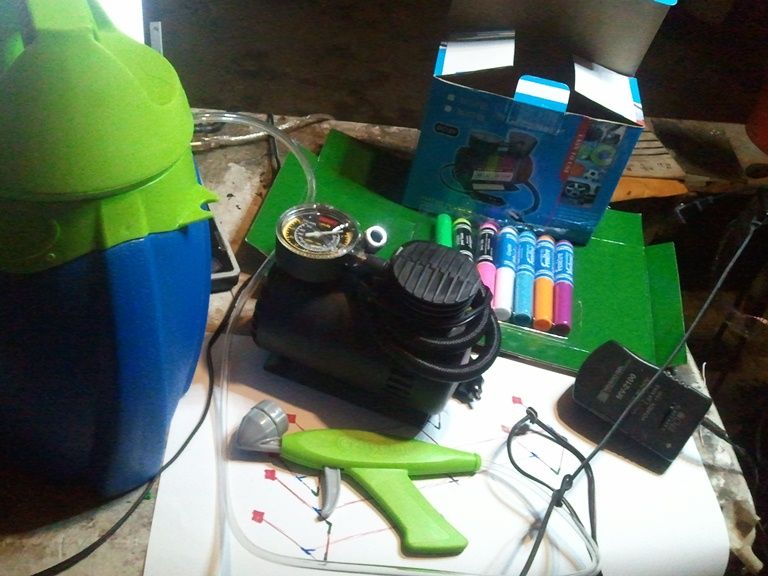

So heres the set up.
Using my mulit- knife i unscrewed the screws. They are Triangle head. But the flat head on my mulit knife fit just fine.
Once you get the screws out. (4 total) Use a flat head to pry it open. Its tab glued together so it may take some patience to work it through. Dont rush or youll end up shattering it.
Just take your time...
After you spilt it, it should look like this.
Now a nice add one from the DC compressor was that it came with 3 nozzle tips. Use the center one.
Next you can remove the front nozzle . It slips out with no trouble.
Using the insert tip nozzle, you can inject it into the spray nozzle tip. For me it fits in pressure snug.
After a while you get something like this
After that I inserted the marker, and by adjusting the voltage I can get between 3d paint. or spray paint. I can mod it for the gun to be fully used. But its an easy diy build that i enjoy using .
Hope someone finds it useful xp.
