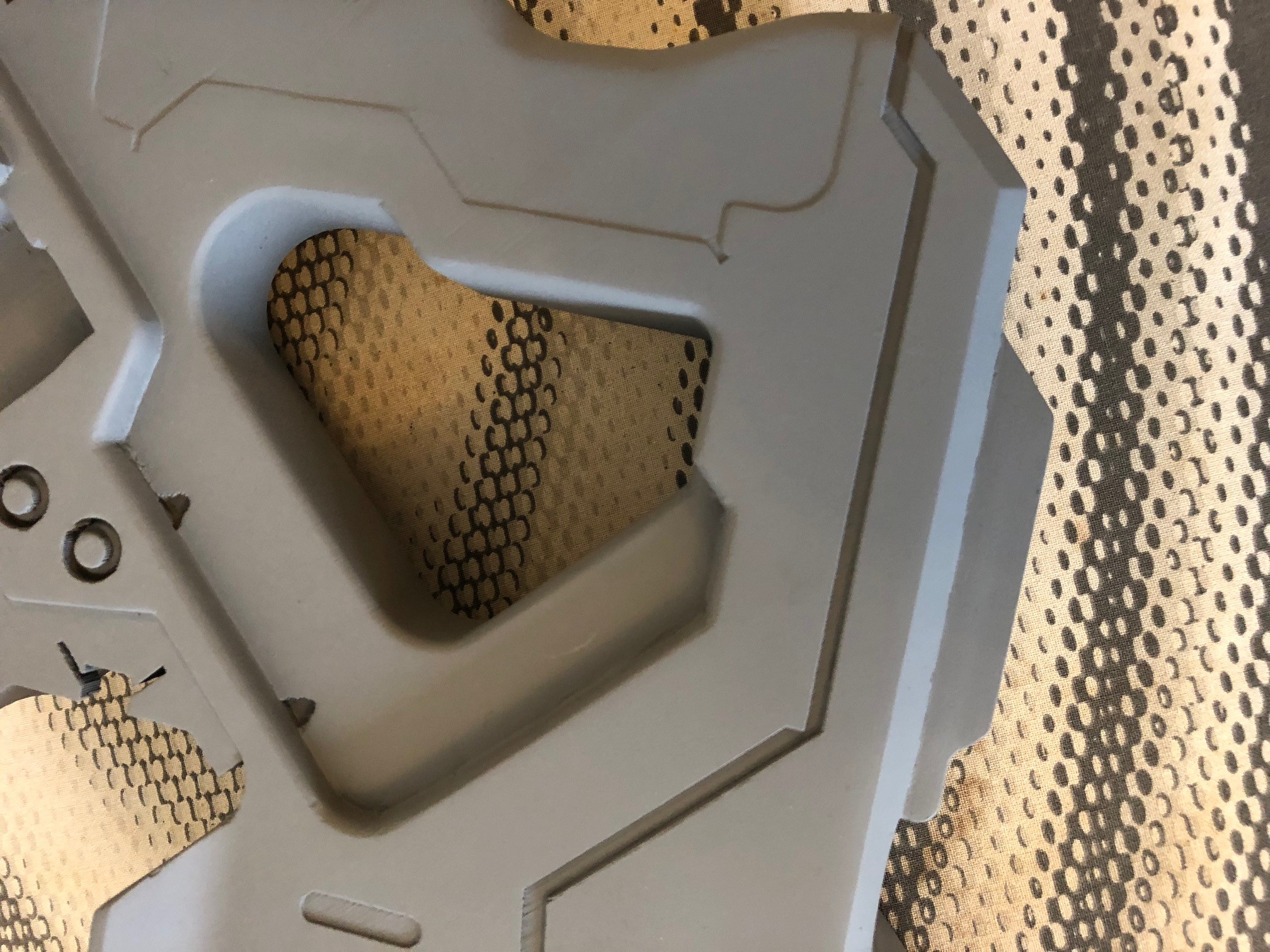

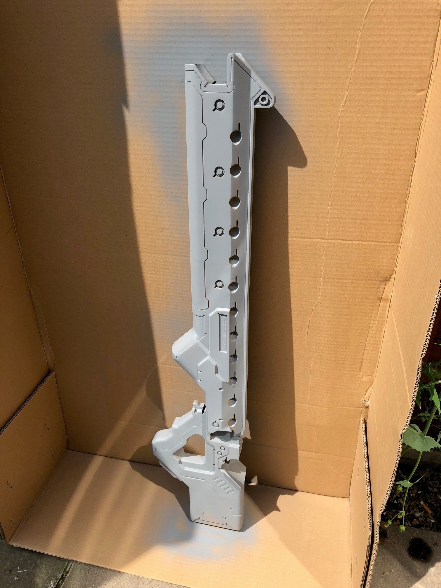

On receipt of TMax's stunning AR kit, I've charged straight into building it. For those of you with kits on the way, whether it's the AR or one of the others, be aware, there's lots of sanding and filling to be done to get a great finish. But that's fine; that's what we all expect from a 3D print, and this kit obviously has a lot of parts! The parts are all beautifully printed and the barrel pieces can be done, to a large extent, with a small electric sander. Keep the Dremel locked away though - way too aggressive on the plastic! Otherwise, it's a case of putting aside a lot of time to sand, prime (with high-build primer), sand again, prime again, and so on.
In terms of filling joints and covering blemishes, I found great results using Humbrol Model Filler, and I used Halfords Plastic Filler Primer, and regular grey primer (also Halfords) for a final coat ready for painting. If you're in the UK, those brands will probably mean more to you than if you're elsewhere. Oh, and for joining the main parts together, I used RS Components' Structural Epoxy Adhesive (918-1401).

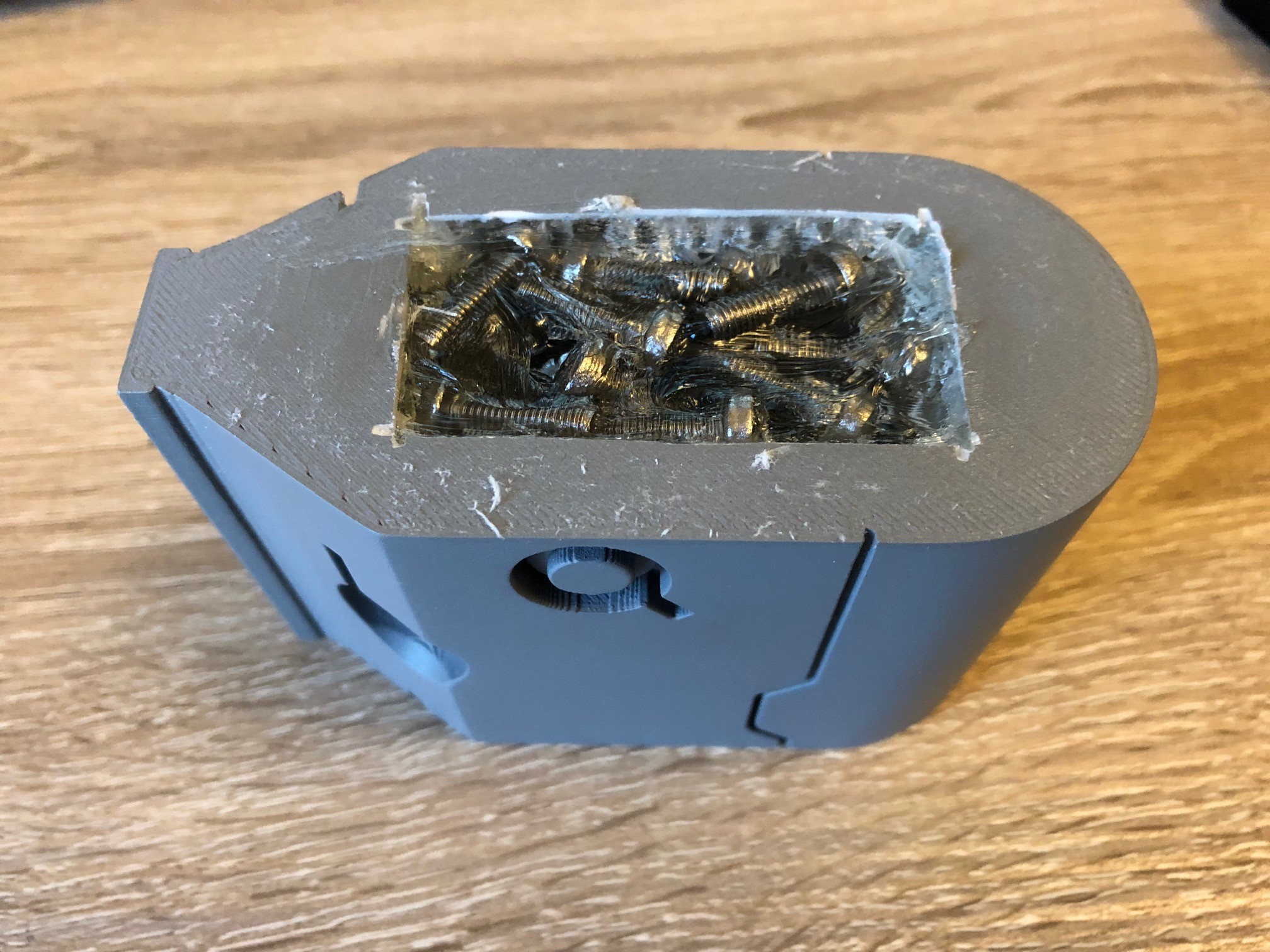

I wanted to make the weight of this thing proportionate to its size. So, I cut into the mating surfaces of the main parts, leaving enough material around the edge for when I joined the parts together. The supporting structure inside is easily removed with a battery drill.
Then I simply threw in whatever metal parts I had to hand with some adhesive. I added adhesive before, during, and after I added the metal parts so to avoid any annoying rattles on the finished prop.

I love the idea of using an adhesive set with metal in. What type of adhesive are you using? Would a glue gun speed things up?
Hi Dreamscape - I've been using an adhesive that comes in those cartridges similar to bathroom silicone. But actually, a hot glue gun sounds a better idea!
So long as the hot glue doesn't affect the print, i think it will dry quicker than a silicone or similar adhesive.
Hot glue is fine for this sort of thing as it’s just the internal surfaces of the kit and won’t cause any damage. And yes it will dry a lot quicker than a silicon without expanding either which is important. I too might try adding weight like this to my SMG kit. [emoji1360]

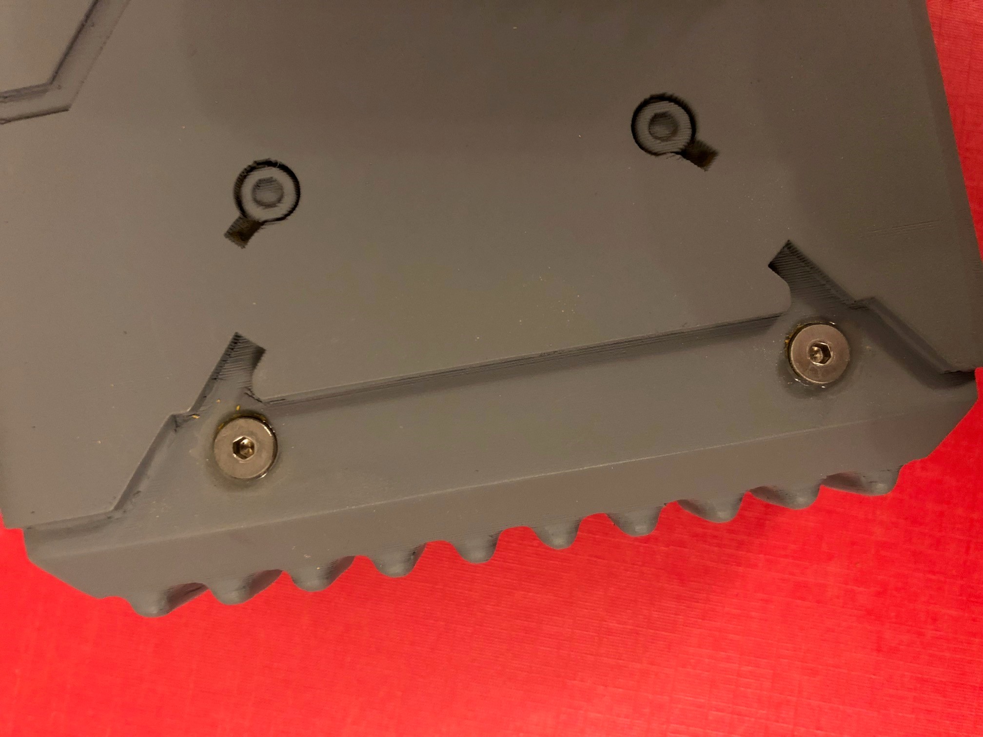

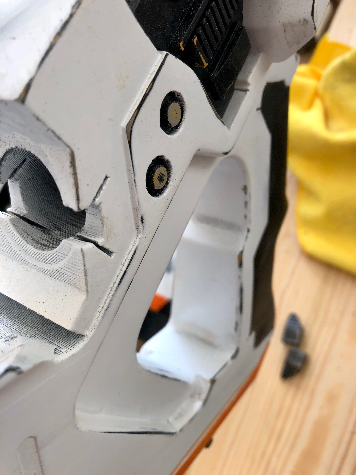

I was looking at photos of the original prop and noticed a couple of additional details that it was worthwhile to add. The first of these was additional screws on the shoulder stock.

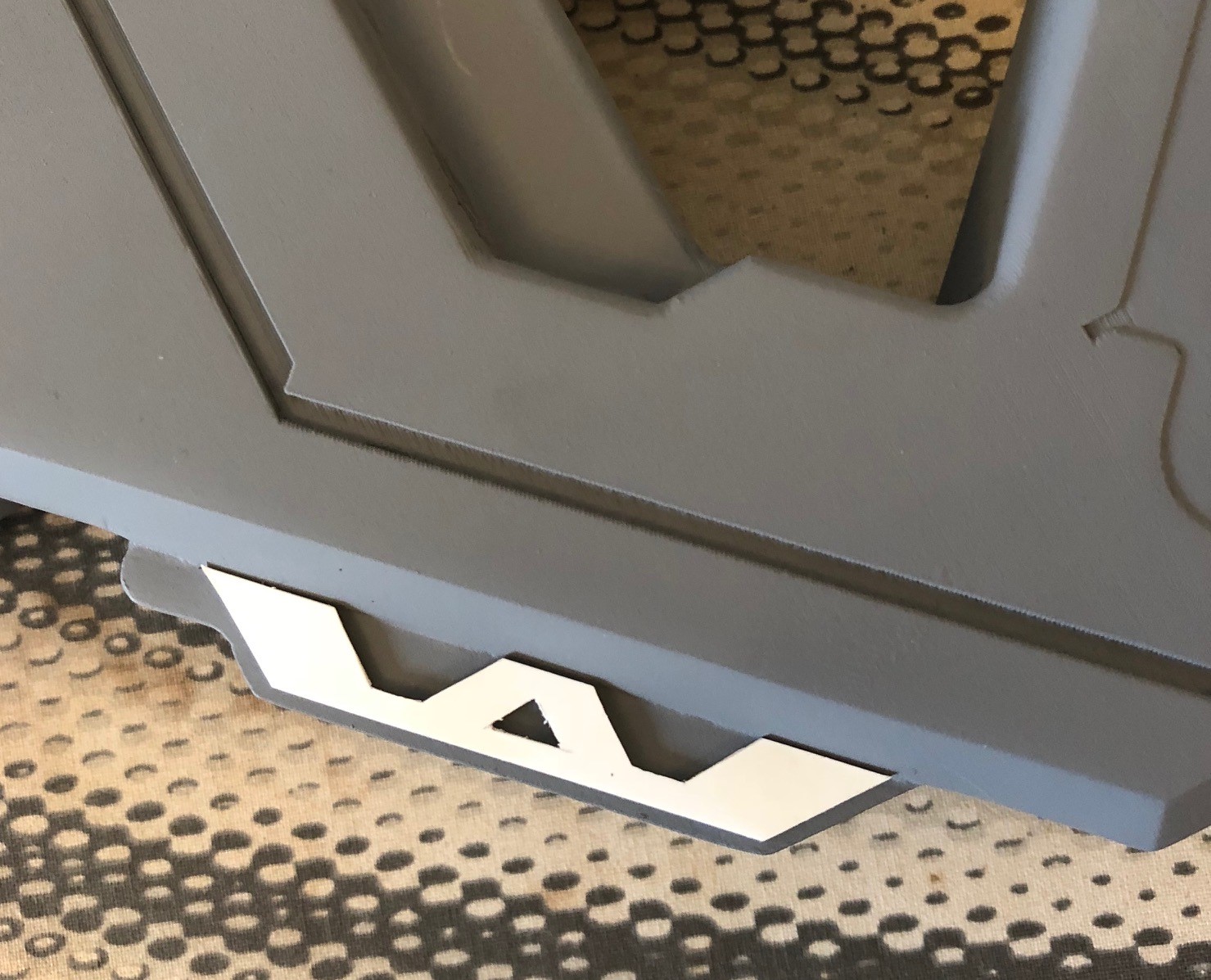

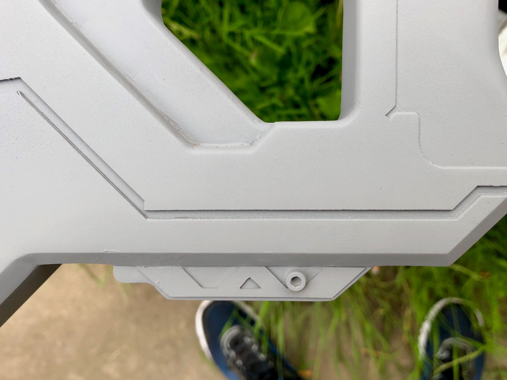

Then, underneath the hand grip, there appears to be a little more detail. The photos I was looked at were a little hard to determine clearly what was needed so I came up with an approximation of what I could see.
Good spotting and great work-around! Both these details are already on our SMG kit and will be on future AR kits.

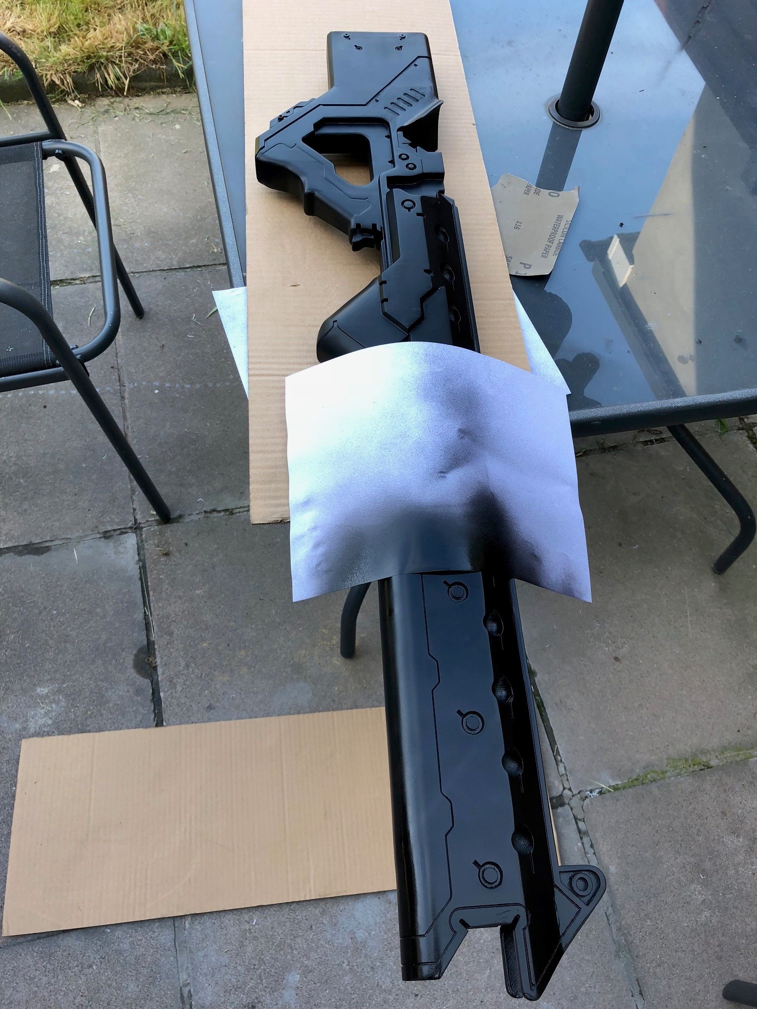

I've sprayed the whole thing satin black, with particular focus on the parts that will remain black (which I'll be masking off when I apply the white paint). Later on, part of the weathering process will be to wear away the white or orange paint so that the black shows through either as wear or as scratches..

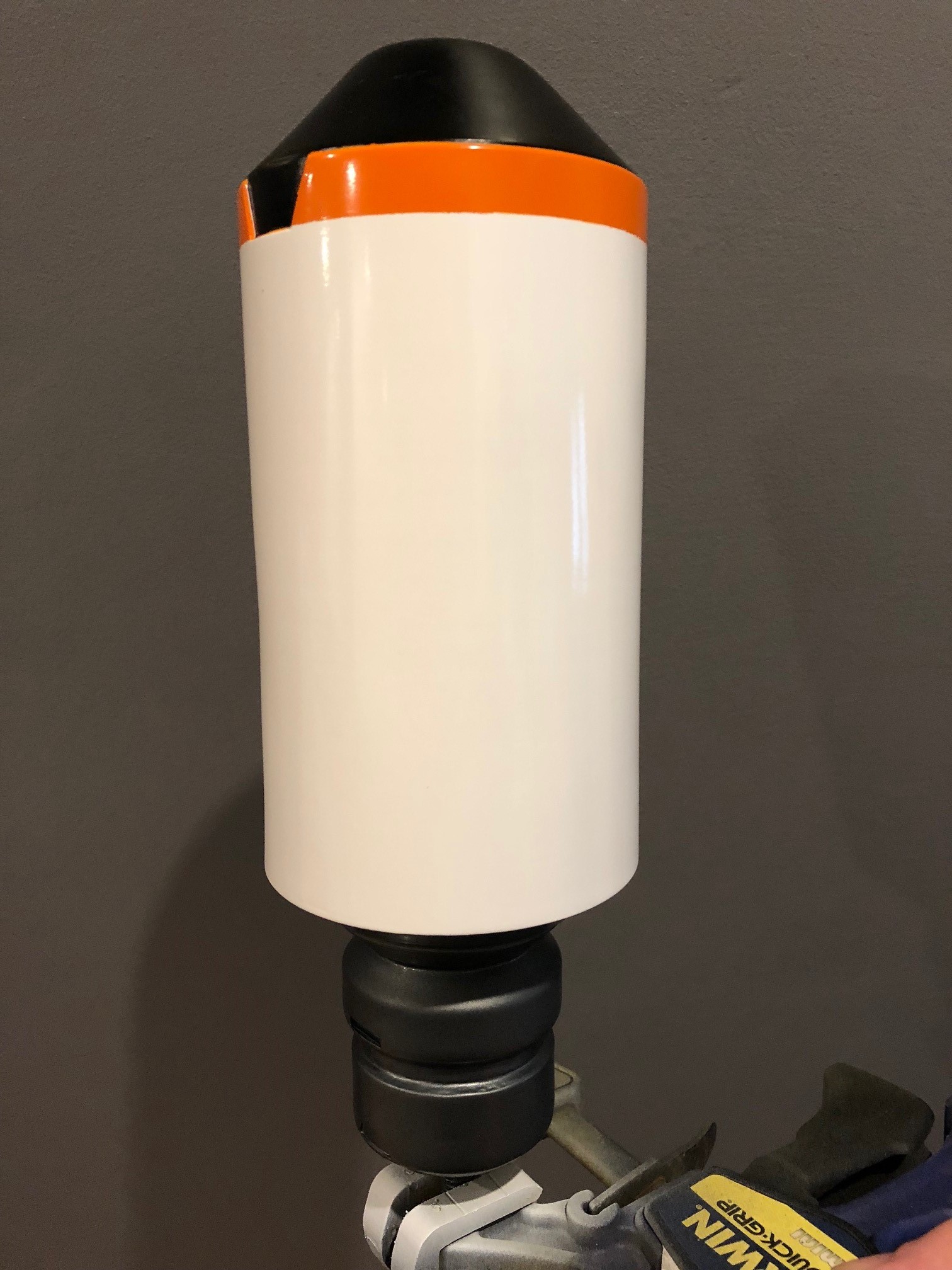

Finished painting the main canister...
Again, I used paints from Halfords: Volkswagen Brilliant Orange, Rover Stone Grey, and Appliance Gloss White.

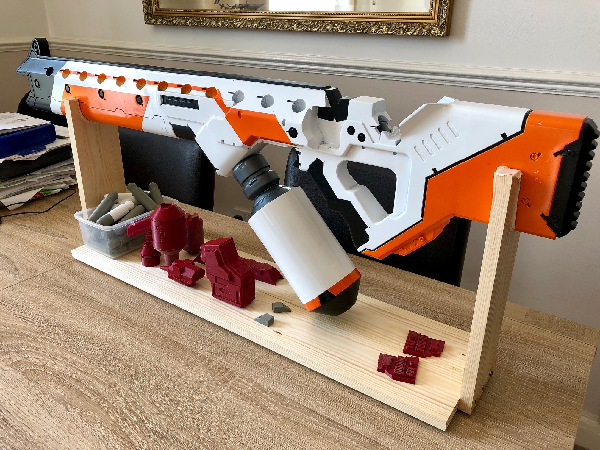

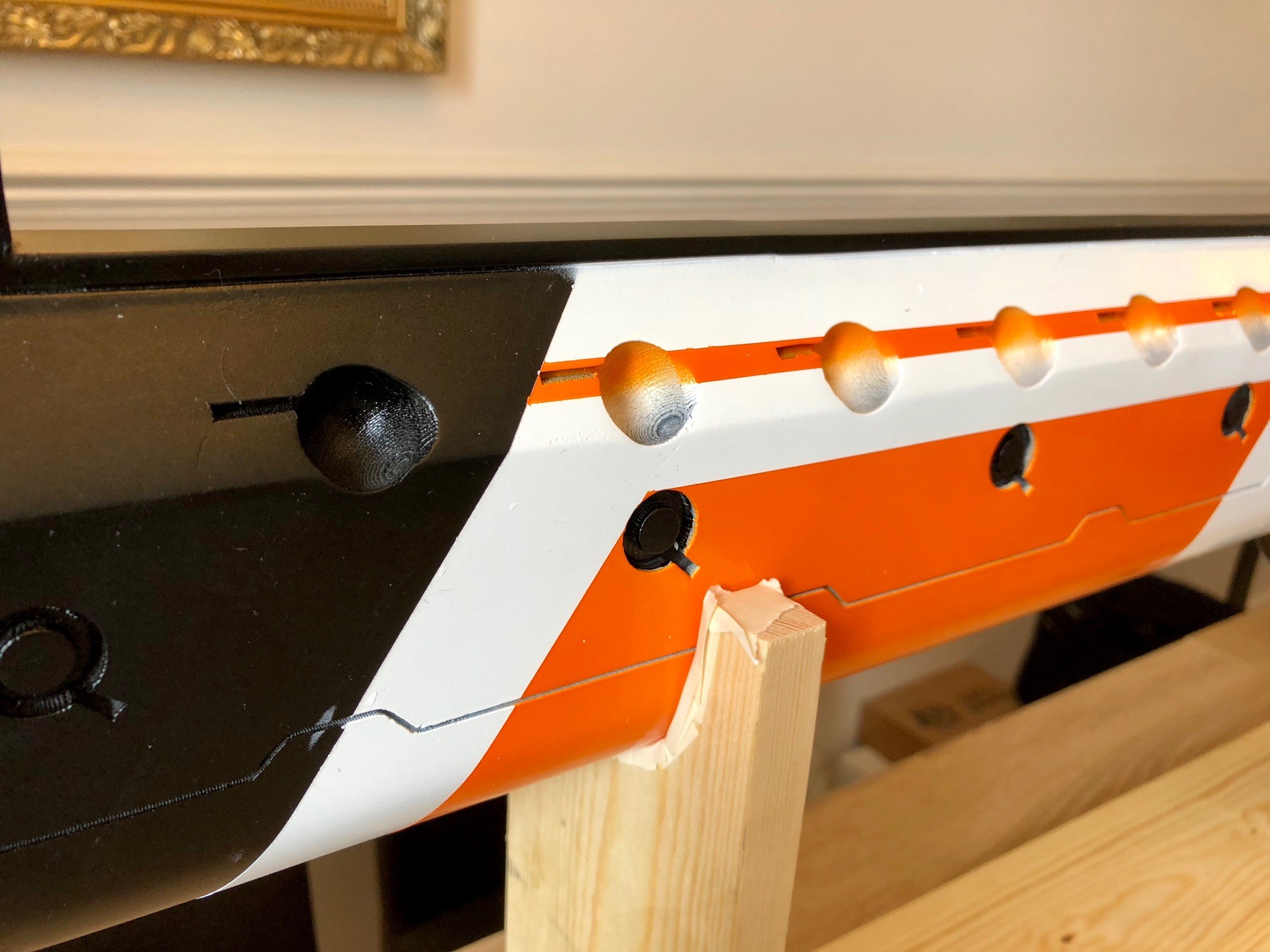

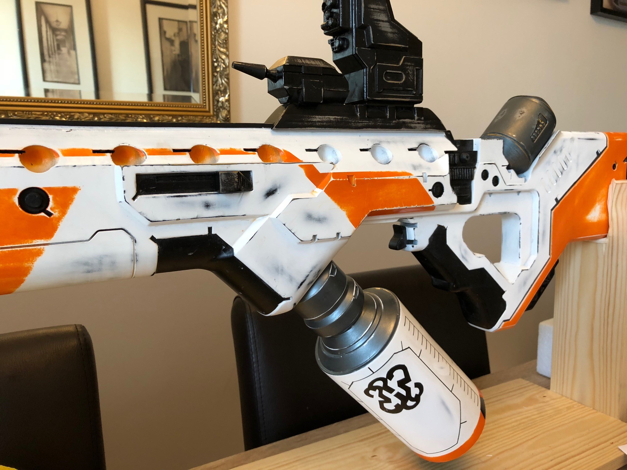

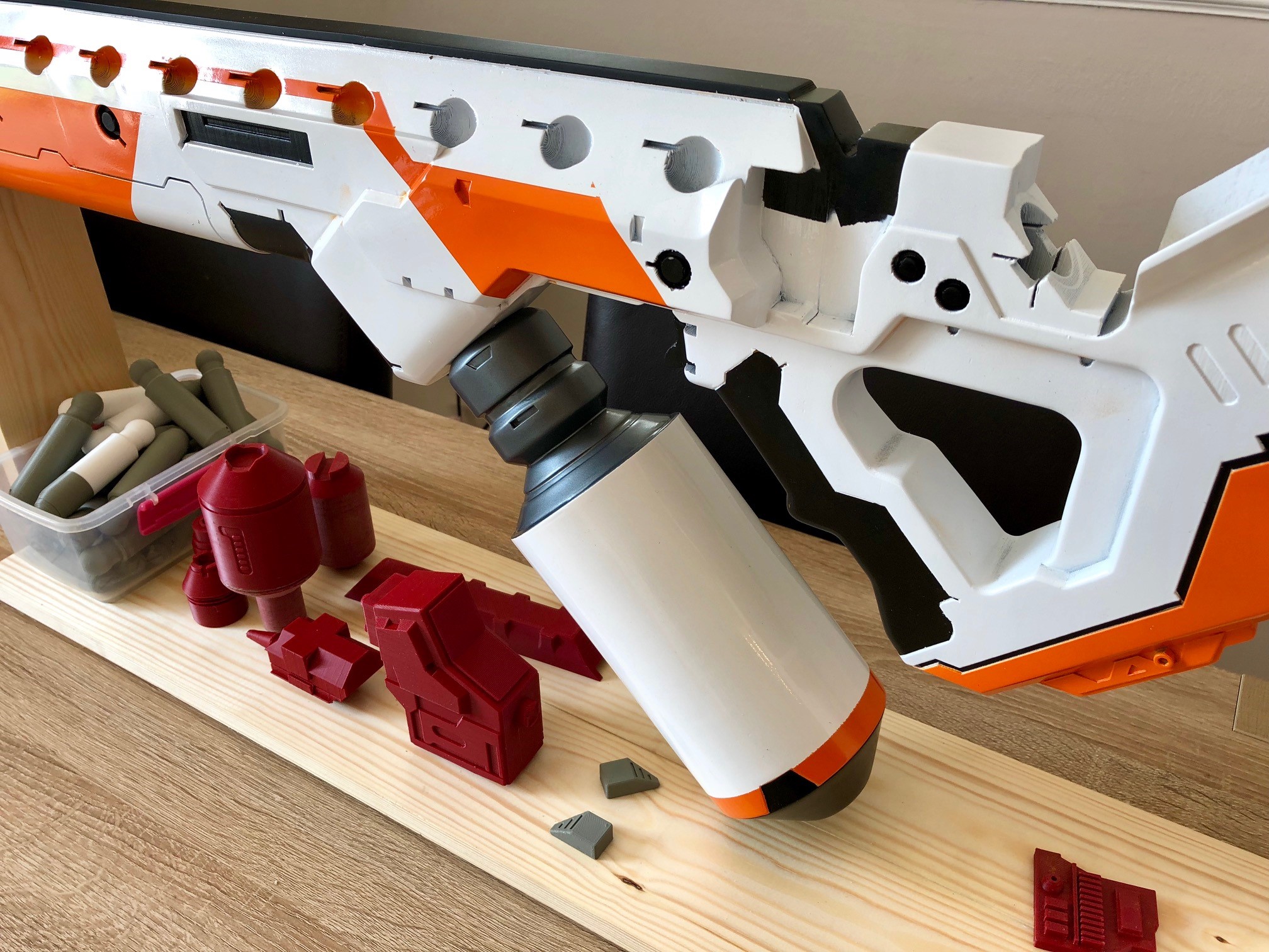

Some good progress over the weekend.

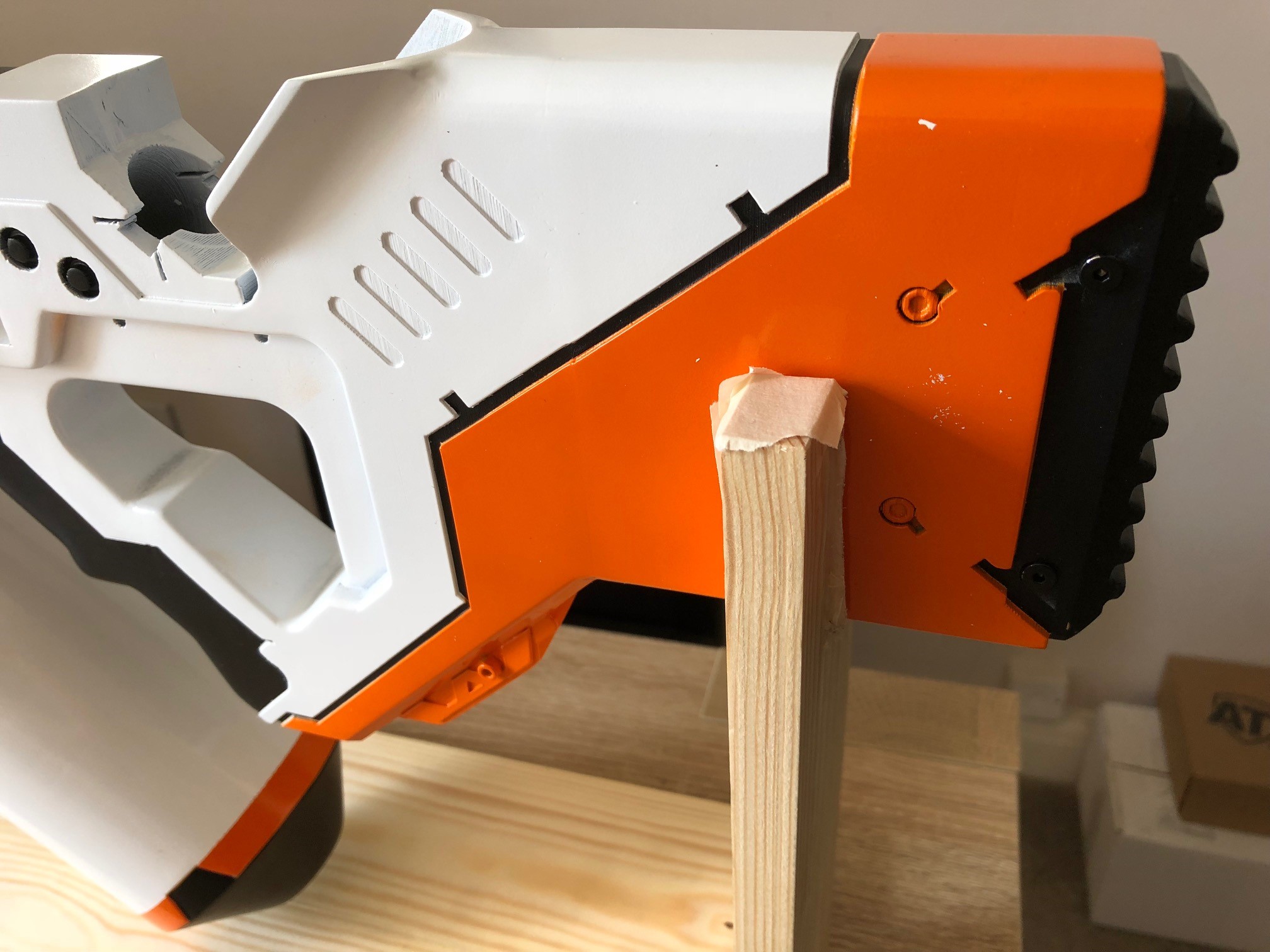

After painting the whole thing black, I masked off everything that was to remain black and painted it white. Then masked off the white and painted the remainder orange and here's the result. There's a bit work to do on the paint, not least cutting the paint back to give a perfectly smooth finish. I'll probably use Meguiars Ultimate Compound for that.
After a close shave with nearly dropping it, I made a temporary stand to keep it safe. I'll think of something a bit nicer for displaying it permanently when the build is finished. This temporary stand will also serve as the beginnings of a jig for when it's time to fit the 24 small cylinders. I'm envisaging a piece of wood that screws to each side with semi-circular cutouts along the top edge, so that each cylinder is held at the right angle when being glued in place.
Thanks for looking - I'm extremely pleased with it so far.

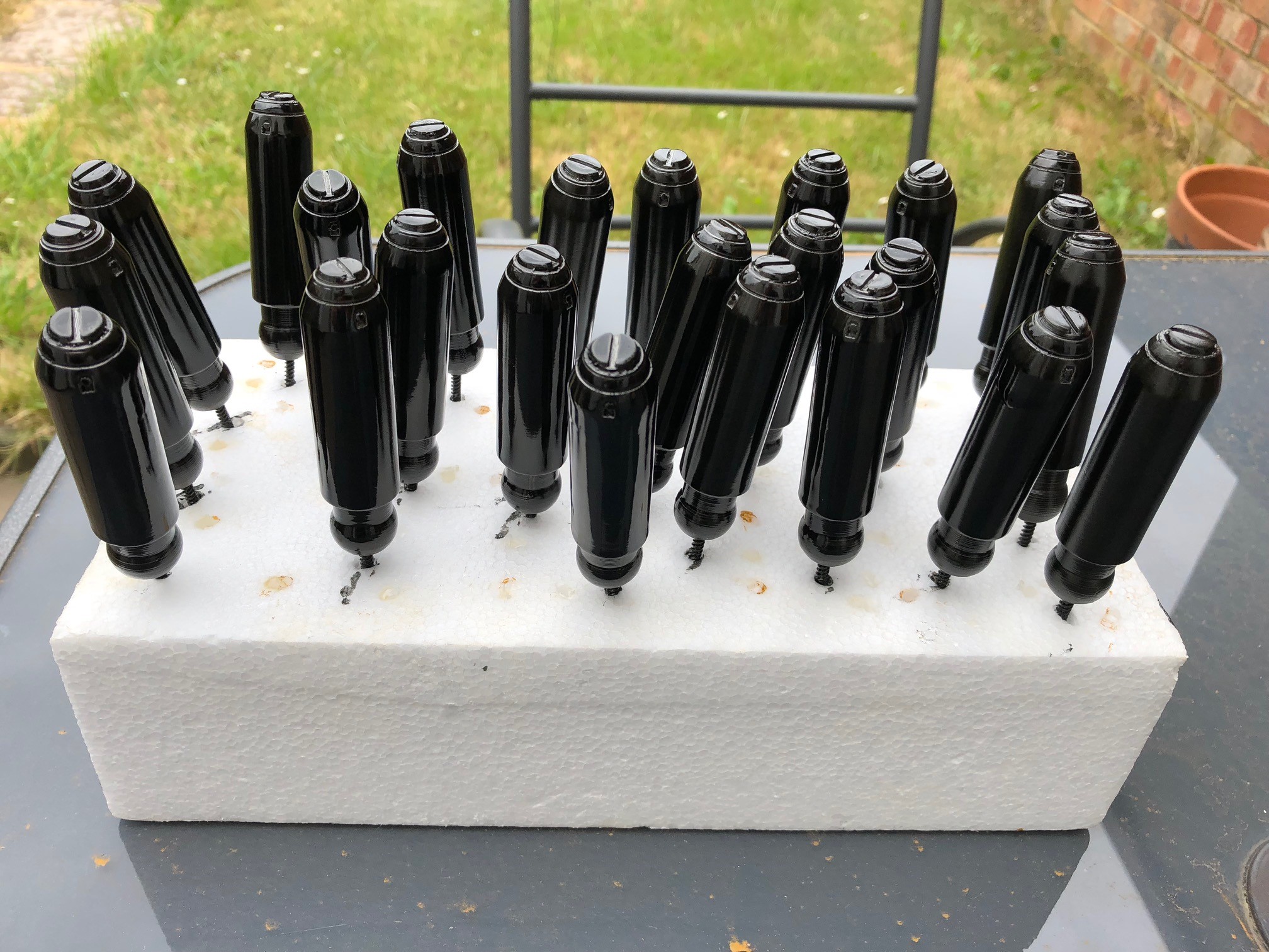

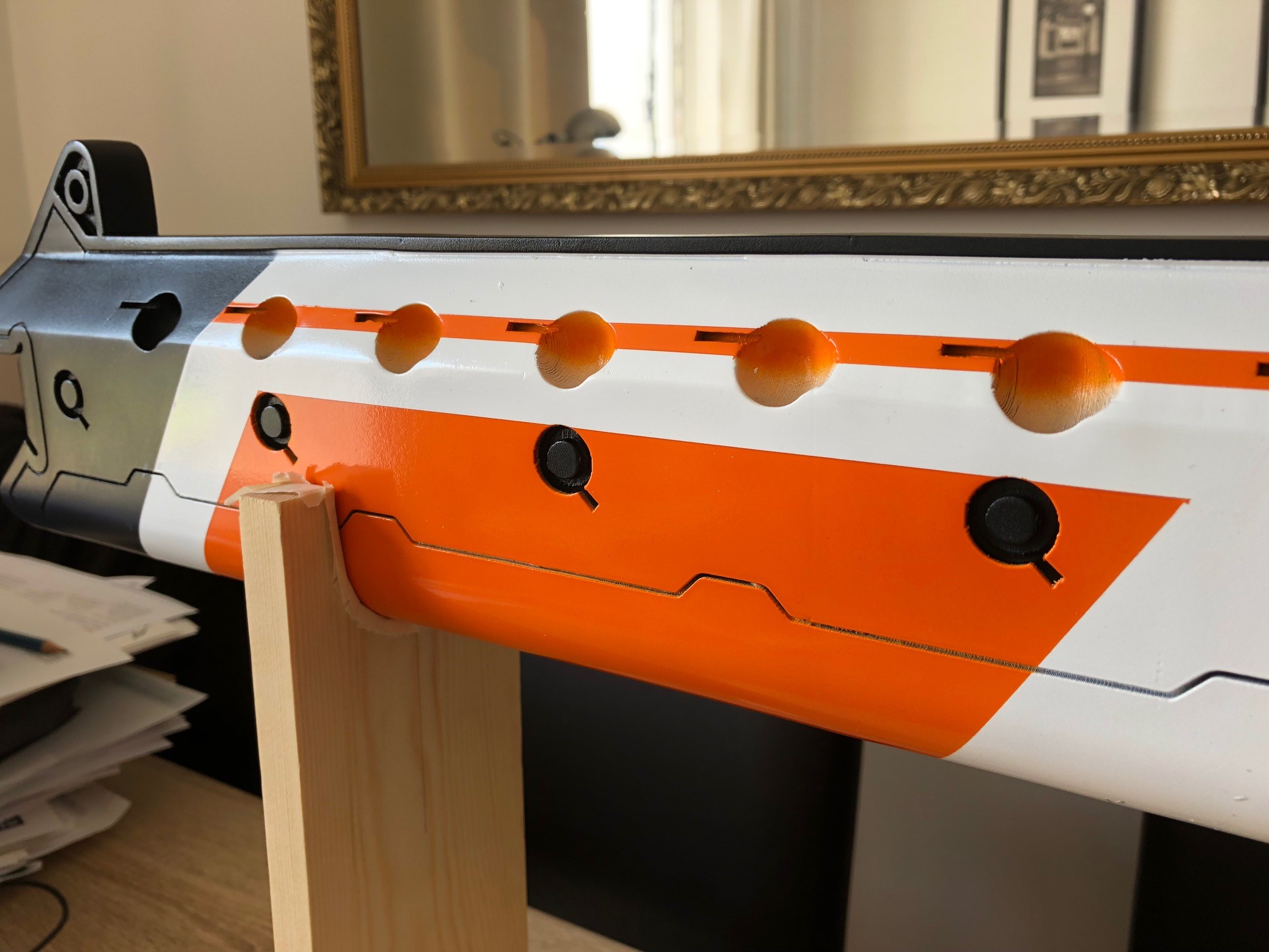

Just finished these little guys.
I painted them Audi Phantom black. There's silver underneath which will show through when I weather the tips with metal polish. Actually, looking at the original prop pics, I'll be taking most of the black off.

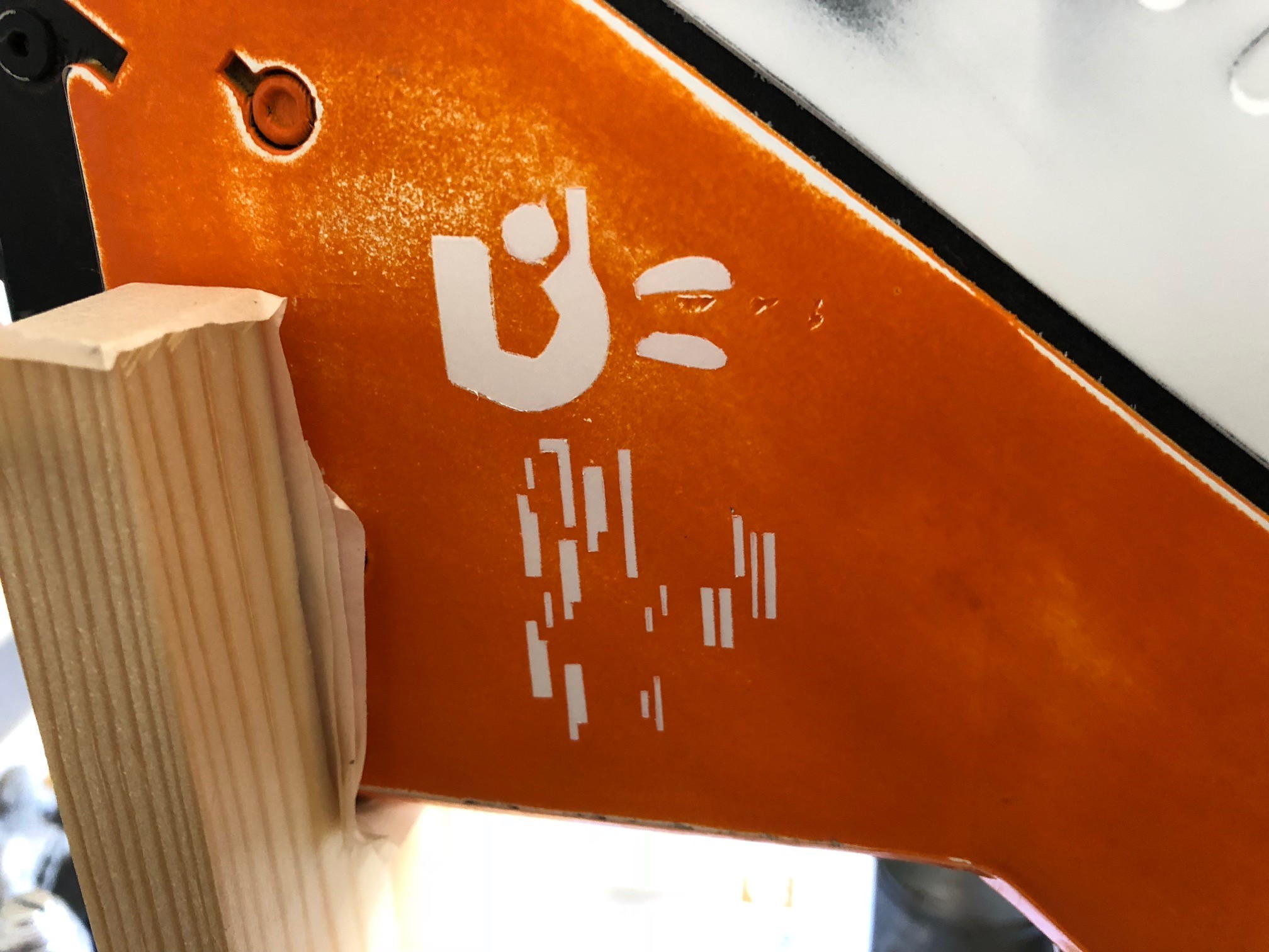

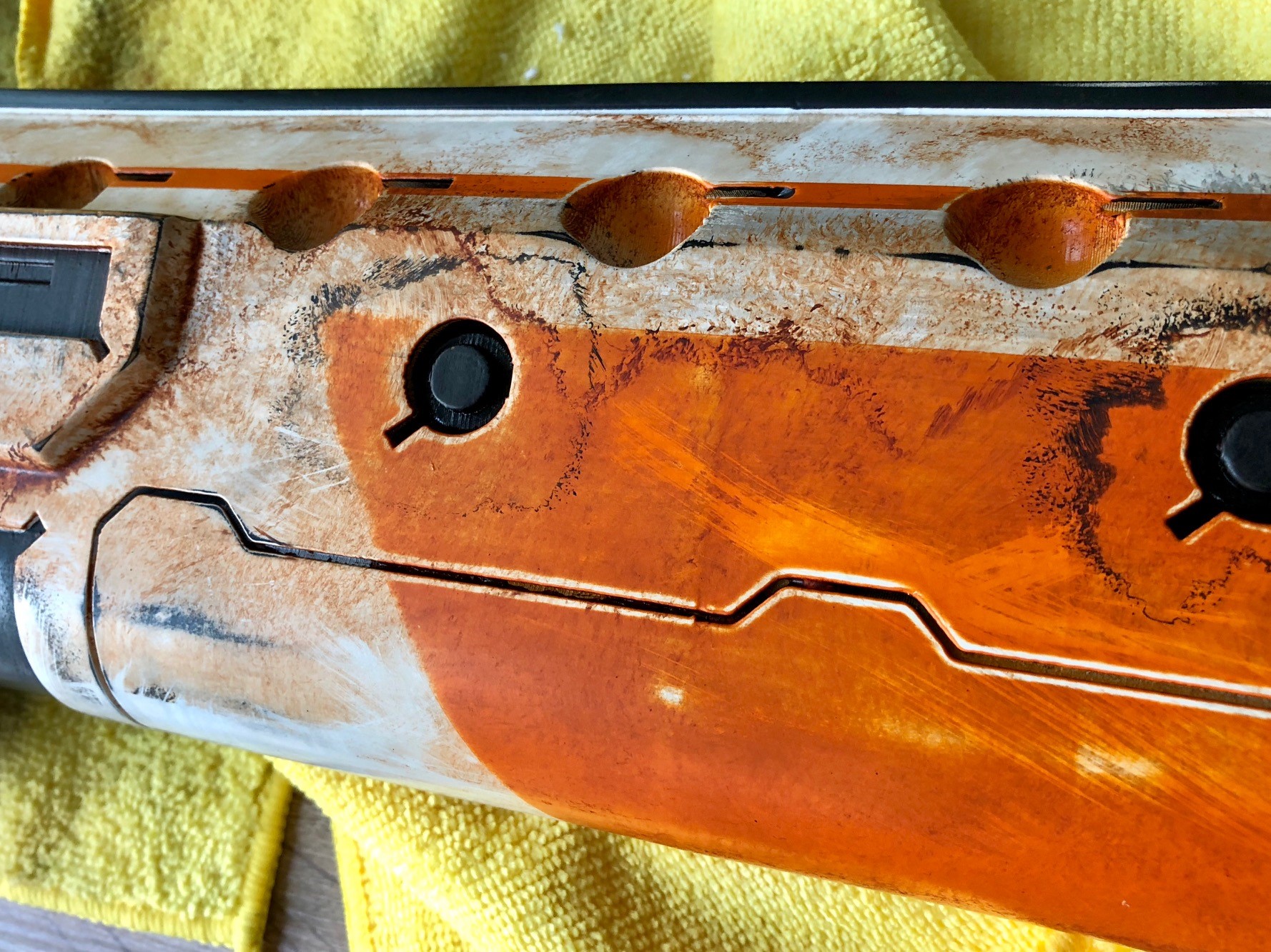

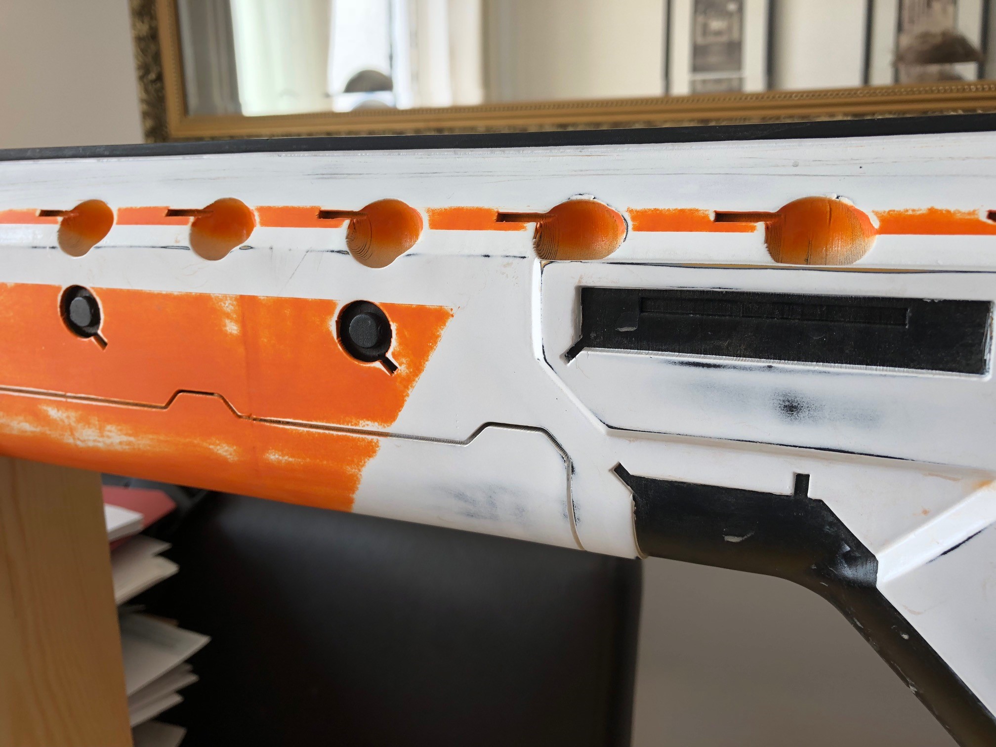

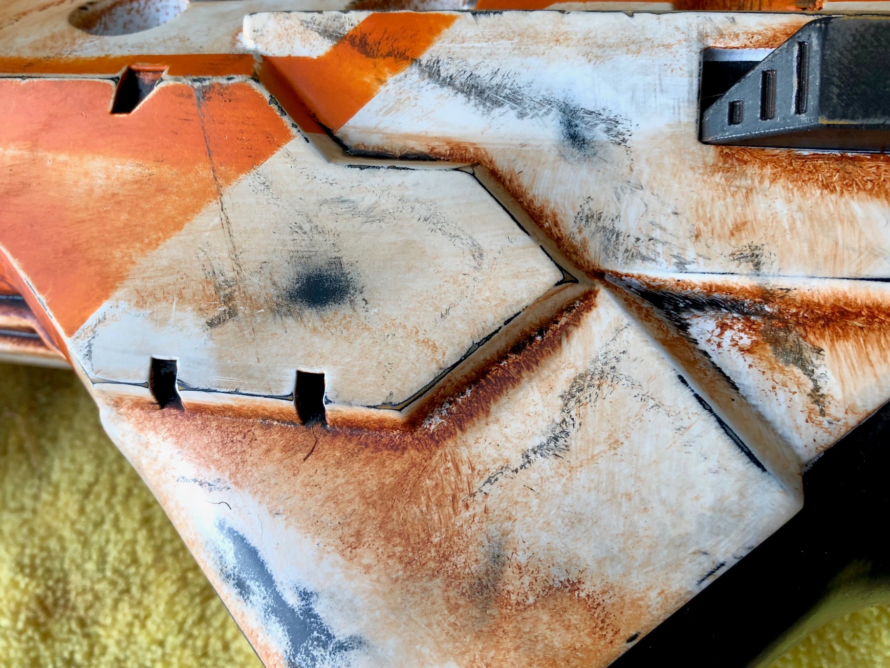

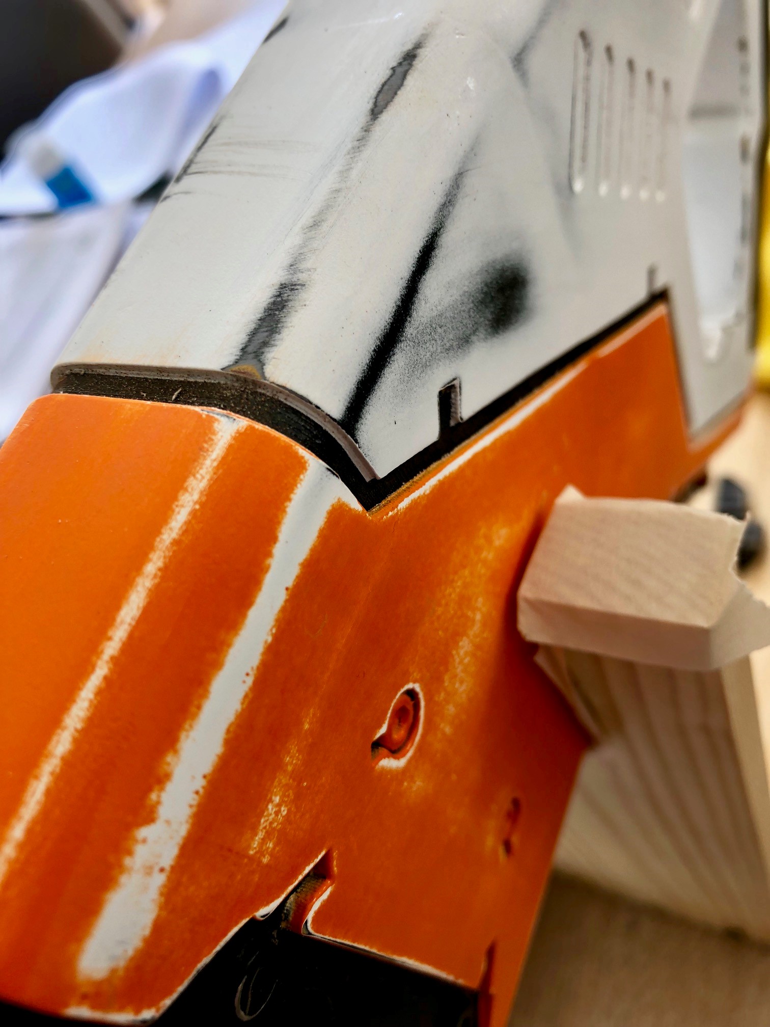

Weathering is done - mainly rubbing with fine emery paper to bring sub-layers of paint through.

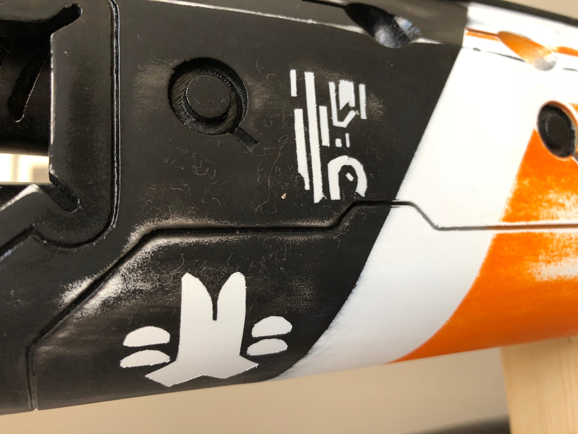

Graphics added - did my best to replicate what I could see on the original prop photos (I traced/created the images in Corel Draw, printed them onto removable sticky paper labels, and cut them out to make paint masks.
I'm really going for the all-out grubby and used look!

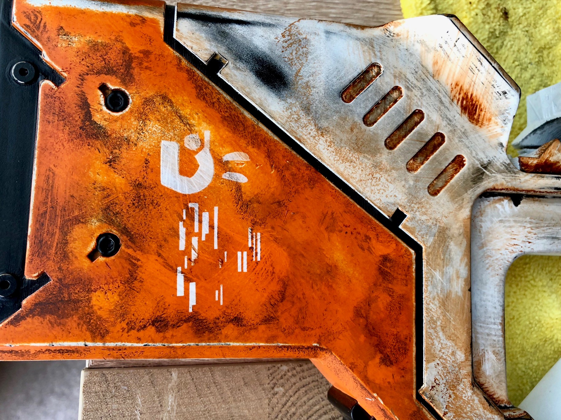

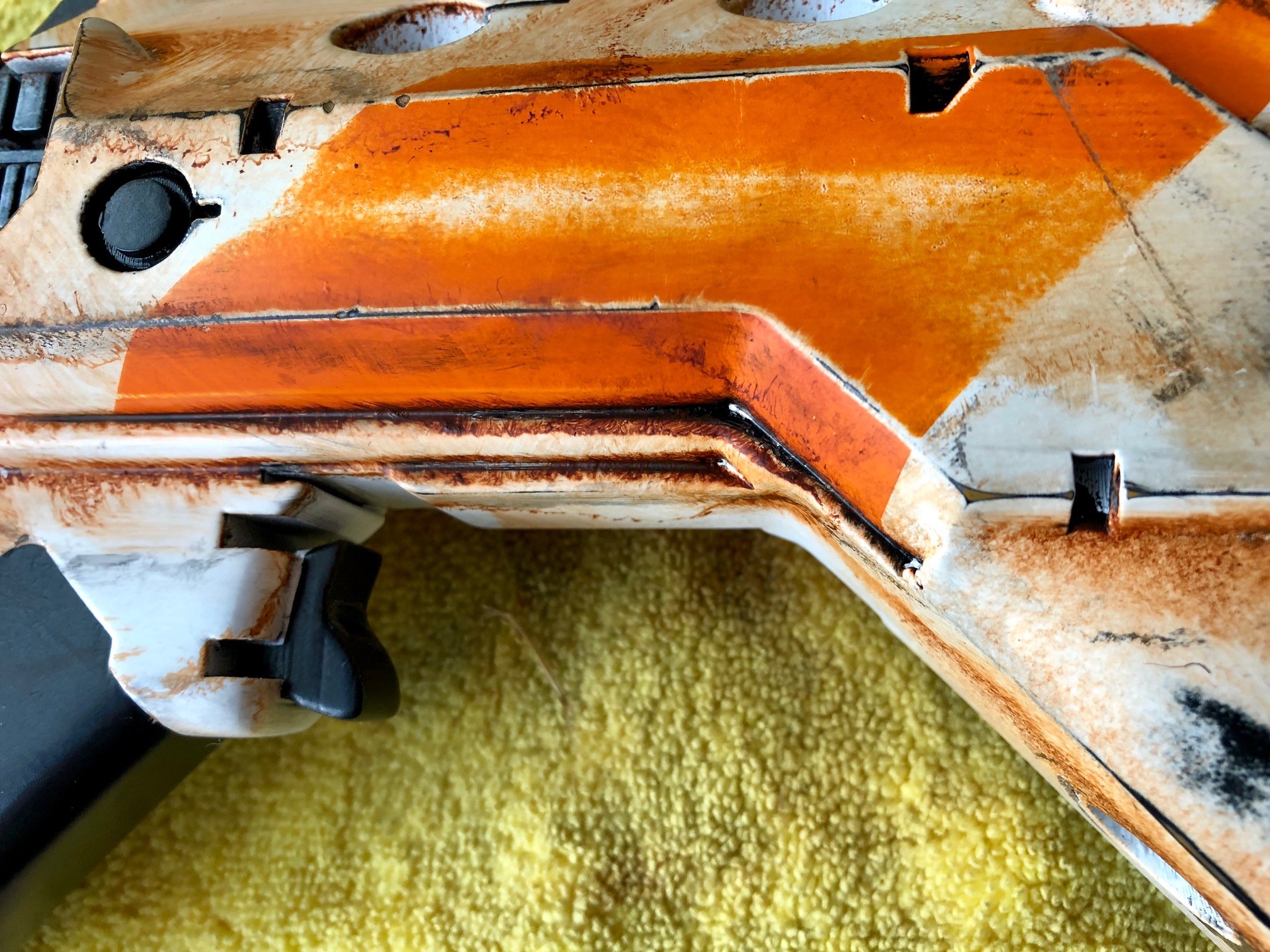

After sealing the paint with satin lacquer, weathering with burnt umber and black acrylics commenced. I was aiming for an overall look similar to this from the film:
I dabbed on the paint with a small, natural sponge, broadly following the technique I'd seen in Pandas Props' Stormtrooper Armour videos on YouTube, and making sure I pushed it into all the corners and crevices. I found there was a very short window to rub off the right amount with a damp cloth to get the effect I was looking for (to avoid all of it coming off, or none of it coming off). Overall, I'm happy with the way it's taking shape with a combination of previously wearing through the paint with an abrasive, and then applying paint this way. I used an automotive metal polish, to rub back corners and edges to get a more natural look.
