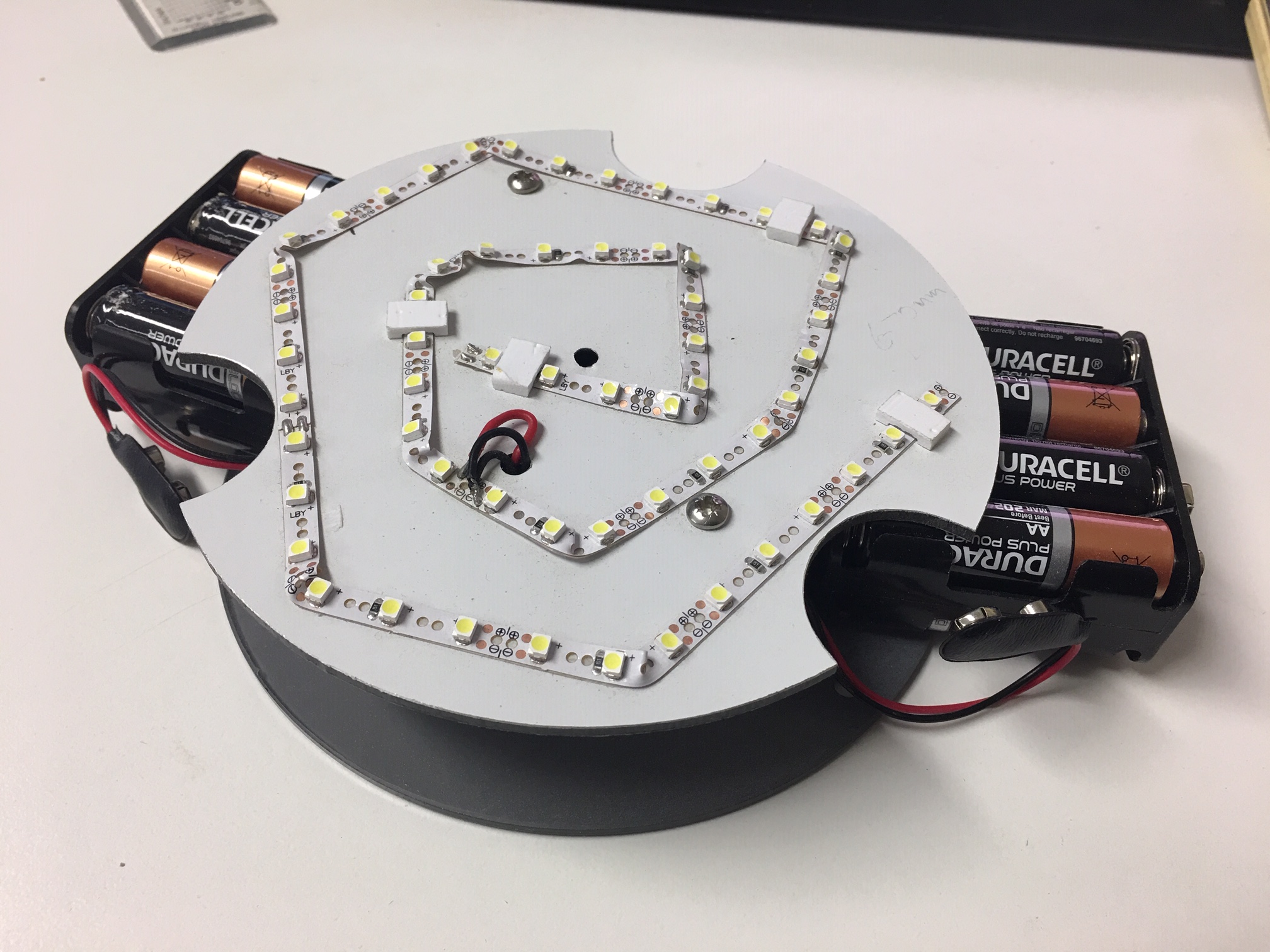

You can use packs of AA batteries, alarm batteries, drill batteries and even car batteries depending on the power consumption and duration of operation. This is part of an illuminated award we built and uses two sets of standard battery packs. The sixteen batteries ran for more than thirteen hours without a noticable drop in brighness.
