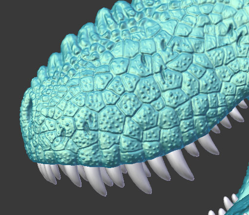

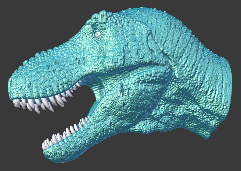

Some scarring added to the non-lipped rex. A little lighter and more scratchy than the lipped version, thought I'd try a slightly different look for the damage.

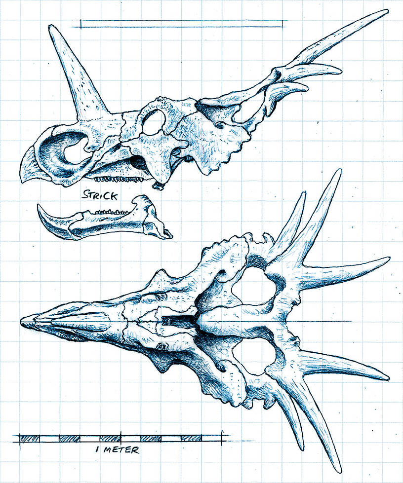

I'm going to run up my own scale drawing though. I prefer to do this because I need to learn the shape and sketching it out helps me fix the form in my head.
tarnyloo73
Spent the last couple of nights scribbling, some false starts accompanied by plenty of swearing. This is the first of the orthographic drawings (call it revision 3.5) though I might make a ventral view as well.

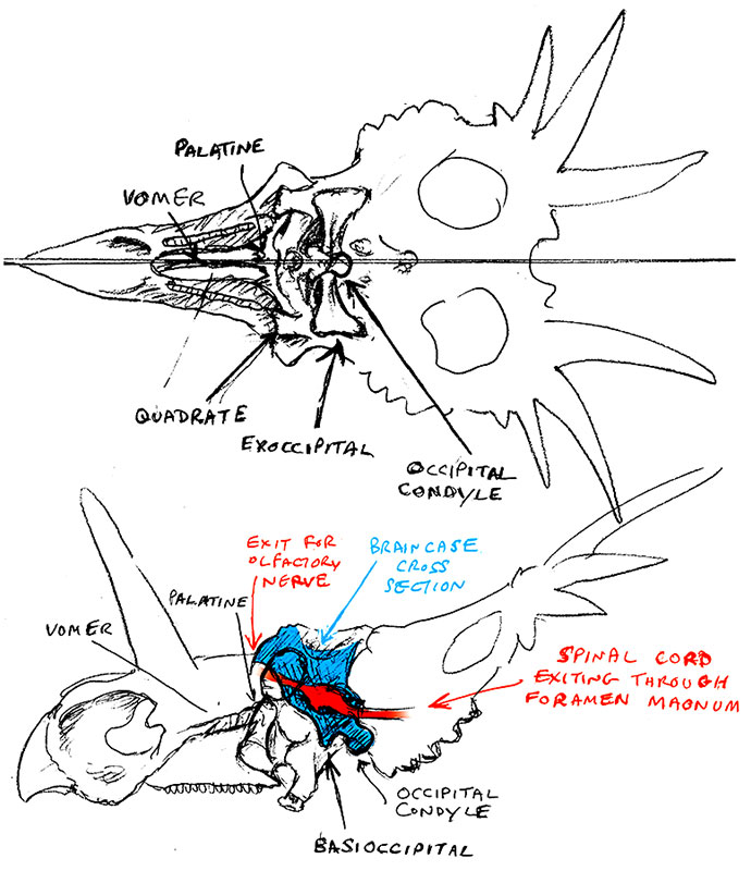

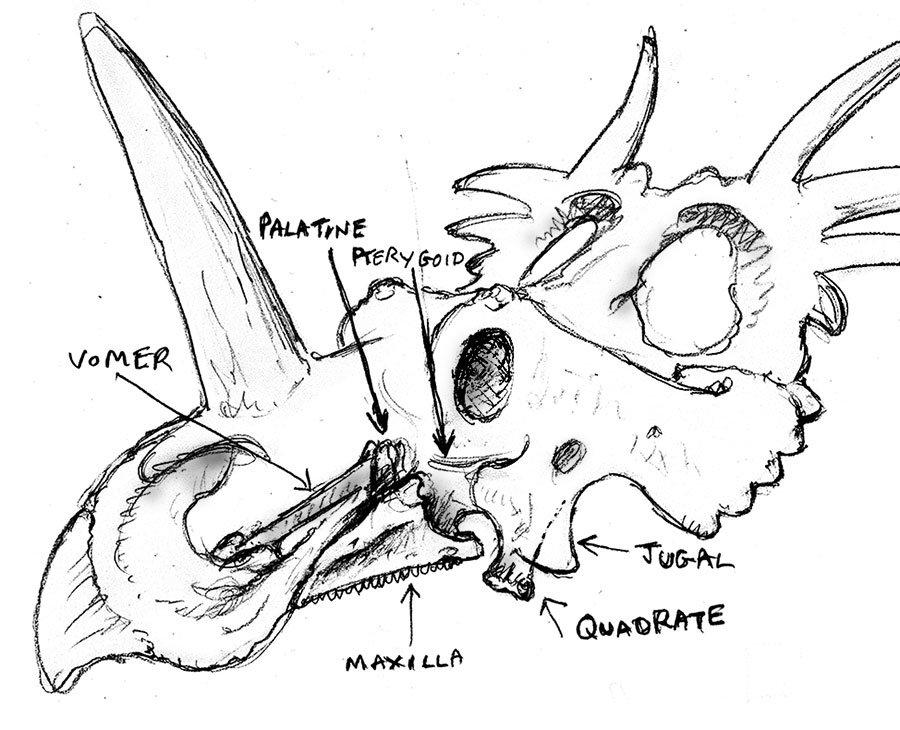

Can't find decent reference for the inside of the Styracoasaurus skull but there's some for the closely related Centrosaurus and much of Triceratops's inner skull is covered fairly well in published works. I've been scratching my head over this for a couple of days but I think I can work around it.
Apart from the signature features of each species there's a lot of uniformity among the ceratopsian group, especially centrosaurines so these more obscure areas will be based on Styracoasaurus's cousins. I'm not going to show these parts in great detail anyway because they can only be partly glimpsed through the nose and the orbits but I can sculpt them loosely to show some internal structure.
Ceratopsian heads are highly modified with a huge beak and chewing apparatus at the front and the rear skull elongated into a frill, because of this the back palette and lower brain-case bones are sort of smushed together at the mid point longitudinally. These sketches are my efforts to 'feel' my way around the internal skull bones. There's only so far I can go with drawing, time to dive into some 3D modelling I think.

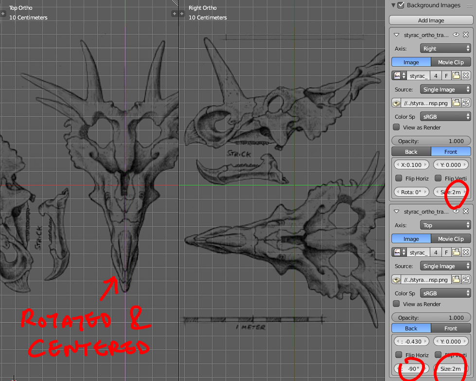

Not very motivated this weekend but I'm going to make a start putting down some polygons tonight. For the next 3 weeks its Springwatch on BBC 2 so I'm not going to get much creative work done :). One of the (many) things I like about Blender is the easy template image setup. Due to natural laziness I make it even easier for scale modelling by making my images conform to a particular size.
My Styracosaurus orthographic is drawn at 1/10th scale on a grid 20cm wide. That means I can just crop the scanned drawing on the grid lines and set the background image in Blender to 2 meters, instantly the correct size! The same image is used in both top & side view, I've made sure the top view is rotated and centered on the origin.

I didn't know you can use an alpha channel for the background images. Thanks for the tip!
Following with great interest!
tarnyloo73
I use the 'colour to alpha' filter in Krita to quickly make the pic background transparent, it works great placed in front of objects with the opacity set low.

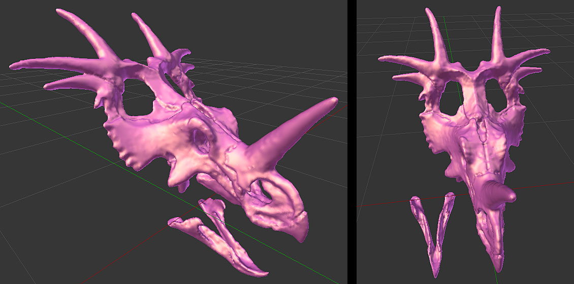

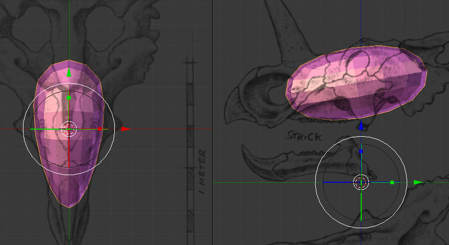

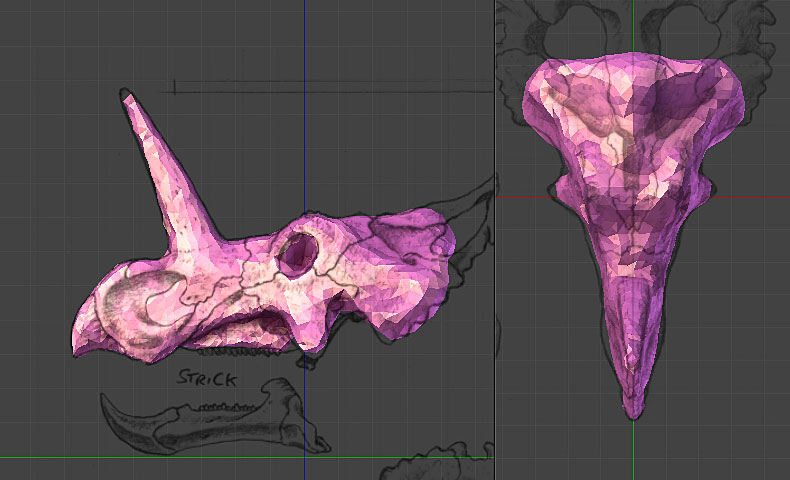

Been away from this for how long now? 1 week? More? I've been spending some time looking at the internals of ceratopsian skulls. Anyway I can only look at 100 year old museum publications for so long so I've made a start.
Took a different approach from last year's rex skull models. Rather than building a sub-D model from the drawing I thought I'd try making a template sculpt first, not intended to be the final model but hopefully that will make sense later on. Starting with a subdivided cube I've used Blender's dynamic topology to create the initial shape, mostly with the SculptDraw and Move brushes. It's a great tool for free-form sculpting and very easy to add/reduce detail.
tarnyloo73
That's the main form mostly laid out, bit more still to do on the underside. Not too refined as it's a scaffold for the next stage. The inner bones I'll work out in sub-D polys later.

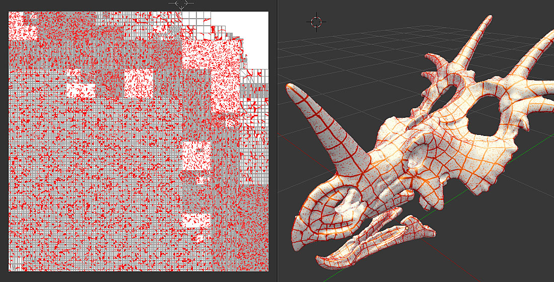

Added some lightmap UVs on the scaffold sculpt so I could paint this poly map (red lines). It's mostly a guide and I'm not wedded to it, there'll probably be changes once I start placing polys.

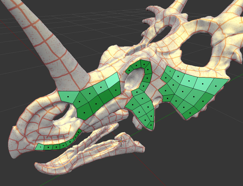

Another long absence busy with other stuff, Really need to make a push to wrap this up. I'm setting up a low-poly base model using the painted lines as a guide. With face snapping turned on, it's easy enough to lay down polygons. There's a mirror modifier on the retopo mesh but most of the time it's turned off.
For placing a vertex that's meant to be on the centre-line I find it convenient just to zero it's X co-ord manually in the properties panel. Now it's just a case of working my way around until it's all built. Always a lot of tidy up required as the model develops, inner bones will need extra attention.
