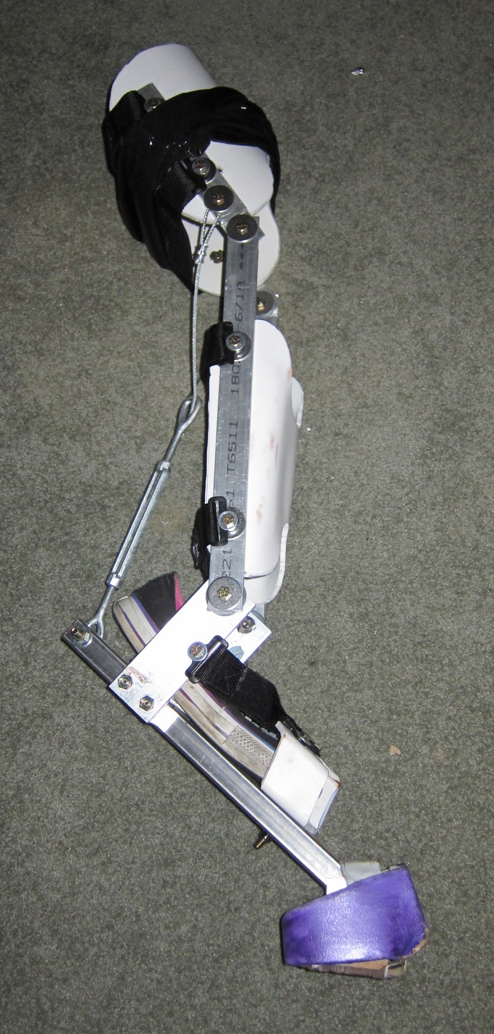

I made a pair last year, using the blueprints and instructions found at http://www.instructables.com/id/Werewolf-Stilts-digitigrade-legs/, also for a draenai costume. I made one change to the design, I cut the lower leg section shorter, and bolted a block of wood to the plate that serves as a foot in that design, around which I built my hoof, so the structure looked like this:
I was amazed at how easily I was able to get the hang of walking in them, although I had to make sure I built a prop weapon that was big enough for me to use as a support, as without that, I couldn't stand still. By the end of the day (close to 12 hours of being in the full costume, albeit with a bit of a break middle day) I was exhausted, but I also hadn't been overly smart about eating much during the day.
I had no stresses on my knees or shins. In fact, the only issues I had, was a blister on one toe (more due to the shoes I used, than the design of the stilts), and I had a pressure point on the front of each thigh, which had been caused by the angle of my legs shifting throughout the day - the support cables had stretched out, and by the end of the day, I was trying to walk too upright. It is worth spending a number of hours practicing in the stilts ahead of time, for just this reason, and I had not allowed enough time to do this. Now I've had a chance to repair that, and tighten things up, I'm actually really excited to find another reason to use these again!
Let's see ... We were able to do the whole build for somewhere between $150 and $200.
The big costs were the metal bar stock parts, and the Sintra. All the metal bars and blocks came from a website that lets you order custom cut pieces (we lack the tools to do accurate metal cutting) and totaled around $80 - $90. The Sintra was about $40 for a 4 pack of 12" x 24" sheets (including shipping). I only really needed 2, but was glad of the extra, when I dropped one of the stilts and one of the formed pieces broke.
The velcro I bought at a local craft store for $15 (I bought the kind that is designed to be used as a luggage strap, worked out WAY cheaper, and easier to sew).
The nylon webbing came from the same place we got the strap connectors, and was about $10.
Then adding up all the bolts, nuts, washers and other connector parts, probably another $20 or so.
I'm basing this off the parts that actually went into the stilts. My husband was very involved with helping me build the stilts, and he would sometimes buy additional parts, because he'd found something that he liked better - his primary concern was that I would be safe while in these things! Also, we went to the additional cost of buying a drill press for this project, although it depends on where you live, you can likely find a local machine shop that can drill the required holes in the metal.
Edit: the wooden blocks for the feet were just scraps we had leftover from some fencing work, and I sacrificed an old pair of sneakers for their soles, so that I had some traction while walking on a variety of surfaces.

Metal bar stock came from www.metalsupermarkets.com, custom cut to the sizes we wanted.
Sintra was bought off Amazon: http://www.amazon.com/White-Sintra-...ie=UTF8&qid=1420306870&sr=8-2&keywords=sintra
Nylon webbing and the d-rings for the straps were from http://www.plastic-buckle.com/ (I used these: http://www.plastic-buckle.com/ph408-d-ring.aspx). You could also get the velcro from this site.
The turnbuckle (the part that controls the tightness of the support cable) as well as all the screws, bolts, washers and other fasteners can be bought from http://www.fastenal.com/web/home. If you have one of their stores near you, they were super helpful in making sure we had the best possible parts for the project.
The support cable is airline cable, which we got at our local Lowes.
If you haven't used a drill press much (or at all, like I hadn't), it's worth either buying a little extra material for practice, or finding a local workshop that will drill the holes for you. (I actually have a local Senior Center that offers this service, which I found out about after we'd already bought a press!) The holes are pretty precise, and the nervousness of getting them right caused more stress than any other part of the build!
If you go ahead with this, and have any other questions, let me know, I'm happy to help out in any way I can!
