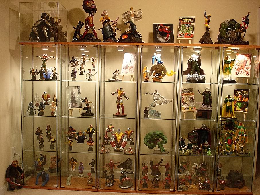

Who has some IKEA Detolf Shelves? Post pics so I can get ideas for a cool display.
I just stick stuff in it but I'm sure there is a better way.
This is one I found online and is kind of what I might do unless I find a better way.

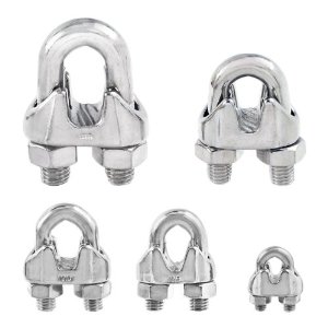

I use 4 steel wire clamps (6mm) per shelf (fastened on the vertical posts) to place the shelf at every height I wish. A lot of people do so.

Those clamps are a good idea. I saw a guy modify it another way which looked pretty good.

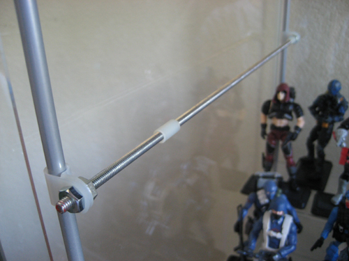

Here is my mod to add an additional shelf to my Ikea Detolf.
I used:
8-32 threaded rod cut to 12.75"
Nylon L brackets
Nylon cylinders
8-32 nuts
Glass or Plexiglas cut to 15" x 11.5"
I got everything at Lowes, but they are common parts to any hardware store.
Attach the threaded rod with the L brackets as shown. The little cylinders are to keep the glass off the threads, but are not essential.
