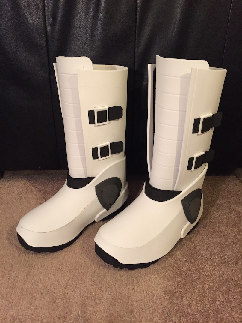

So I started with the boots. I started by paper templating over some black swat style boots I have had for years. and after my third attempt I had something I was happy with around the foot itself. The boot shell was hot glued around the toe and heal of the boots rubber sole. This gave me good adhesion but also is able to peel off cleanly because I still use these boots in the winter. The next problem solving moment was trying to get a good range of motion out of the boot without too much stress on the foam so nothing would tear. I decided to add a velcro strap to the bottom of the calf, and thread that down between the real boot and the foam shell that would wrap under the arch of the boot. This allows the calf to move independently of the boot so there is no joint stress. Then I just added some velcro to the tongue so this just tucks into the boot, and attaches to the the calf for easy entry and exit of the boot.
I have the Boot cuffs done, just not in the picture, and I just gotta make the shin/knee caps to finish these before a little painting and weathering.
