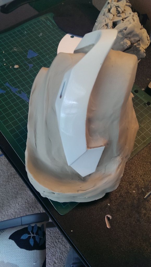

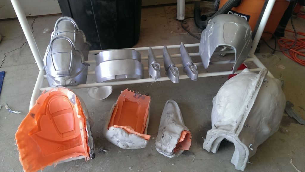

Well, here are this weeks progress picks.
What do you think?

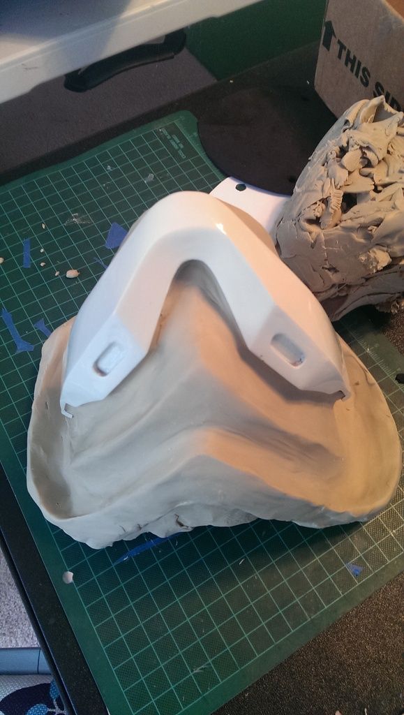

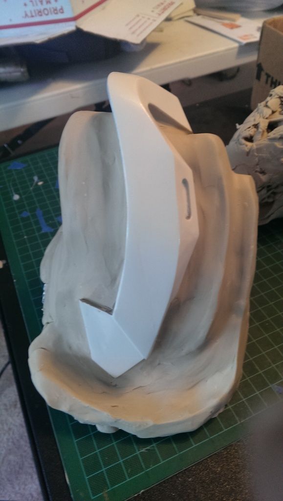

The main molds are complete, just need to finish the jaw piece. It's been giving me the most trouble. Hopefully in the next few days it will be finished. trying to work around my work/life responsibilities.

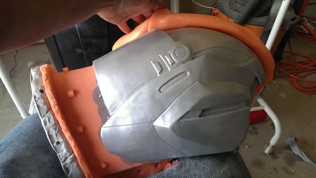

I'm liking it! Is that grey resin or are you cold casting?
Thank you! I am using smooth cast 320 with black dye (it turns the castings grey). Before I run the dyed resin through the mold I've been dusting the mold with cast magic silver bullet. It makes it look like metal. I just wanted to see how it would look if I did a whole helmet that way.

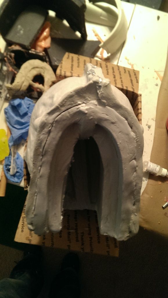

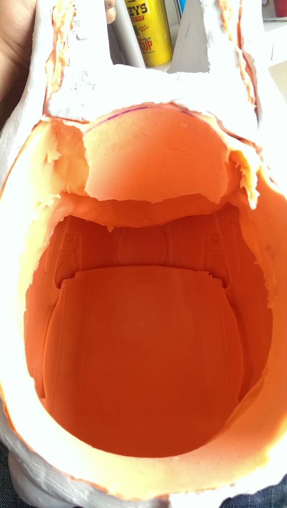

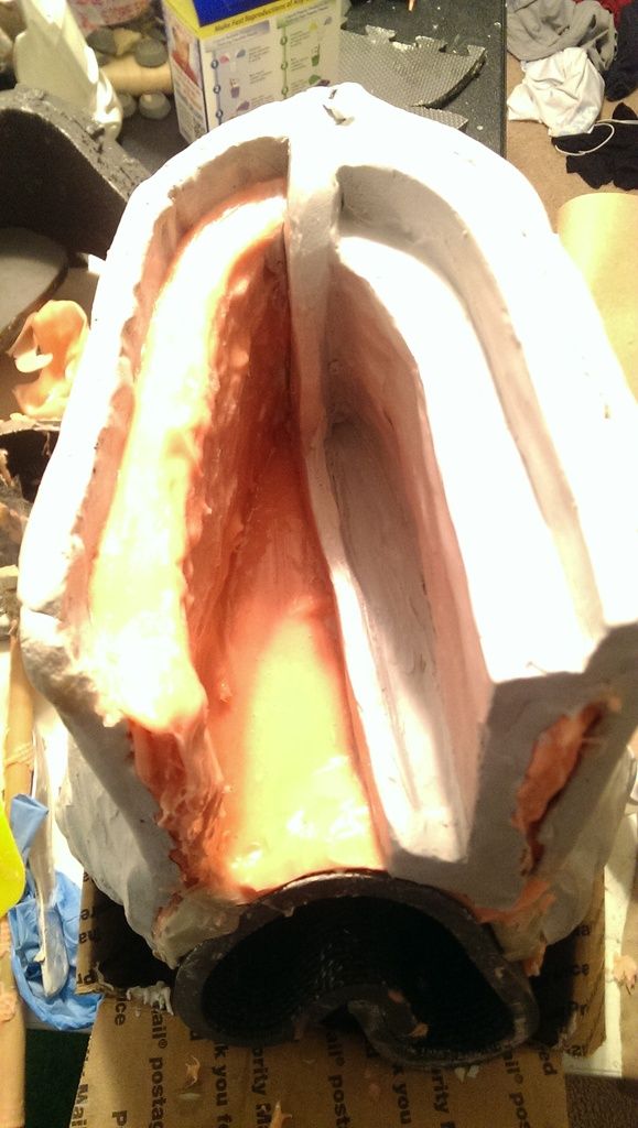

Thank you so much for the awesome comments and feedback. It means a lot. For the shell/jacket, I use a material called "free form air" it's an epoxy dough, takes a little while to fully cure but it's the easiest stuff I've ever used to create a support shell. started using it with the Elite head sculpt and have never gone back to any other material. It took roughly a full gallon to do the whole helmet. THis does not include the Jaw piece (in the pictures below). I think a whole gallon would work though. I went a little heavy handed with it :( . I'll be using fiberglass on the jaw mold below tonight.
Wow! That looks like a great approach to doing the mold. Seems like most people opt for a single piece helmet mold, but it looks like your method will work out nicely.
Thank you! Yes, I planned on having the helmet be multiple parts so it could fit the head more form fitting like the in game helmets. To do this, meant more molds :( I think it will look good and have less of a bobble head apearance. It has been a lot more molding effort though. I think it will pay off in the end. Fingers crossed.

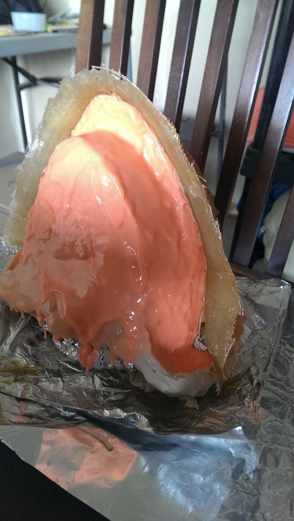

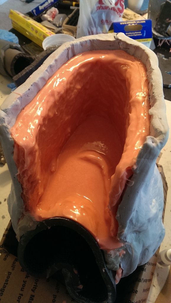

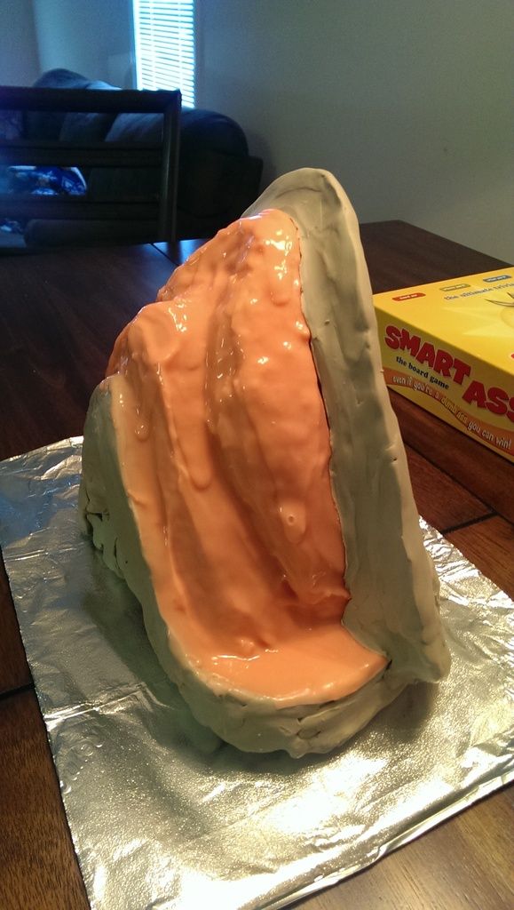

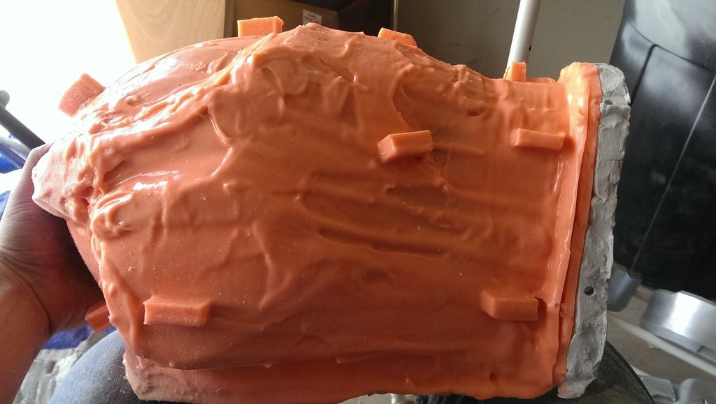

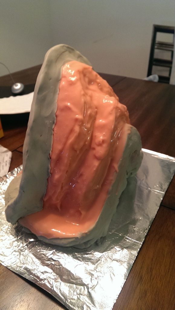

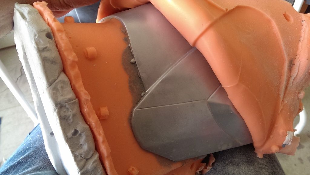

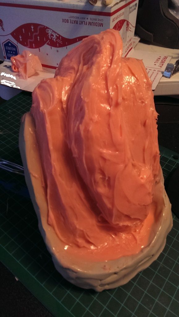

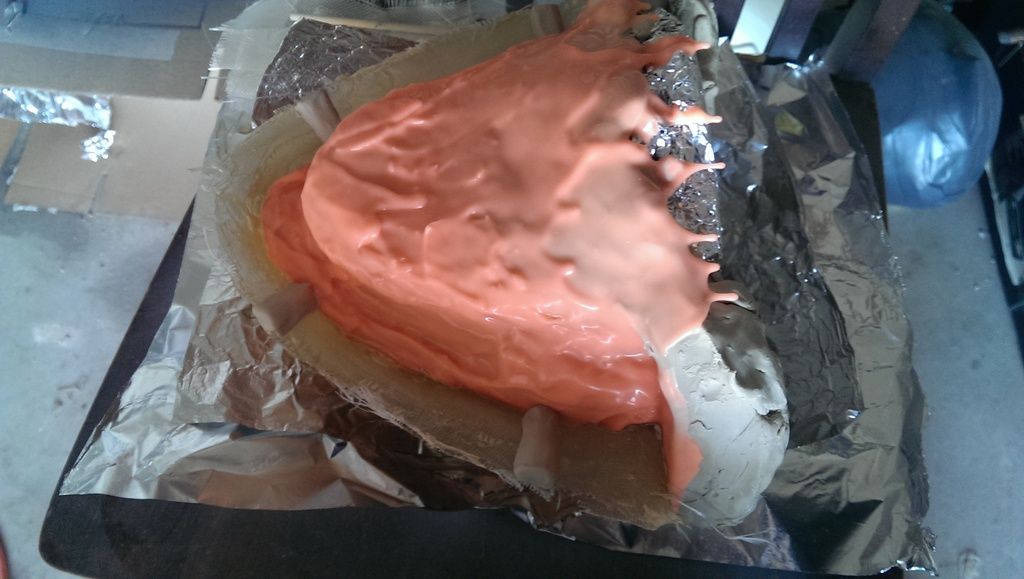

Here is where I am as of today on the Helmet mold. Sorry it's taking so long, I have to fit it around juggling life and such. I also play Destiny a crap load....lol

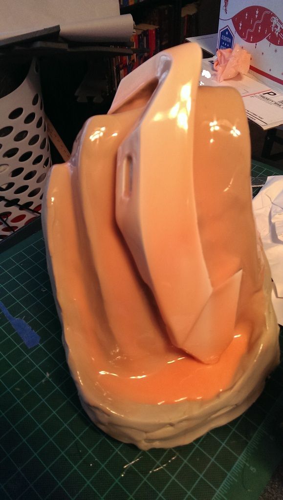

Prepping for rubber (takes a while):
First layers (no thickening):
Second Layer (Thickened):
Third Layer (no thickening & prepping for mold jacket):

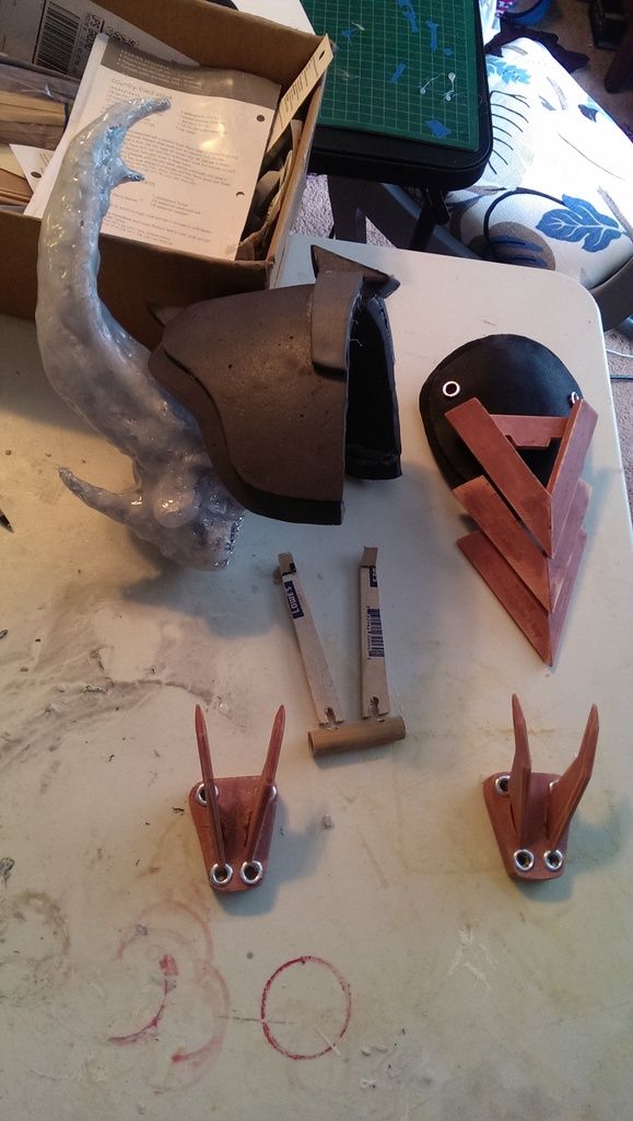

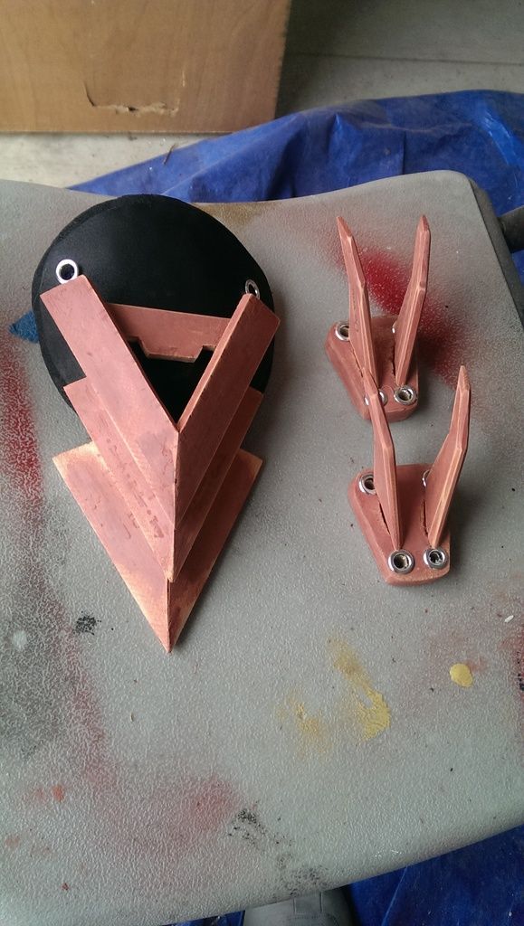

And.......work on my girlfriends Hunter stuff (i may redo the horn thingy):
"Don't touch me" gauntlets
Thanks again for viewing everyone!
-Tony

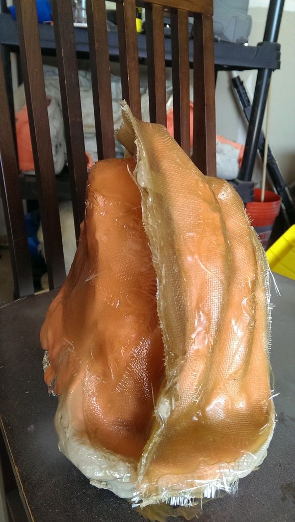

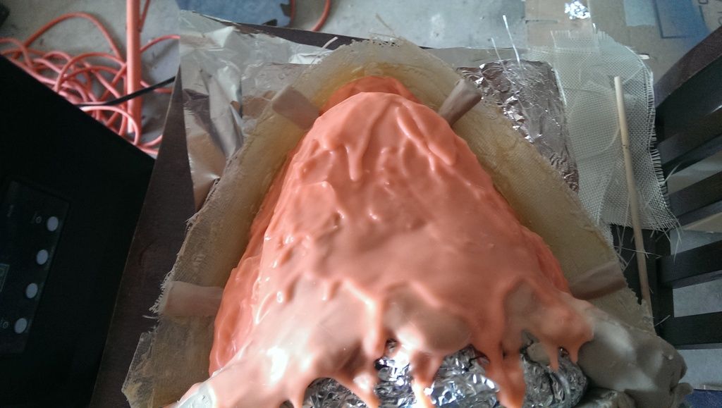

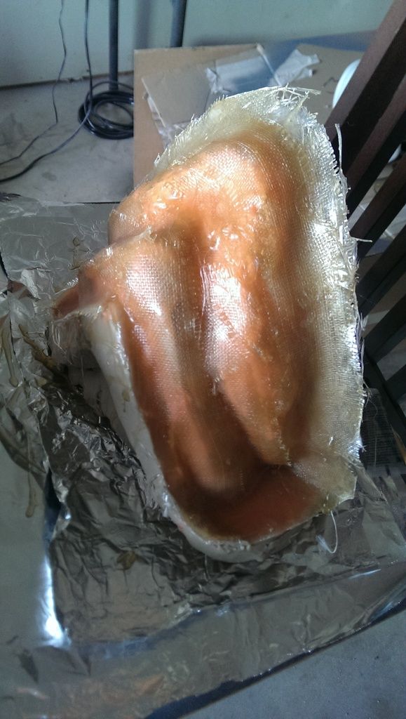

Current Progress:

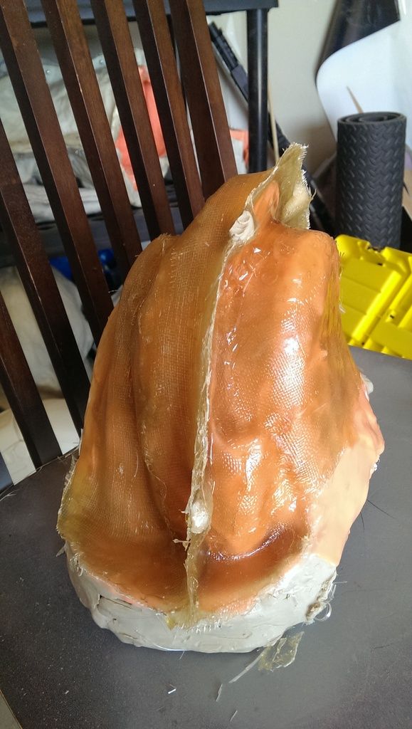

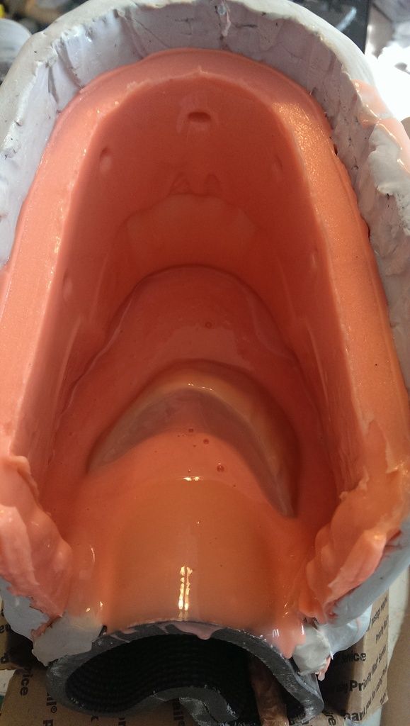

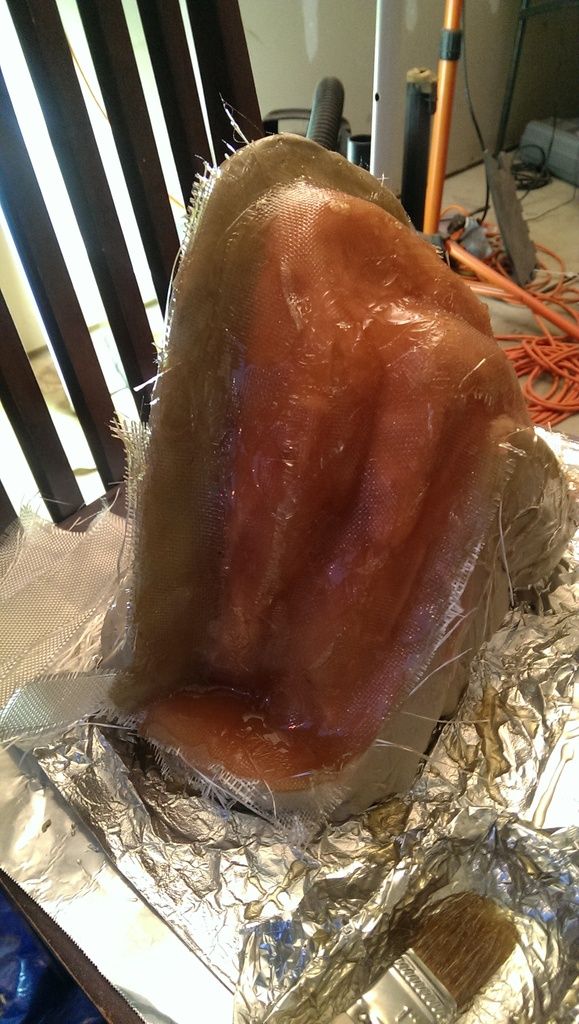

Jaw Mold:
Unfortunately, I ran out of the free form air and had to go with smelly yucky fiberglass.... :(
Thanks for viewing!
-Tony

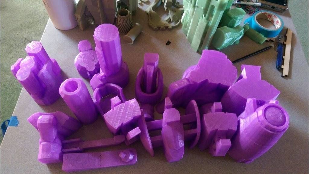

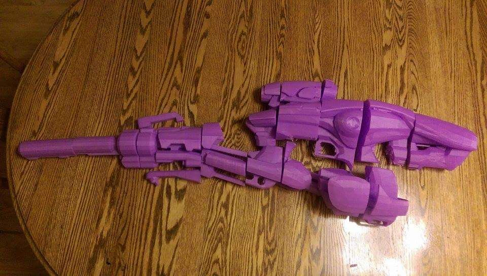

Speaking of Vault of Glass, can you name this weapon? (sneak peek)
This is being printed by my friend Nephi (AKA Nefiwashere on the RPF, 3DPrintedProps on Etsy ) . I'm going to clean it up real nice and make a mold, I'll then send a copy to Nephi who will be molding that one as well,
Thanks for viewing the build guys!
-Tony

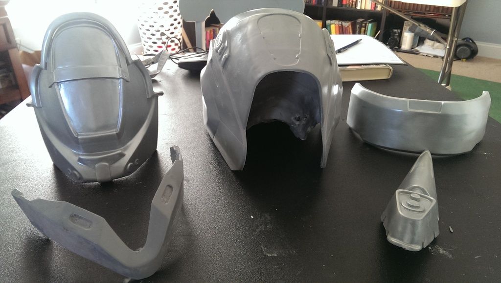

The complete kit :)
It came out pretty good. there are some minor imperfections, but nothing a little spot putty or filler can't fix. I will let a few of these go to recoup cost of the build (PM me for info).
Thanks for viewing.
Tony
