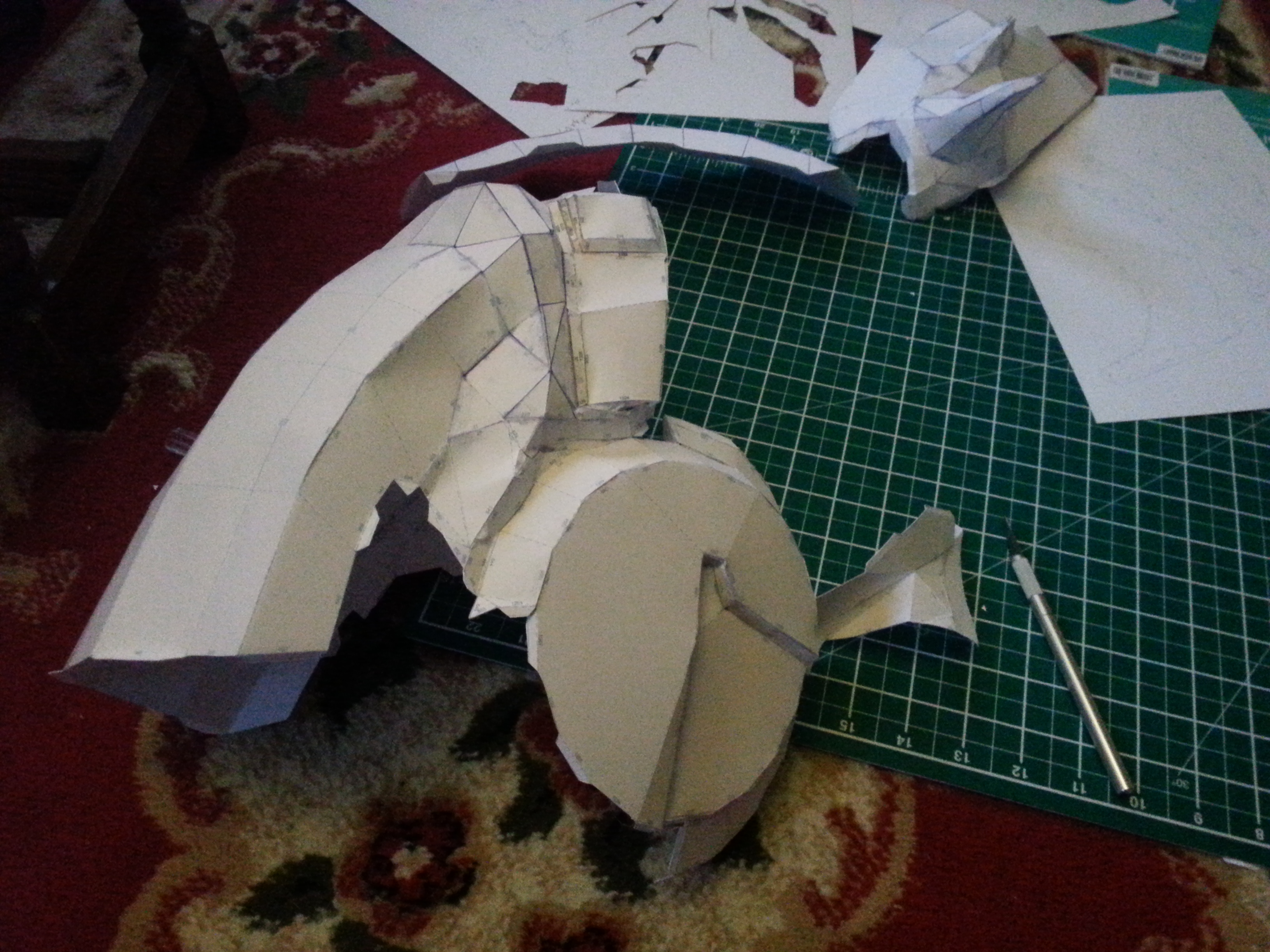

Building
I started with superglue but quickly moved onto a hot glue gun as this sped up the process considerably
20150201_162235.jpg 20150201_162244.jpg 20150202_162725.jpg 20150203_160836.jpg

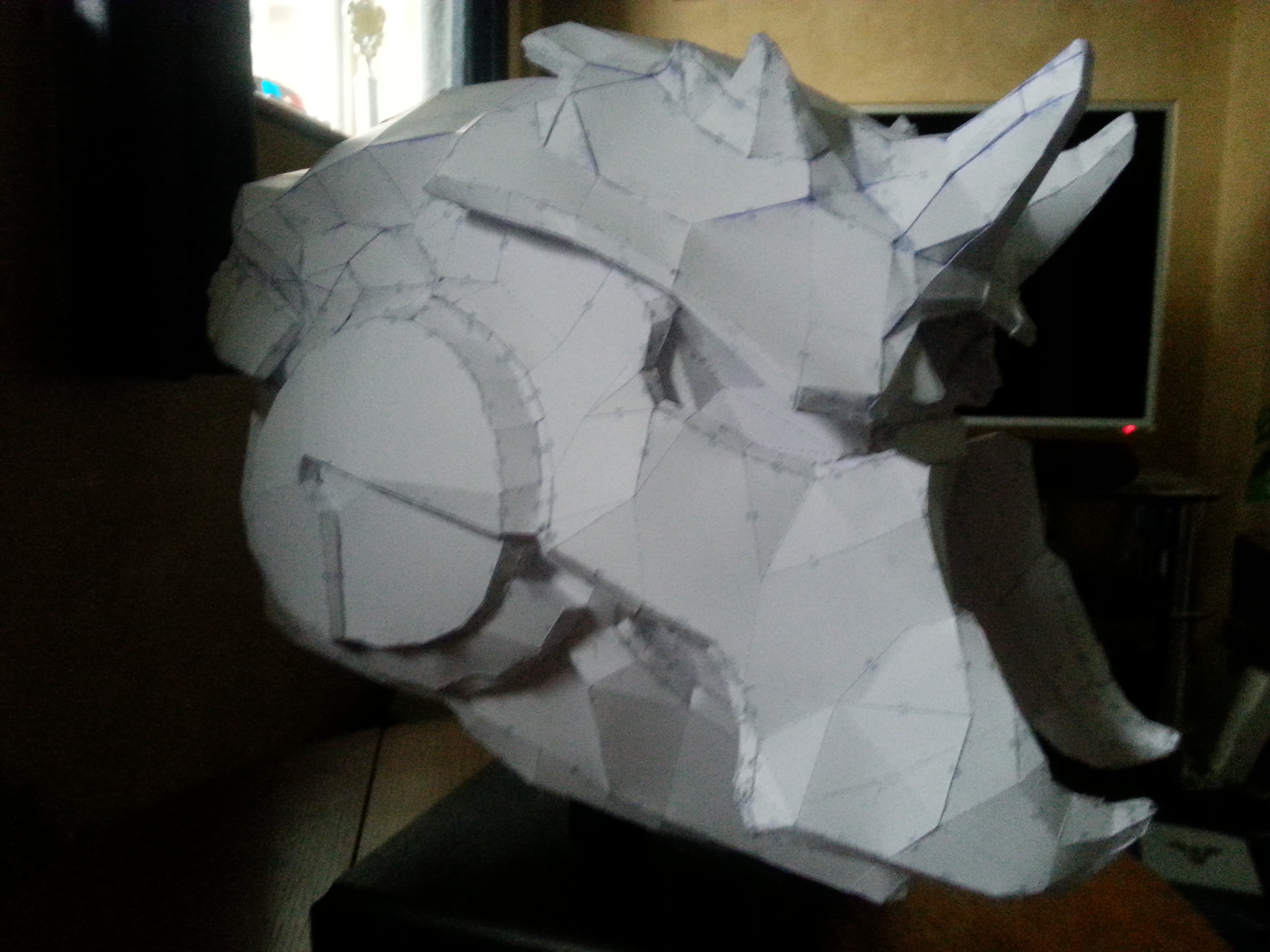

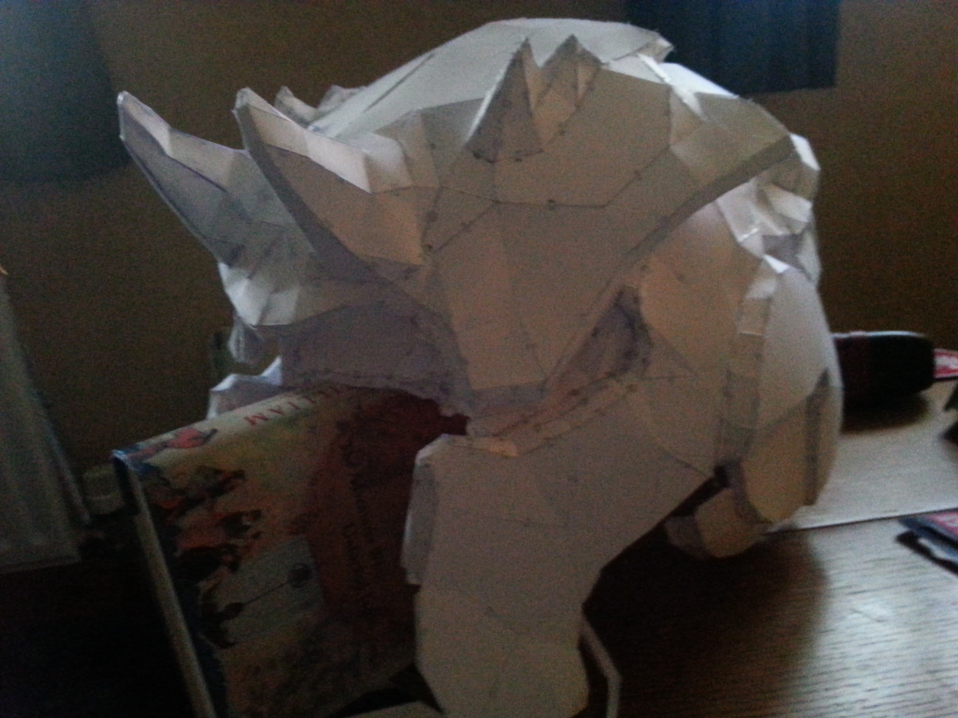

My first go at Pepakura. I know Pep takes a long time but this seemed to take forever, as parts overlay and fold back on each other.
20150212_121212.jpg 20150212_121223.jpg The finished Pep helmet

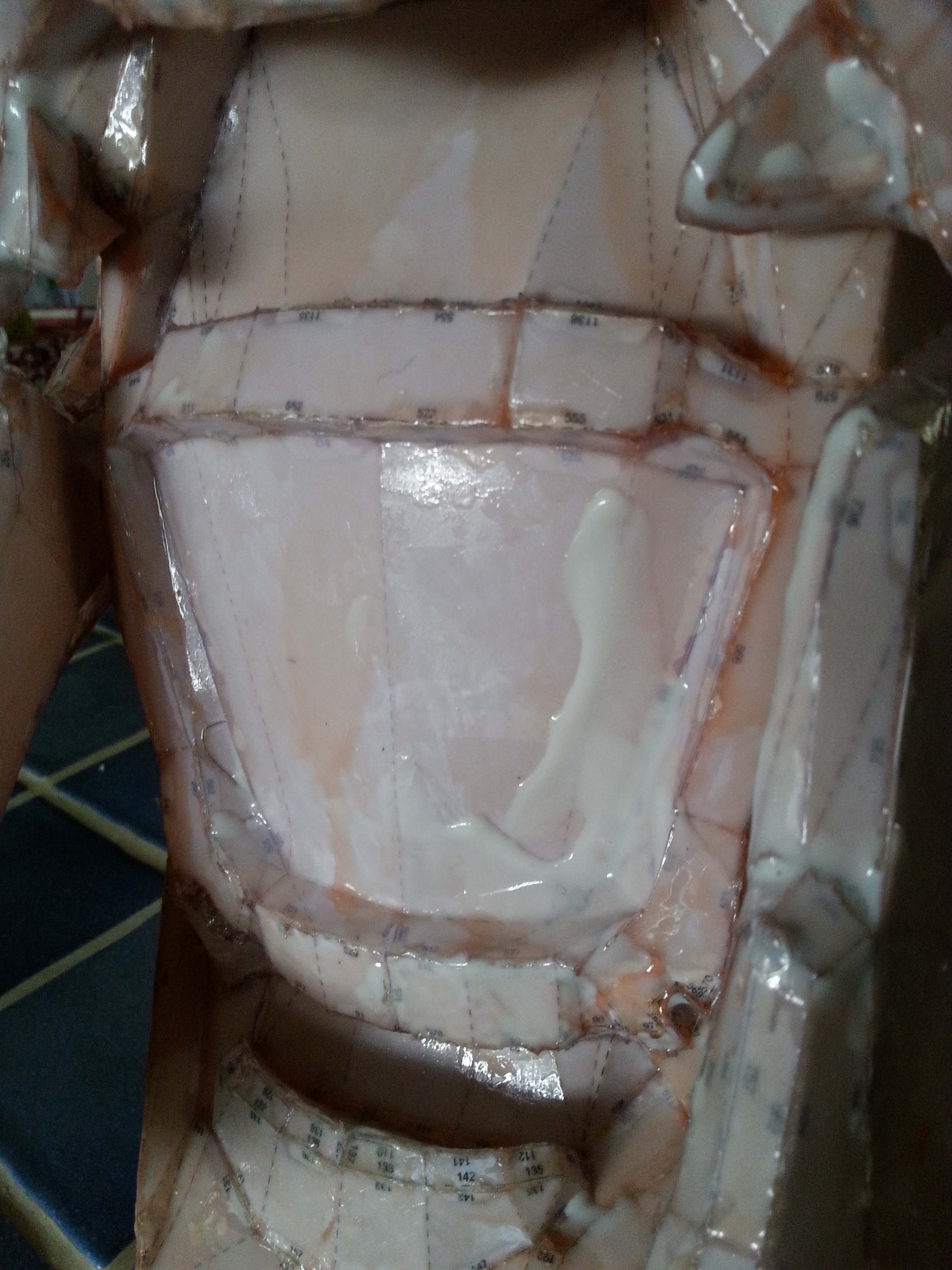

Next was the fibreglass resin on the outside. For this I used David's Fastglas Resin which I got from Halfords (UK)
Applied Resin
20150219_142643.jpg 20150219_142636.jpg 20150219_142617.jpg 20150219_142648.jpg

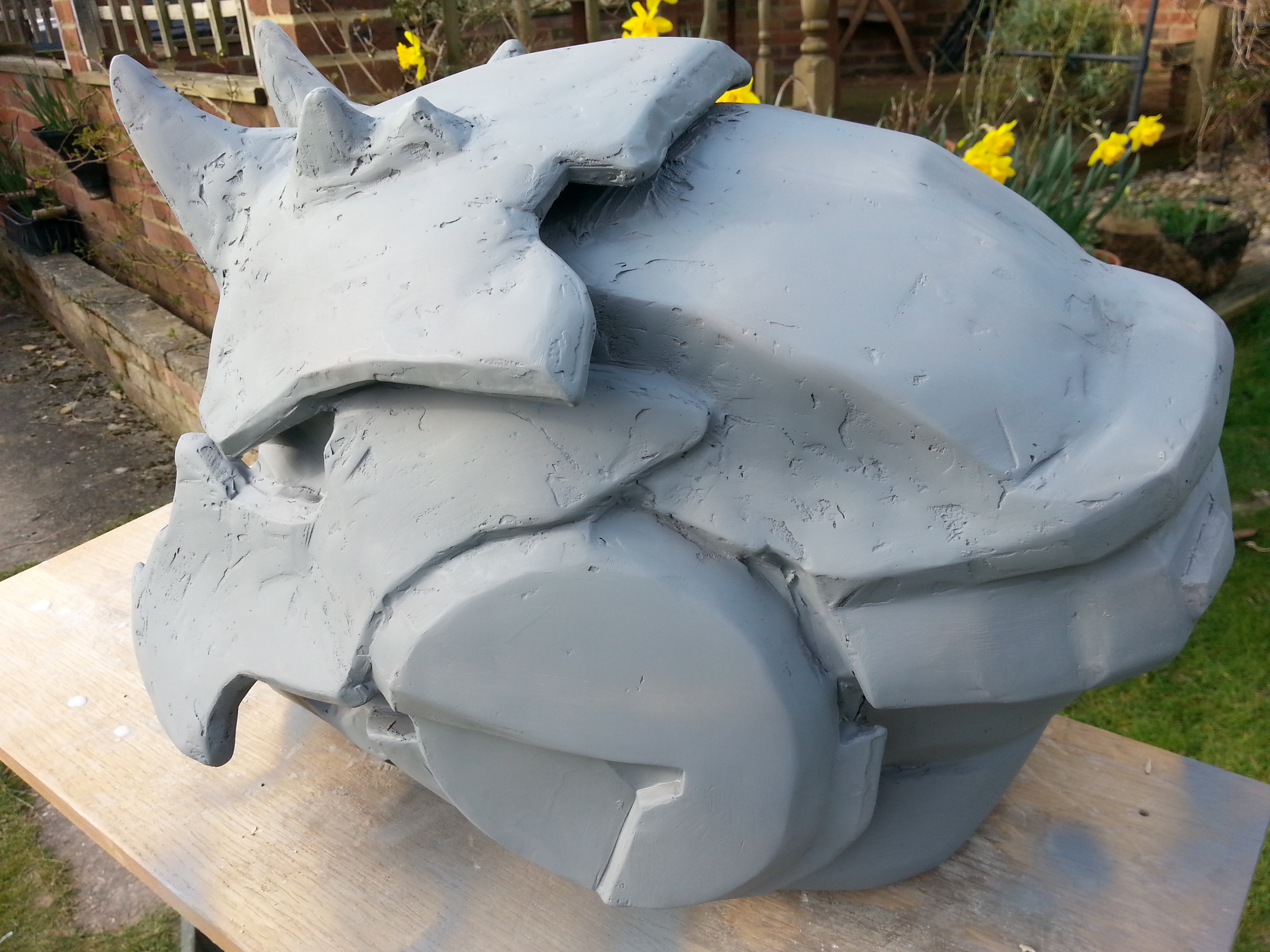

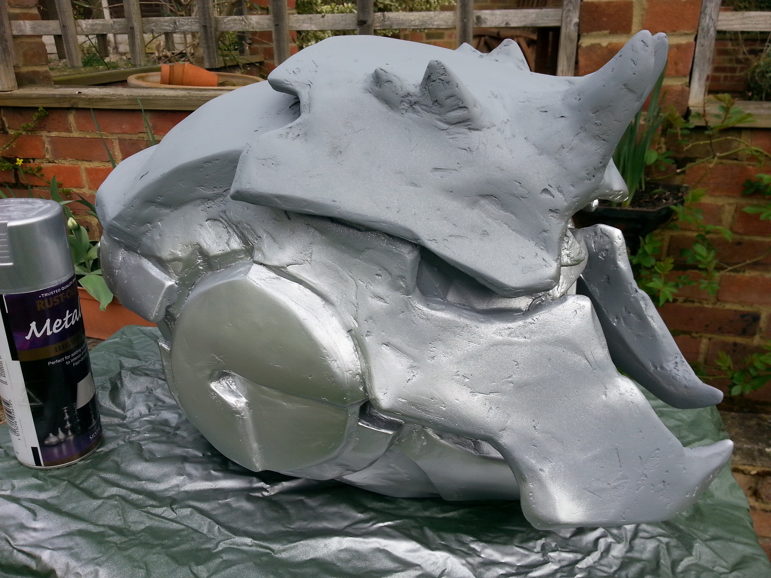

A pass of grey primer to see what things I need to fix and fill before final painting, and there are quite a few.
20150312_153151.jpg 20150312_153158.jpg 20150312_153208.jpg 20150312_153215.jpg 20150312_153226.jpg
I have left the top and side parts deliberately rough and ready which I hope will give a good bone texture when painted and weathered. Otherwise just waiting for some good weather to go and fix the parts which need filling and smoothing, then I will be cutting the visor and prepping for paint.

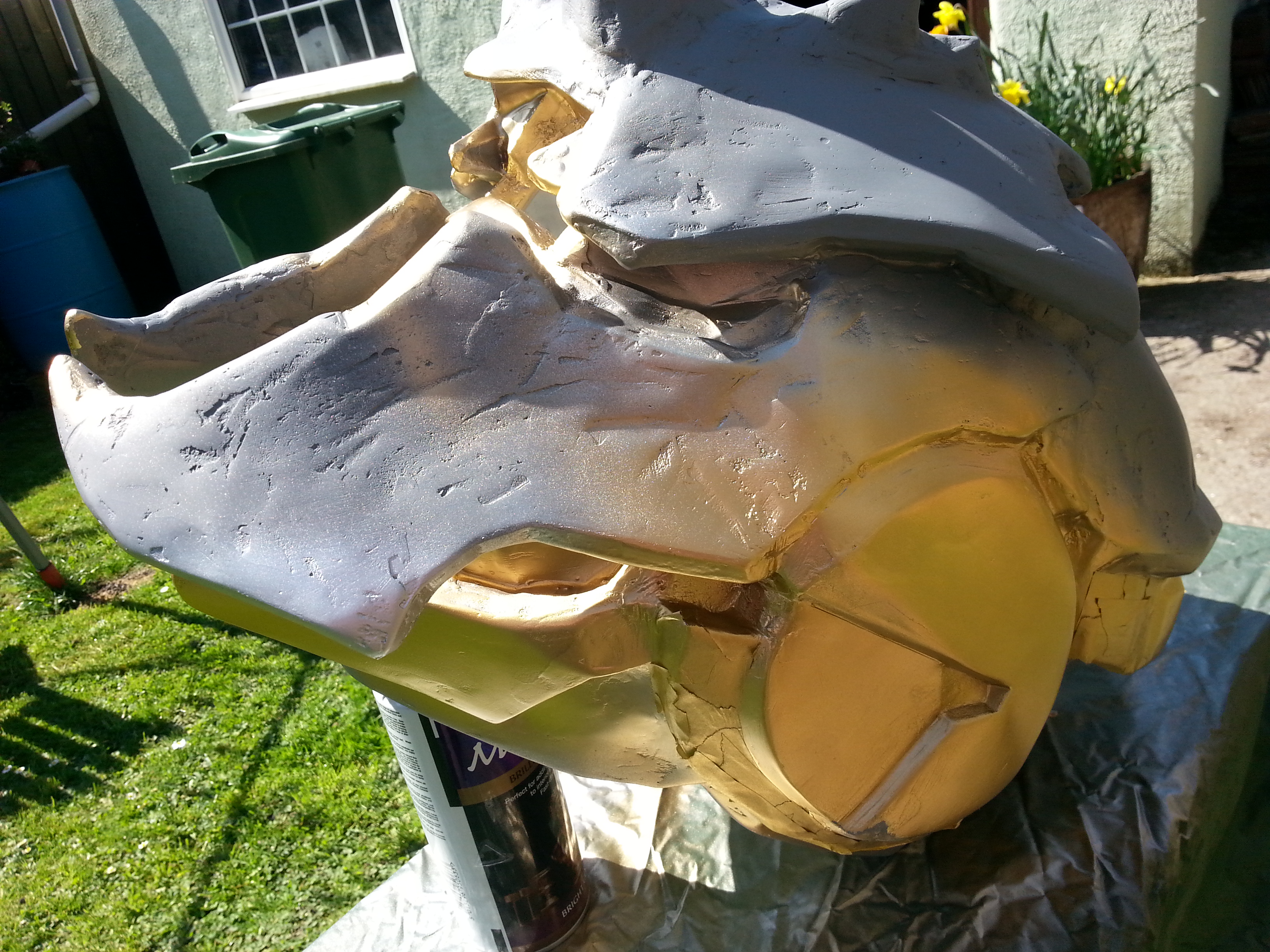

First pass in silver for under the ear pieces and as an undercoat for the gold.
20150413_105426.jpg 20150413_105439.jpg 20150414_131906.jpg 20150414_131914.jpg
Just a tease of the final colour. Got a few more colour passes then the fun begins with the weathering and final assembly.

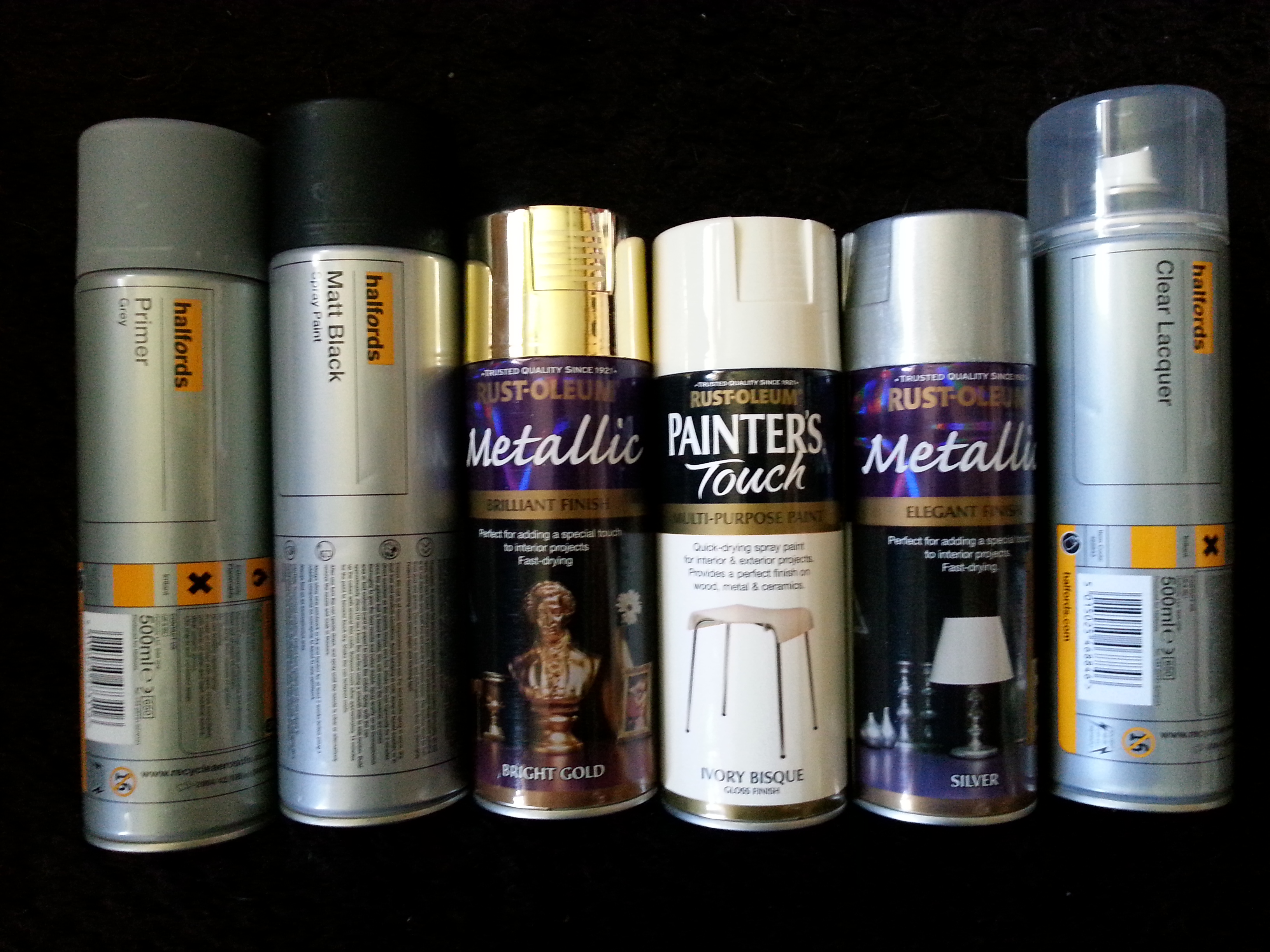

I thought I would first start with the base spray paints which I used on this project, just in case anyone was interested. They are basic primers and lacquers from Halfords, and then Rustoleum Bright Gold, Ivory Bisque, and Silver (which I got from Homebase).

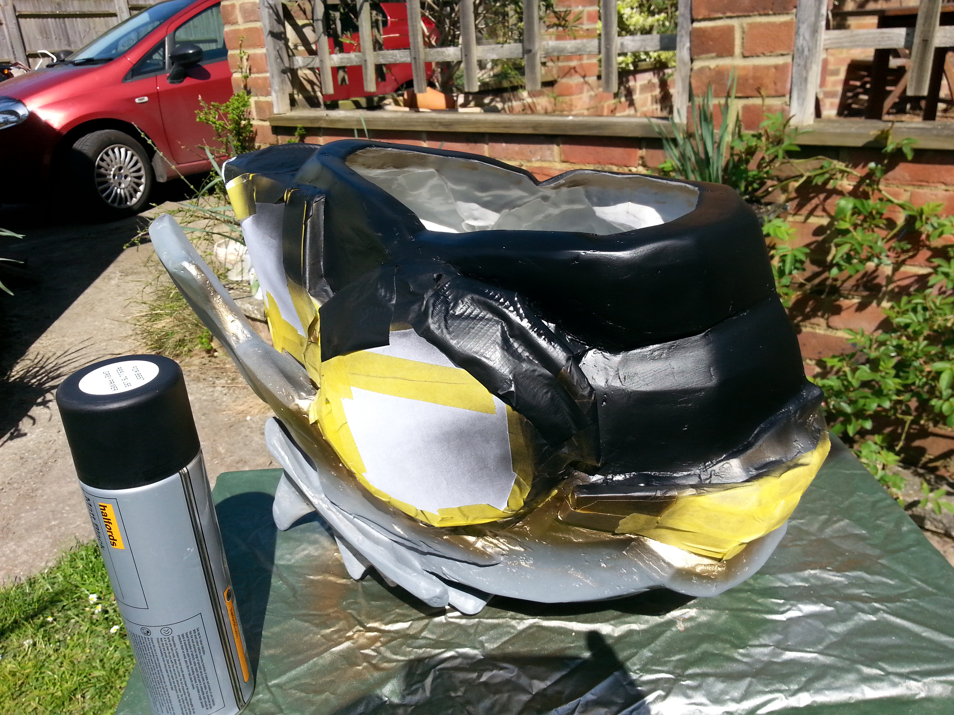

Now continuing on, the black layer

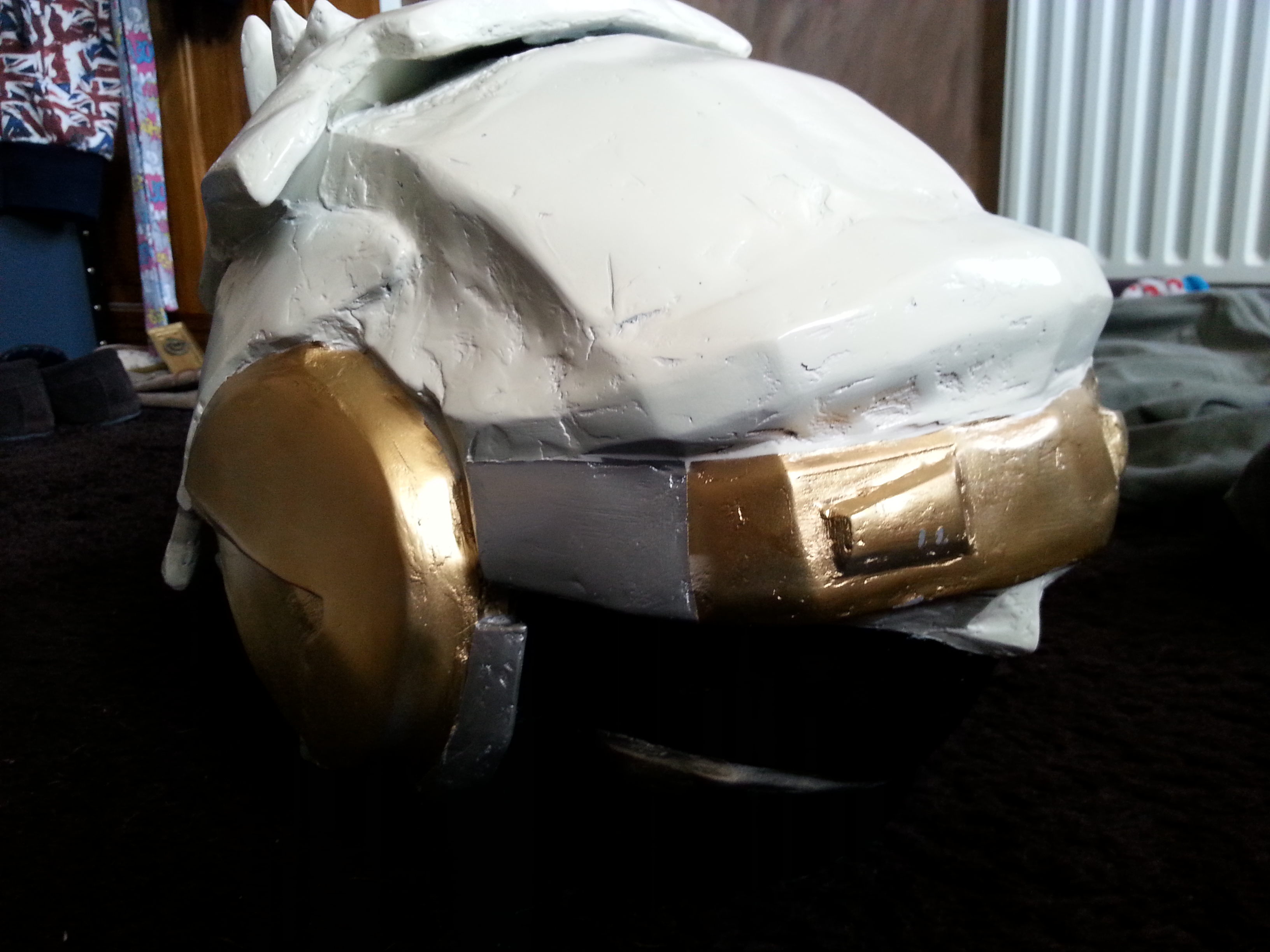

and the Ivory Bisque layer
and the reveal; the raw spray painted helmet. Not very exciting but covered in colour. Now the fun bit, painting it up with texture and weathering.
A cheeky glimpse of the paint job, proper pics t follow. I used lots of different acrylic paints, including; raw umber (very good colour), burnt sienna, yellow ochre, black, cadmium red hue, primary blue, white. metallic titanium gold, metallic silver (metallics were Anita's all purpose craft paint, from the bargain bin at the craft store, the silver is very good for weathering)

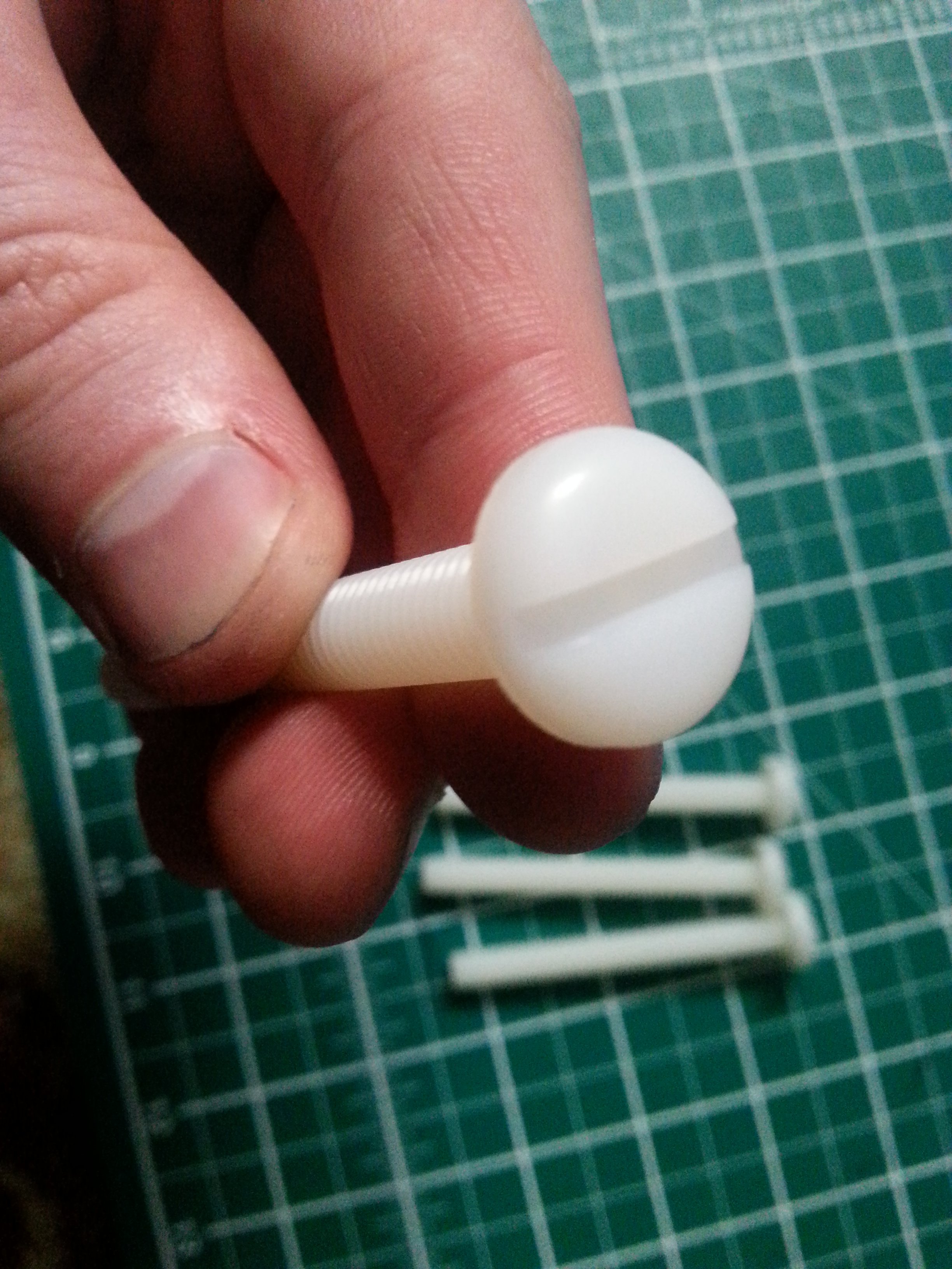

The helmet in the game has screws which hold on the Ahamkara bone. I bought some plastic screws from ebay and cut off the threads. These were then weathered and hot glued down.
Around the screw was also weathered, once it was glued.
