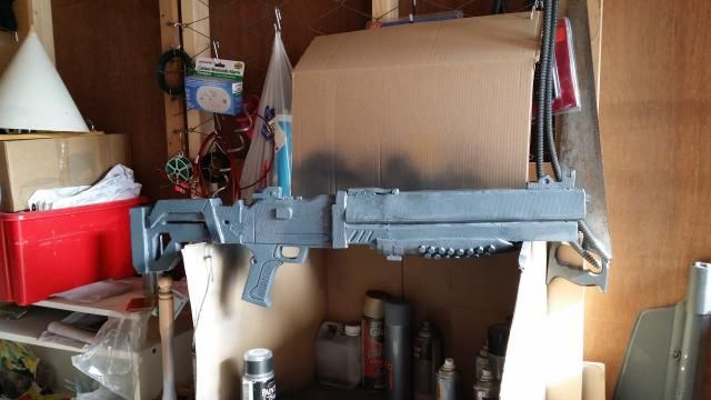

still needed a weapon....
based my build on this
templating and scaling
detailing
prime
and paint
