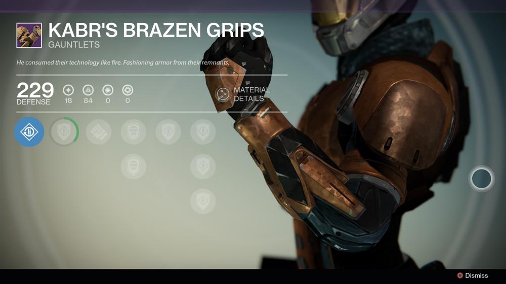

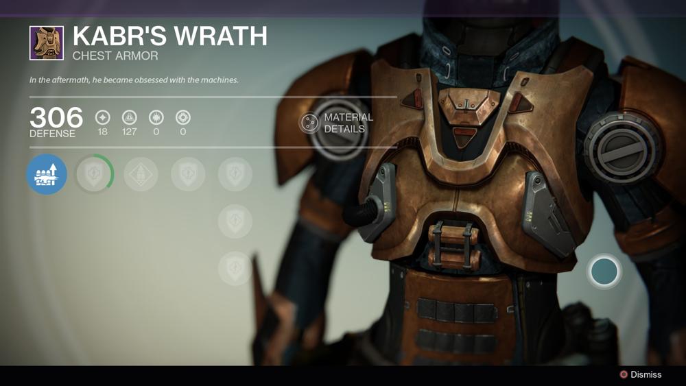

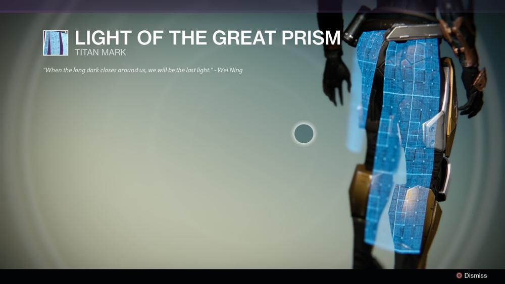

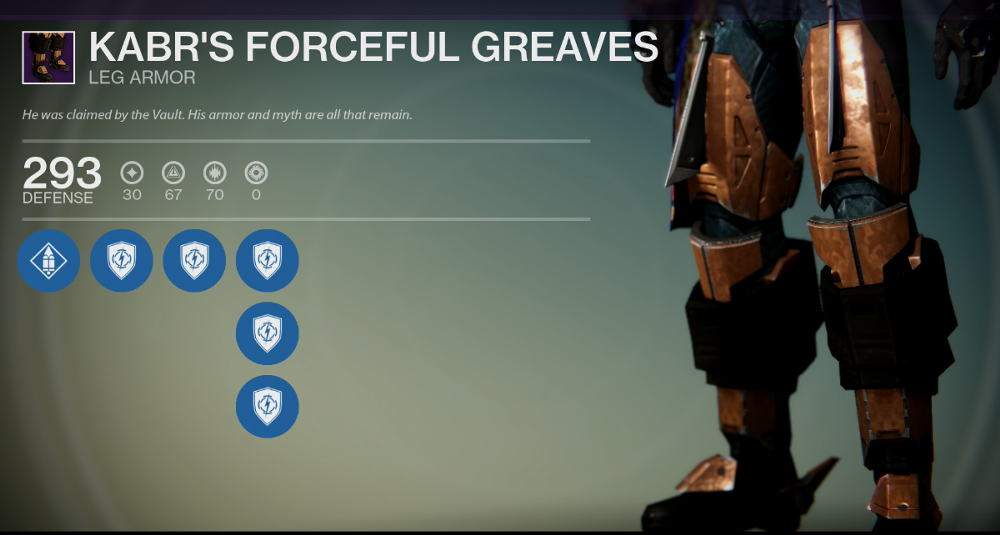

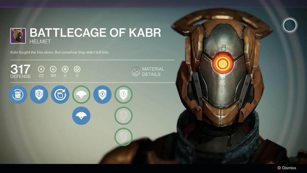

Here's the complete armor set from the first raid, The Vault of Glass, for the Titan class.
1000px-Battlecage_of_Kabr.jpeg1000px-Kabr's_Brazen_Grips.jpg1000px-Kabr's_Forceful_Greaves.png1000px-Kabr's_Wrath1.jpg1000px-Light_of_the_great_prism.jpg
That is awesome. I'm thinking a combo of cardboard and EVA foam seems appropriate for this build.

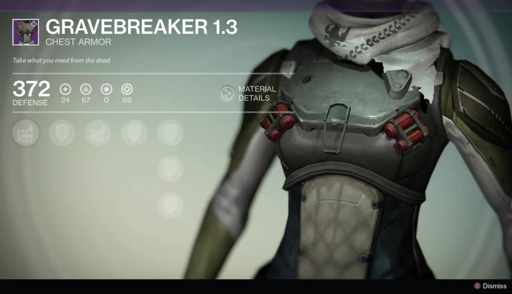

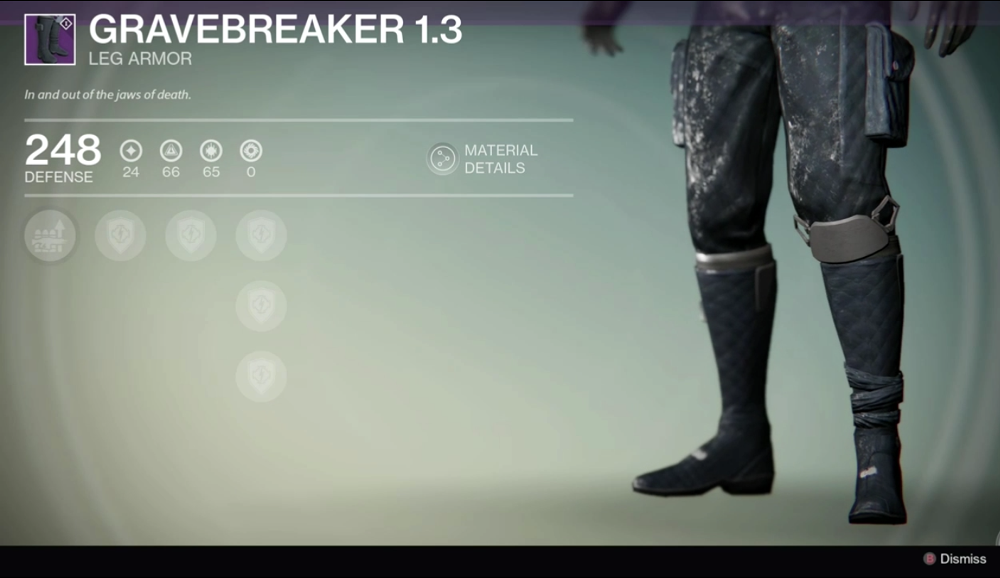

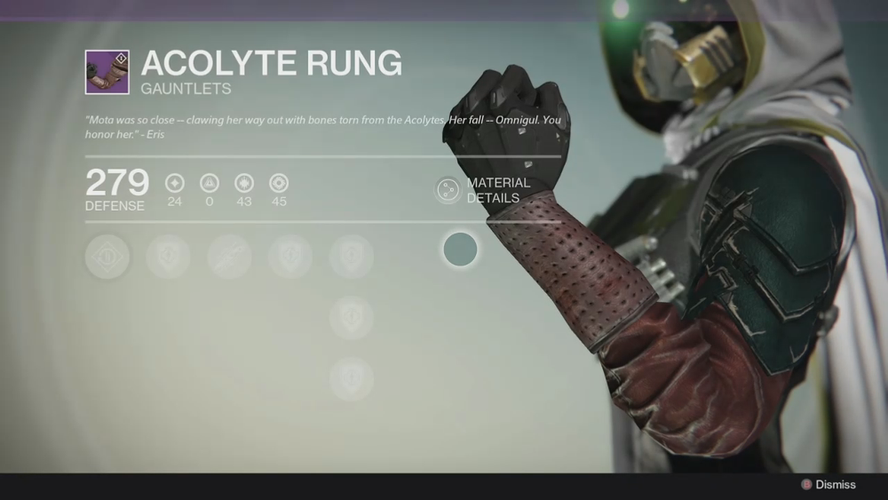

My personal Hunter, which I will hopefully be basing my cosplay build on.
Screen_Shot_2014-09-24_at_1.11.59.png1000px-AcolyteRungGauntlets.png1000px-Gravebreaker_1_3_(Chest_Armor).png1000px-Gravebreaker_1_3_(Leg_Armor).png
NOTE: The chest piece on the Hunter is from a female. I gotta find a male variant of it.

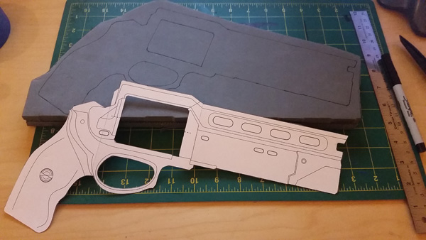

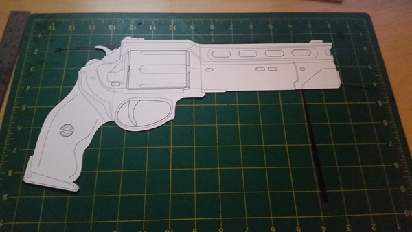

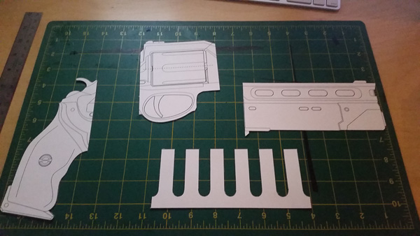

Punished Props has a free MK 44 template blueprint. Downloaded the PDF, then cut the image into parts so I could print each piece on 8.5 x 11 paper. And cut out the parts.
Used blue painters tape to tape together said template parts.
Cut out the trigger and cylinder section out, and cut the hammer off. I'll be making those pieces separately. I Traced the gun shape onto the foam.

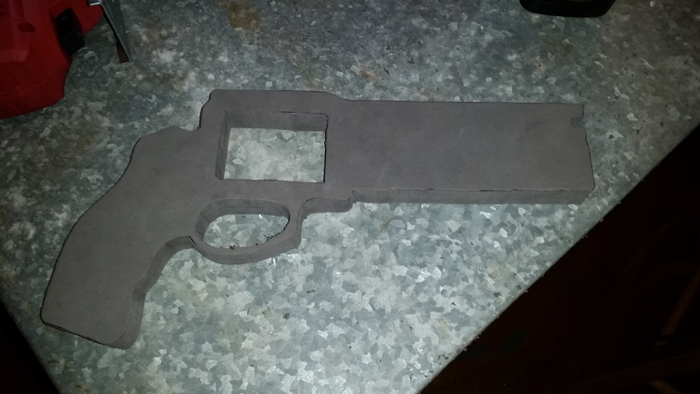

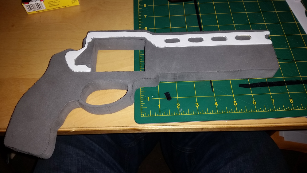

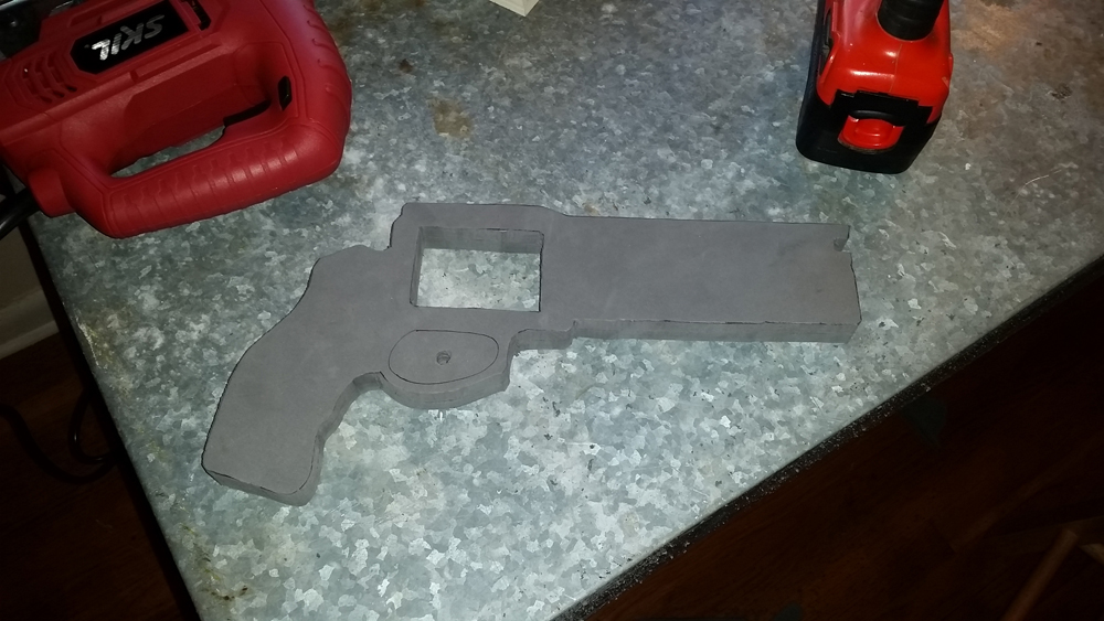

I made more progress on the MK.44 over the weekend.

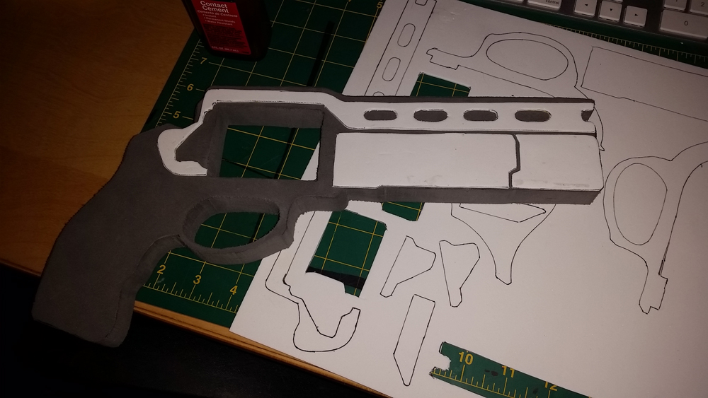

I cut out the gun body from the 2 foam pieces I glued together and cut out the cylinder and trigger area. The jigsaw worked better than a I thought, considering I didn't use a fine tooth blade. The edges are pretty smooth. I'll need to do some sanding but nothing major.

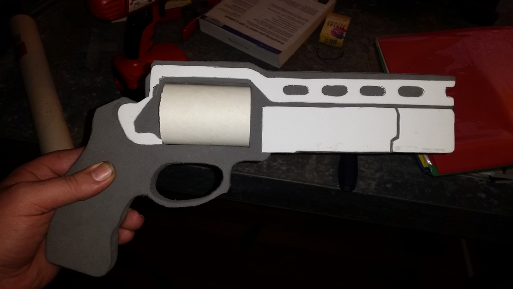

I traced out and cut the detail pieces on thinner foam and glued them to the gun body.

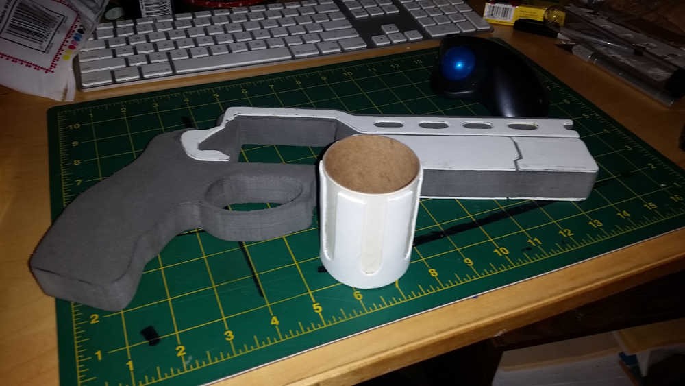

I used a cardboard mailing tube for the Cylinder piece, just cut off what I needed from one end so I could also keep the mailing tube for mailing something later. Then test fit the cardboard tube, and glued the detail piece onto the cylinder and then test fit that piece again.
another cylinder test fit.jpgglued cylinder detail piece.jpgtest fitting cylinder piece.jpg

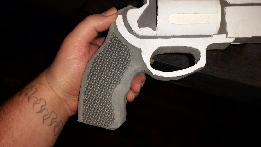

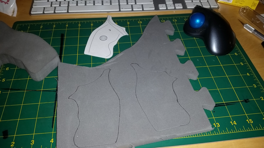

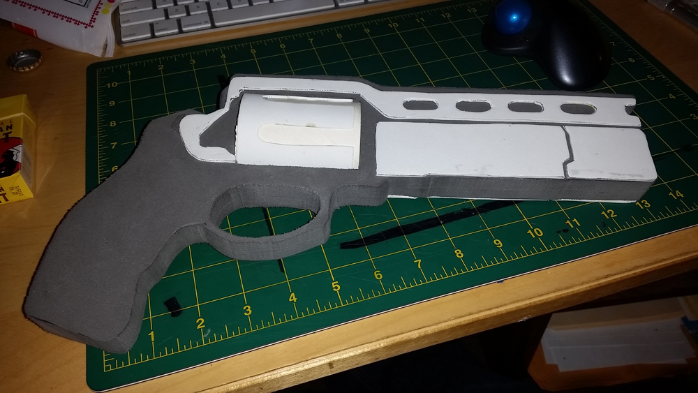

I traced and cut out the grip pieces. The EVA foam floor mats that I am using have a cool pattern on one side and I figured I would make use of that side for the grips, so it has a texture like some real grips.
At this point I have to start sanding / shaping the foam around the grips and smooth out certain areas and sculpt the foam with the dremel to get the grips where I want them. I also have to make some round plugs for each end of the cylinder and add some more detail foam pieces to the gun body.
It's coming together.

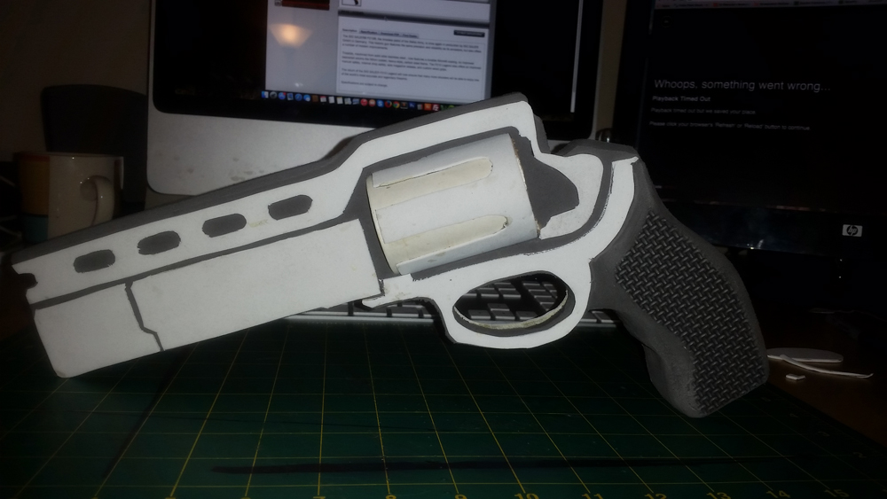

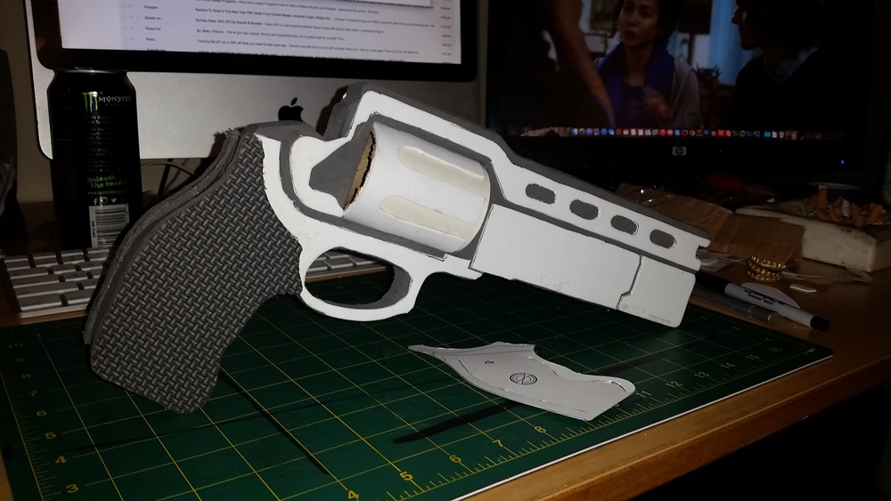

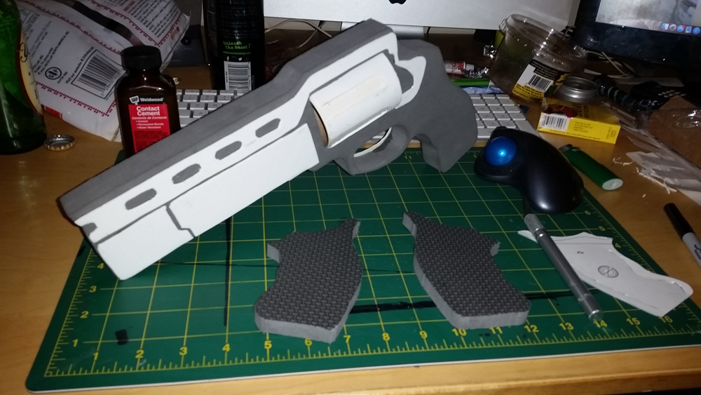

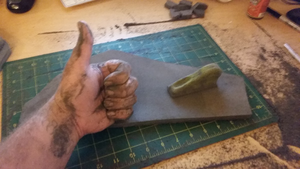

Here's my progress on the MK.44
I started shaping / sculpting the grips on the gun, as well as added a couple beveled edges to the top of the gun (no pics of this sorry) but I'll take more pics.
That's where I'm at so far.
Still need to add some more foam pieces, then start painting.
It's coming along.
