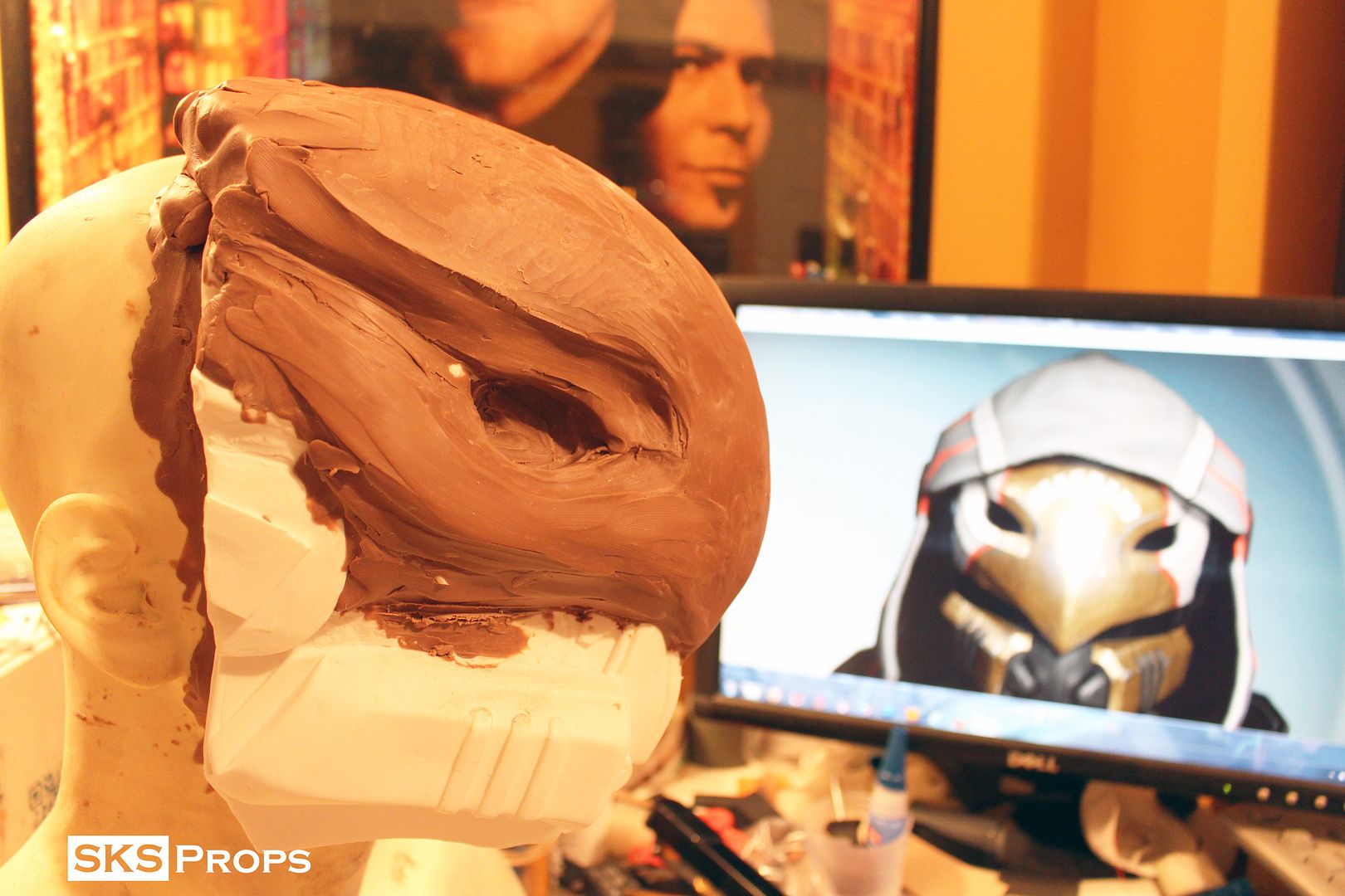

Starting a new hunter thread for my latest mask the Destiny Hunter Celestial Nighthawk. I wanted to make this one so bad that I took this commission even before the official name for the mask was released. This mask should be a little easier to build because I get to use my past helmets as a base to build upon. Like all of my other build I searched the internet to try and find some good reference pics. Even though the DLC just came out there are not many really good images yet. I hope by the time I get to the final details I will either have the helmet in the game or one of my friends will so I can get some better shots. Here is the collage I designed so that I can get multiple angels at once while I build up the clay.
Since it uses the same lower half as my previous hunter mask I am going to build the top out of clay cast it in resin along with a lower half of my first hunter mask. I will then combine the two casts and add the final details for the final version that will be remolded and recast. Here is a shot of the first hunter mask I created. You can see how I built this in my original Hunter thread here http://www.therpf.com/showthread.php?t=228705
I started this mask by casting up a Mask of the Third Man because I like the eye placement better and want the Nighthawk to be pretty close to that in size.
I melt down a tub of Monster Clay and begin building up the bulk of the shape adding small amounts of clay here and there. You don't want to add to much at once or start getting into details before the form is really flushed out.

Ok now that I have got around to uploading a bunch of Destiny Celestial Nighthawk pics let go back and see more of my sculpting process. I started off by using a cast of my third man mask because I really liked the placemen of the eyes. I usually start by taking small globs of Monster Clay and build up the profile and basic features. I have found I work better this way because I won't clump to much clay on at once and get lost in the overall form. The mohawk ridge I created is used as a guide for the top and front of the mask. The sculpt still needs to remain very loose though you don't want to start putting in details and then realize that form is all wrong.

I'm going to back up a little bit here and show you more of the sculpting and refining process. One of the thing I like to do it turn my sculpt upside down and look at it from a different point of view. This will help with getting symmetry and proportions. Funny thing is once I though I was pretty close I found a site called Destiny DB and on this site you can 3d rotate in game models. Needless to say I was off in some areas and had to go back and cut out or build up areas. Another trick I like to use is to place a string right down the middle and see how the sides line up. The top of the mask was made the same way by building up with warm clay and once cooled cutting out the excess. And the last pic is one of my favorites. It shows the new mask sculpt with my Destiny Mask of the Third Man in the background :)
