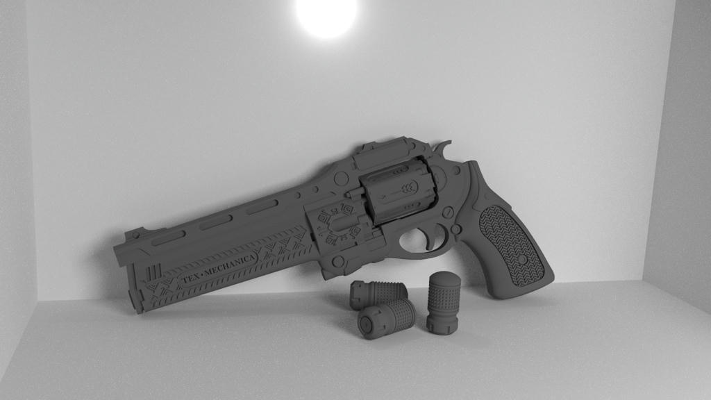

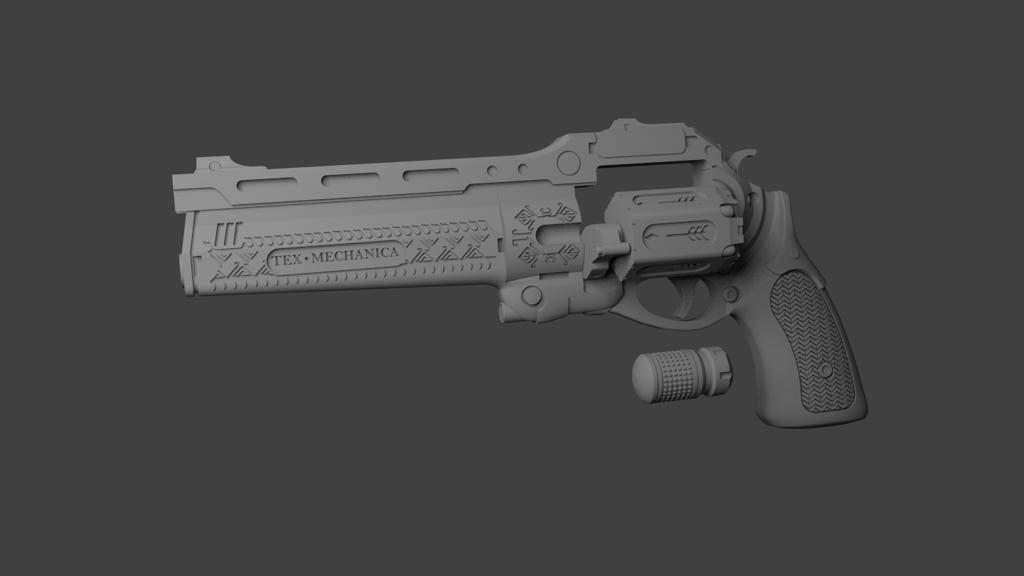

And the finished model:
Opened cylinder and load:

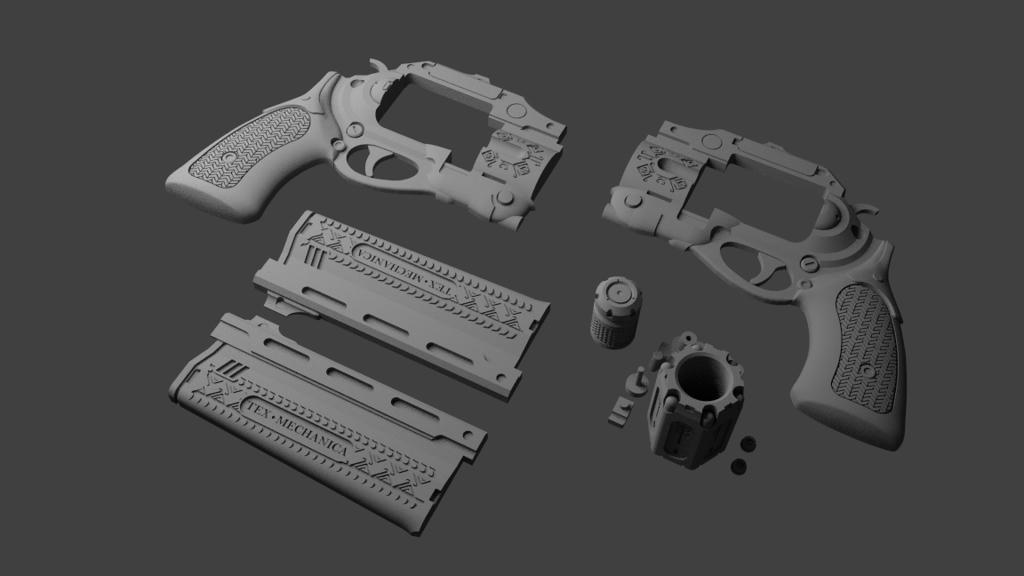

The print breakdown:

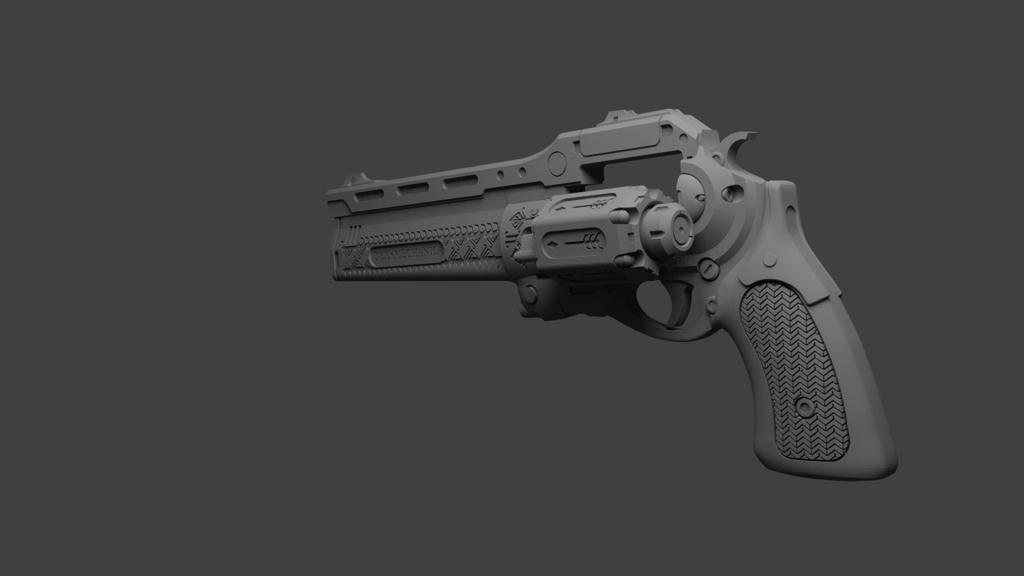

...And a last shot:
