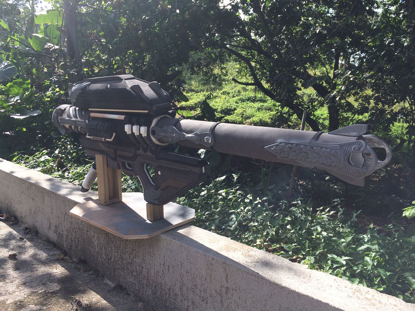

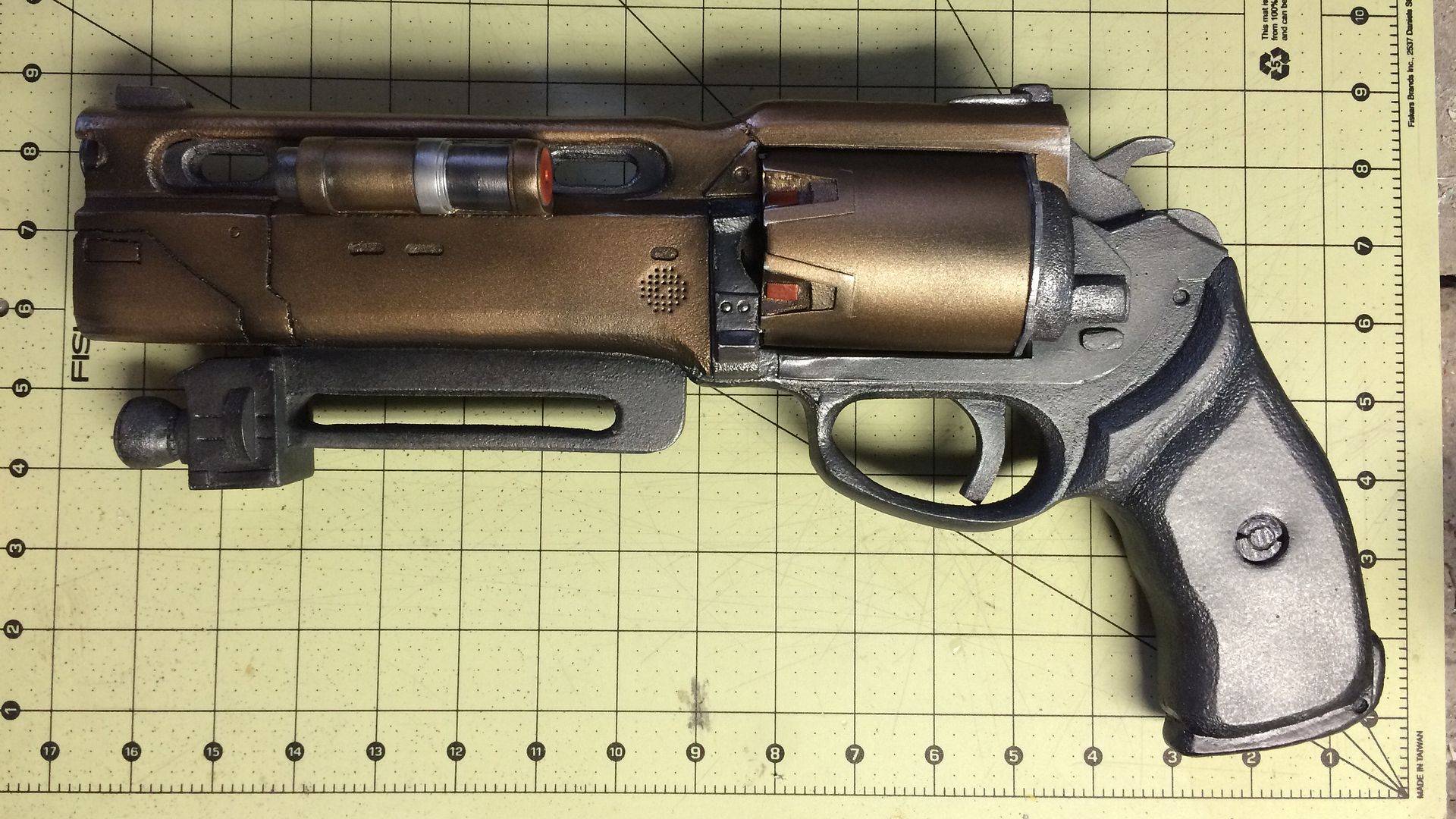

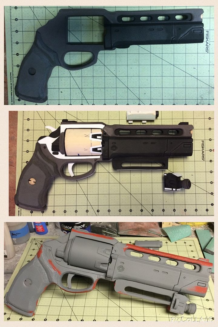

    I call her "Foambringer"
    [​IMG]
    just a little more filling and itll be ready for paint

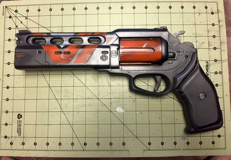

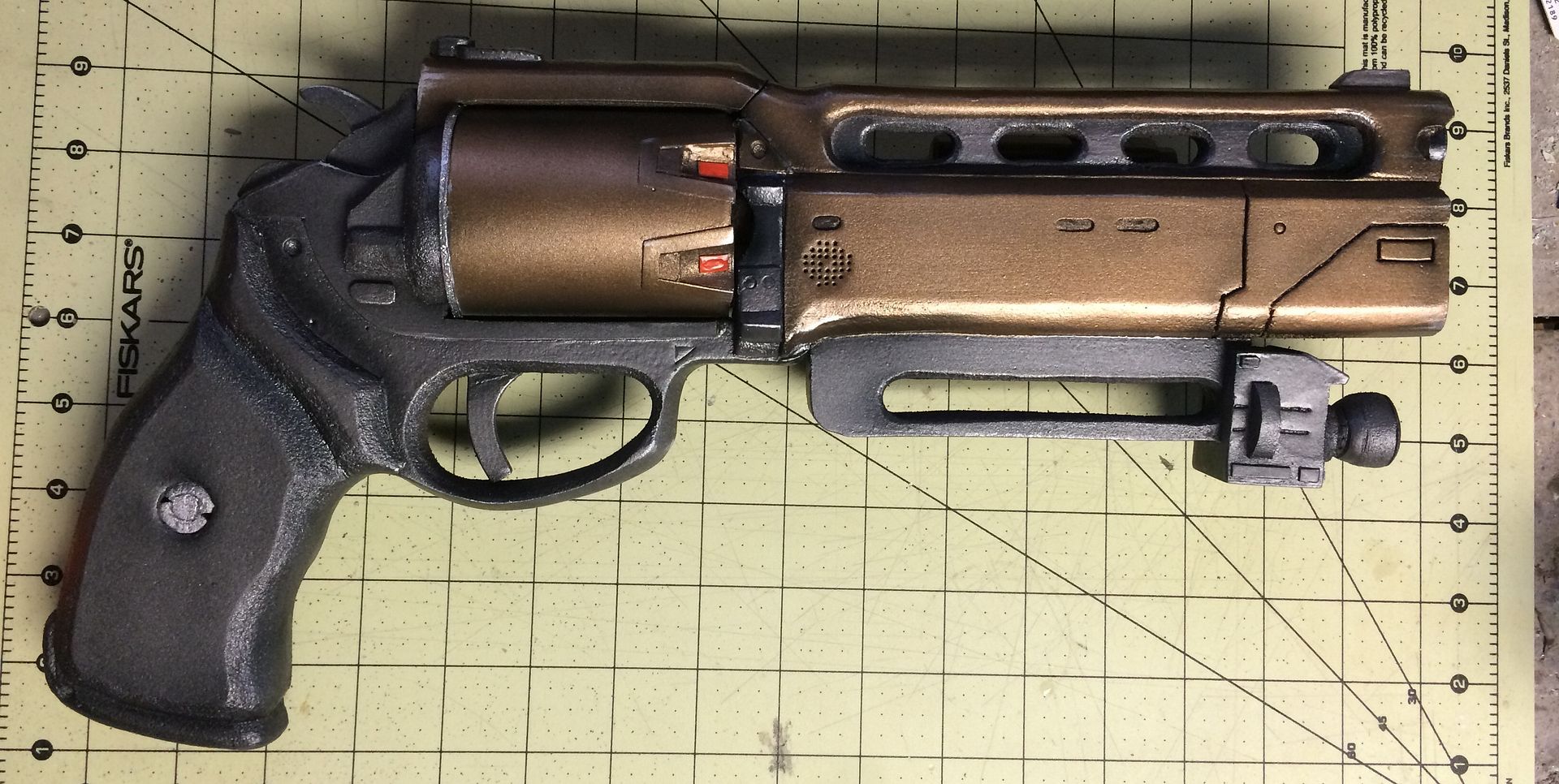

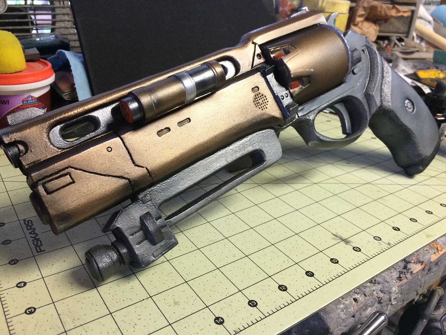

    Delivering the inevitable, one pull at a time
    Hope you like
    [​IMG]
    [​IMG]
    [​IMG]
  4. Tarchinoko
    Tarchinoko Well-Known Member
    Trophy Points:
    566
    Re: Destiny Fatebringer hand cannon out of foam
    looks fantastic! how did you remove the pattern on the back of your foam so layers would glue together flush? Also what are you using to fill your foam pieces?
  5. made007
    made007 Sr Member
    Trophy Points:
    1,356
    first i take off the diamond pattern with a belt sander, then i glue with contact cement, and clean with the dremel sanding drums
    i seal carefully with modge podge matte and a sponge, thin layers, coat with primer then use automotive red putty in unwanted seams
    ButtSauce likes this.
  6. Tarchinoko
    Trophy Points:
    566
    haha thats the bit of kit im missing then :p a belt sander
    I use mod podge too for my foam builds, does the automotive putty ever crack in the seams and chip off? I wouldve thought that would happen as you are filling in a non rigid material with a rigid material
  7. made007
    made007 Sr Member
    Trophy Points:
    1,356
    it wont unless you bend it or hit it very hard, the gun is not meant to be bendable, its a gun, people fill with wood filler and drywall filler those are solid too, i use automotive because it bonds better, also i use smal qty, if the gap is too big its more likely to crack or separate

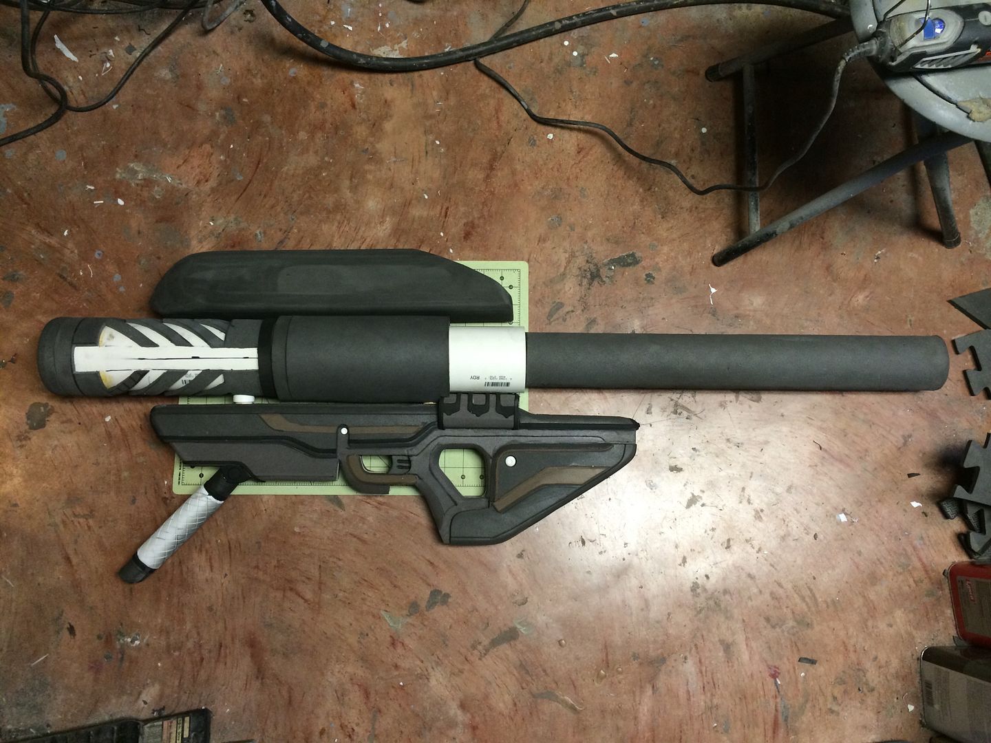

    Thanks everyone, currently making a gjallarhorn out of foam
    [​IMG]

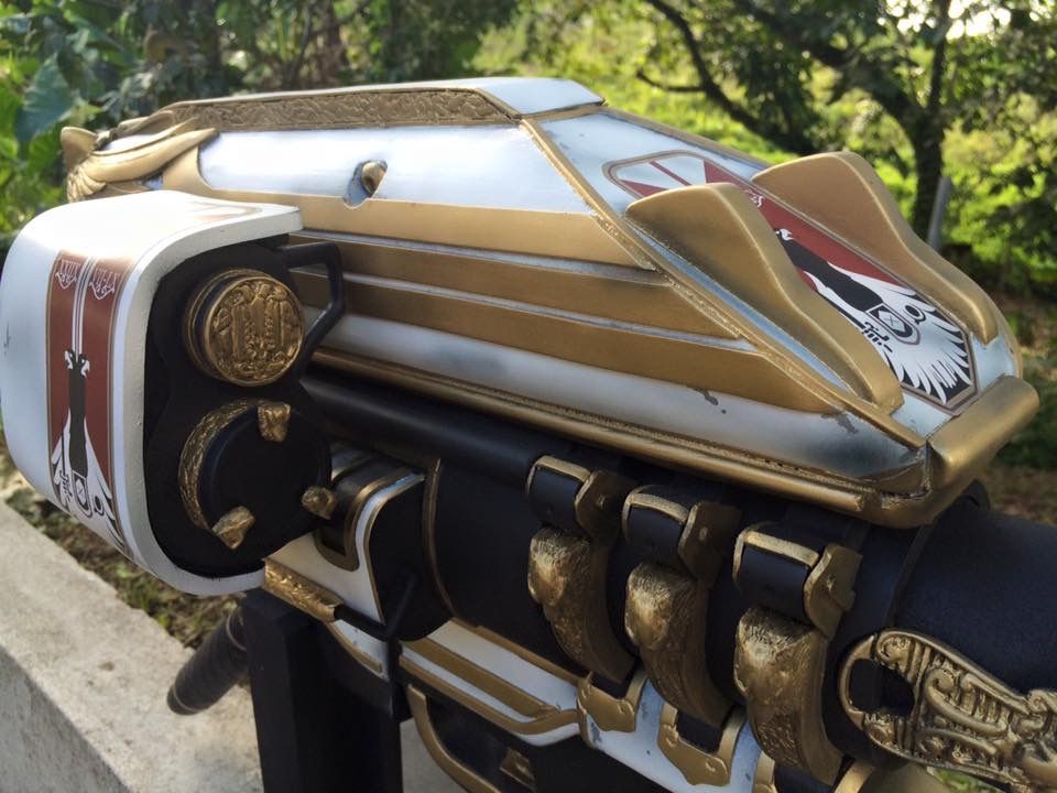

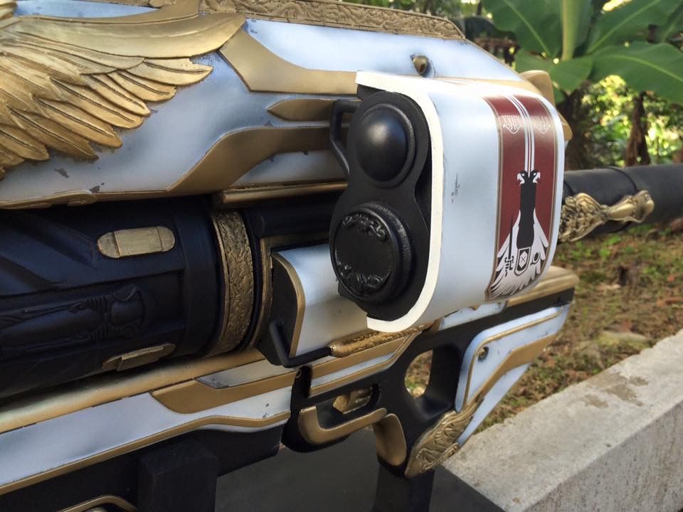

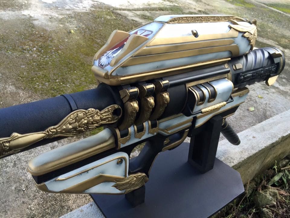

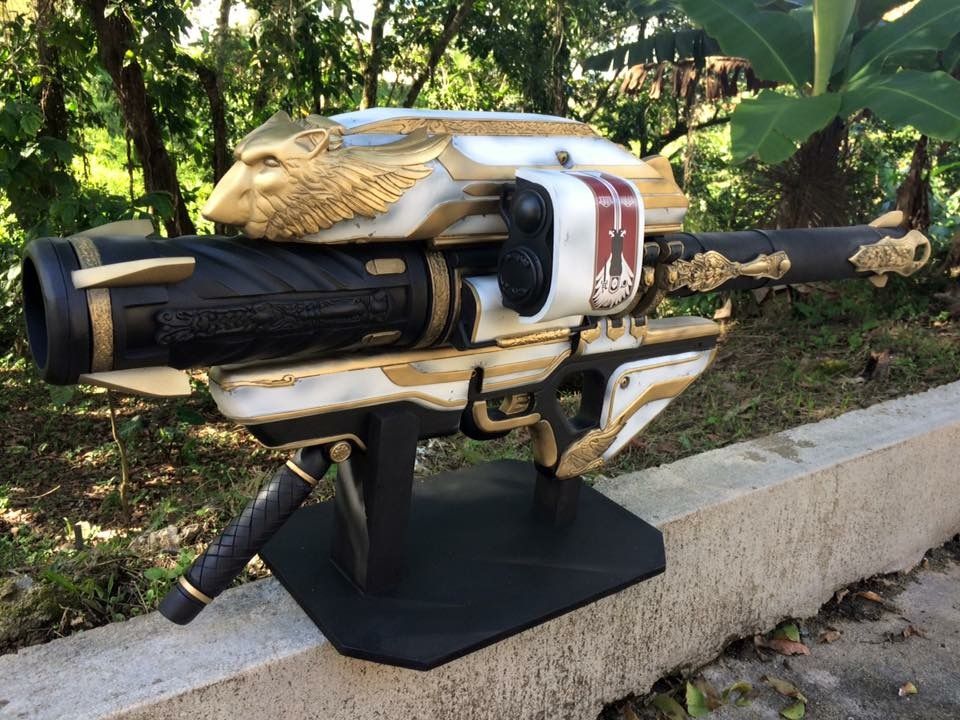

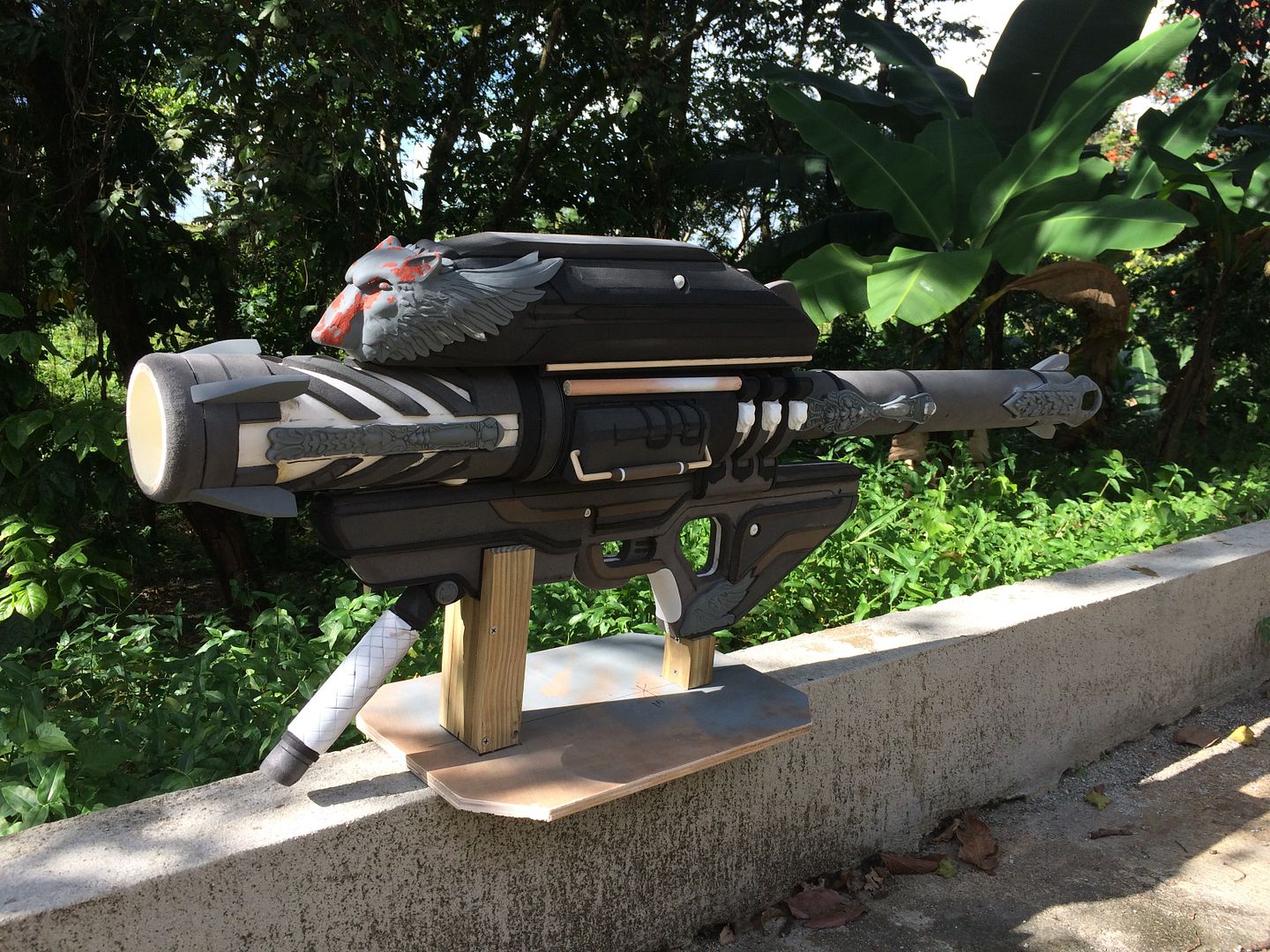

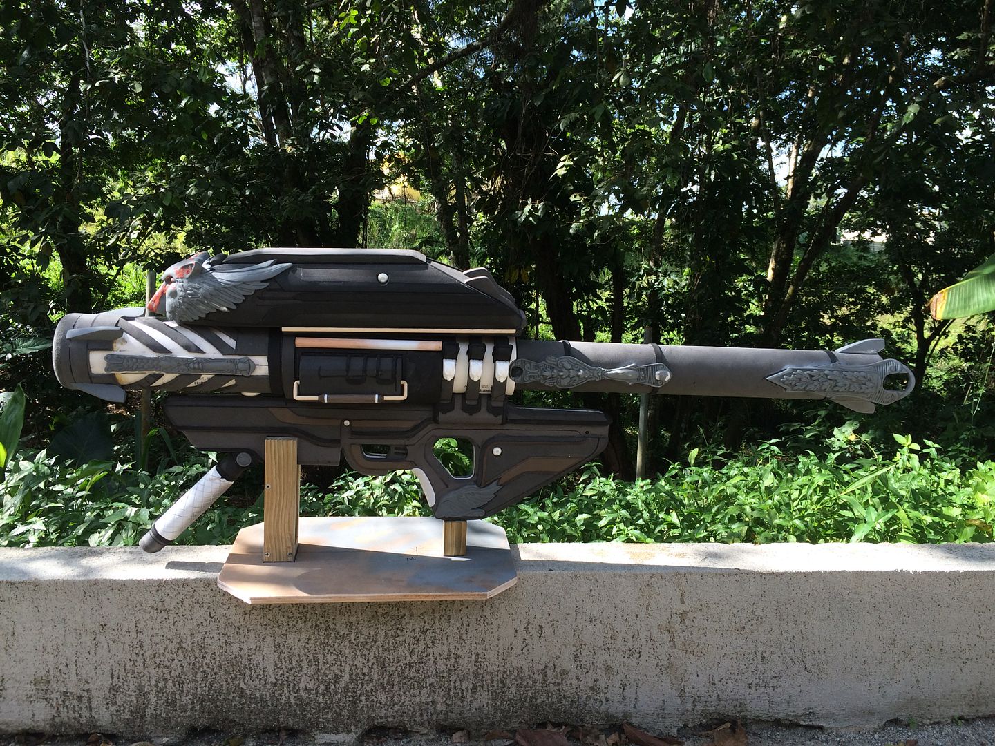

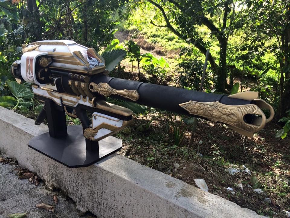

    Re: Destiny Fatebringer hand cannon out of foam, added gjallarhorn 9/25/2015
    Finally finished building it, currently sealing to prepare for paint
    [​IMG]
    [​IMG]
    [​IMG]
    [​IMG]

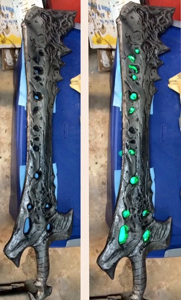

    And my finished crotas sword also foam
    [​IMG]

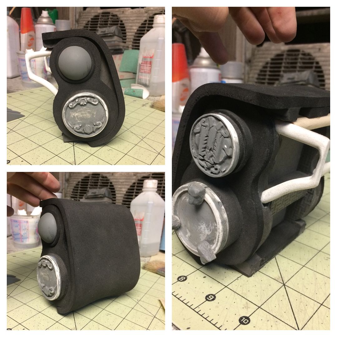

    These look amazing!! If you dont mind my asking, how did you do the detail work on the back end of the g'horn. The little floral looking badges? Was that all foam as well or was it a clay mold/cast?
  20. made007
    made007 Sr Member
    Trophy Points:
    1,356
    Re: Destiny all foam props, finished gjallarhorn pics and video of it in action 3/5/2
    I sculpted those with chavant nsp medium clay around a pvc tube, then i made a mold and casted them
