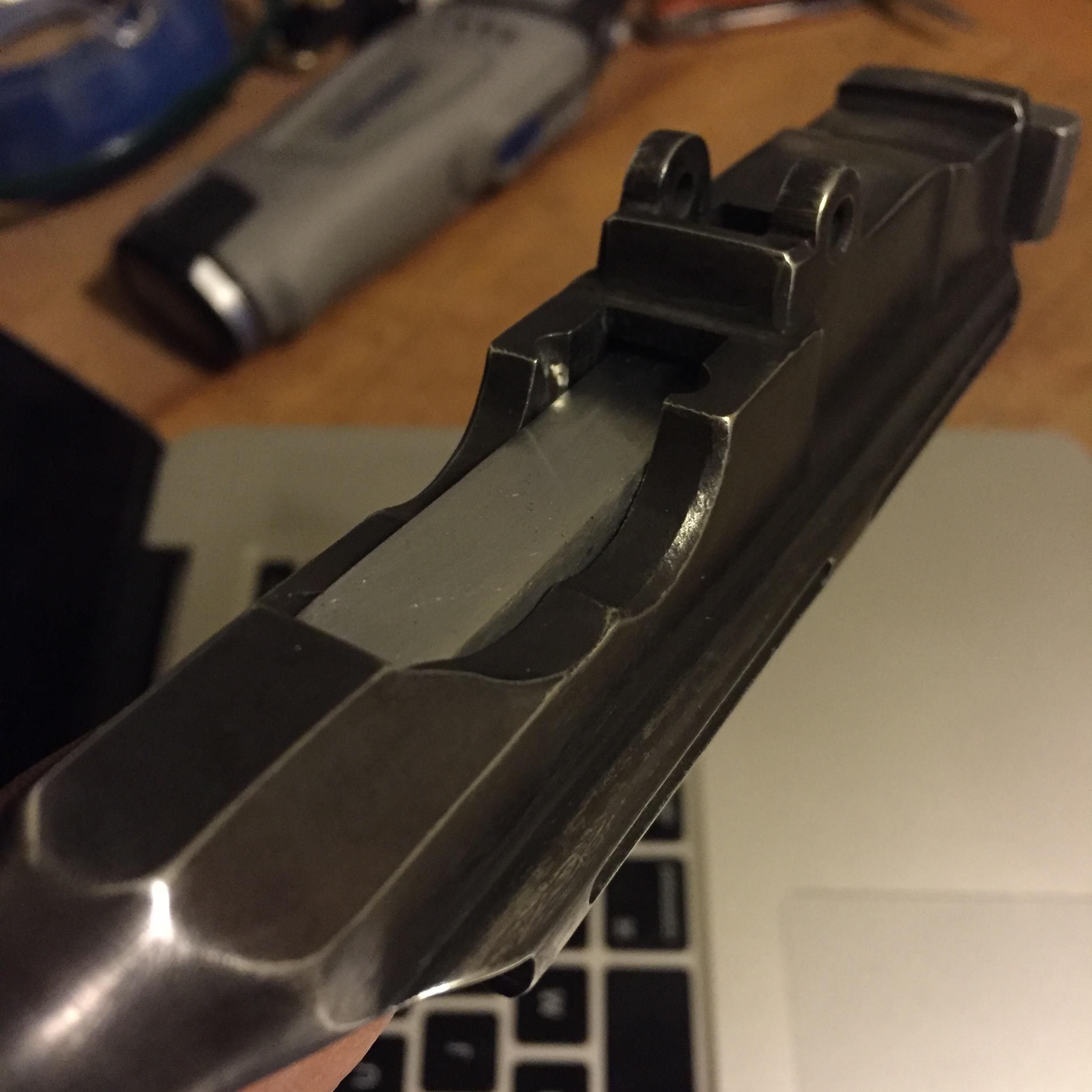

This, too, is a section of the DL 44 process that I'm not familiar with and would like to learn more about. How dark does it get after a just one coat?
I've used Novacan Black Patina for Zinc on my Denix Boo and it seemed to work really well. I'll echo the prep
In my experience discouragingly un-dark. A couple passes in it starts to fill out, though. This is I think eight passes w/ some weathering along the edges. Again, I warmed it before each rub down. Surface was smooth and clean beforehand. I rinsed with cold water and buffed with 0000 steel wool between each pass.

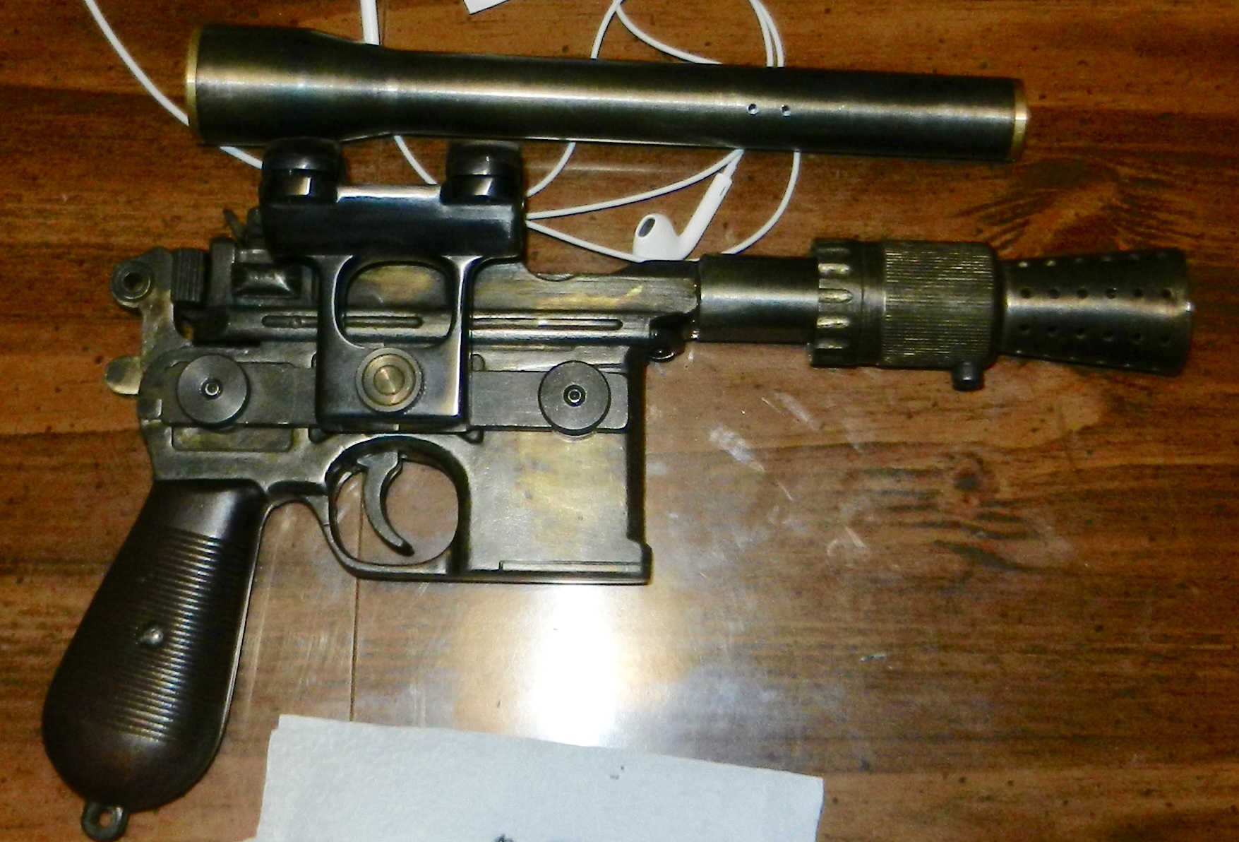

Good post. Does anyone know what the best way to blacken brass? Or should I use paint?
They make brass black as well. You can also tarnish brass with ammonia fumes (suspend them in a jar above a few inches of ammonia... remember to close the jar!). Once it's tarnished you can paint it black, and weather accordingly. It all depends on what kind of finish you're trying to simulate in the first place.
Awesome. Is there a particular reason why it would the tarnishing would need to be first? Do the ammonia fumes react with the blackened brass?
The tarnishing is just another way to simulate age. Brass black + buffing can get you a similar result. So say the part you're trying to finish was originally brass that was painted black, but now the paint has chipped and the brass oxidized, you can "age" the brass before painting with either of those methods, then follow up with some paint, then chip some paint off. Bingo bango - 100 year old thingymabob.
Which agent did you use to get that wonderful result? Is that the Novacan or Aluminum Black?
Like it was said, they make brass black. However I have had luck with Aluminum Black on brass too. I used it on a brass lightsaber hilt I made and some BSG dog tags. Not sure how the two products stack up in comparison but my point is that if you don'y need a lot of BB and you happen to have some AB, you might want to give it a shot.
Yeah I would bet they all have similar oxidizing agents in them. I've even heard you can put zinc in a ferric chloride bath and it will blacken. I haven't gotten up the courage to try it yet though.
