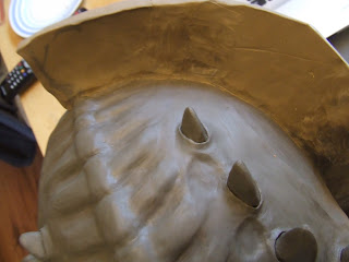

here is the clay wall starting to go on around the sculpt half way from front to back to make a 2 part mould
I have added a lip on the top so i can make the plaster more like water to try and get better detail from the surface.....the lip is to just contain it from spilling
Well here is the side view of the wall and bellow is where its finished with lip ready to go....finger crossed lol

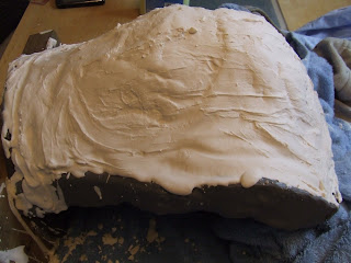

OK here we go first layer of plaster on covered nicely i noticed the nose had air bubble and promptly popped lol few!!
Here is the second layer making sure i pushed it into the gaps dont have much time with this plaster as it starts to set after about 5 mins so kind of pasting it on with my hands now....
here is the 3rd layer now less panicy no lol as this layer is just for strength
the fourth layer again for more strenght
And a final thin top layer this is just to smooth it out for ease of handling
