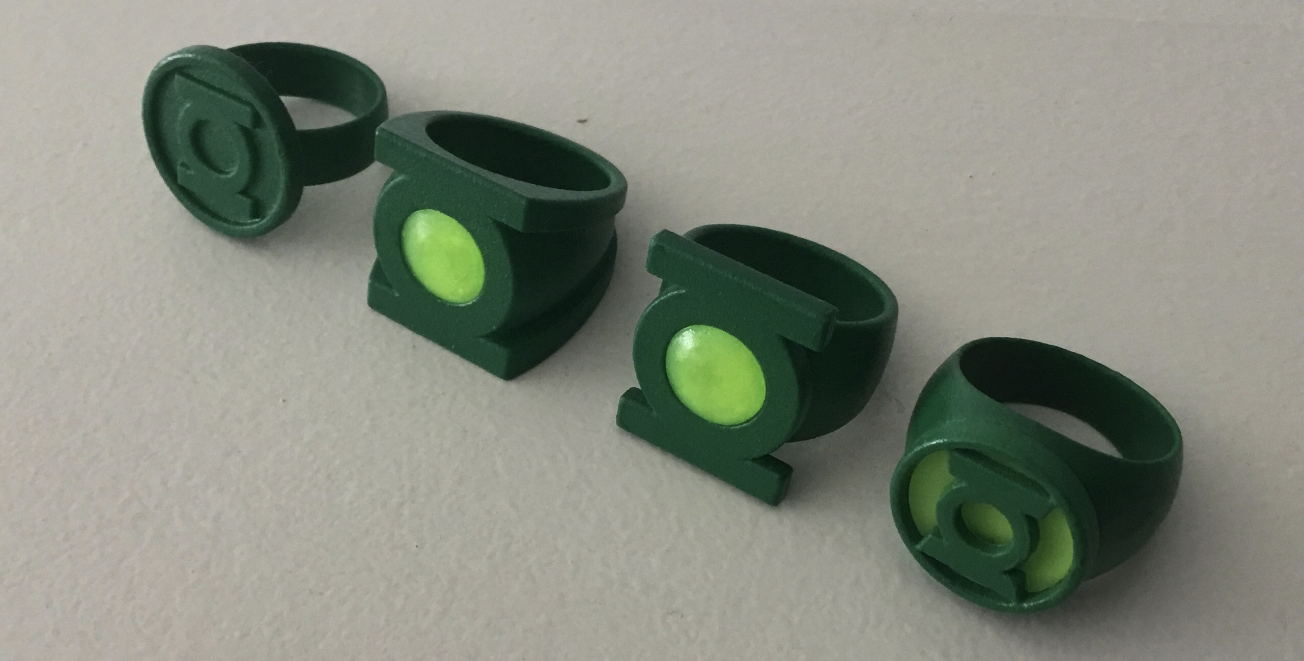

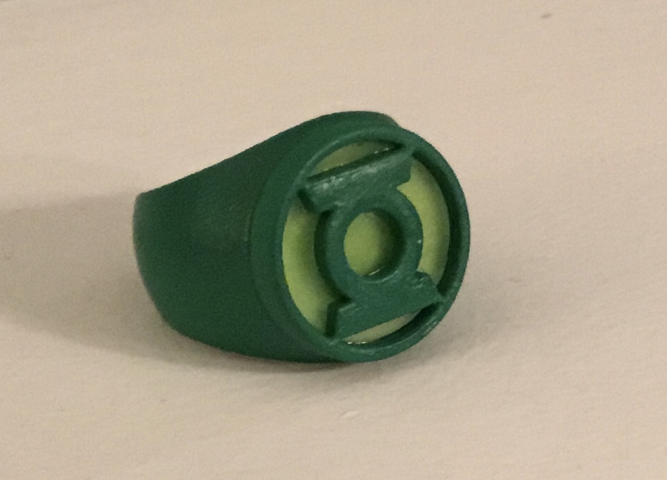

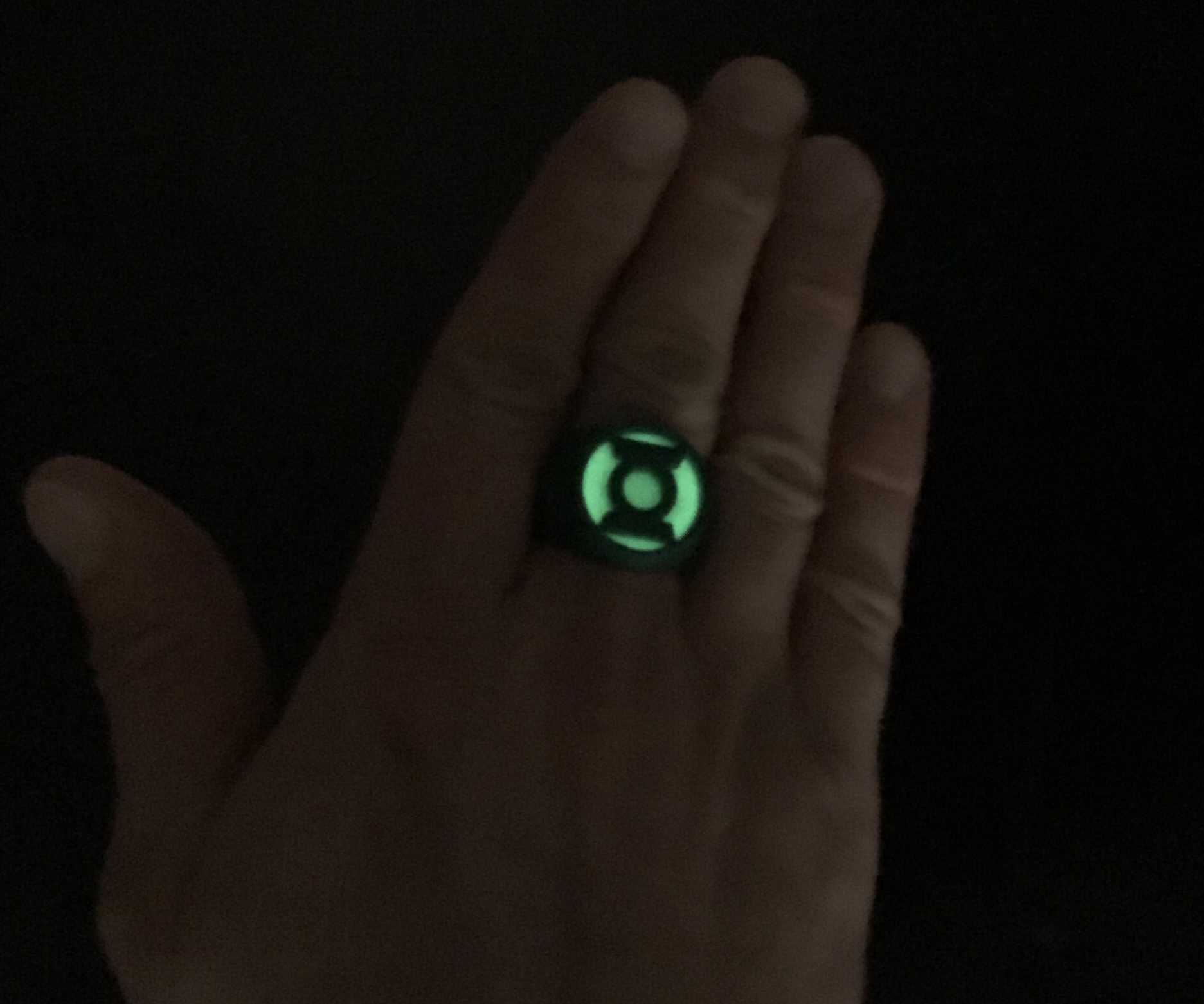

Okay, I finally got a pull from the REBIRTH resin insert’s mold which wasn’t rubbery, and which had a lime green-ish color that looked good. I sanded and trimmed the insert piece down to remove excess resin, which also ended up frosting the backside, just as planned. The resin remains translucent, with a bit of polishing to give it a shine. I didn’t go all-out for this prototype with polishing compound, or anything. Just a quick bit of wet-sanding on the face of it to remove imperfections and give it a slight sheen.

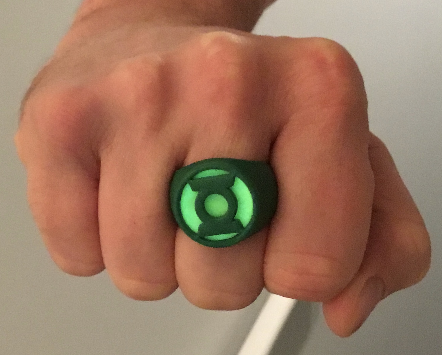

After that, I applied a watered-down mix of white Elmer’s glue into the socket for the resin insert on the main body of the ring, then evenly sprinkled green glow powder onto it. After that, the three pieces of the ring were glued together. The results are encouraging. I’ll need some time with the ring to wear it and study it, but we’re headed in the right direction.
I’m still not entirely sure how deep the negative space around the symbol should be. At the very least, I need to modify the model so that all the parts have deeper/stronger connections with each other, to assure a proper lock-fit.
Having the frosted resin insert piece suspended above the raw glow powder works great. When the powder is not charged with light, the lime-green resin insert looks nice and comic-accurate. When the powder is glowing, the frosted backside of the insert evenly diffuses the glow, which is quite bright.
Too tired to trim and install the V2 and V3 gems in a similar fashion, tonight, but this is a good start.

Just finished. Even as rough prototypes, they look good. The color of the gems actually appears MORE intense than I’d been expecting. Still need to find the right balance, in terms of tinting the resin. This is a little too much of an intense neon green. Backing the gems with glow powder adds to the intensity of the color.
For the final versions, I expect that I’ll mask off the gem sockets, evenly coat them with spray adhesive, and then apply the glow powder, so as to avoid uneven patches. And the gems will be properly polished to a shine, and maybe the backs frosted with dulling spray, rather than just being sanding.

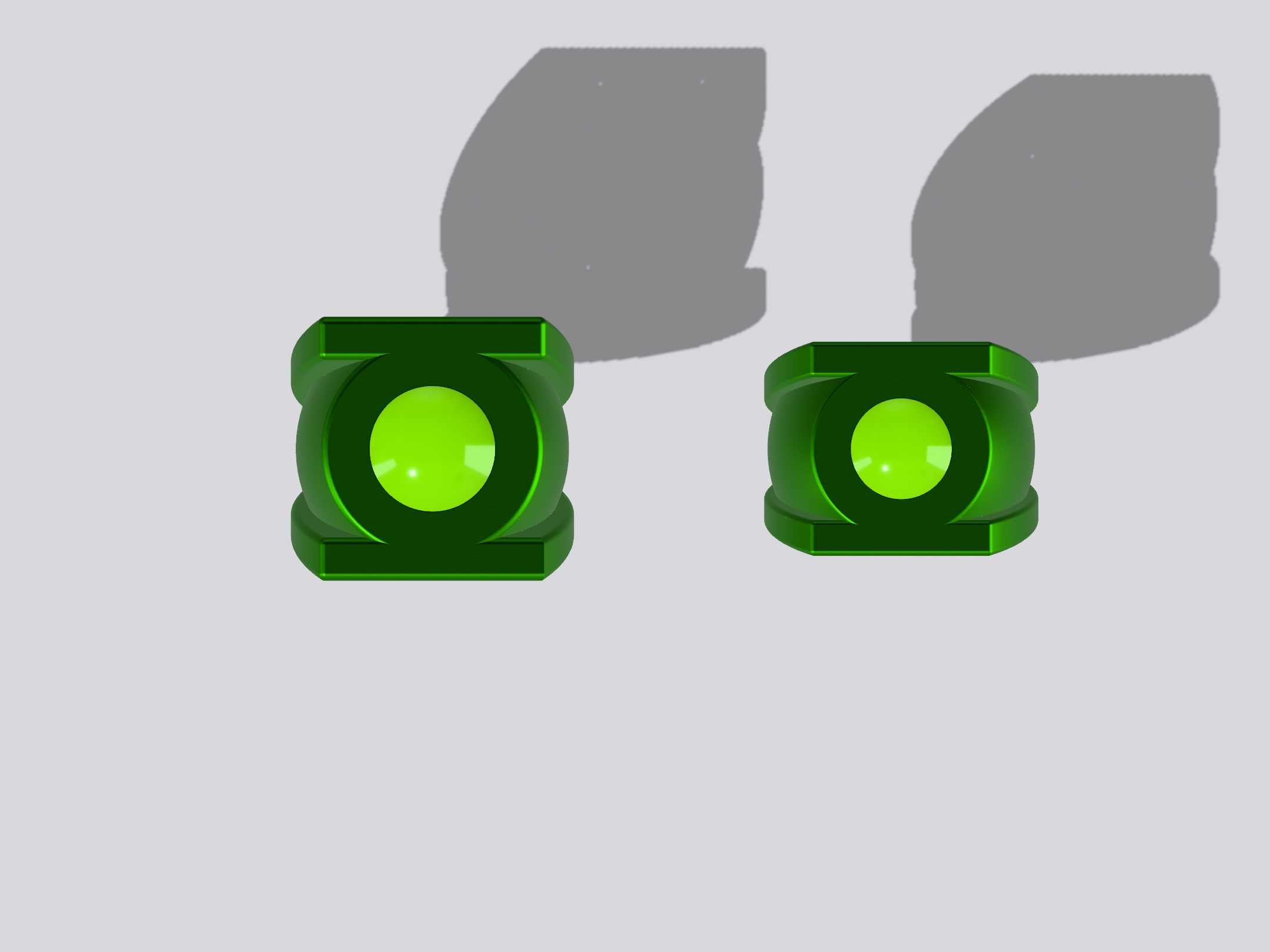

That being said, If I were to keep the V2 and V3 symbols the same size relative to each other, I’d be very hesitant to shrink the V2 symbol-piece down any more than I already have. I think the current 25.4mm size is pretty spot-on.

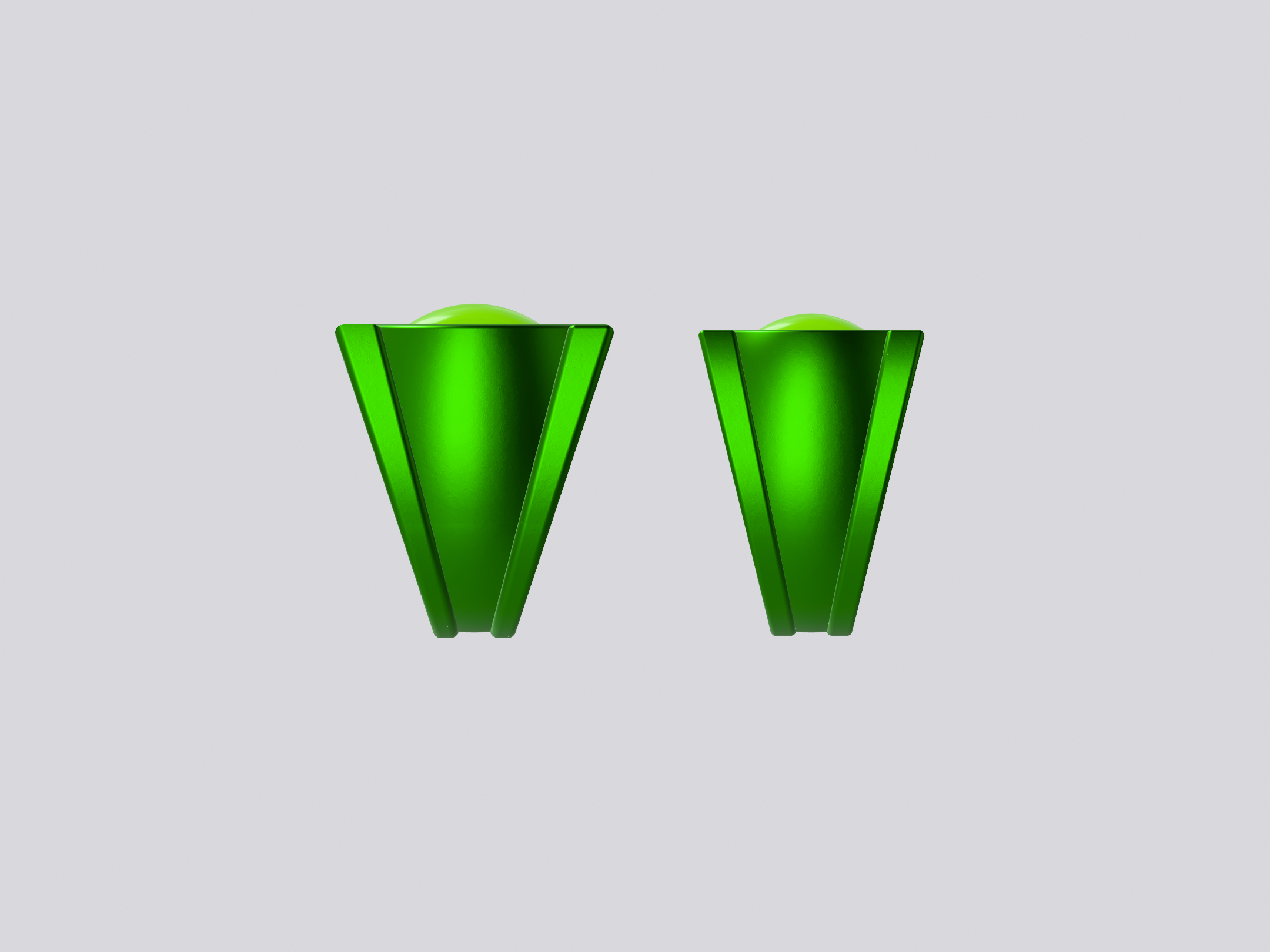

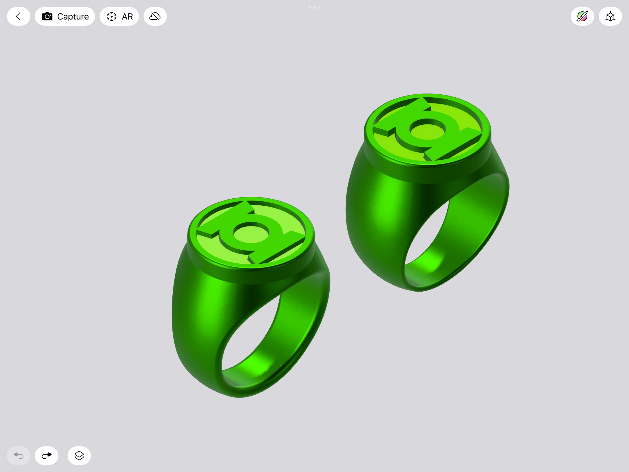

That being said, here’s an experiment. I shaved down the V3 symbol to 20.4 long, and adjusted everything else to fit. So, the ring is about 20% smaller. I think it looks quite nice, but I’m still wondering whether or not smaller is the way to go. I do think the proportions and curvature are sleeker and cleaner than the current, larger model.

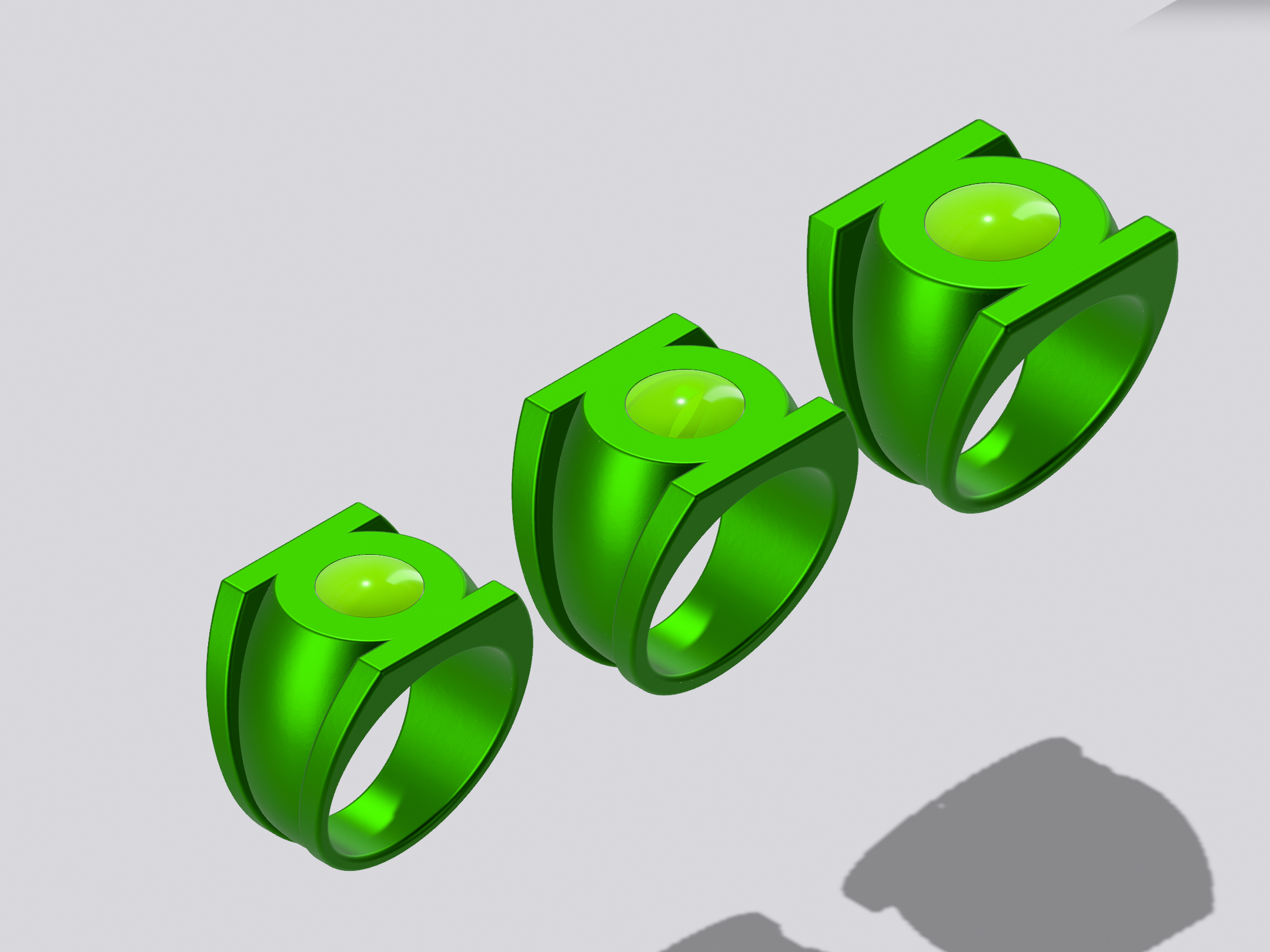

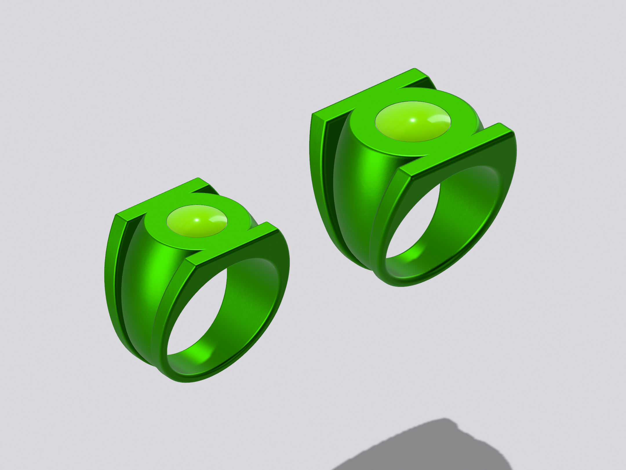

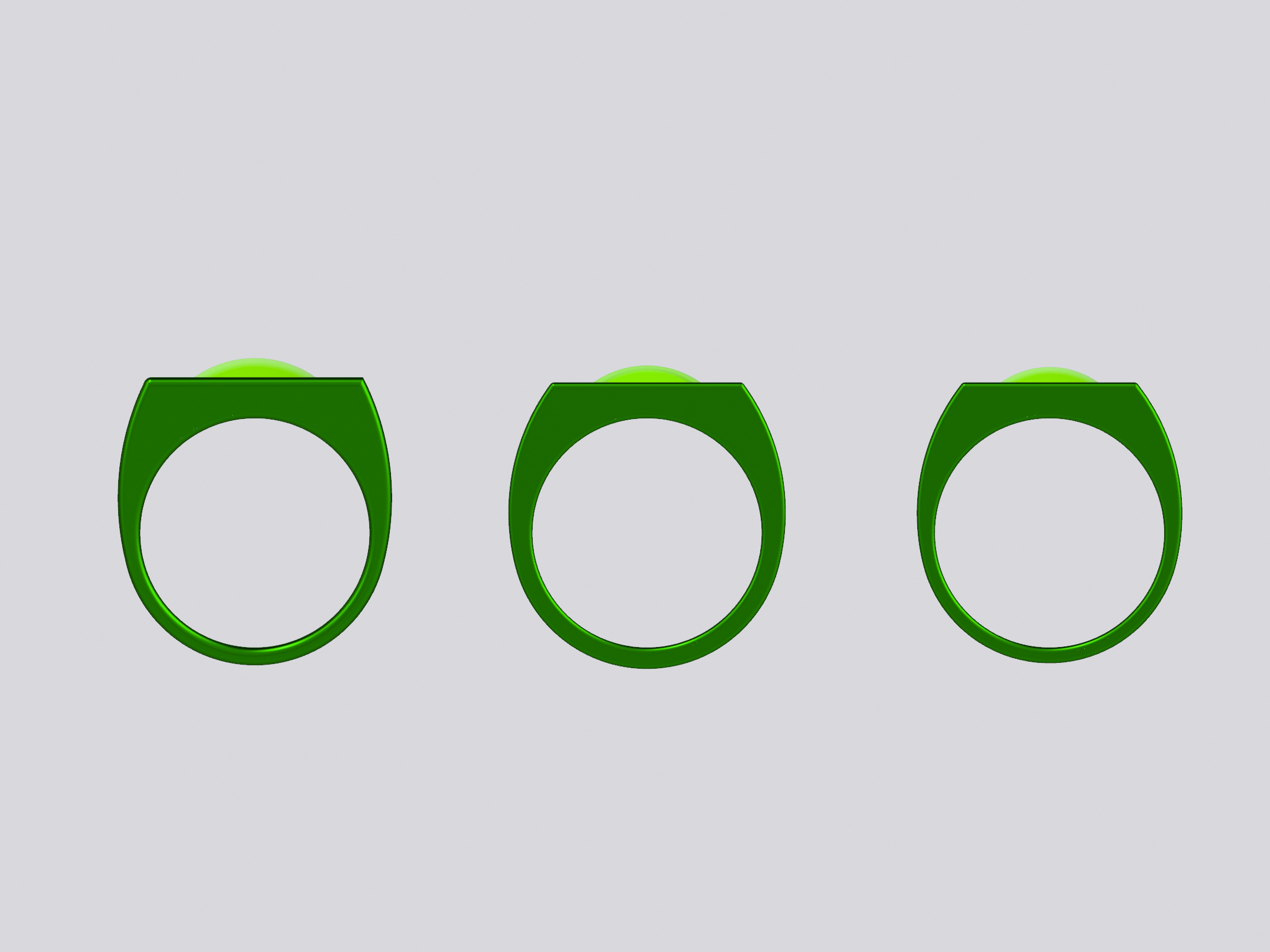

Meanwhile, I think I'll do a V3 test print in the smaller size. Shrinking the symbol down a bit makes a radical difference in the aesthetics and overall elegance of the ring. If the symbol is too big, the whole thing looks REALLY tapered in profile, and kinda clunky.
As noted, the symbol/face on the revised, smaller version seen above is 20.4mm tall. I might do one at 22.4mm, to see what an in-between version looks like.

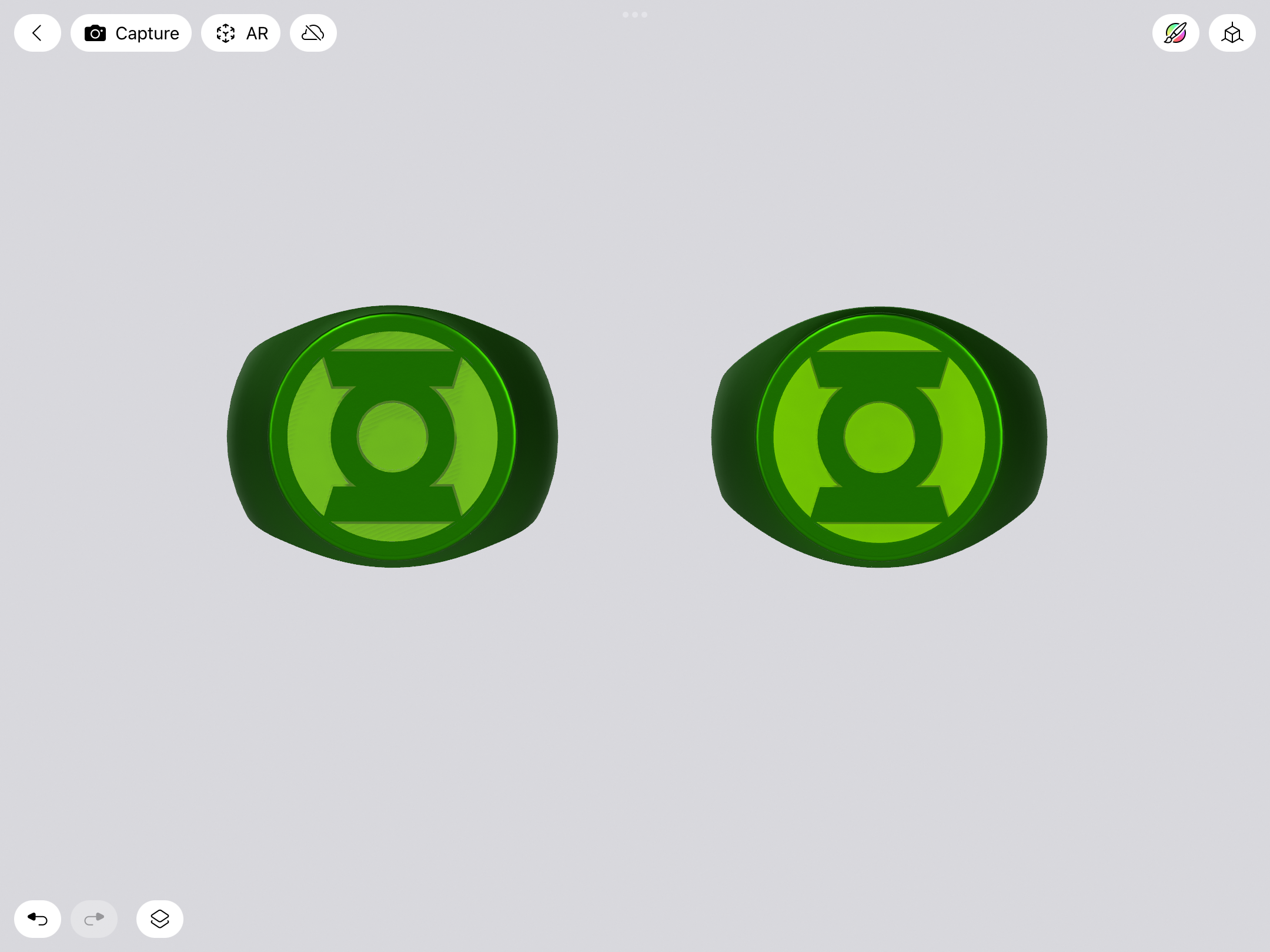

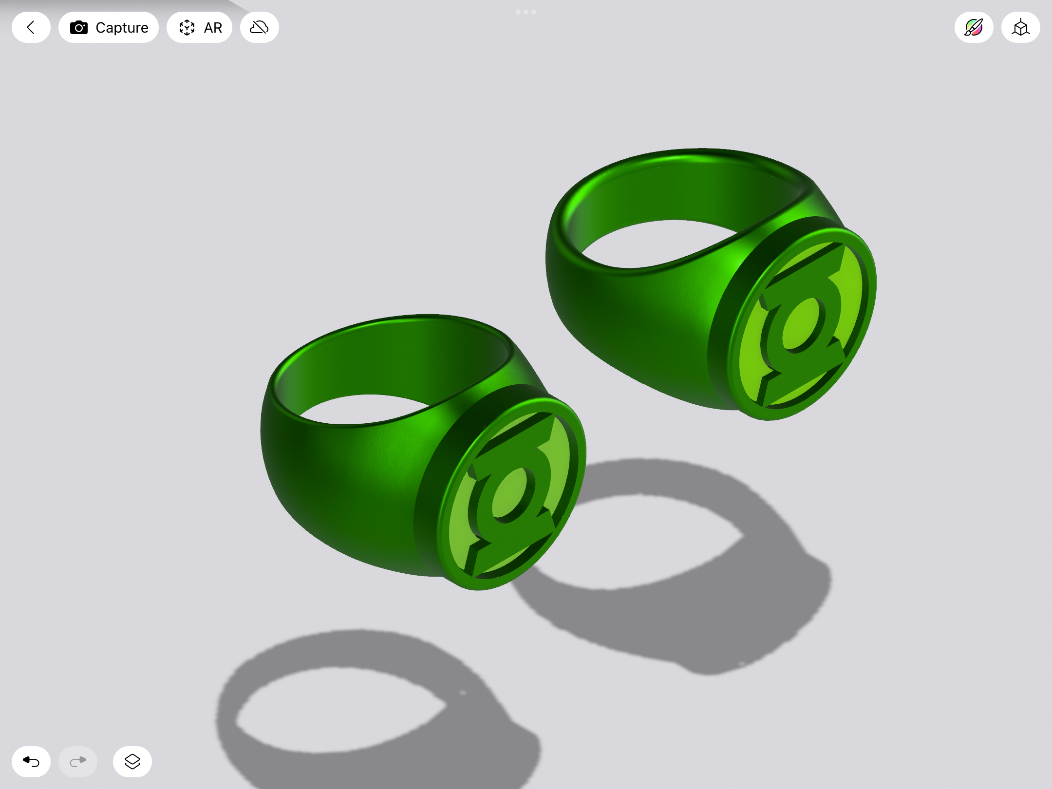

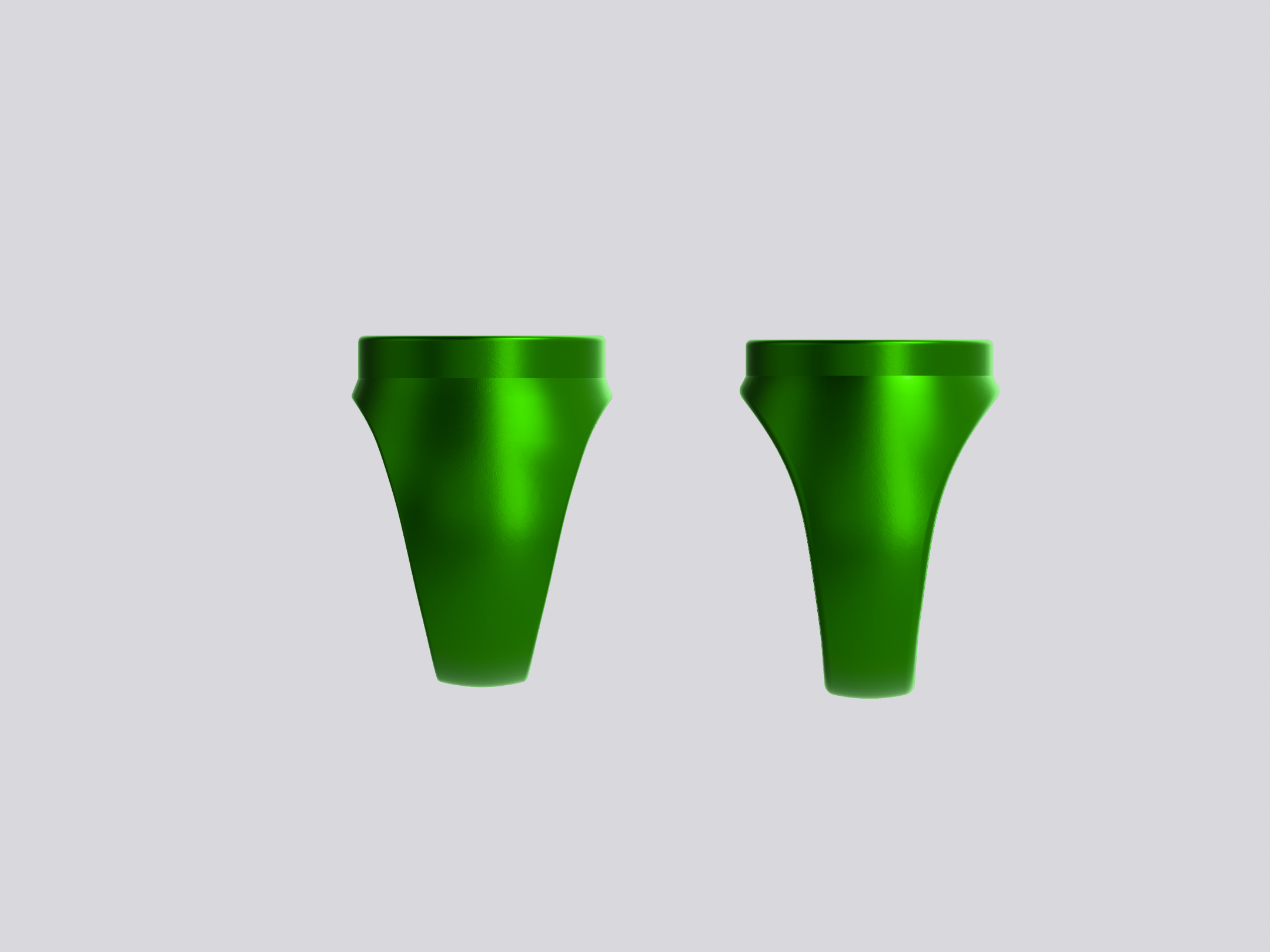

Tweaking. I had previously created a few REBIRTH variants when working on the version I just had test-printed, so I grabbed one of them to use as a base for revisions. The current/printed model as shown upthread has the edges of the finger-hole filleted by 0.50mm. This new model has them at 1.0mm, which flattens the edges around the hole and removes a good deal of mass on the band, helping to emphasize the symbol-disc (now reduced in height to an even 3mm, with the depth of the negative space surrounding the symbol reduced to a slightly shallower 0.75mm).
Also made a few tweaks to the connection points between the three parts (ring, resin insert, disc) so that they sandwich together a little more securely.
Overall, the result is a slimmer and sleeker shape. I may yet again tweak the overall shape of the band and also adjust the thickness. This new version is a bit heavier/thicker, which gives the bottom of the shank more substance.
Here’s a comparison between the model which was just printed (left) and the revised version (right).

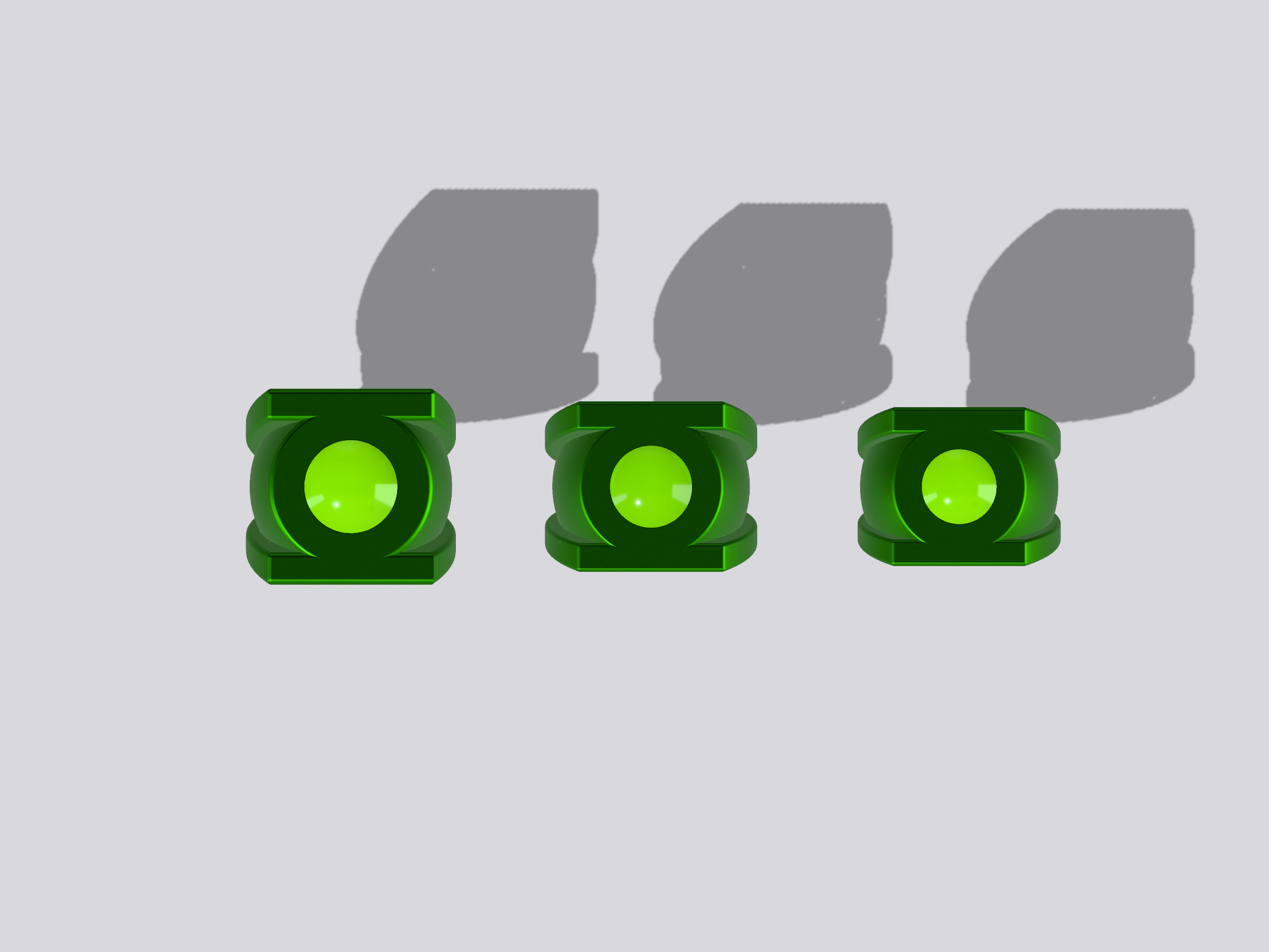

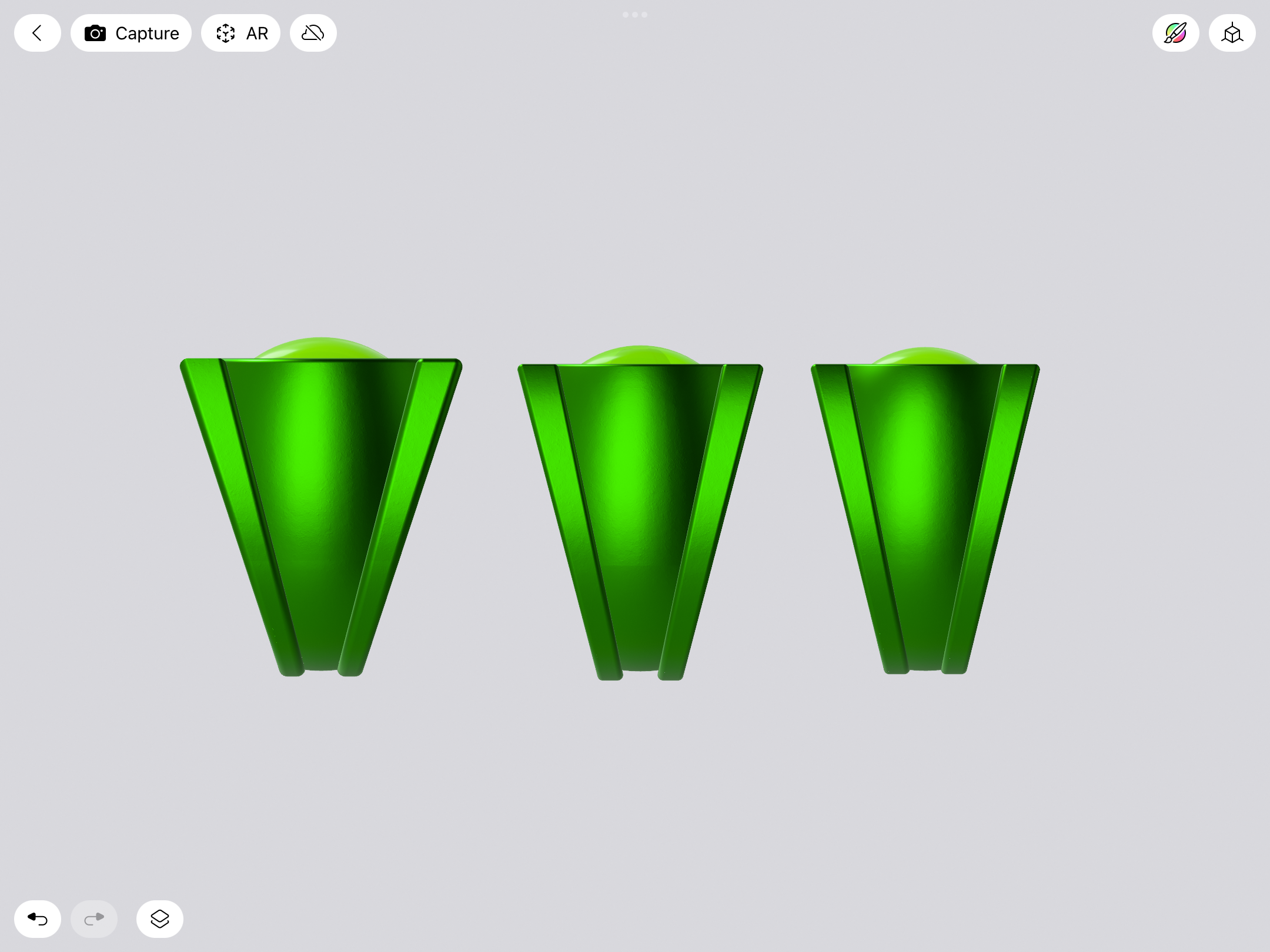

Threw together a 22.4mm V3 (middle) to compare to the other two. Interestingly, in the front view, the way the sides of the band curve up toward the symbol/face resembles Grell’s art pretty closely.
