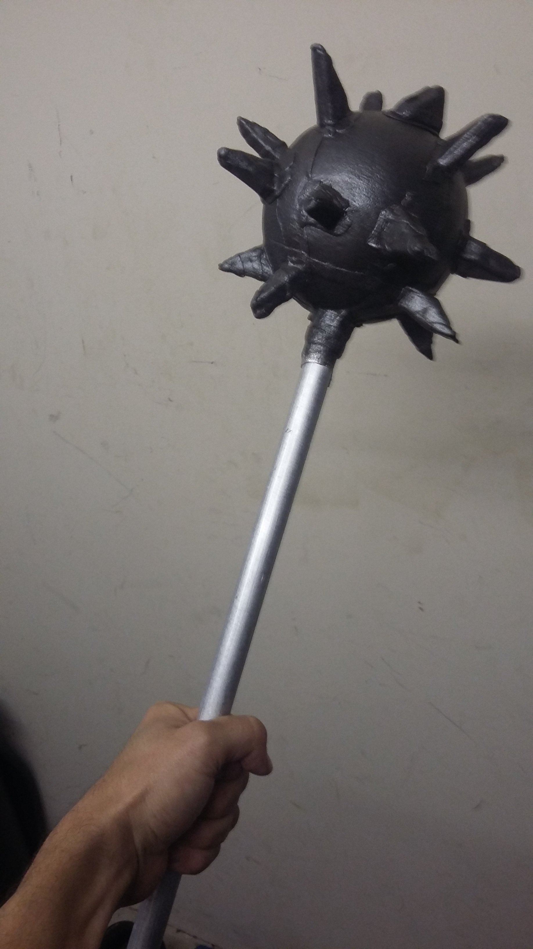

Weapon Time. Death's Head uses a Morning Star Mace and I've made one for another cosplay (Fink Angel from 2000AD). I used a large polystyrene ball, made a large hole to allow the handle to be fixed to it then started to cover the ball with off cuts of worbla I had. The spikes were triangles cut from EVA foam, covered with Worbla then attached to the main body. I primed the Worbla then sprayed it metallic effect. MorningStarMace2.jpgMorningStarMace0.jpgMorningstarMace.jpg

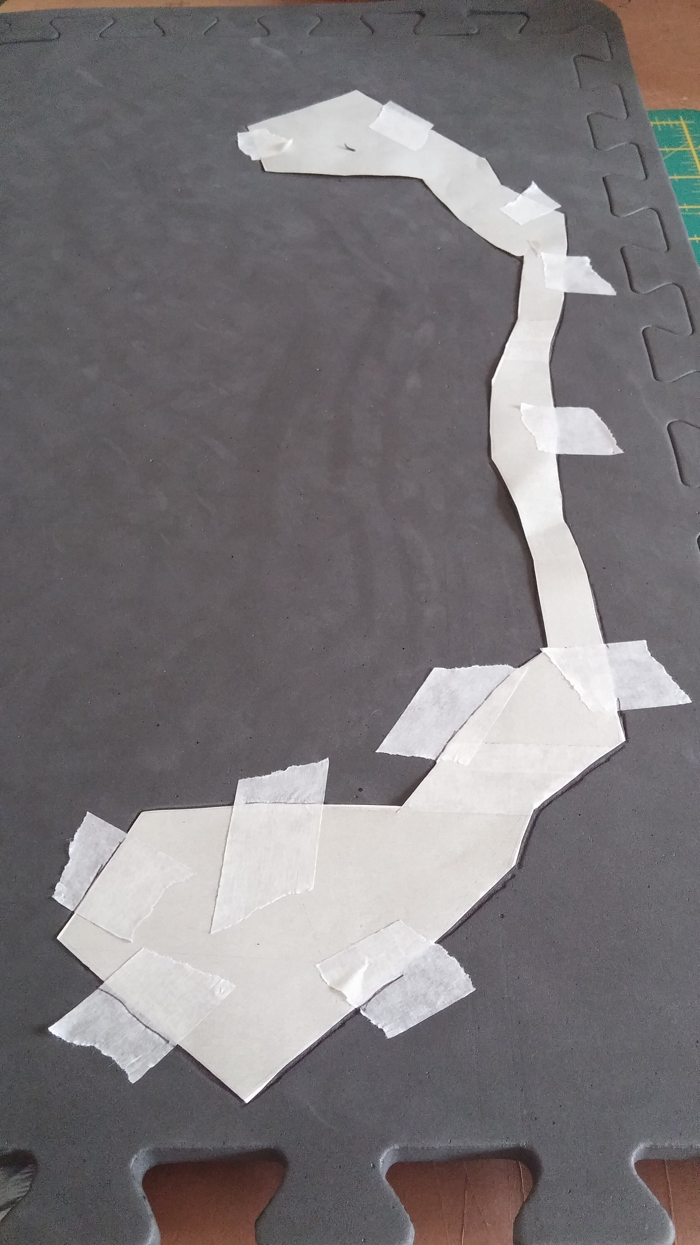

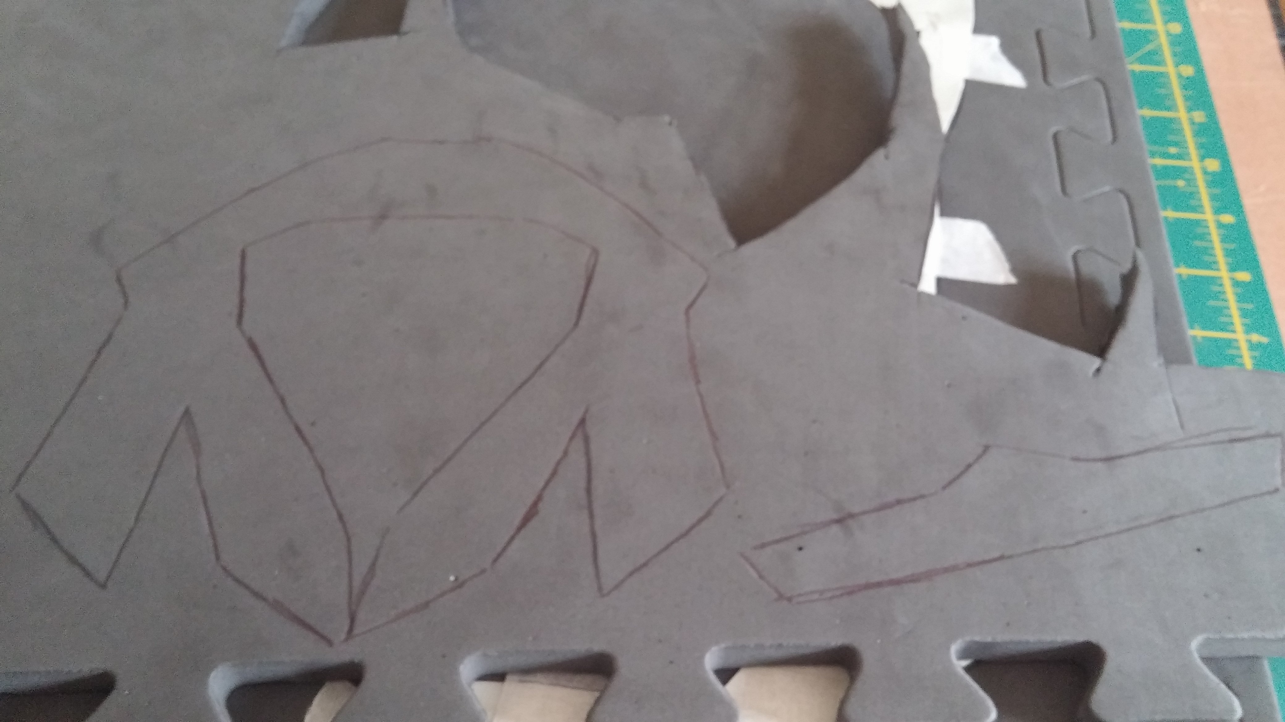

With the basic build of a skull created, I then cut out paper templates to gauge the size of DH's triangular front plate.

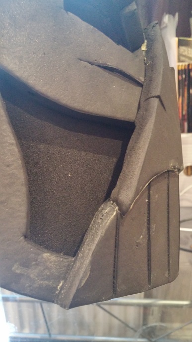

When I found the appropriate size, I cut the plate from Eva foam, then slice it into two parts, one part forming his nose and the other the teeth.
For the teeth effect, I scored the detail using a craft knife and used a heat gun to expand the notches.
I then glued the two parts of the face plate together to get the over hang effect and attached it to the skull.

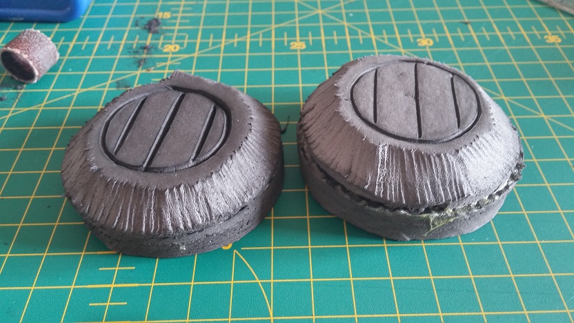

Sketched up some paper templates for the jaw line.

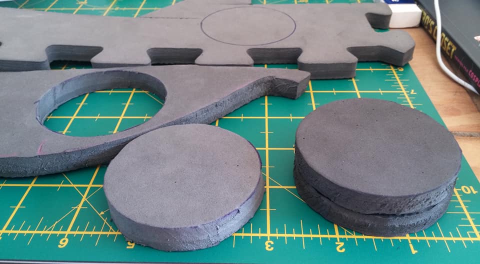

Bevelled some eva foam cylinders with my dremel tool before cutting in patterns and using a heat gun to open the cuts. These pieces are to be used once jaw is attached.jaw disks.jpgjaw finished.jpg

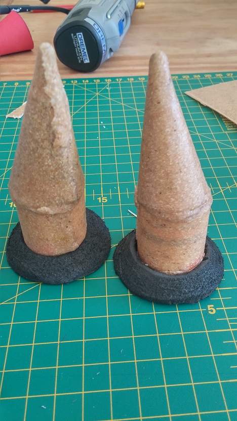

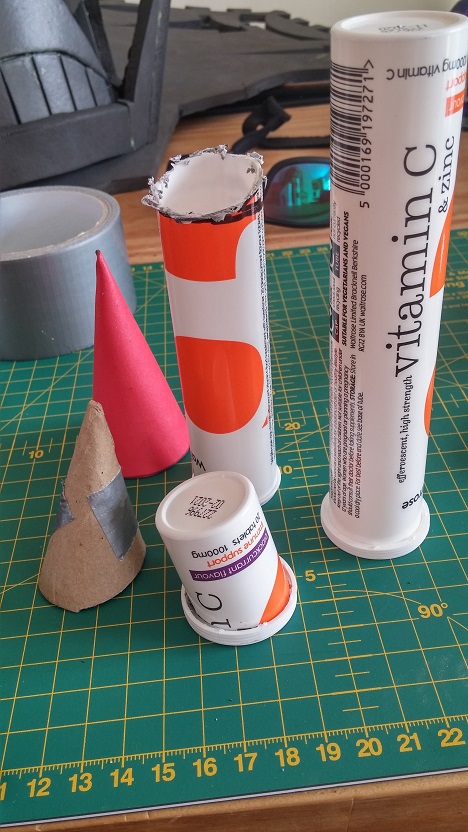

Ol' Death's Heads horns have given me grief, started with cardboard cones from a craft shop, that I pulled apart to make foam cones, they looked rubbish, so I used vitamin tubes, the cones, eva and more bevelled eva rings to end up with horns I'm fairly happy with.
